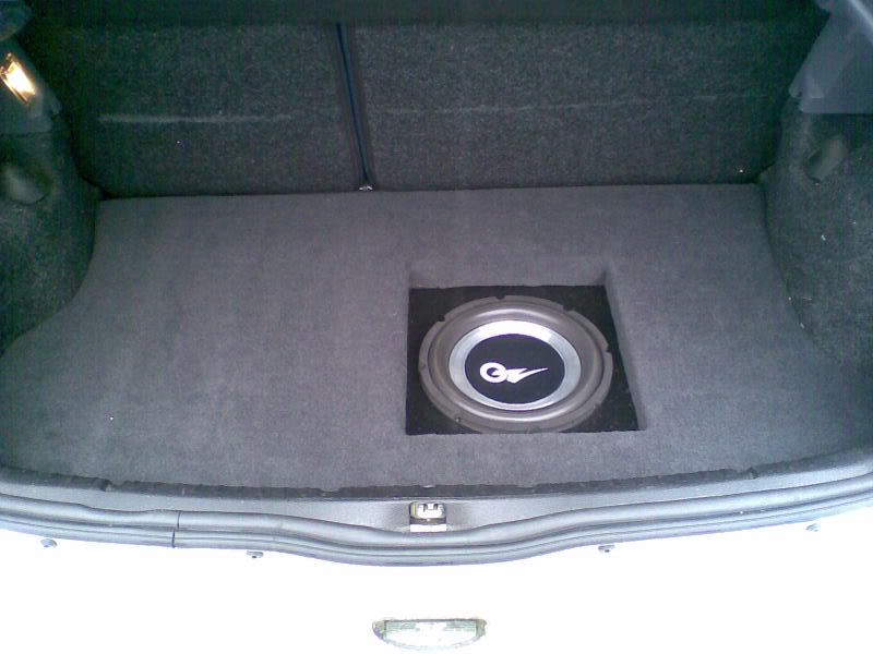

Exactly what I have done now made a fibreglass shell out of the wheel well, then attached that to an msg board that runs along the floor of the boot, you can then make a very simple false floor covering the amp and sub so you get full use of your boot. I just use a can of that tyre inflate stuff incase I have a puncture, coz correct me if I'm wrong but 182 don't have spare wheels

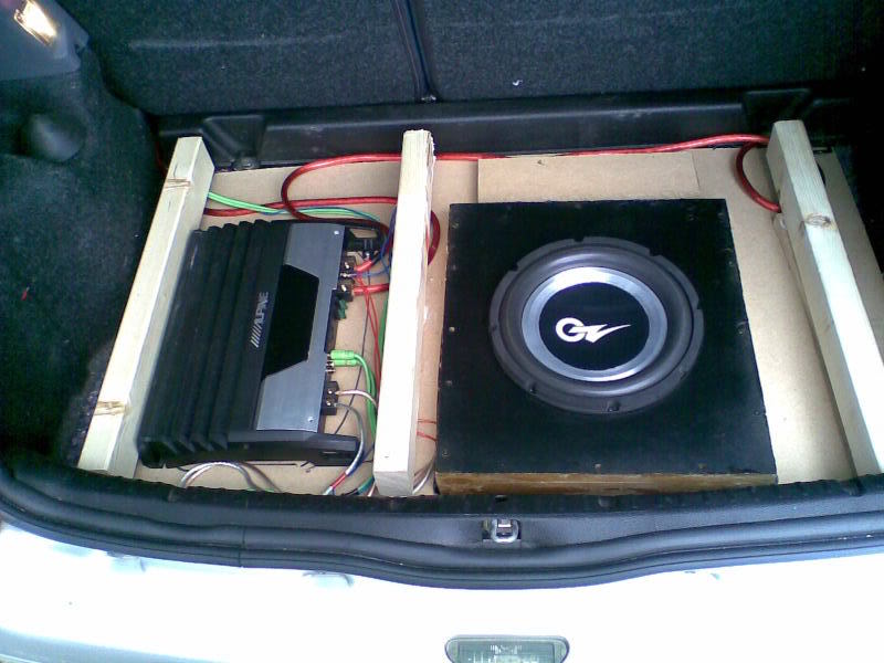

This is mine, I had it for about 10 mins before I decided it was a poo idea.

Lol your BMX is almost as famous as Roys RS. Yep it wasn't sealed properly I just couldn't be asked with all of that.
Charlie, looks good fella. You do it yourself?

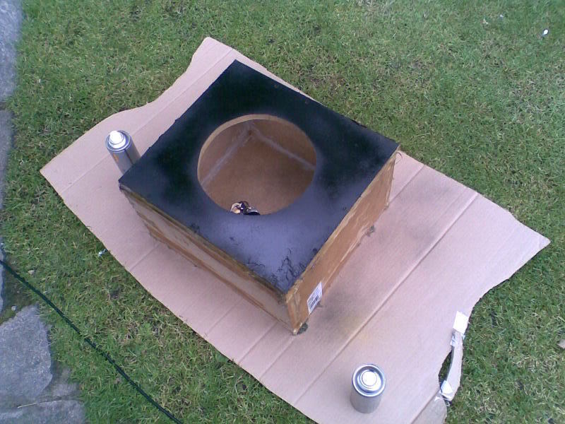

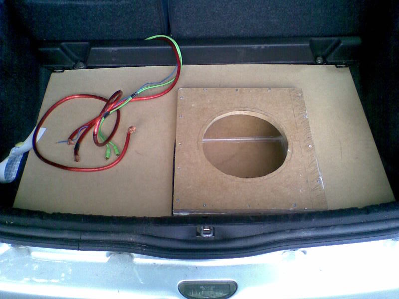

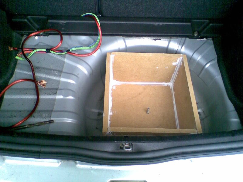

Yeah just knocked up a quick box without a lid, stuffed it, got a sheet of MDF, cut a hole, joined sheet to box, dropped sub in.
Never gonna sound amazing, but gives you a s**t load more space and a nice little punch in the back.
