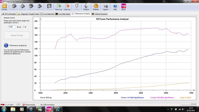

Just been playing with the performance analyzer aspect of the rs tuner software.
just wondering what people think.
I think all information displayed is at the wheels and also power is in kw not hp
Power 117.08kw @6823rpm = 157BHP / 159PS
Torque 180.38Nm
Drag 21.25Kw

I did 3 runs in 3rd gear from very low revs all the way to cut out and the above seemed to be the best out of the three.
not sure if I should be happy or not.

^^^ very good numbers as those are figures @ the wheels. Add the drag and you have an estimate to the fly, that is around 185 horses, not bad to be honest, actually is pretty good! Cups seem to do book figures, so all those mods paid you back around 13bhp all in.
