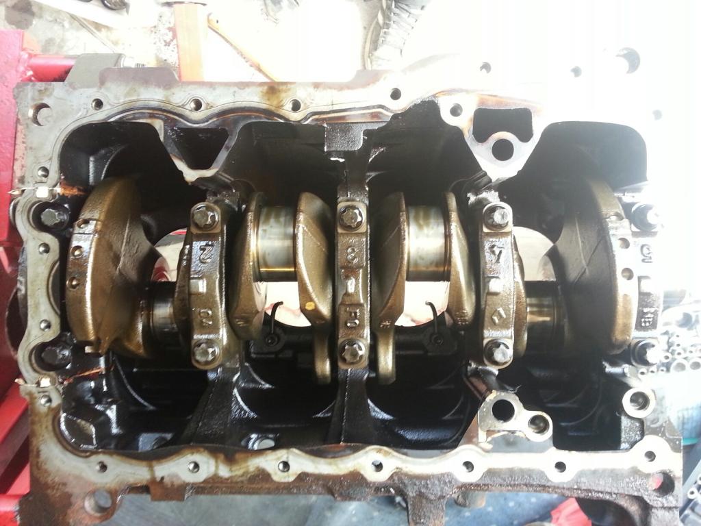

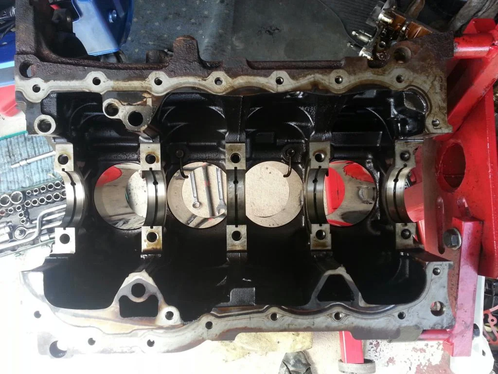

Ripped the engine apart today, here are my findings
  206,172 Cup,focus,X5

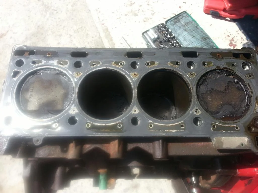

The engine has only 66k but nether the less with what im doing to the car I want to make sure the engine is good and up to scratch

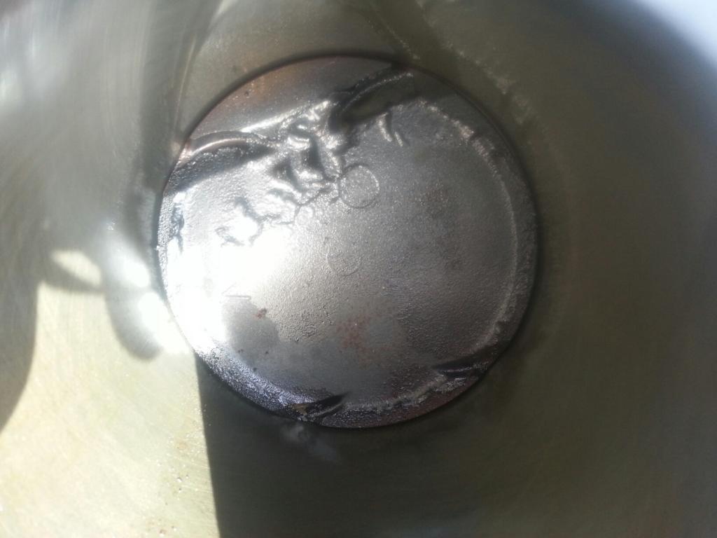

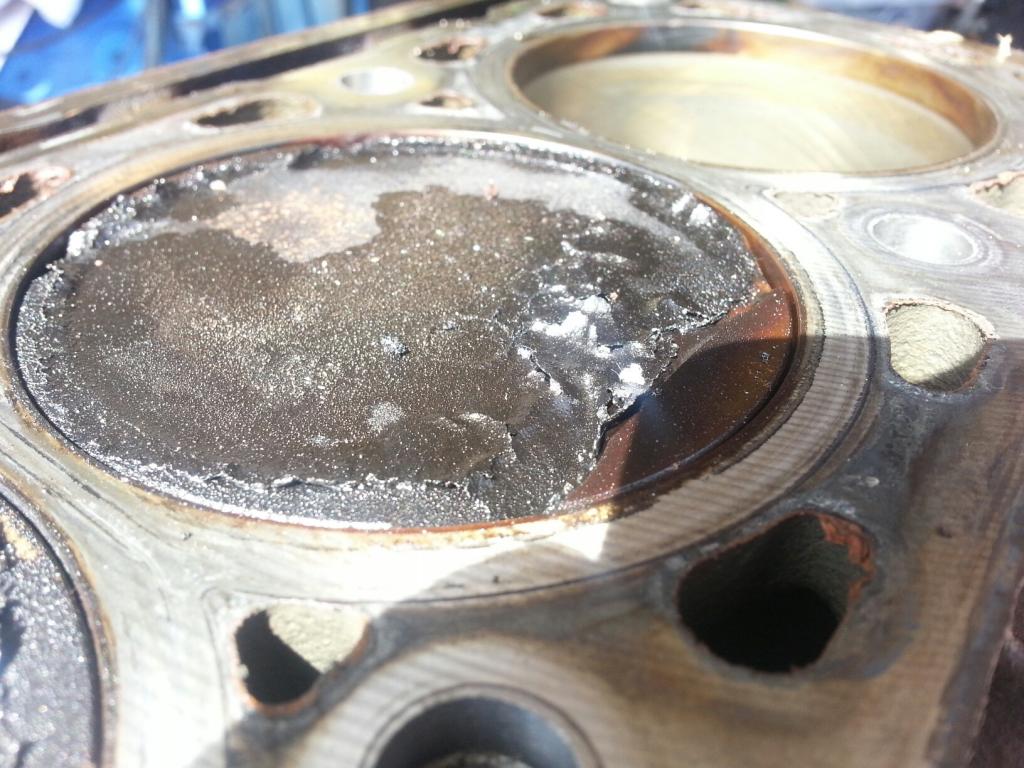

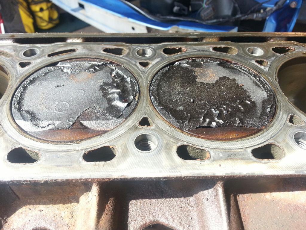

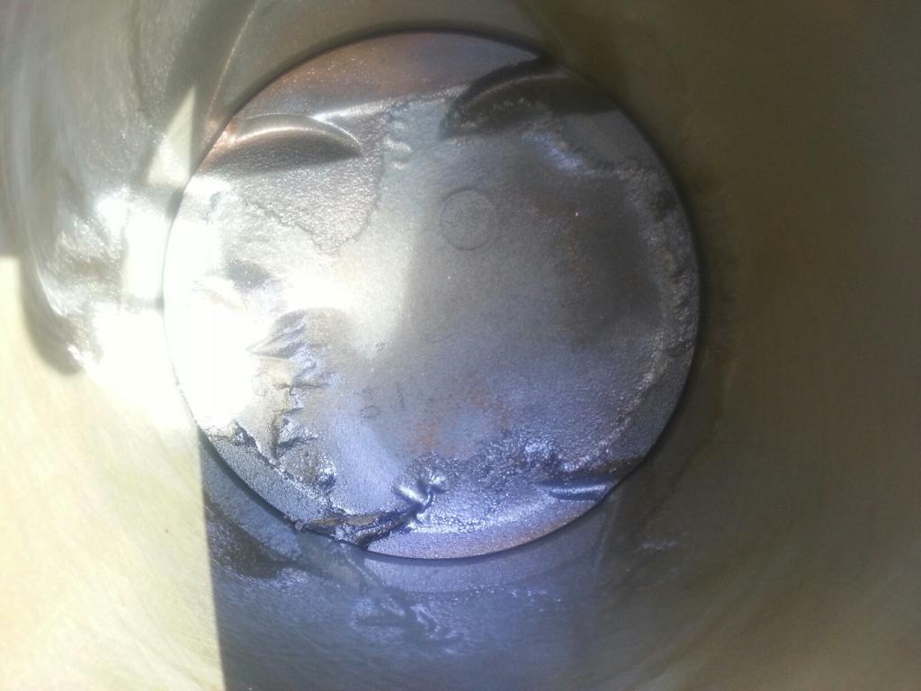

This is what I found

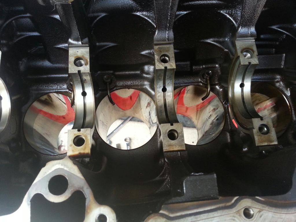

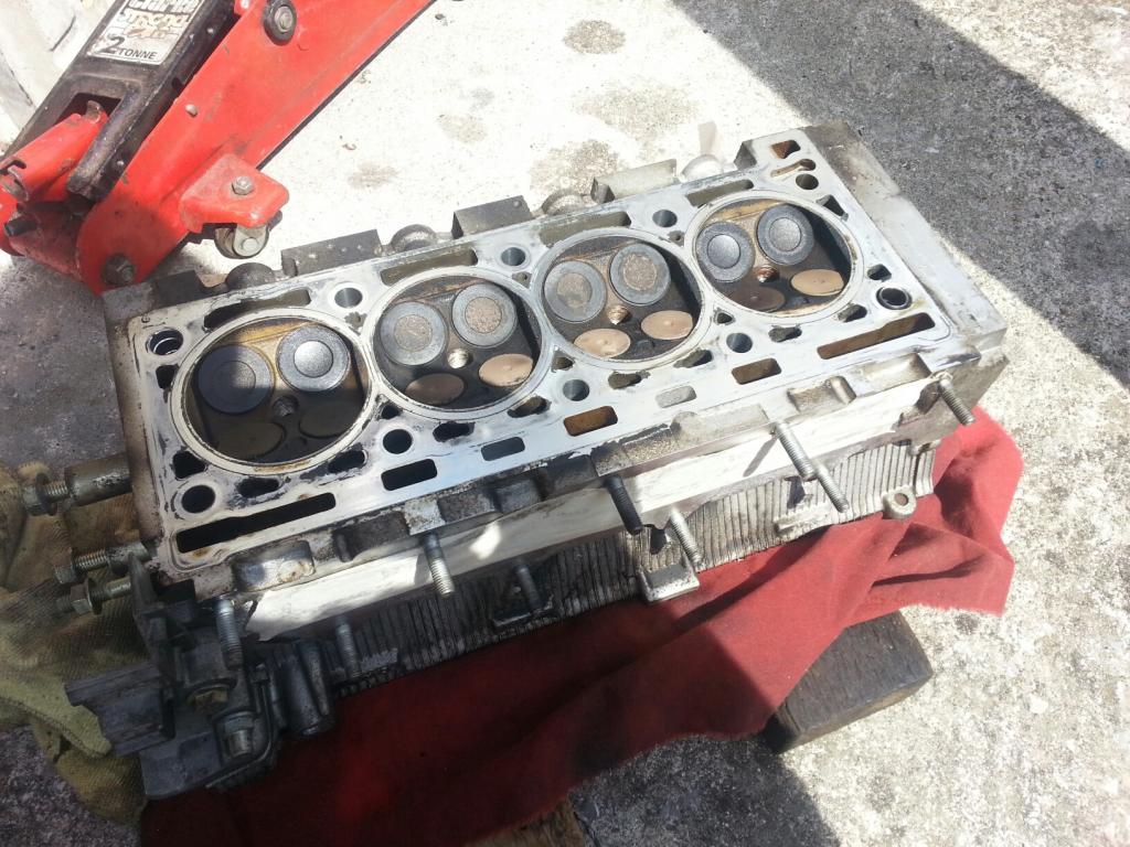

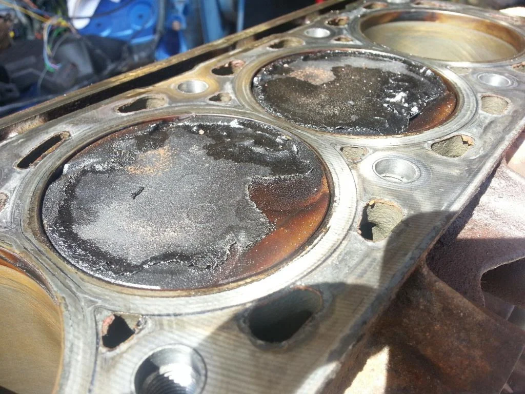

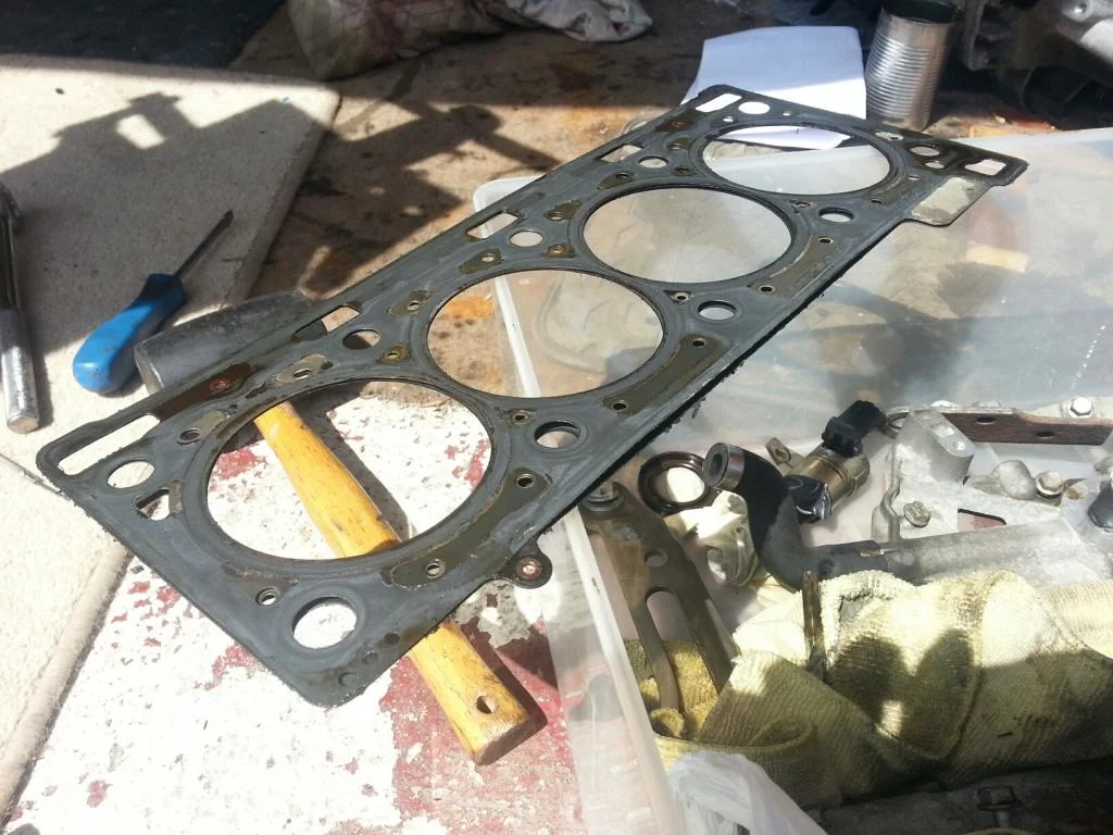

Bore looked and felt lovely , no lip at all , head gasket looked good as well
Just have a couple question
1. Did the 172 come with a MLS head gasket as standard ?
2. Are the piston oil jets press fit ? how do they come out ?

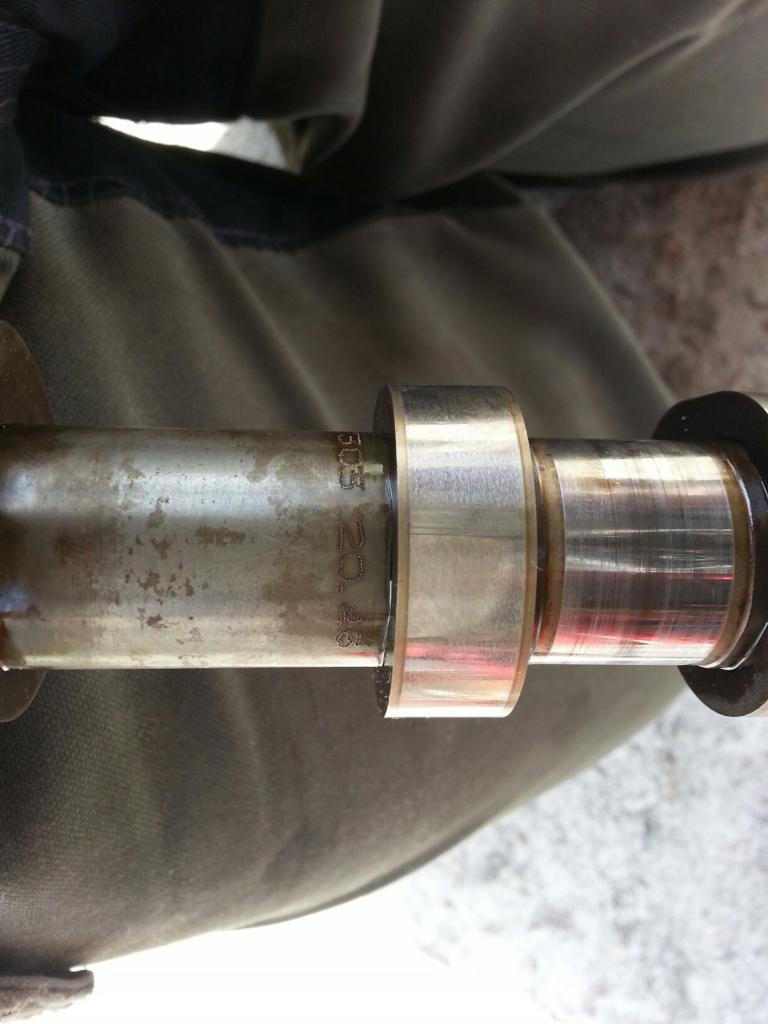

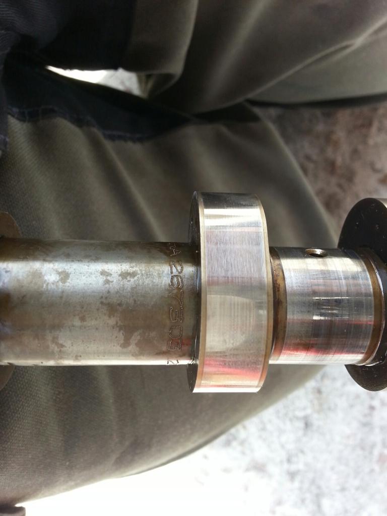

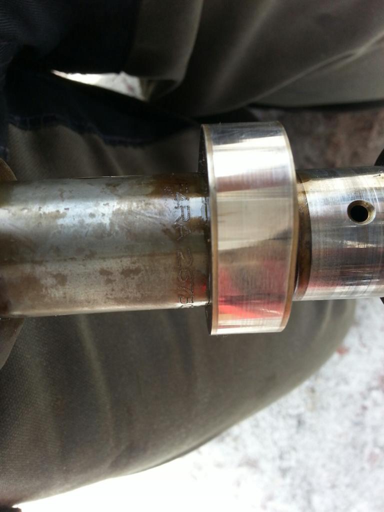

Here are my measurements
Bore : 82.50mm
Big Ends: 48.00mm
Main Ends: 54.80mm how do these look ?? pretty standard ??
With the cams that I took out are they just standard Renault cams ?
All the shells looked spot on as well , also does anyone have the lobe size for the cams so I can measure them up please
