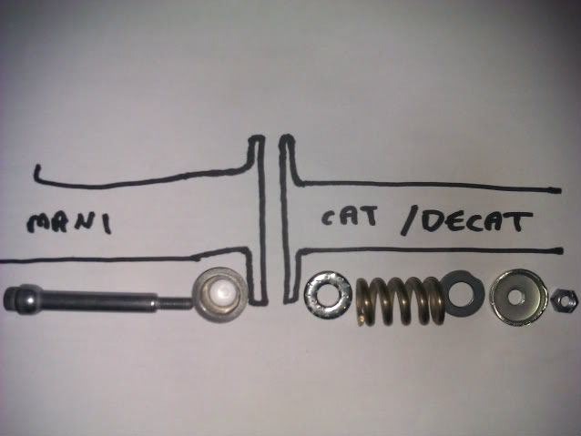

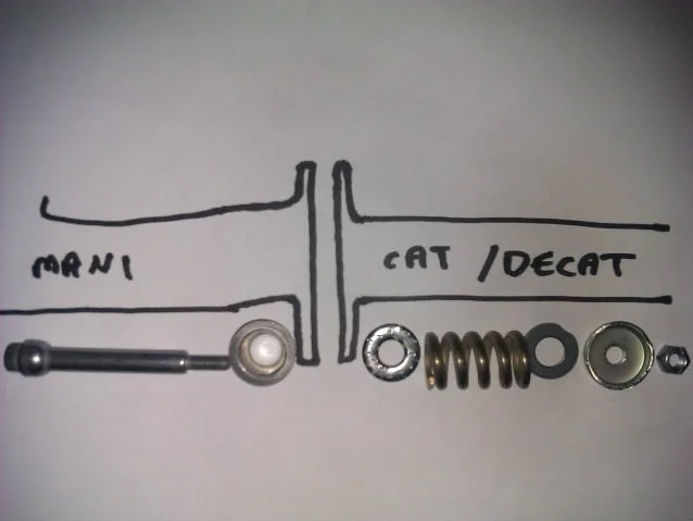

OEM Renault CAT to Manifold fitting kit which way does it fit?
  RB182
I know this has been asked numerous times but most threads give different answers and configurations lmao! :p
bolt-deep cup-manifold-mesh ring-cat-2xwasher-spring-shallow cup-nut
bolt, cup, metal washer, fibre washer, spring, cap, nut
Bolt
Cup on the mani side.
Then
Fibre washer
Spring
Other washer
Other cup
Nut
Does anyone know definitively which way is correct, Changing it tomorrow and I cant be sure that the one fitted atm is in correctly as its been on and off for cat and decat fitting numerous times.
