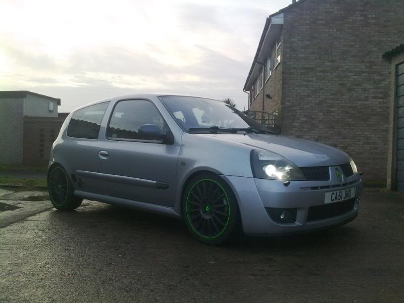

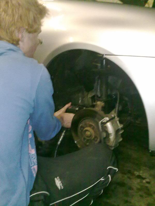

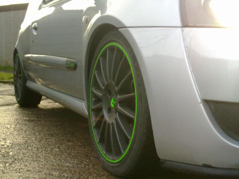

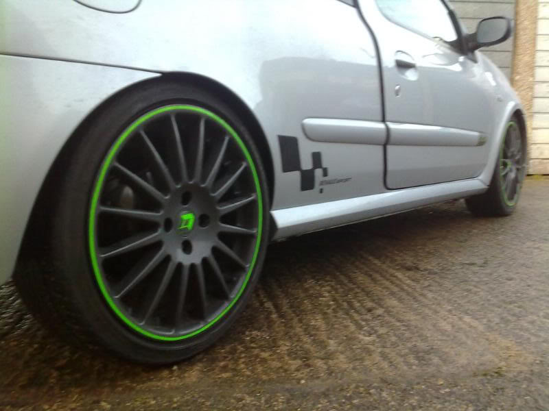

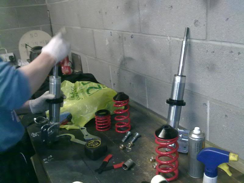

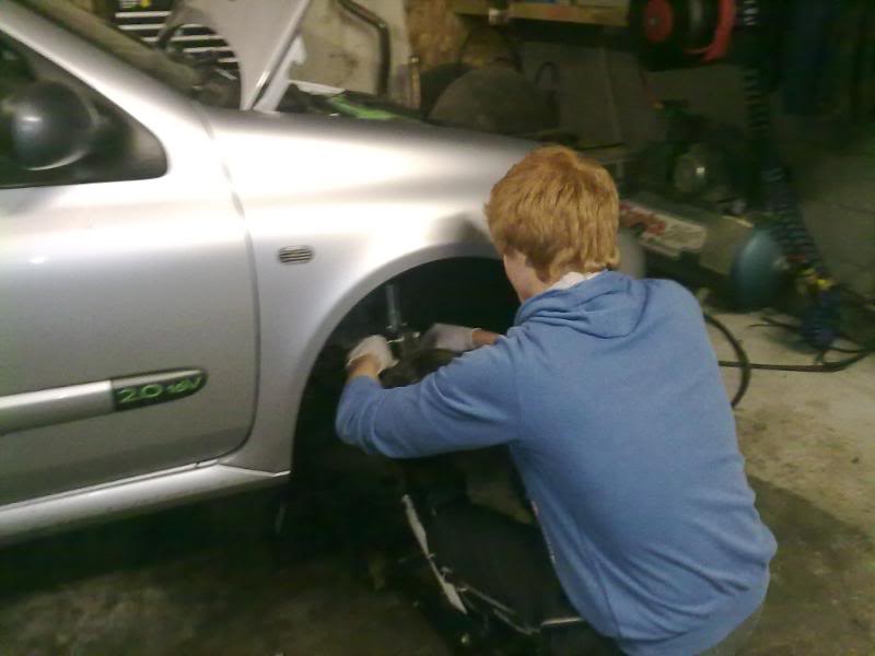

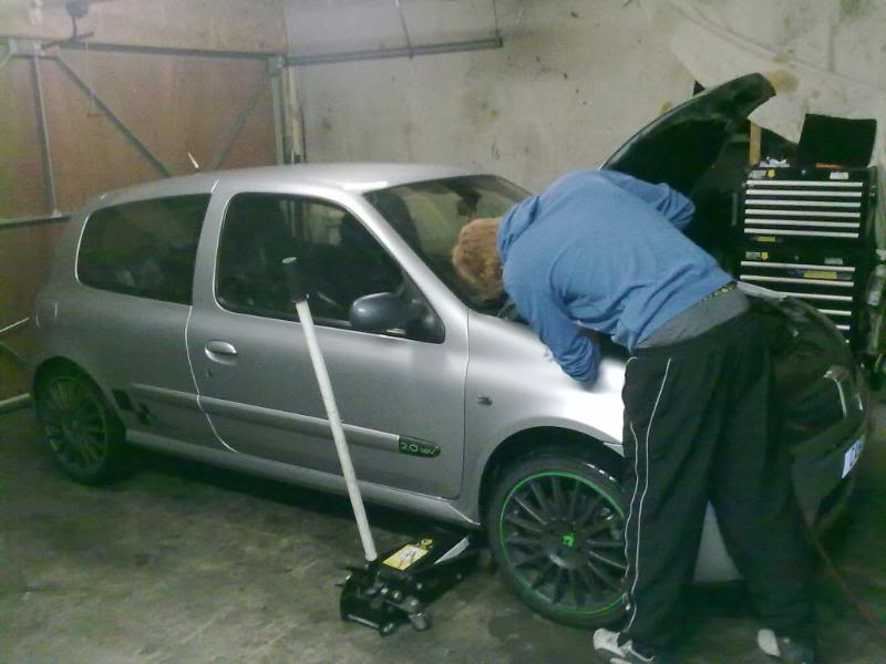

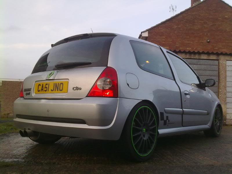

Pics as promised, after another day of driving on them ive been very surprised how well they handel, not crashy and seem alright over pothole but you do try to avoid them anyway lol. Further adjustment needed either 2morro or monday and it is still yet the settle down. Thankyou to Prince Harry lmao aka cookie_jnr for fitting them!
Outcome:- BTW my wheels are 17's
Back on the lowest setting but still to settle so approx another inch drop!
Nice spot of camber!

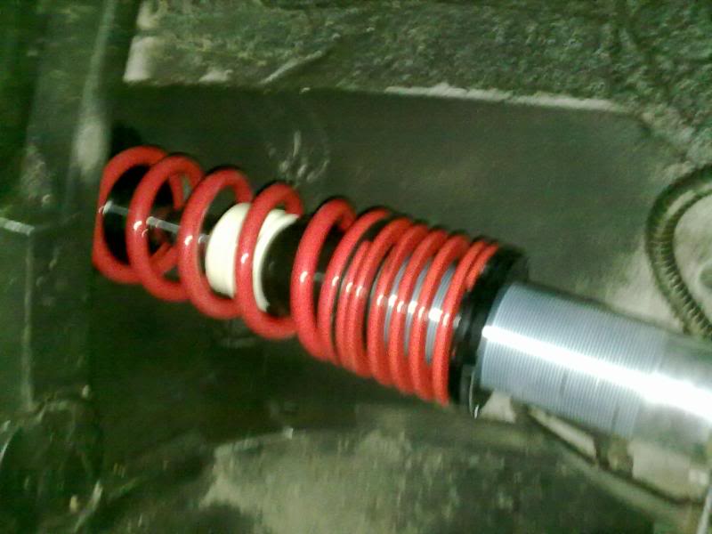

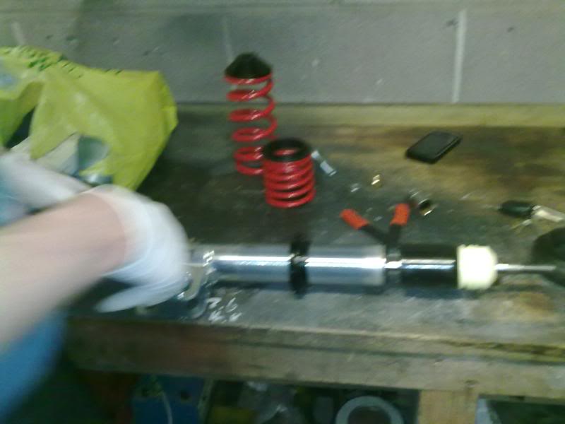

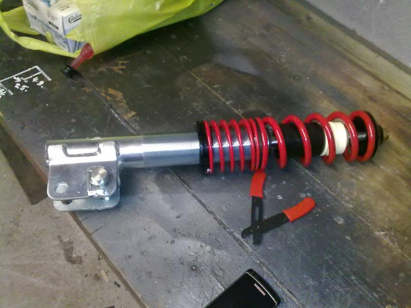

You will either want to use the top spring cup complete or the cup washer that is spot welded on top of the cup itself to spread the load onto the top mount bearing, otherwise all the load will go on the inner circumference of the bearing.
I drilled out the spot welds as i didnt want to use the complete spring cup
