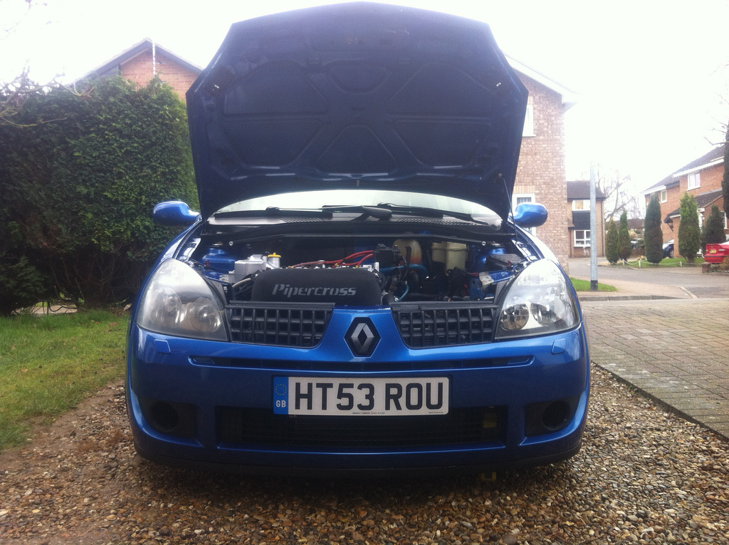

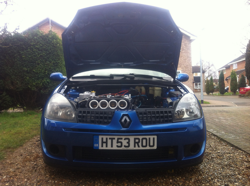

Ahhh I've just bought all the bits I need to cut my bonnet for aerocatches - so I'll trim the support braces away for the filter too :)

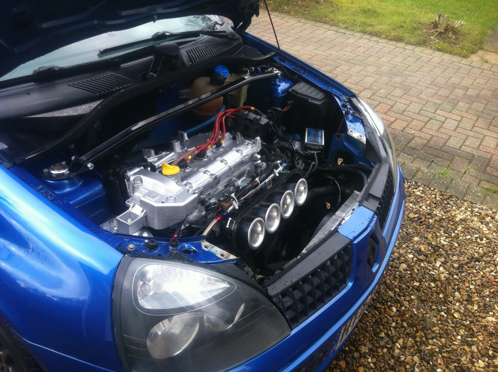

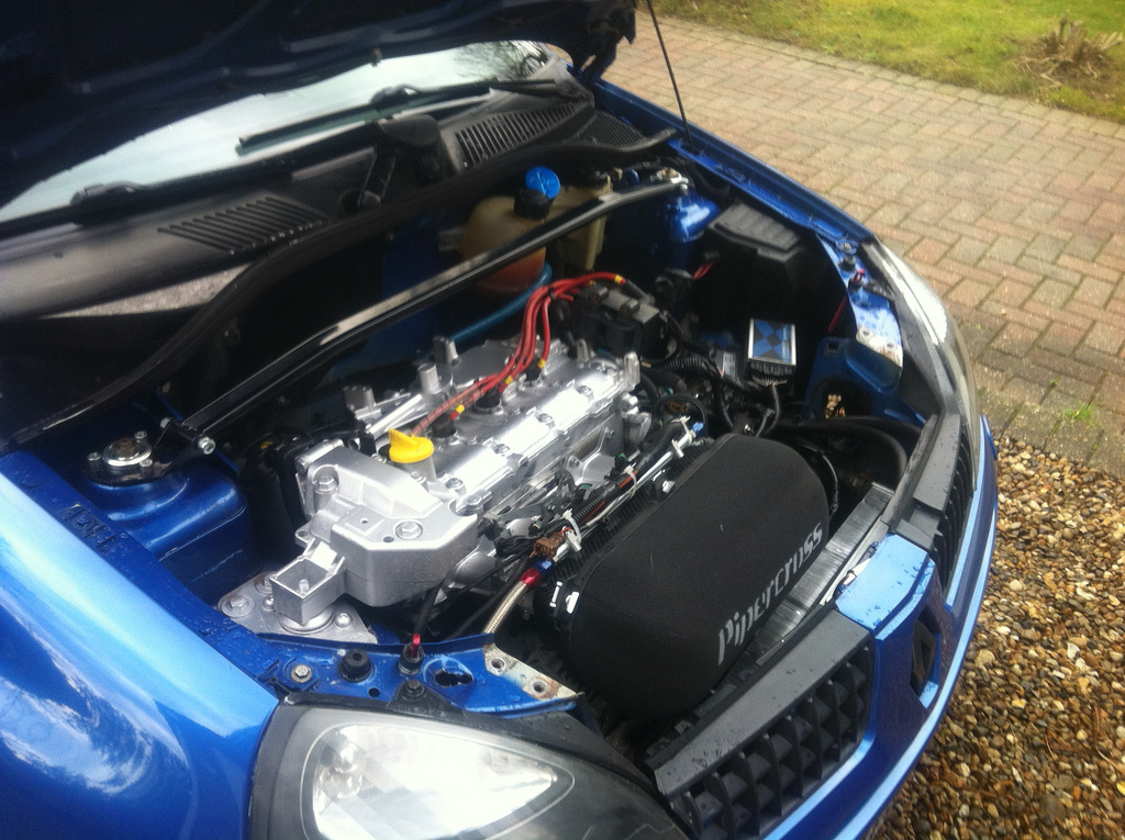

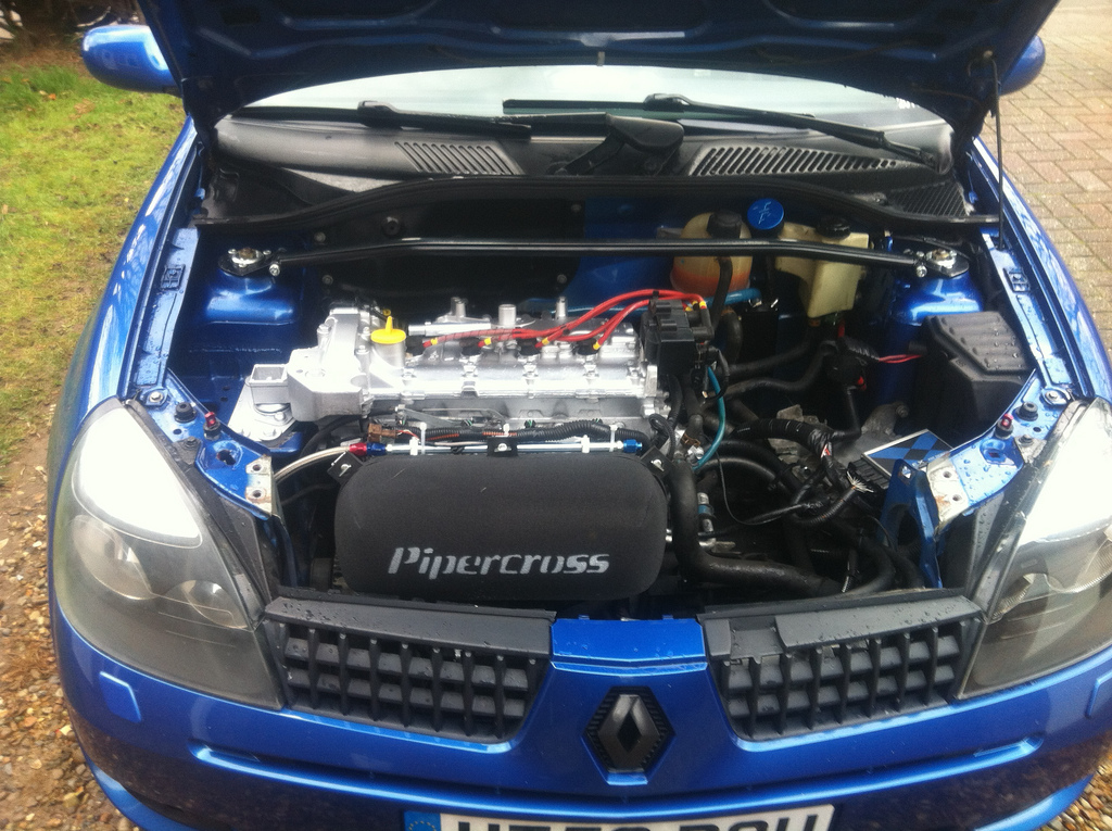

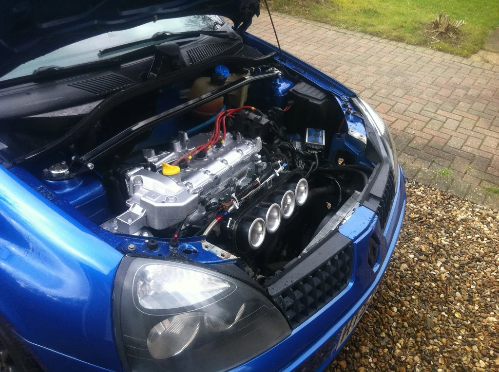

Well the engine bay is now FINISHED, well apart from a coil pack mount, although i just put a bolt straight through one of the holes and it's doing the job well :)

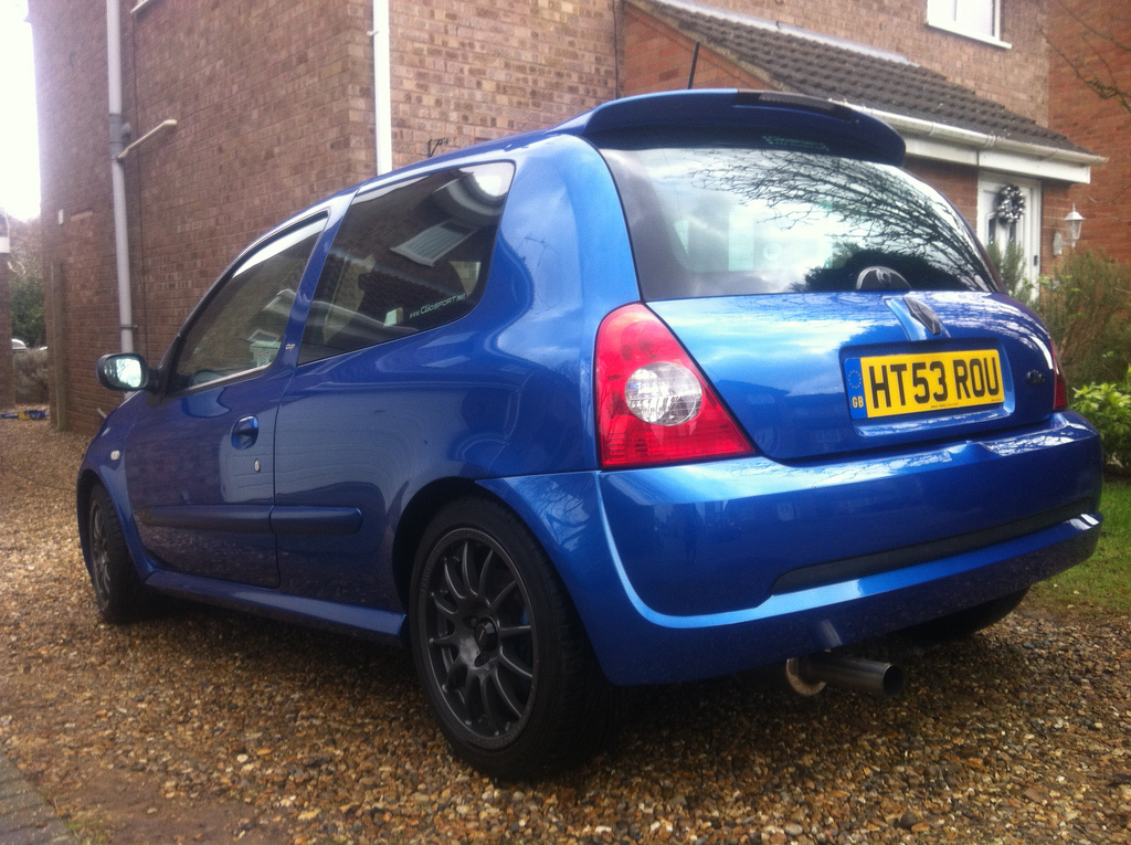

Just gave my car it's first clean in 2/3 months, didn't use tyre shine as i'm sick of having to clean it off the paint work after driving the car.

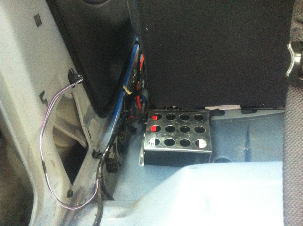

Picture of my battery behind my seat.

I like! Battery not fit under the seat?
It does, its just my battery cable sat lovelly in the cable holder things on the side of car so made the cable neater by putting it there, and it was easiest to earth putting it there, should of put it about 50mm further to driver's side as it's close to the seat, but it will do :)
Ahh right, i plan on putting a battery under the seat, i thought if it didnt fit under your seats it would neve fit under mine, as theyre so low :)

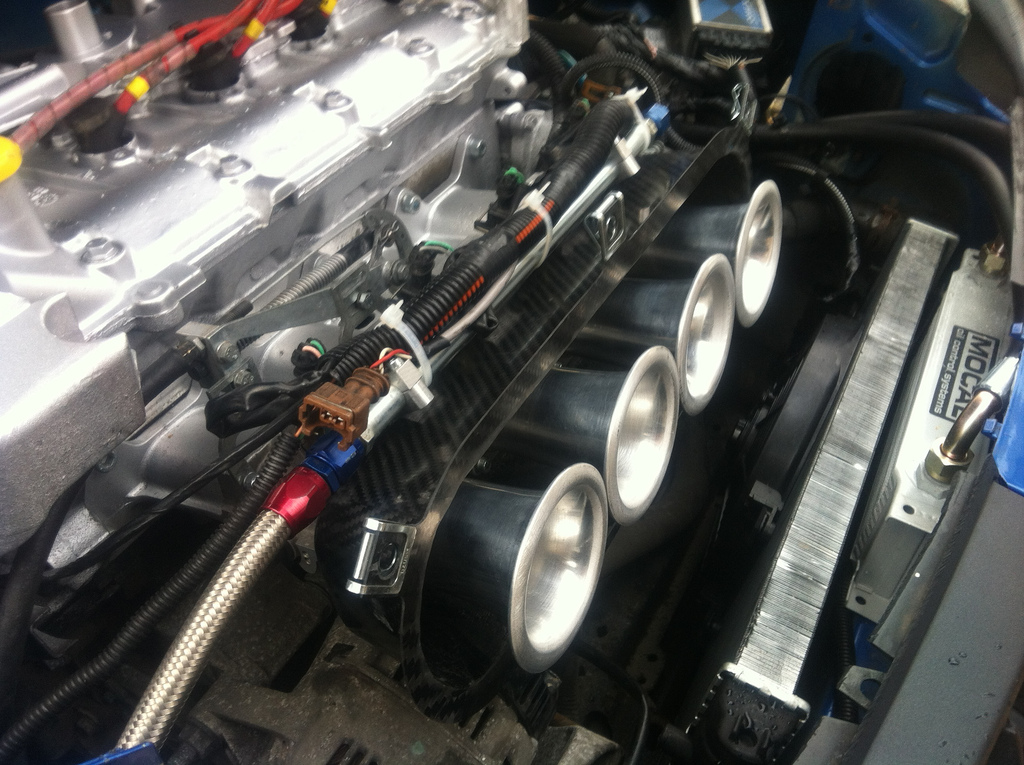

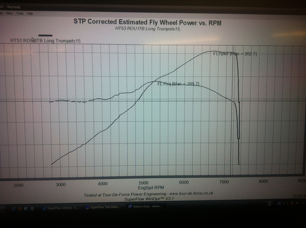

I'm back from TDF after having a full diagnostics check, ITB's balanced and a Remap.
First of all Matt got the throttle bodies balanced, must say they were out a fair bit, but after seeing Matt do it i think it's well worth me investing in the air flow meter and doing it my self, Matt showed me what to do.
Matt Then had a check of all the Valves with a smart little Key hole camera, all were in fairly good condition apart from when of my exhaust valves wasn't seating to well, but he said it wasn't bad enough to worry about, he said the engine seemed in very good condition for an engine with 85k on it so i was happy :) He then done a pressure test and again wasn't perfect but was very good for an 85k engine. After that he checked the timing, unfortunately it was slightly out, but not bad enough to justify re doing the timing. Not to mention the car is running relatively fine as it was. So Matt got the car back together and then it was onto the Dyno.

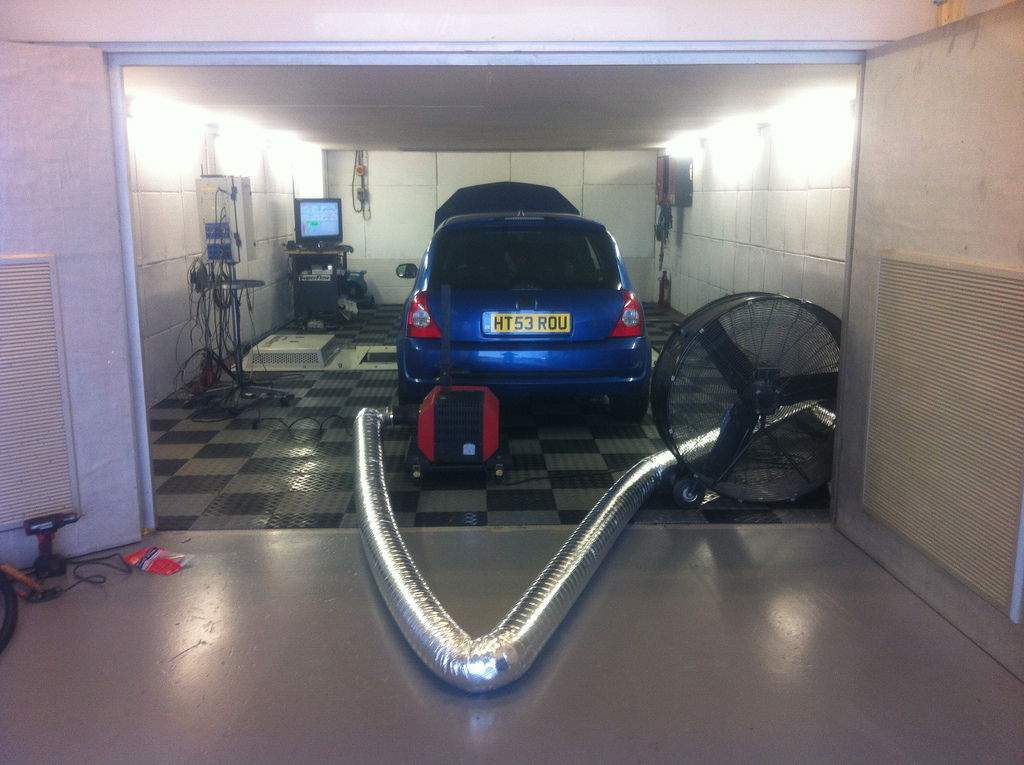

Matt got the car onto the Dyno and he done a few run's and done a few tweek's to get it running 'OK' to go from there and the car made 200.7bhp and around 167.9ftlb of torque so i was already very happy, Matt then set to working his Magic on the car and got the Map to be as good as he could and the end result....
202.7bhp
169.7ftlb
Car also made 172bhp at the wheel's and the minimum torque it made was 148ftlb, considering the last time it was mapped my peak torque it made was about 151ftlb so bags of torque and couldn't be happy, had a good day, Matt was very informative and helpful. I just can't believe how the few simple changes i've made has brought so much power out of the car!
Here she is on the rollers
The proof of my power:
My car on TDF's rollers:
Obviously there was a bit more to the day than this but I'm just summarizing :) I'm very happy with the car got some 2118's and A048's coming next week then Snetterton on the 21st of Jan for My 21st :)

Is that power just with bodies or have you got cams too?
Seems really high. 182s usually make about 195 on bodies. You must be well happy with that!
Just throttle bodies, and as said my engine is far from perfect one valve not sitting right, and timing is slightly out. Although i have got a decat, 182 manifold, and Oreca Group N exhaust aswell, but it's mainly due to Matt's mapping i think he can do these with his eye's closed now. Car's he fit ITB's to generally get 195-205 :) With the smaller trumpets, 172 manifold, cat and slam panel still fitted, i made 192.3bhp and 151ftlb of torque when they were first fitted.
