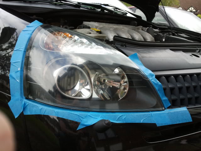

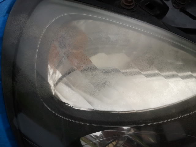

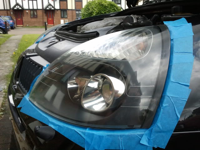

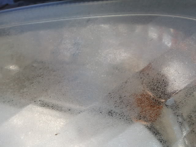

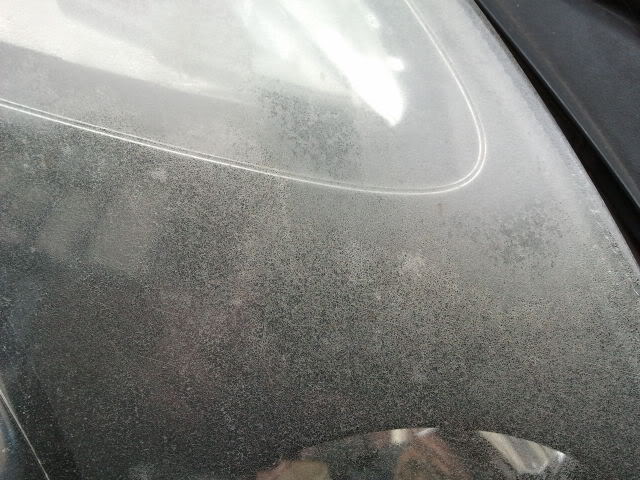

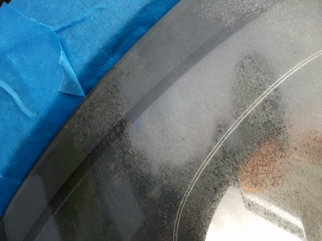

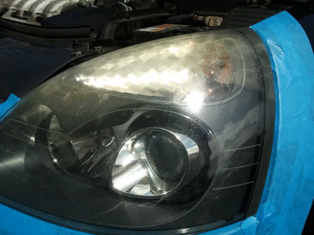

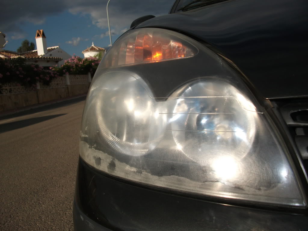

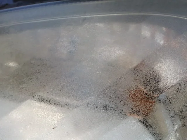

Well I'd been wanting to do this for a while now as my headlights were terrible, very damaged..
Pics don't show how bad they really were (taken with my mobile)
Before shots
They were one of the worst looking headlights I'd seen...
Method I used was similar to the guide on here, 1200 Grade follwed by 1500 grade then some Megs Scratch X with a Drill attachment..
Then a quick going over with wax to try and protect them

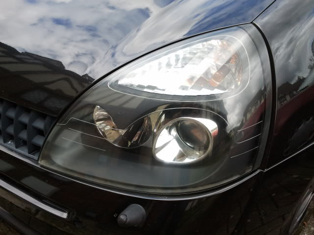

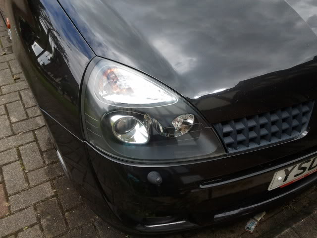

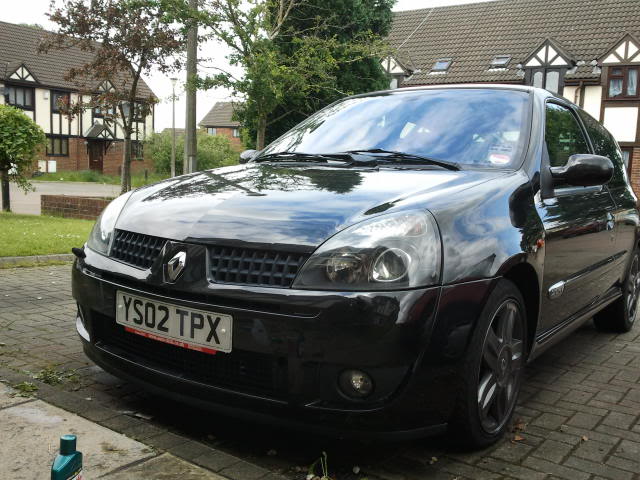

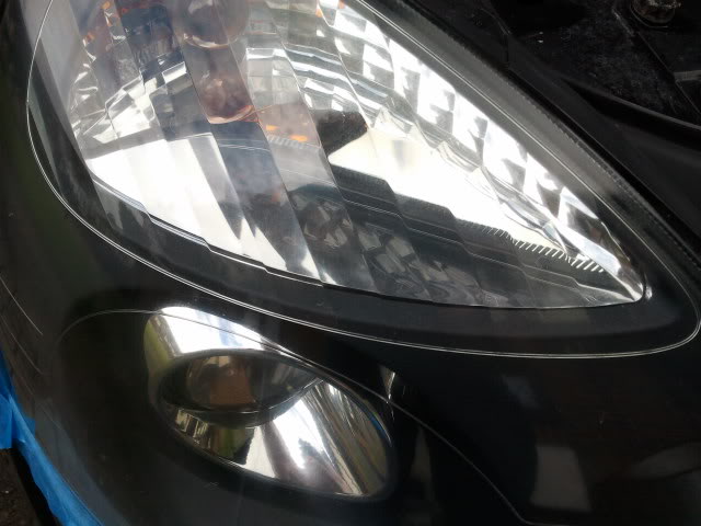

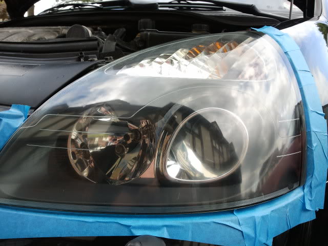

After shots
I'm VERY happy with the results, they are not 100% defect-free, but for a first attempt I'm chuffed... They look a million times better than before and make the car look much cleaner...
