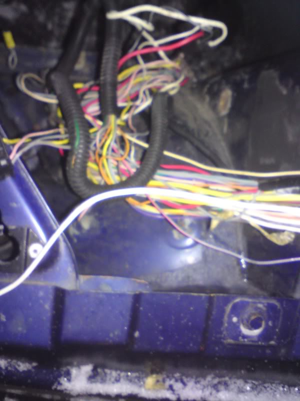

hi, im busy fitting a 172 engine into a mk1 1.2 clio shell. i have took the engine out of a clio williams shell.
when i go to start the engine it turns over but there is no fuel, cant here the fuel pump running either.
i noticed in the williams shell where the engine loom joined interior loom it was connected buy a large brown plug, + a white wire from a relay on the 172 loom was joined to a wire on the williams interior loom. does anyone know what this wire is for? as there is no matching wire on the 1.2 interior loom to splice it into.
pic of wire on williams loom, may not be much good.

From what i was told when i was doing my conversion, you need to run the full 172 loom(inside/engine)
The white wire is probably the fuel pump live...
You dont need to run the 172 interior loom at all, we haven't...

had the car started with easystart today so i know its sparking. still not getting the fuel pump to run. i have getting the brown wire from the fuel pump relay wired up now.
i noticed there is another wire (number 2 on relay), it seems to be grey coming out relay then changes to black within 10mm, this wire is not attached to anything. on autodata it says the the wire from pin2 on the relay is violet and goes to pin 9 on the ecu, but there is already a white wire into pin 9. does anyone know where this wire from the relay goes?
  pulsar gtir, astra sxi
the 1 that is on the 172 loom. it had 2 cut wires on it. i have 1 wired up but theres a wire from pin 2 on the relay that im not sure where it goes.
