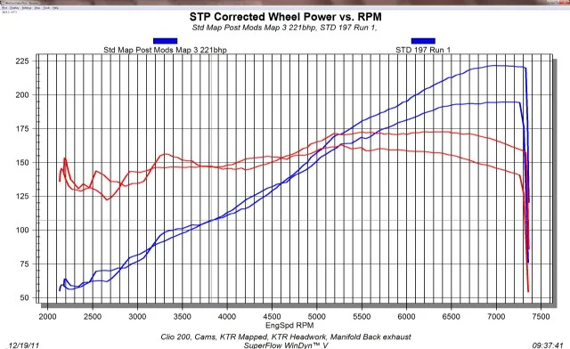

So why would there be loops on a rolling road graph like below?
I would suspect they have come off throttle for a moment and then foot back down again
That's what I first thought, either a throttle drop off or a throttle blip, but the RPM does not seem to correlate with the power figure in any way?!
RSTuning
  R35 GTR
How and where the car is strapped, rpm the run is launched, how long you keep load on the car before letting it go and i also see on some with decats or cams a missfire causes it to do the above so it could be in the mapping too.

To explain the loop at the start of the power graph, for this particular run method you need to set the record parameters for the run. We usually start at about 29mph which is approximately 2000 rpm, you then set the max speed to record for example 105mph.
You then drive the car in the selected gear to under the start threshold, then tell the dyno to start recording. The dyno will allow the car to accelerate to the predetermined start speed and hold the run until you are ready to accelerate. You then release the hold and the dyno maintains the accel rate to give you your run.
The loop section will be where you accelerate at the start of the run and before you release the car for its run, the PID loop will attempt to maintain the speed at 29 mph, of course this will in fact allow the car to go slightly past the 29 mph and then pull it back to the correct speed... this is where you will see the loop on the recorded data. Of course in the real world this is not really there, it's simply a by product of the dyno control system and recording function.
Not every dyno run will show this loop and it does depend on how long the car is held back on the rollers before the run starts. However the aesthetics of the graph, particularly at the start of the run don't normally cause any discussion as its very commonplace for graphs to show odd data at the start of a run. This is true for pretty much all rolling roads and recording methods. I hope this explains the anomoly.

That run was launched at about 1000 rpm where the graph starts so I really don't know how you expect the above to be a valid excuse?
If you can't feel an issue on the road between 2 and 3 on that car I would be VERY surprised tbh

Glad you are happy but this isnt about ktec's work or mapping, it's about the messy dyno graph. If it drives ok on the road i stand by the first comment of operator error.

As explained this was an anomaly we saw on a handful of occasions on our old dyno, not just on a couple of tuned cars but also on few standard cars (only N/A eninges). Now whether that was down to how the dyno was being run or some other cause of flaring up we will leave that to you to speculate about, we would have been happy to have an open/on topic discussion about it but that never seems possible on this forum. Openly comparing and discussing results/gains from other tuners on the same products can very interesting, as well as informative but it doesn't look like that will happen, unfortunately.
The graph shown was used by Cat Cams to promote the 402 cam profile as they fully understood the non relavent nature of the spikes. As soon as we have a suitable graph from our new dyno it will replace the current one (all the other cars that have had cams have also had other work so their graphs would not represent a true before and after plot of just having the cams fitted). We will also make many more dyno graphs available to people to study this year as we will be introducing a Dyno Blog on our new website later this month which will be updated on a very regular basis with the latest results from the dyno.
As ever, we are just trying to be as open as we can as that is how we work. I am sure we could have photoshopped this original graph in 5 minutes to make it look "neat" but we would have just been lying to ourselves, as well as potential customers and that is not the KTR way.
