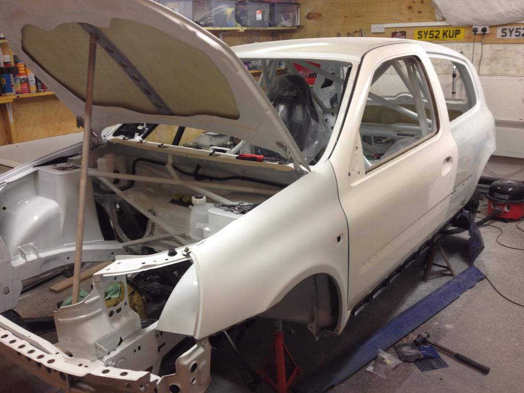

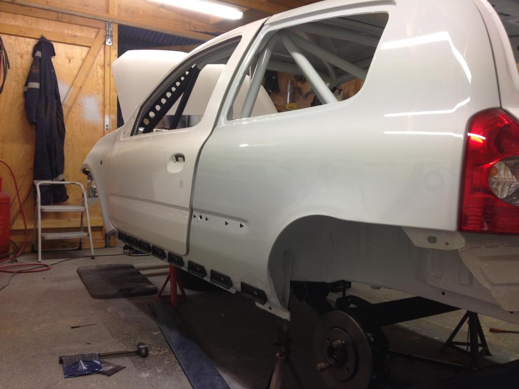

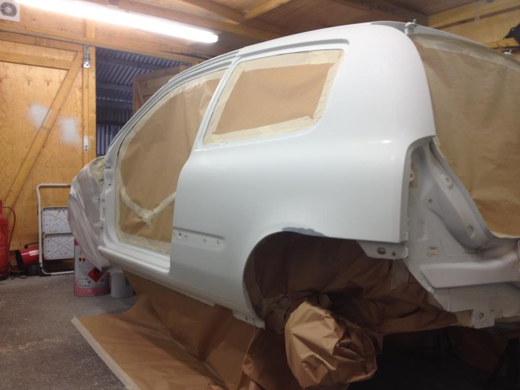

Shell ready for paint a few weeks ago when it was mad hot

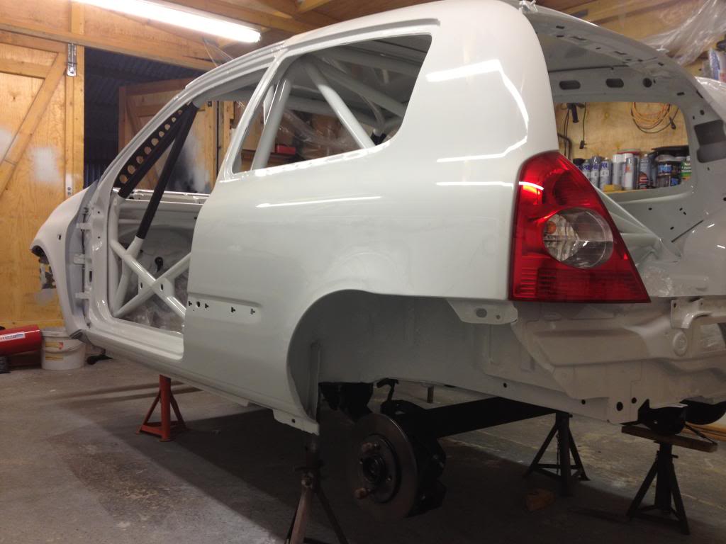

And as it currently sits painted and polished up, not bad given that it was done in a shed, there's only one wee bit that's not 100% but unless I pointed it out to someone they probably wouldnt see it and besides, it's a race car! few stickers, jobs a goodun!

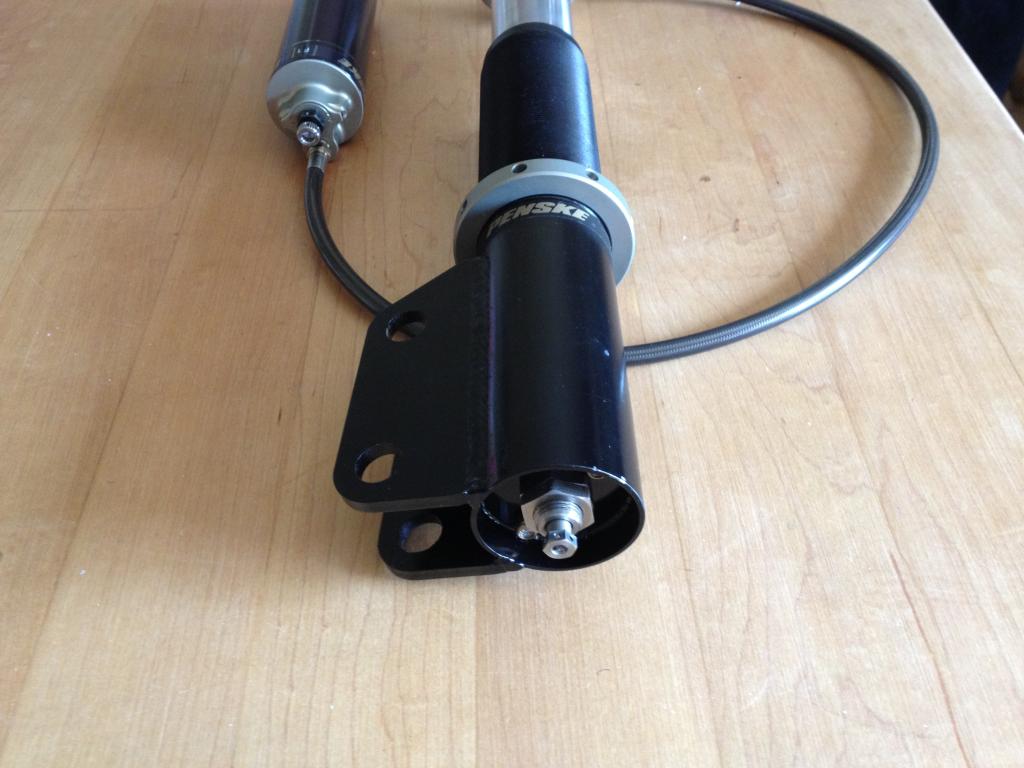

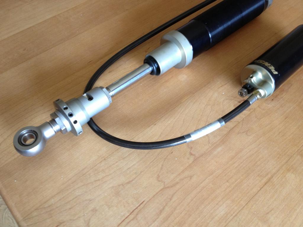

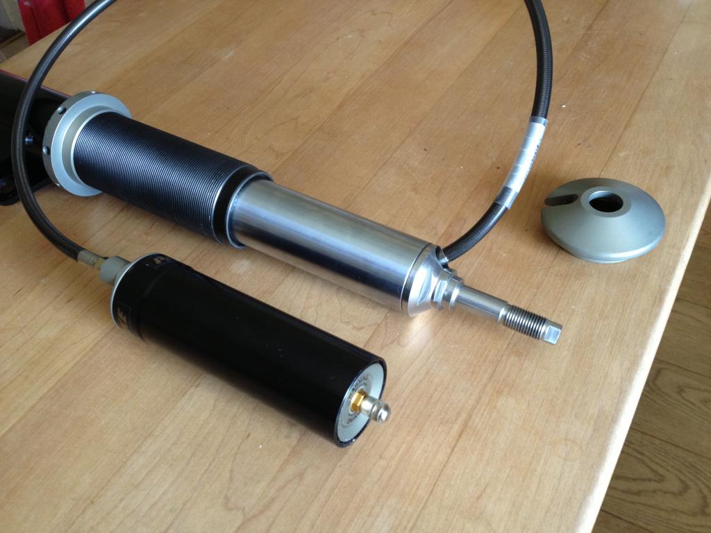

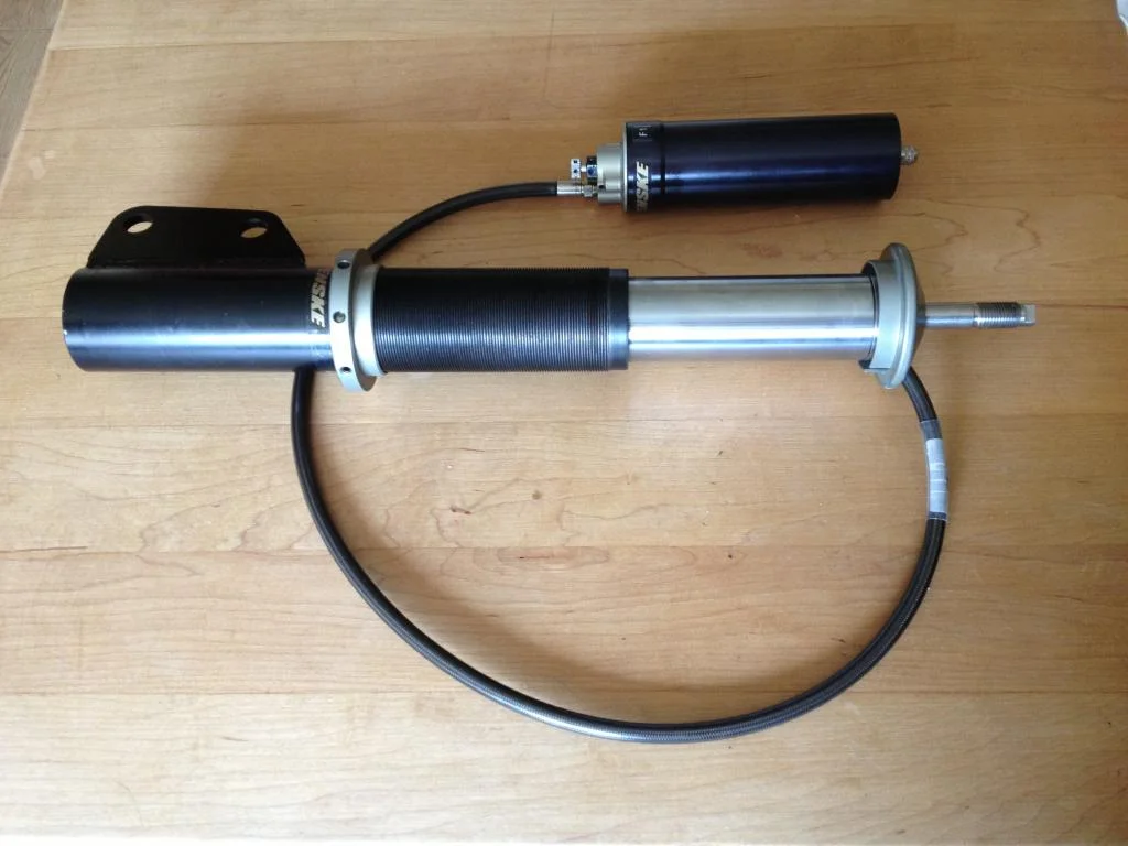

Some suspension pictures just for you Mark ;)
They're all 3 way adjustables and for me the major bonus being that they are fully serviceable in the UK, the guy i've been dealing with has been superb.

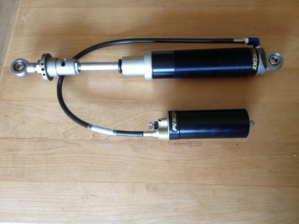

Rears:
Very Similar design to the Cup Racer Bilstein's but with a different upper mounting point. I'm getting some clevis's made up which bolt through the original damper mounting point. An M10 bolt then goes through that with some spacer/sleeves in the spherical bearing to bring the bore down to suit.

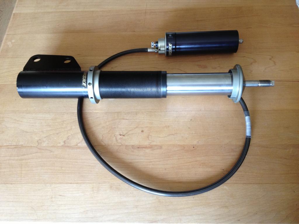

Fronts:
Again, these are essentially a copy of the Cup Racer Bilstein's, but with a slightly shorter body. Supplied with adapters to suit my top mounts.

Very nice Kenny, is that off the shelf stuff that they have pieced together to suit a Clio or full custom?
  Audi A6 & 172 Cup
Bit of both,
The front cases are custom but use standard internals, top pin and adapters machined to suit my top mounts.
The rears as you can see have threads on the outer case so the body is being used in a different configuration to suit a 36mm spring, the lower spring seat and rod eye mounting is all custom.
They were made using mostly new old stock, ie last years design. The big teams want the very latest stuff so they were able to do me a pretty good deal on these. Still expensive but worth it in my opinion.

Wasn't aware the cup ones were known to break but having looked at them I did think the rod end looked a bit puney. The fact it was in single shear wouldn't have helped either, as it may be subjected to flexing.
The lower rod end on these is pretty chunky and is based on a design they did years ago for another team who ran them with no issues so hopefully be ok.
  Cup In bits
You should be fine they look a lot more substantial, the r-sport stuff is only 10mm max. I'll probably upgrade if the KH chicane doesn't like them.

At the moment we're thinking something in the region of 400 front and 500 rear but that may change. The valving is as such that I could potentially go a fair bit stiffer or softer than that, its fairly easy to have them changed should there be a big change in the spring rates.
Initially I'm going to be on small tight circuits and sprints so may opt for softer springs.
  Audi A6 & 172 Cup
Yeah, aware of that Tony, as mentioned, with the current valving there's a fair bit of scope to go up or down from the rates mentioned. I discussed the use of the car at length with the guy at Penske so he was well aware of what I was using it for, once we get some seat time in it and a base line for what works or what doesn't! we can alter the valving to suit.

I was aware that you would have looked into it Kenny, just I know what it's like once you start playing around with stuff, sense can sometimes go out the window.
Strange rate as the rear dampers give 1-1 wheel rate in there position? usually you go for spring rate proportional to the weight distribution front and rear. So if its 60/40 the 600F and 400R for example as the starting point...
  Audi A6 & 172 Cup
It did seem a little odd to me too at first but that's what's been suggested as an initial staring point.
Where the cup cars not along the same lines? ie really stiff at the back and softer at the front?
  Audi A6 & 172 Cup
Epic dampers Kenny very jealous! My rear dampers have a 1:1 motion ratio yet still have stiffer rear springs than fronts and seems good to me :)
You have a complete working car though! And working well, I've got that to be jealous of.
I thought you had stiffer rear springs than fronts, was actually going to ping you a message about it. Seems to be two different approaches to spring rates on fwd cars, instinct would say stiffer springs at the front but a lot of folk now seem to be going for stiffer springs at the back. The guy at Penske did explain the logic behind it a wee while ago and it made sense at the time, but too many beers tonight to type it! Lol

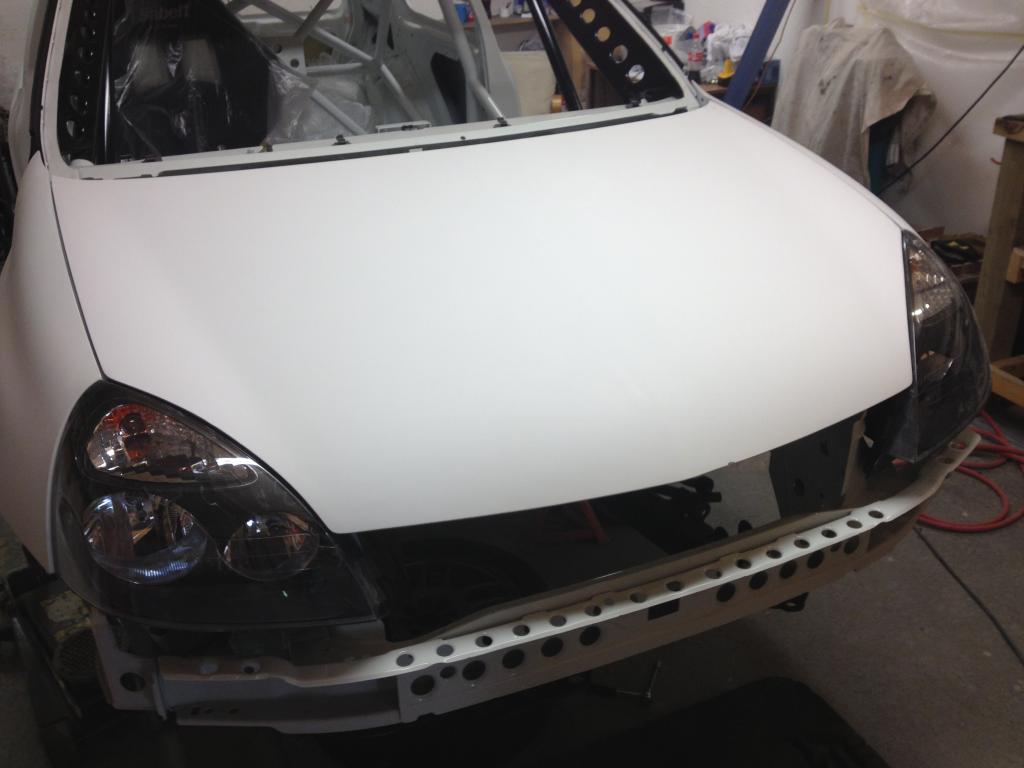

Today has been mostly about fibreglass!
I got a bonnet and tailgate from MC racing in France a few months ago, and a pair of doors from CMcomposites during the group buy.
The bonnet fitted surprising well, only needed very minor tidying up along the edges.
It's got no inner skin to speak of and the outer is quite frankly stupidly thin, I guess they were going all out for saving weight! so I cant really complain as it is very light.
Only minor issue was the middle of the bonnet would pop inward with very little pressure so I decided to add a small stiffener, made from a bit of folded ally, etch primed and then bonded on with some sikaflex.

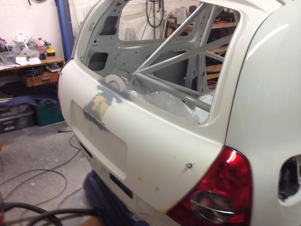

The tailgate wasn't quite so straight forward! It was the wrong shape in that it had too much of a curve in it and the edges had been trimmed back too far and the gaps round the lights where huge, granted it's a race car but even then it was still shockingly bad.
So a few hours of cutting, shutting and filling had the profile sorted and then buttered up the edges with some fibreglass, also filled in the lock recess.

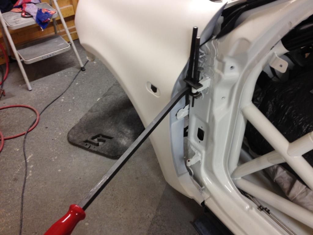

The fit is pretty good but I have noticed the top corner catches on the edge of the roof as it's closing. Once closed however, the gaps all look pretty good so it seems it's just the door sagging slightly under it's own weight?
I've tried adjusting things as much as I could but the only way to stop it is to set the strike plate a bit high so that it lifts the door before it touches the roof. The alternative is to either trim the edge of the door back a bit or bend the hinges on the A-pillar foward slightly.
It's understandable for a fibreglass door to sag a little, just wondered if anyone else with these doors has noticed this?
I have a set of Kevlar doors and they catch the roof slightly too, I removed the door rubber trim to get them a tad closer. However I will see how I go with that.
My GRP bonnet had the inner skin on them, funny how them ones dont have them. Looking good anyway fella.
  Audi A6 & 172 Cup
Resorted to plan B
Had to get pretty brutal with them, but it worked a treat, both doors now close as well as can be expected. It was the A-pillar that gave before the hinge!
