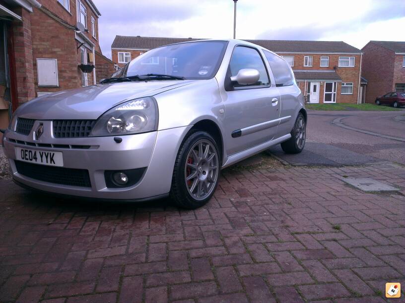

Here's how the car looked when I first brought it home.

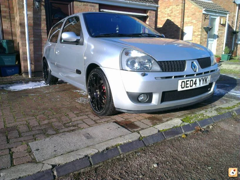

Then I gave it a clean, and got some black side bullets.
Ordered some Turini wheels, while I was waiting for them. Thought I'd take the carpet under the bonnet off and polish it up. Took the silly grill covers off as well.

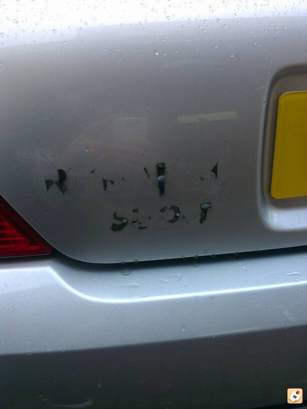

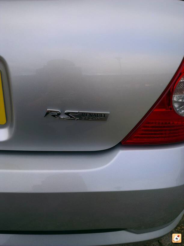

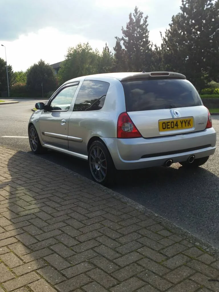

Debadged the rear, and got the RS badge.

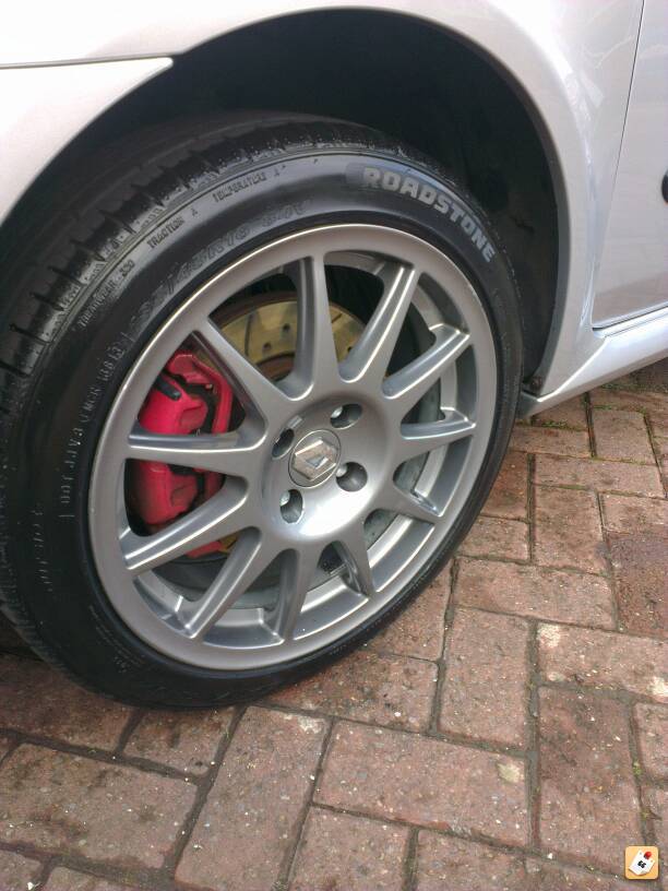

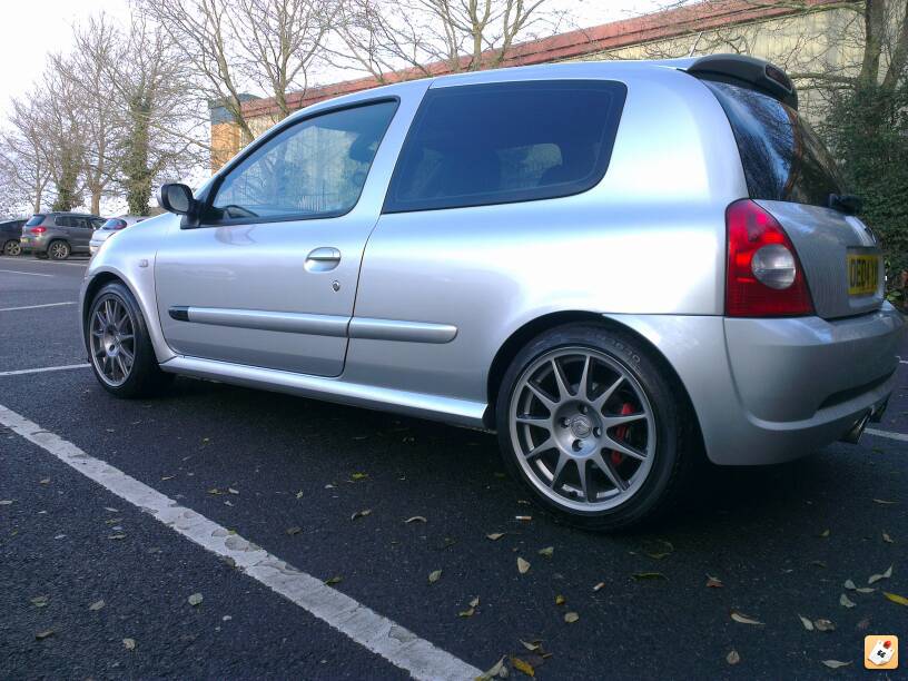

Here's the car with the Turini wheels on! Got some budget tyres for the time being as the ones it came with were completely gone!

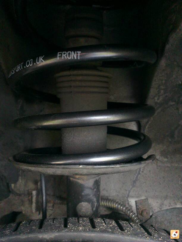

Cooksports. Emailed them about 3 times asking when they were getting them, didn't get one reply. So after some waiting they finally come up, so ordered them and got them fitted a week later.

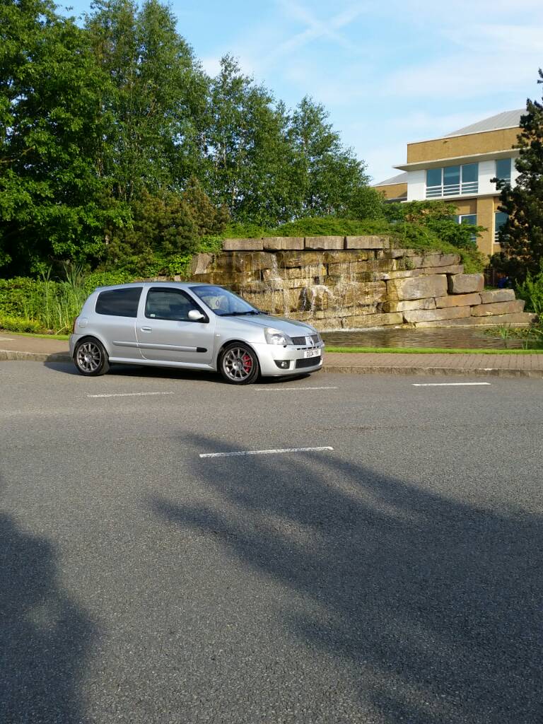

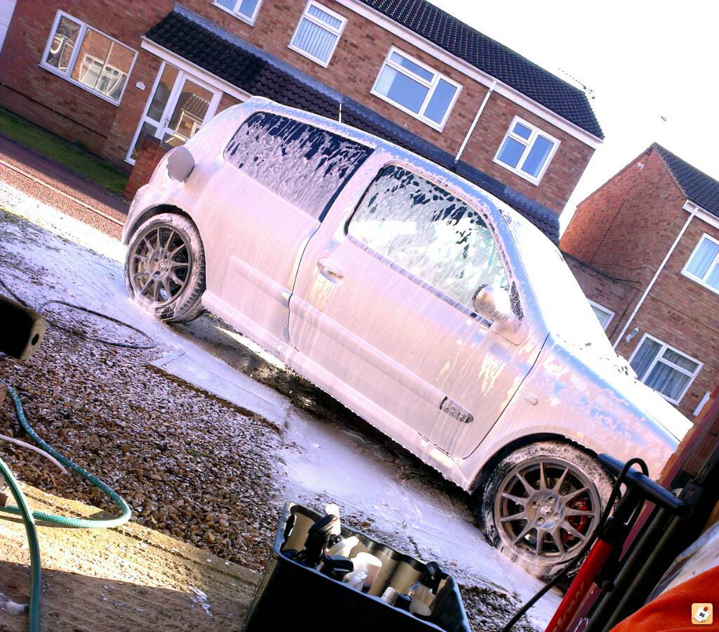

And today the sun was out! Gave the clio a clean.
2 months on and this is how it's looking, very pleased.

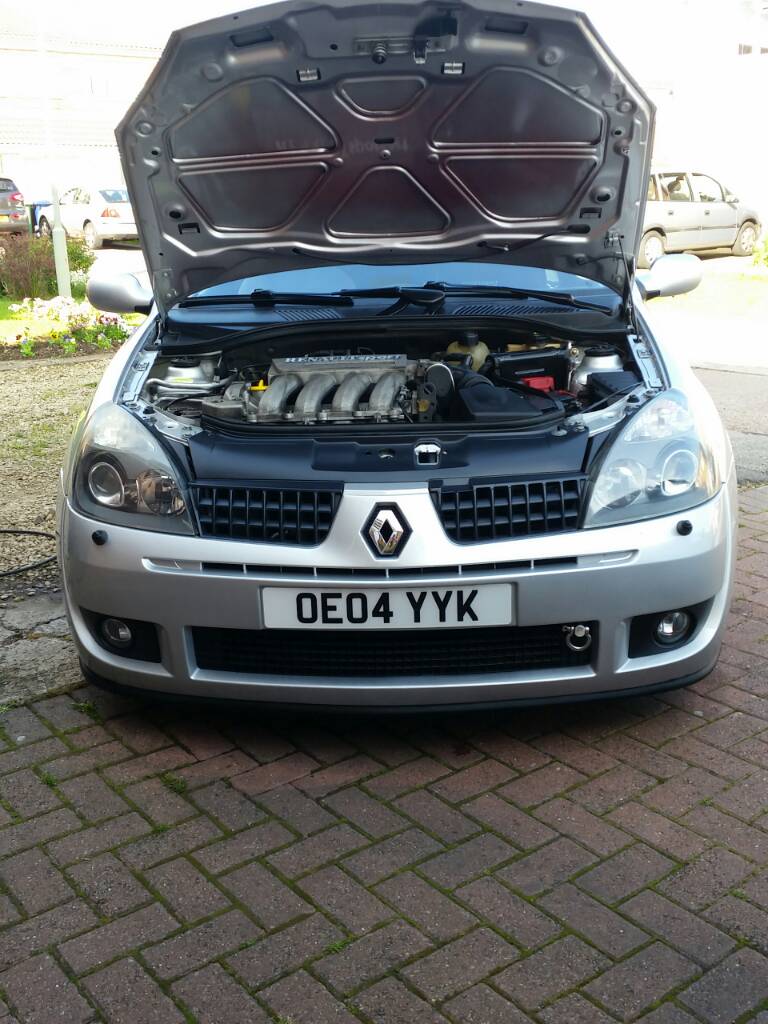

Next I want to concentrate on my engine bay.

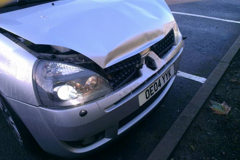

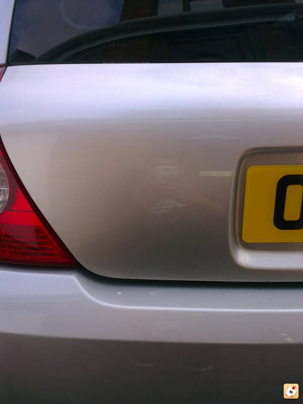

20th December last year I unfortunately went into the back of someone which left the car on the drive like this
Luckily it was only minor. Fell completely out of love with the car and was so close to selling it.
Brought all the parts needed off here got them sprayed up and not long after the car was back and I was loving it.

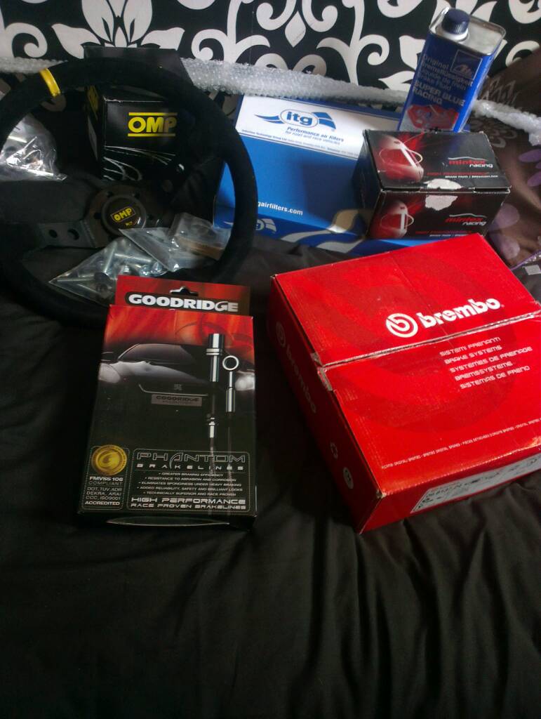

I brought a bunch of stuff for the car.
Whiteline RARB
M1144 front pads
HC front discs
Superblue brake fluid
Braided brake lines
15mm rear spacers
Wind deflectors
Deep dish wheel off eBay
ITG air filter

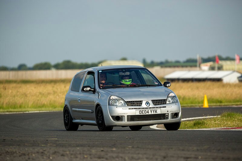

So my birthday had just gone end of May and the girlfriend had booked me FCS with the 2 hour track session in the morning. Had such a good day and I definitely caught the track bug. The show however wasn't for me, so track days it is.

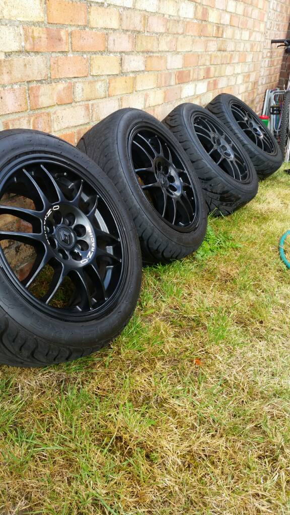

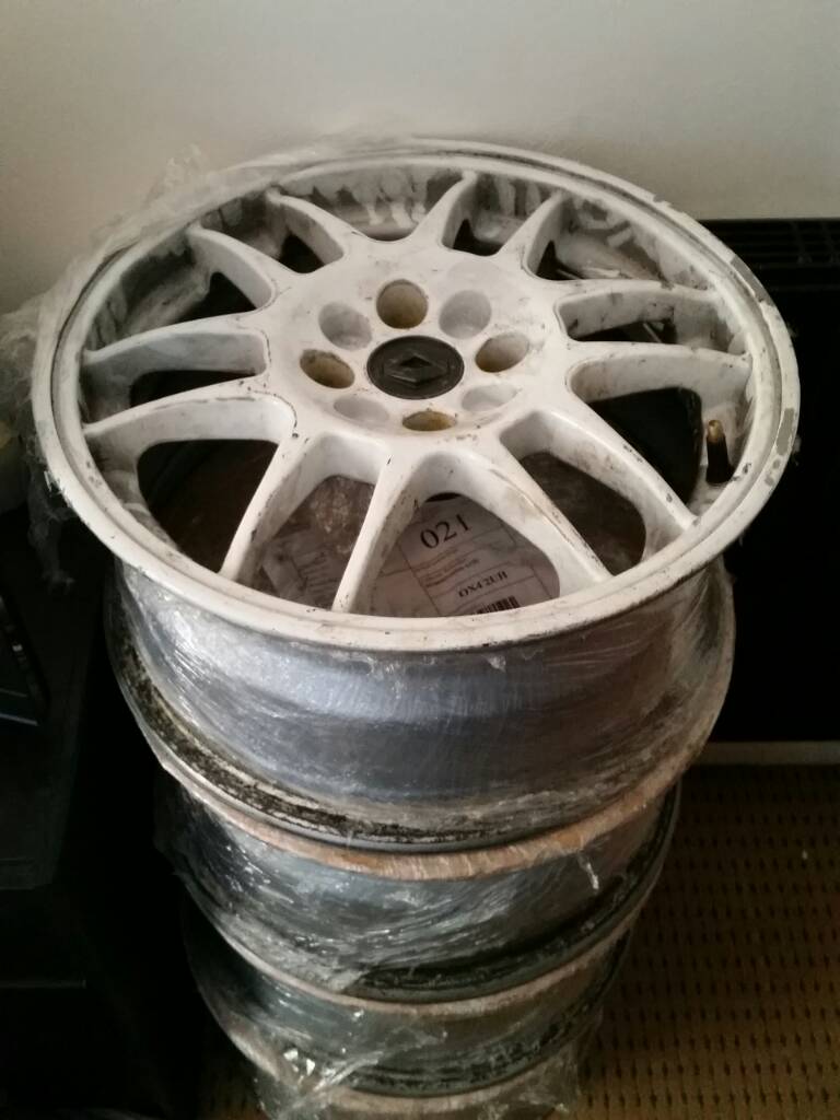

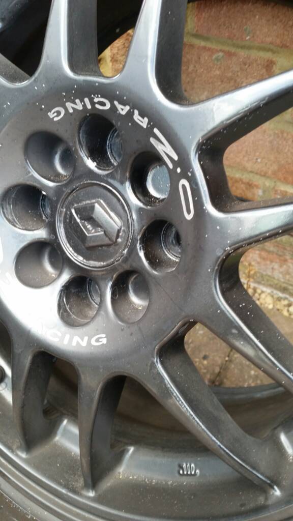

I got home and ordered a set of OZF1 wheels from someone on here.

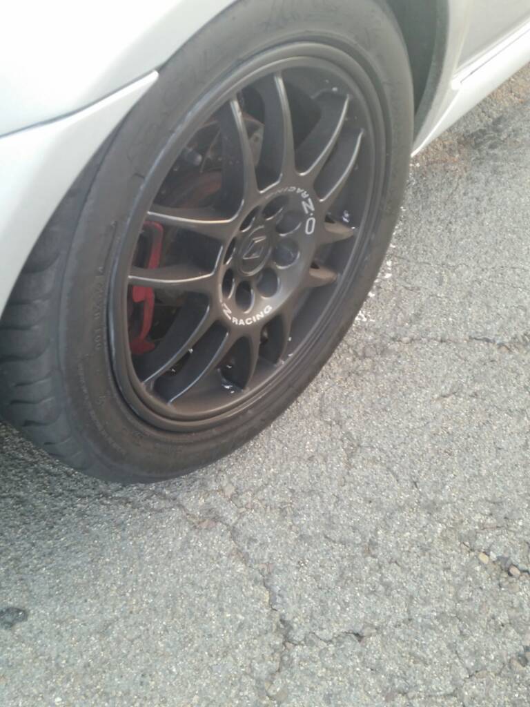

Phoned a few places for a refurb, but they were far too expensive so I decided to do the refurb myself which left them looking like this
I was happy with the outcome, payday was just a week away and couldn't wait to order up a set of rubber for them (by this time I had booked renault sport day at bedford)
Decided to go for the federal RSR as the SDrives weren't amazing. Straight away the RSR's felt amazing and I was happy with how the car was sitting
Day before bedford I had topped up the oil, coolant and fitted a rear strut brace. The strut brace done absolutely nothing but I cannot be bothered to take it off. (My excuse is ill wait till I get some coilovers).
Besides the awful standard brakes, the car brilliant and handled so much better than it did at Castle combe (FCS)

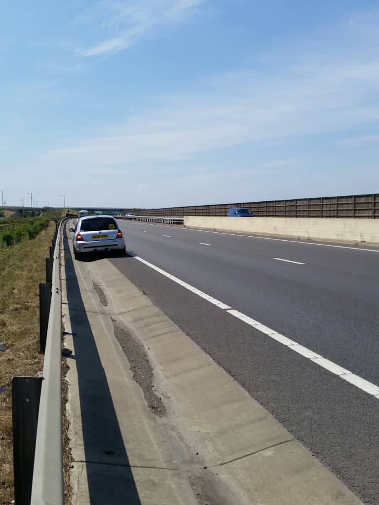

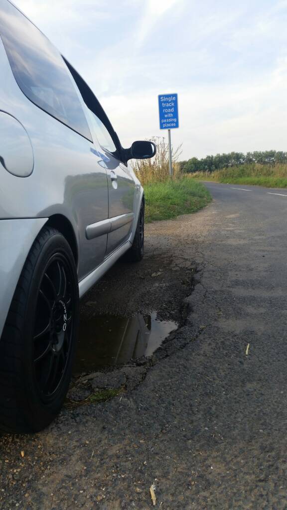

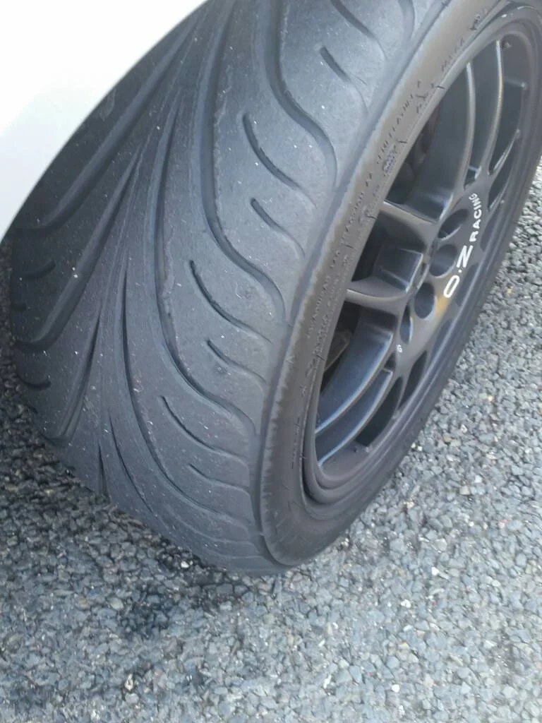

Unfortunately, on the way back to the hotel the front left wheel had locked up going along the bypass. Luckily it wasn't busy. I got out and the wheel had bent in towards the car, 3 bolts snapped and 1 bent just about holding it on. Rather embarrassingly a few of the other cliosport members that were at the track had drove past. My first thoughts were the garage hadn't tightened the bolts properly, but a member on here had told me I should've checked the bolts at the track as they become loose.
My thoughts were the hub! But the garage said the hubs fine and got me back on the road and I managed to drive the car back to the hotel, however the next morning on the way home the steering wheel was shaking like mad! I decided to pull straight over and ring the AA.
Not the best of places to pull over but I'd rather pull over there then carry on and the wheel lock up again. Anyway, 6 hours and one moody missus later we were home! Car is sat on the drive way now, F1 wheel has been brought from a member on here, will refurb it and get it on the car ASAP.
Had a lot of plans for the car after seeing some of the ones at bedford. Saftey devices, buckets, etc.. now I'm thinking get the wheel sorted and eventually get the pads and fluid on, do a few more track days and get a megane r26 or CTR FN2. I will see where the 182 takes me.
Had an amazing time at bedford, it was such a good track with some good/friendly drivers

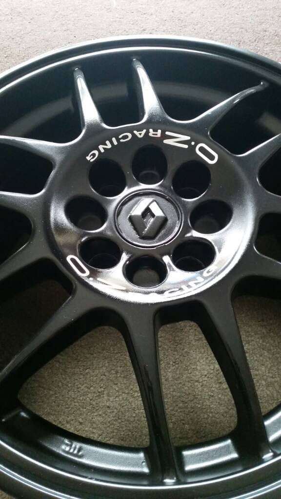

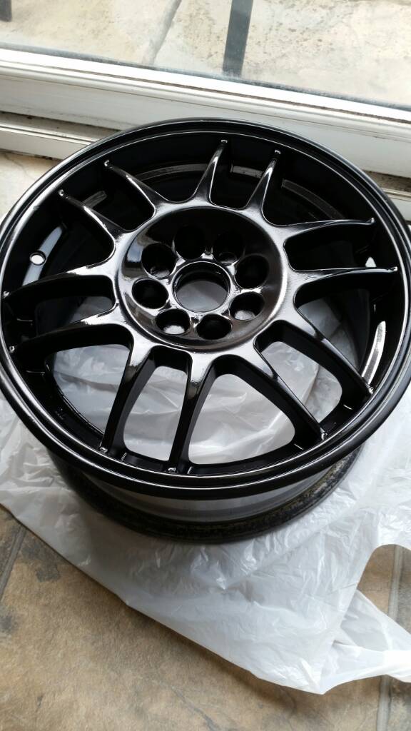

I've also got the new ozf1 wheel sprayed up, going to get the tyres changed tomorrow then refit it to the car.

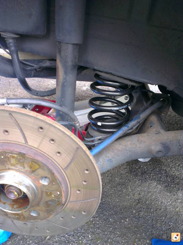

Popped round CUB's today, he gave me a hand fitting the Brembo HC discs and mintex M1144 pads. Only took a couple of hours, all round nice guy and the flamer was amazing. Loved it. Brakes feel a lot better to, will do a couple more track days then bleed the superblue in.

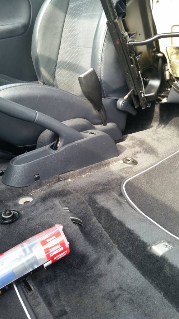

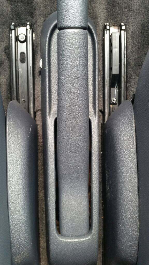

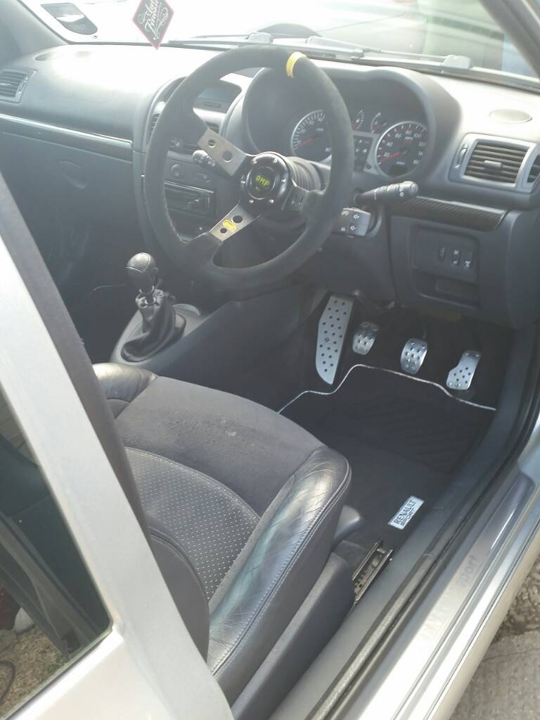

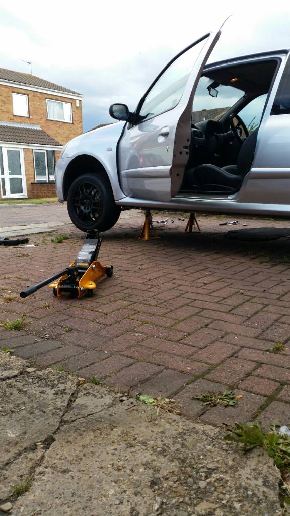

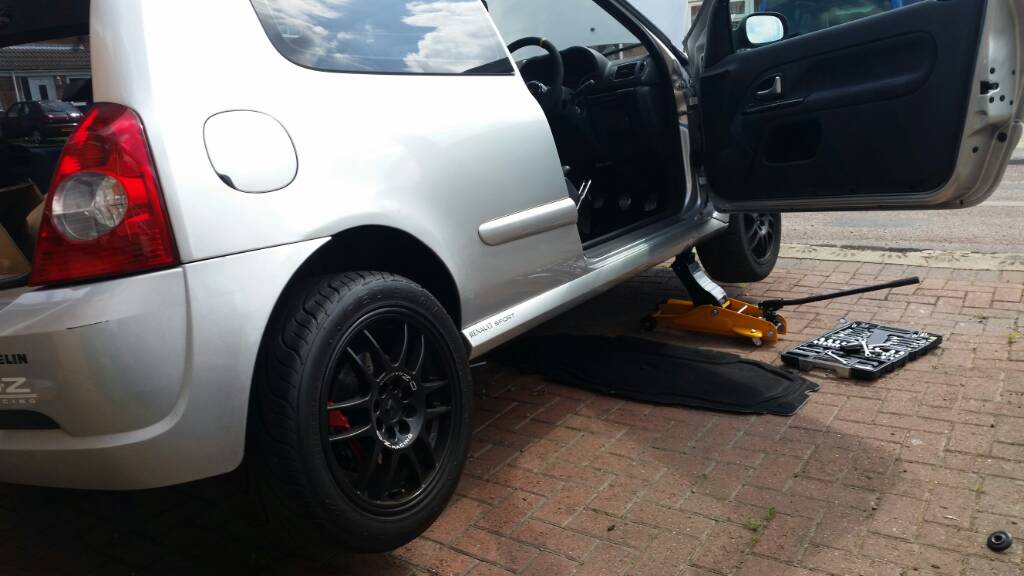

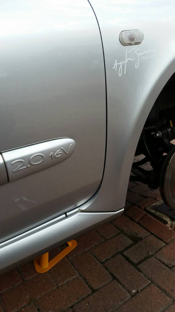

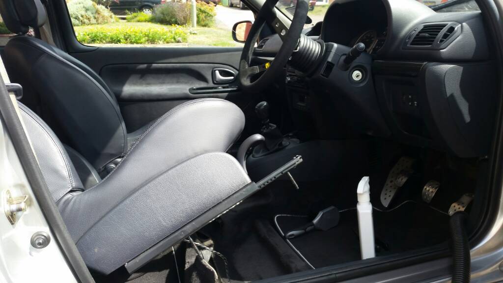

Brought a jack from halfords yesterday, jacked the car up and took the drivers seat out to remove the mounts to make it a little lower. Wasn't to hard just didn't have time to do the passengers yesterday
You can see how much lower the drivers seat is compared to the passengers. I'm pretty happy with the seating position now. This morning I got round to doing the passengers side, both sides were a complete mess so I got Henry out and some interior shampoo and cleaned it up a bit

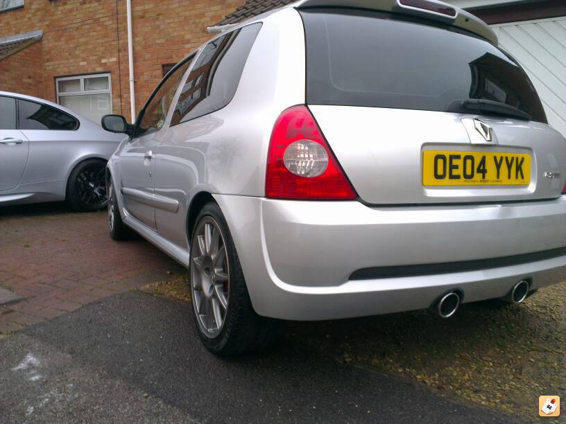

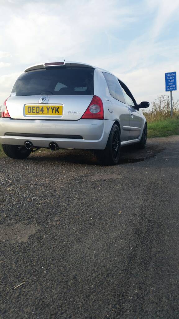

No pictures but the exhuasts weren't straight so I cable tied them up, sitting perfectly now besides the melted exhuast trims

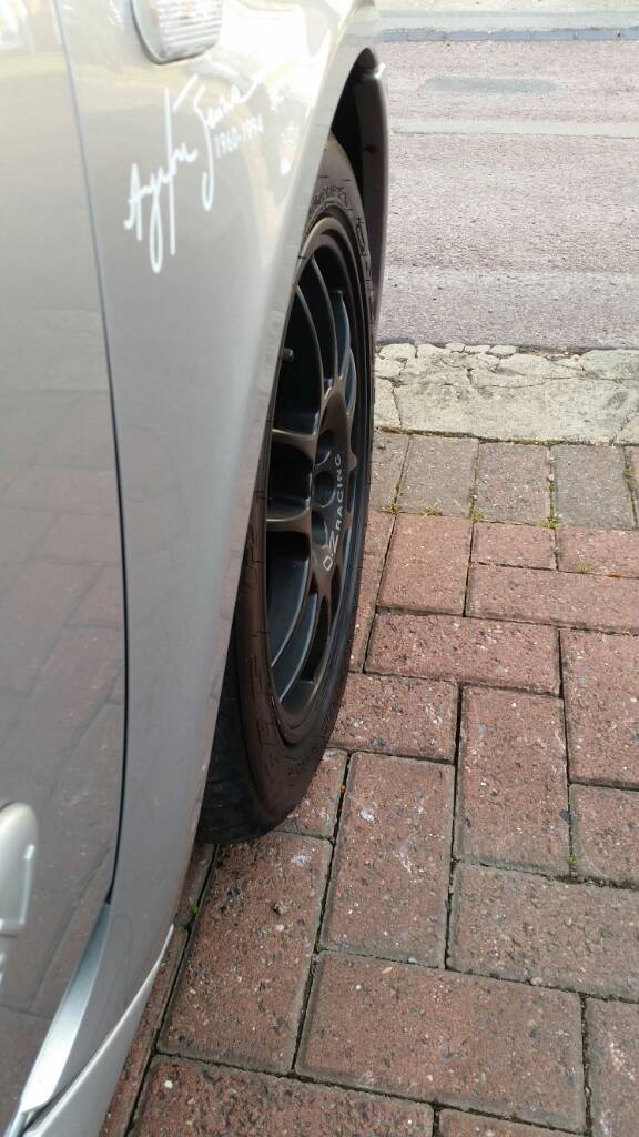

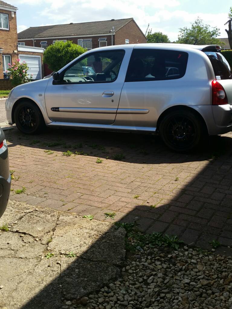

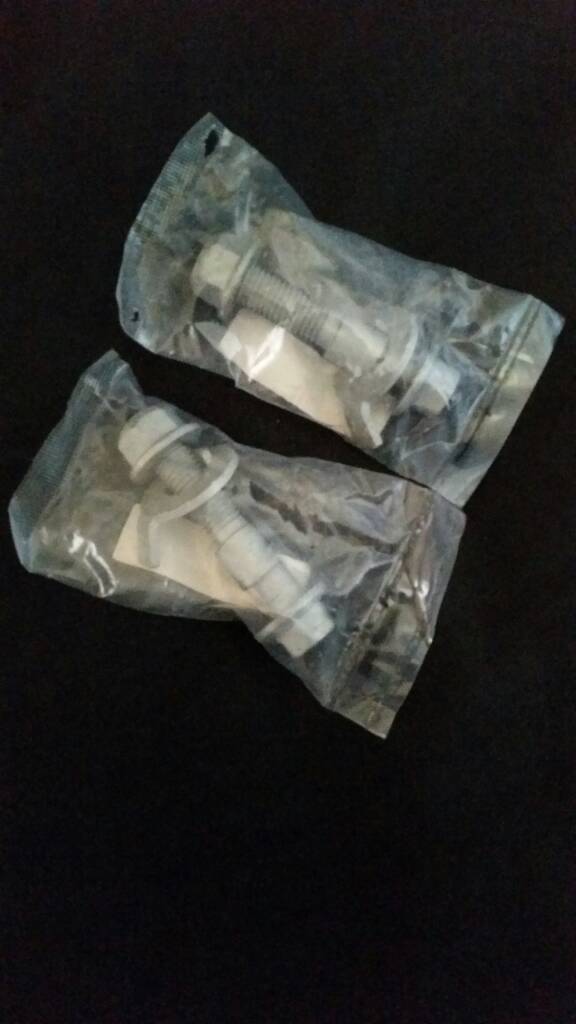

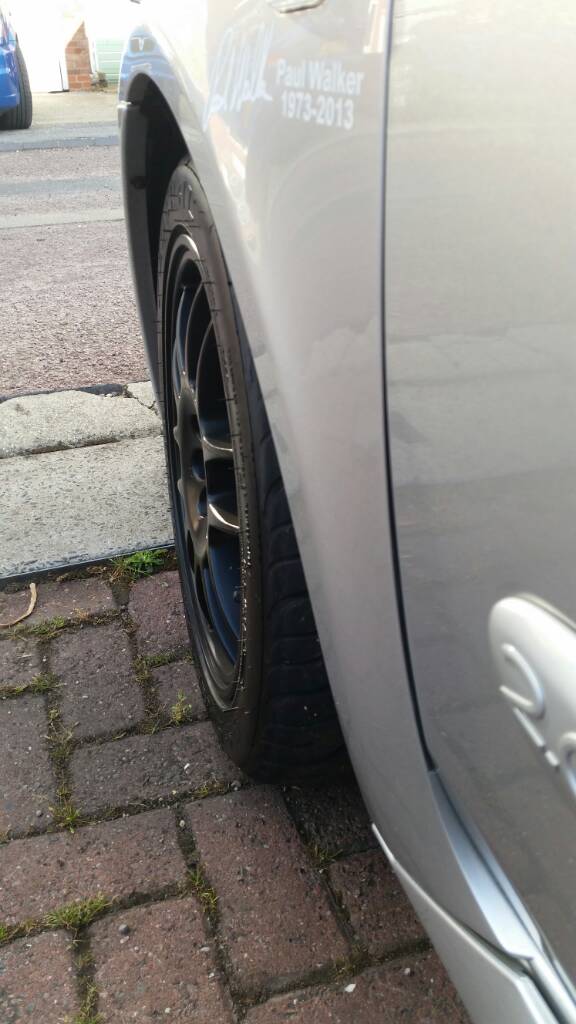

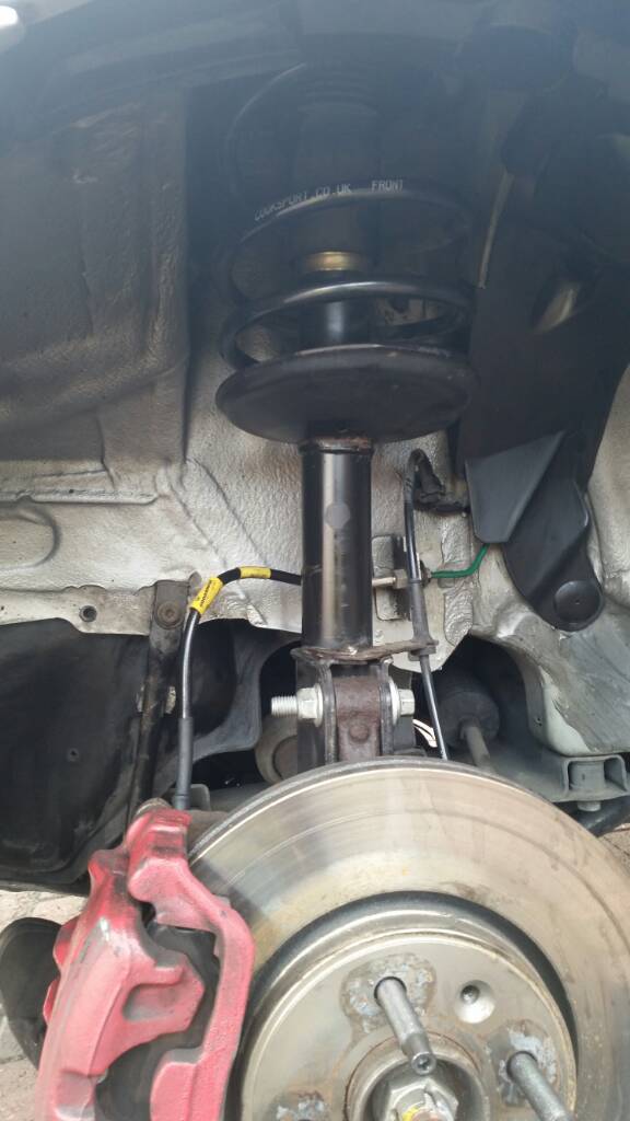

I thought I'd put the camber bolts in myself as I'm running low on money this month. Wasn't to hard, I set them at around just over -1 negative.
My poor wheels
Haven't gone and had the alignment done yet but I'll be doing that tomorrow at my local Formula One Autocentre. I'll ask them to set the camber to negative -2.5 and 10 mins toe out. Should hopefully feel the difference tomorrow.

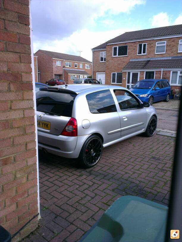

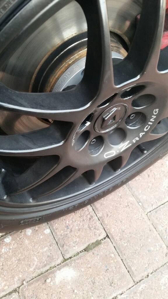

I've also sprayed up a spare set of side bullets I found with some metallic alloy paint lol! They came out pretty well tbh
So plans now are to get the alignment/camber sorted front -2.5 10mins toe out and rear just the standard . At the end of the month I'm hopefully going to go for a set of the bimarco futura seats or the experts. Recently I feel like I'm the stig in a tractor (6.4 110kg)
Then in September a suspension refresh with some bilstein B14 ☺

Coming along nicely mate, shame about the wheel bolts coming lose, however that's not the first time i have seen that and prob wont be the last either. Always check wheel bolts before and after every session, esp when wheels have cooled down, same goes for tyre pressures when heading home after a track day.
  RB197
Re: Titanium Clio182
Thanks mate, yeah it knocked my confidence down a bit. I'll definitely be checking them more often at the track! I still need to play around with the tyre pressure as well
Mate, I'v seen it happen to experienced drivers as well, things happen. Another cause of bolts working loose can be brake judder (causing vibration) and debris on the mating faces of the hub and inside of wheel mating surface, so always check those too when putting wheels on (even a road car esp a spare wheel) as this causes a wobble/vibration and again causes bolts to work loose.

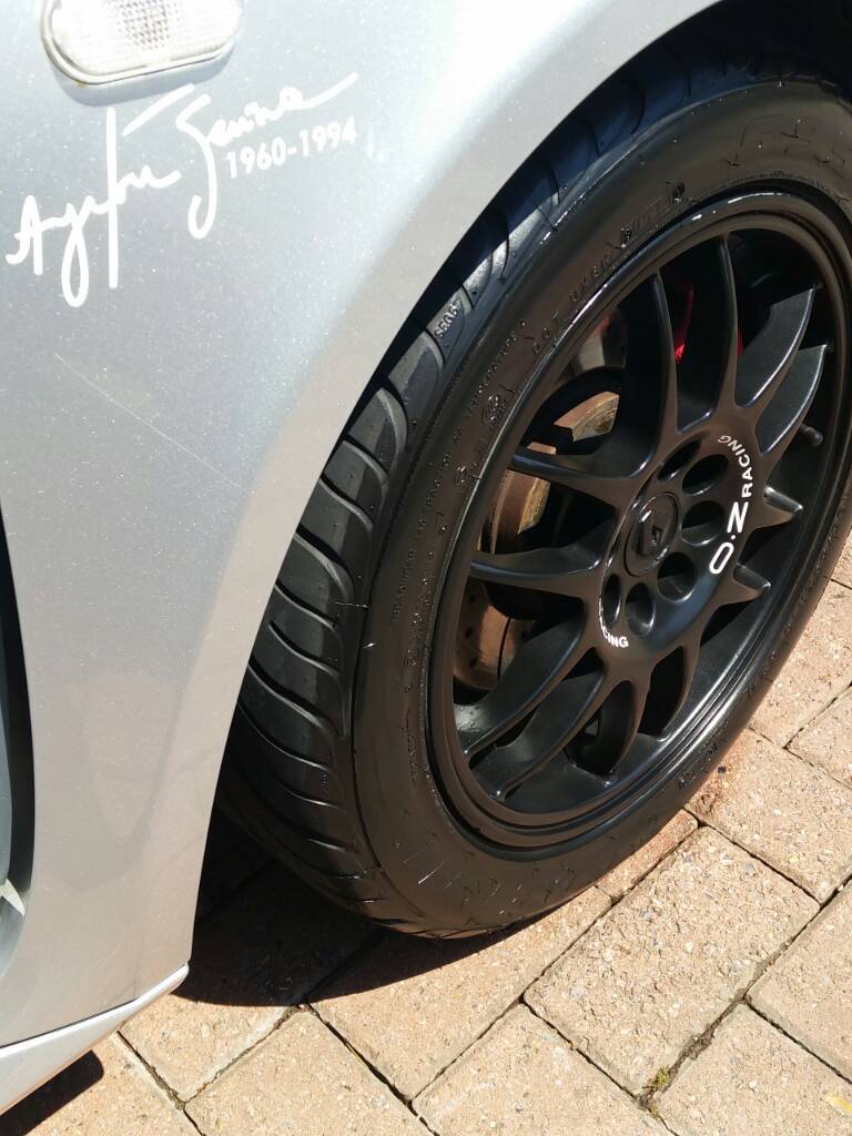

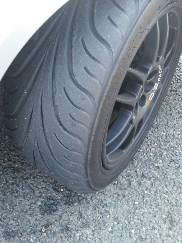

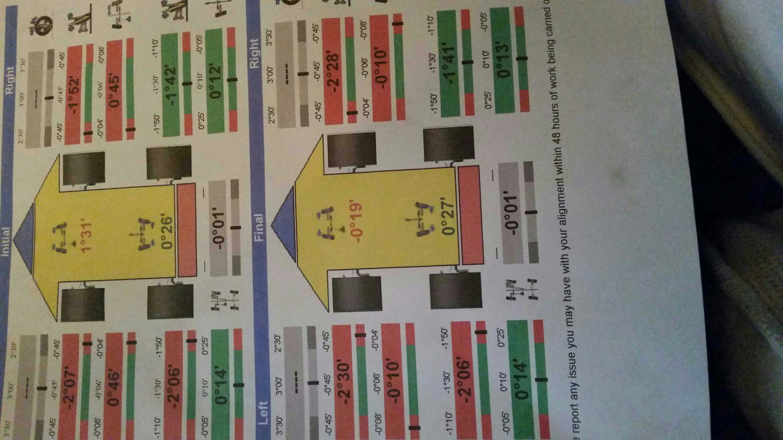

Alignment update-
Can see the size side bullets in those pictures above, look alot better imo ☺

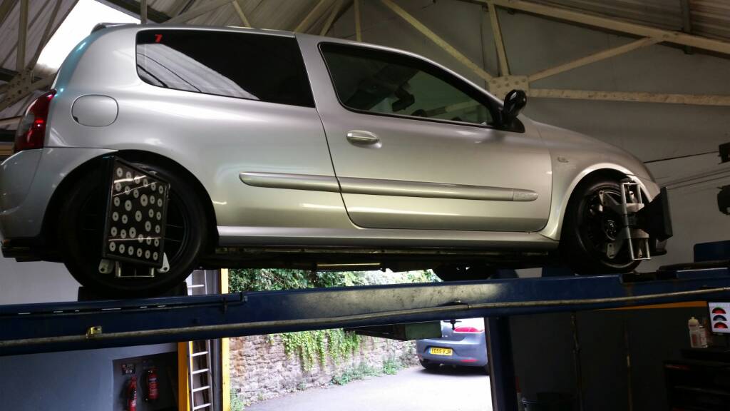

Went to a garage about 15 minutes away today for them to set the camber up and do the alignment, pretty friendly garage. I asked for around 2.3/5 negative camber at the front with 10 mins toe out and just the standard for the rear
Pretty pleased with the results for the front. Besides the rear, especially the passengers side not sure what's going on there.. Anyone?
Its not unusual for the rears to point in different directions. My rear right is 0.5 toe in and rear left is 2mm toe out.. Need to get some shims in there... The rear beam does flex and sometimes not even straight when leaving the factory. In some cases the stub axles can be slightly off too if knocked.
Ok cheers mate! Yeah might order up some -1 neg shims soon! Yeah i can't wait to get it out on track with the new set up and brakes ☺ doing an evening at donnington on the 29th

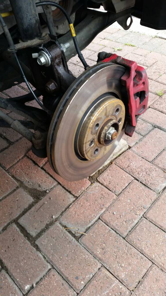

Good day today -

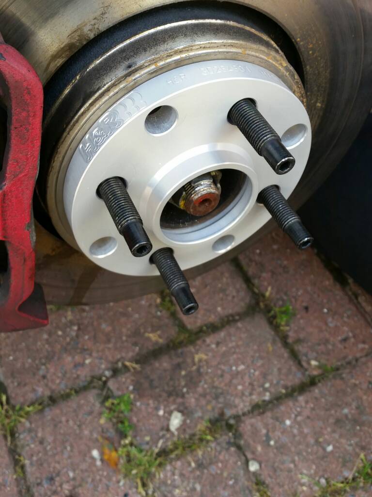

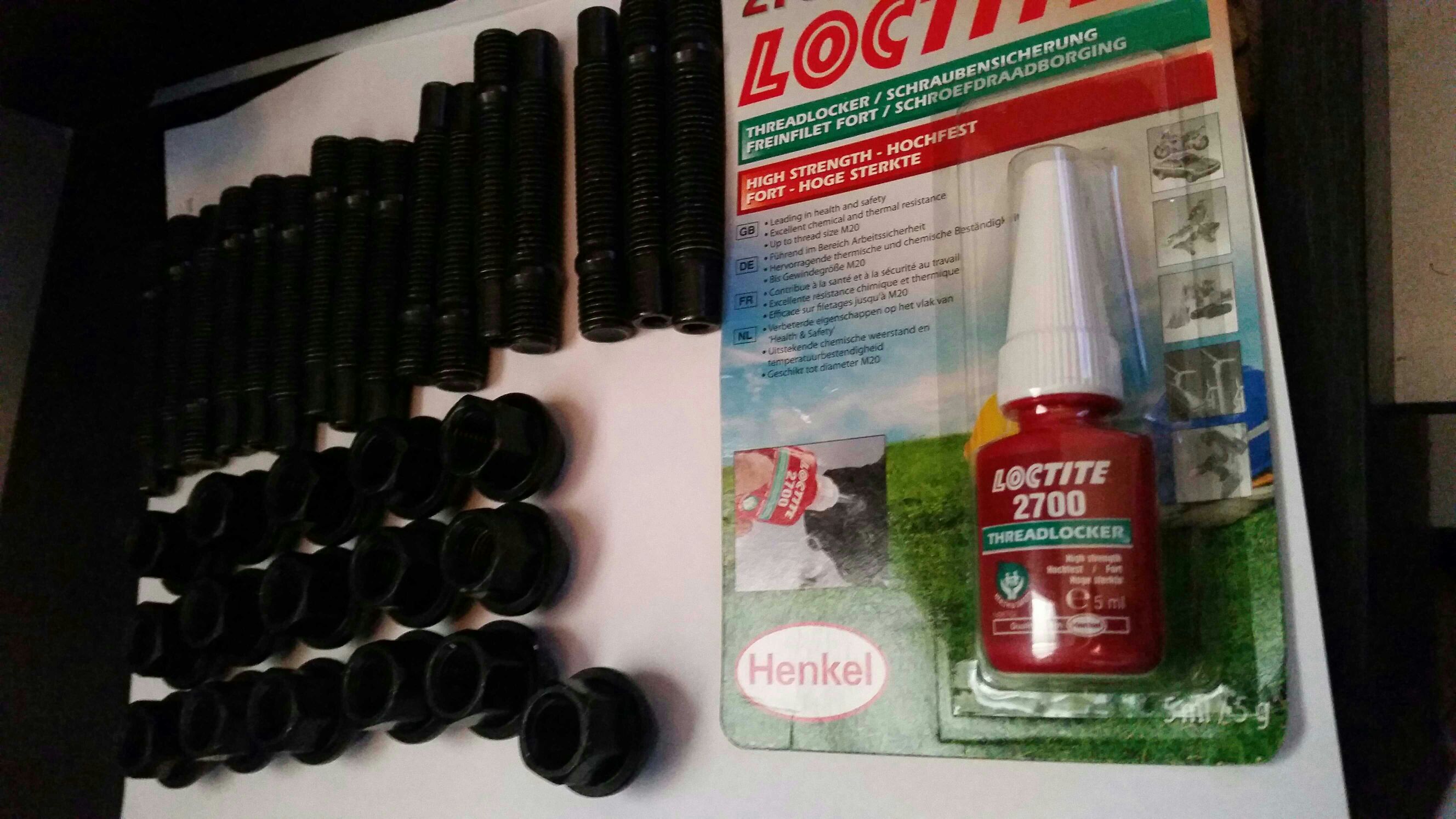

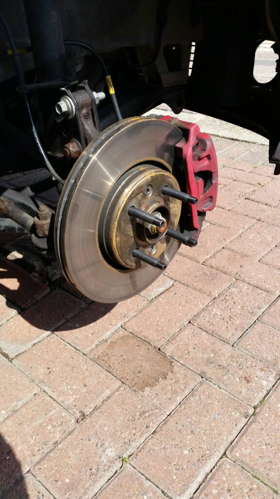

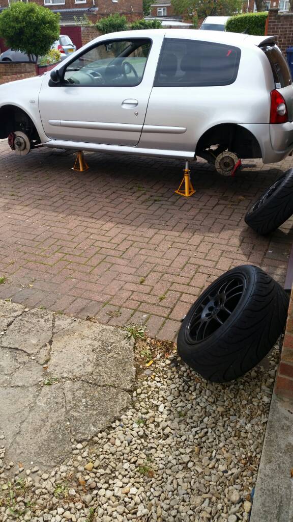

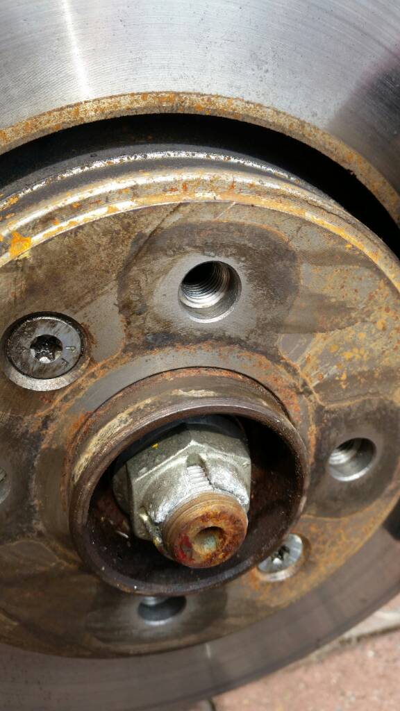

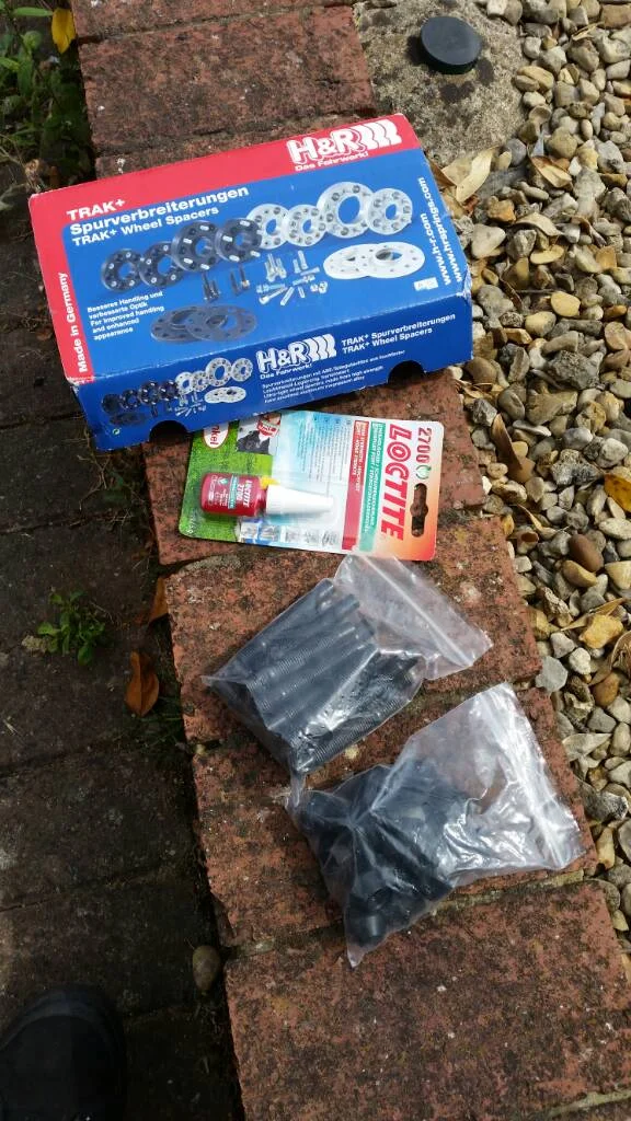

On mornings this week, finish at half 1 so got round to fitting the PMS stud kit and the H&R spacers.
Cleaned the thread holes out as well as I could with some brake cleaner as well as the short end of the studs
Since the wheels were off the car and whilst I had to wait for the loctite I thought I'd give them a quick clean and cleaned the arches out (quickly)
Waiting time over I put the wheels back on (sooo much easier!) torqued them up and went for a quick drive
Running 15mm spacers all round and it's a great set up! With the camber and aligment I had done the other day the car feels great! Wheels stayed on so that's also a good thing.
