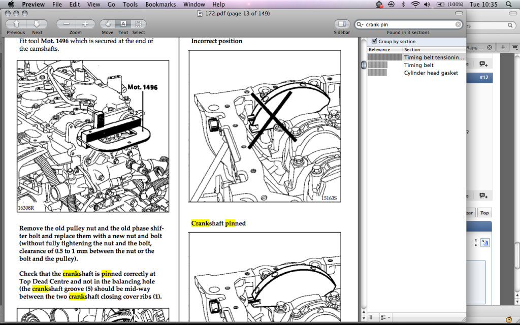

Easily done! As Dan says it will slot into a balancing hole or butt against the edge of the crank (depending which way you turn it) But its easy to get right if you turn it really slow and feel the pin into the slot. This may help clarify :)

where did you get that manual from chris?

I cant actually remember where or who I got it from (that pic was taken from another post) But I've got the PDF version somewhere, may have to check my external drive but it has the whole procedure start to finish. Will have a look & PM you.
cool if you can find it that would be excellent!!!!
