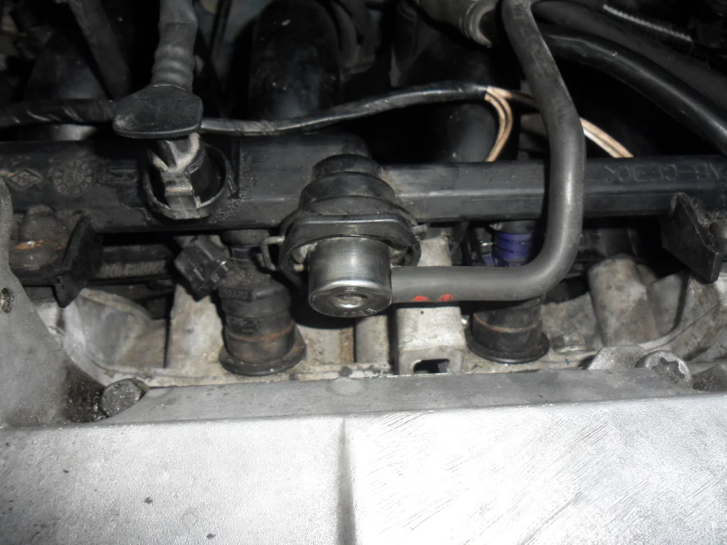

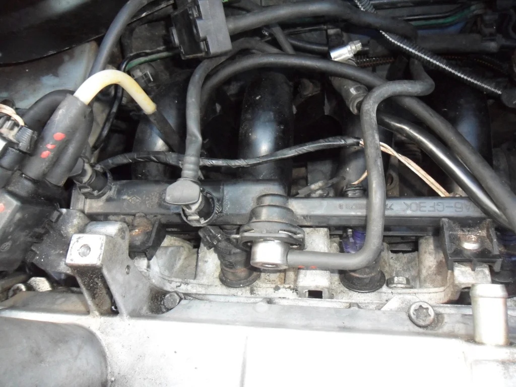

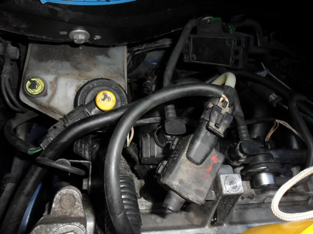

there is the pictures :D
  1.2 clio/clio sport
Nice one thanks ever so much its started first time, this is the first time we have done any think like this so its a big learning curve thanks again :D
