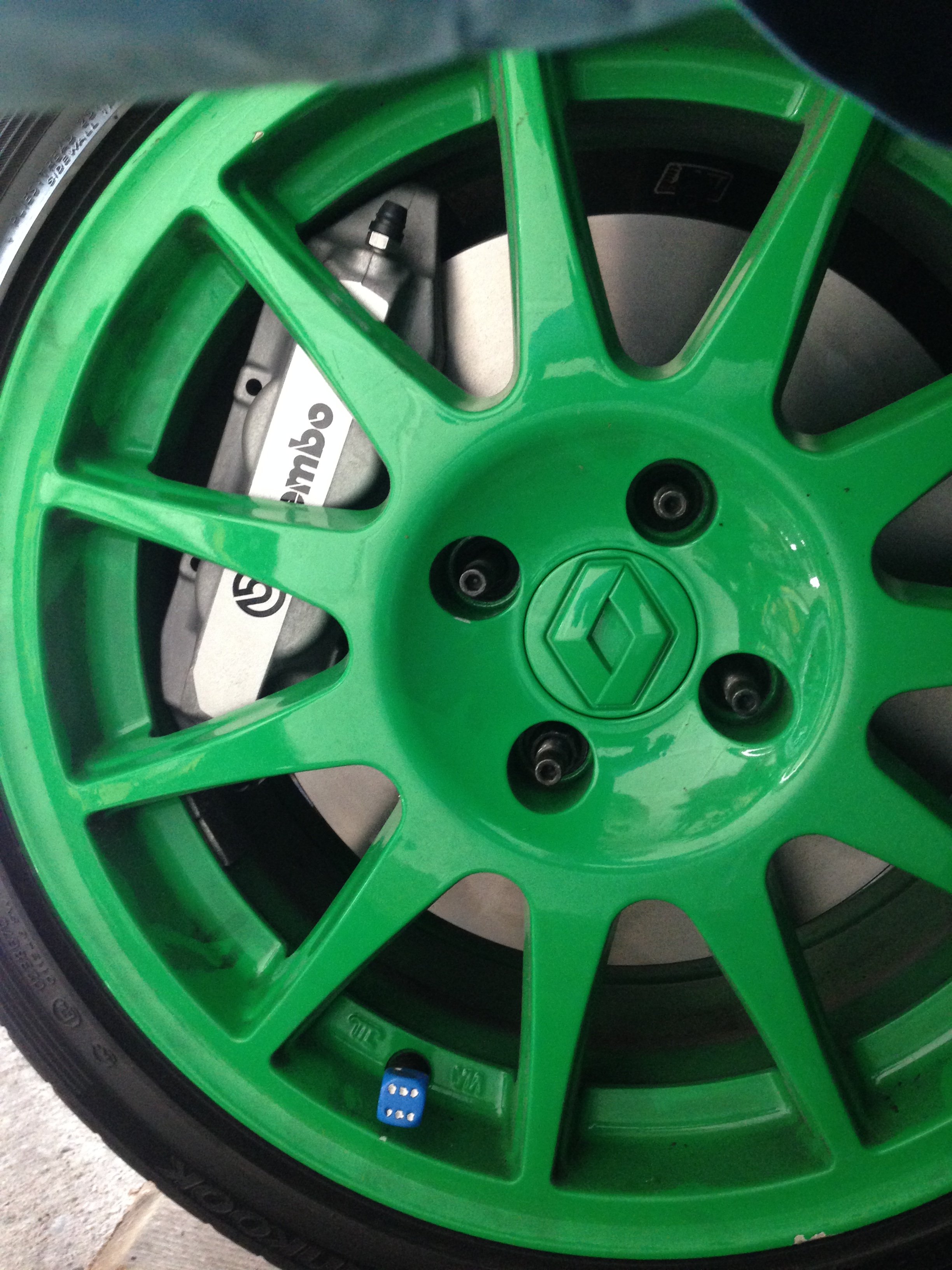

My cup turinis clear perfectly without issue. You just can't run wheel weights on the inside where the caliper sits.

I had cup turinis and they cleared perfectly (with the pure motorsport brackets its even better). There are also still the brand new genuine brembo calipers on eBay at £145 per caliper.

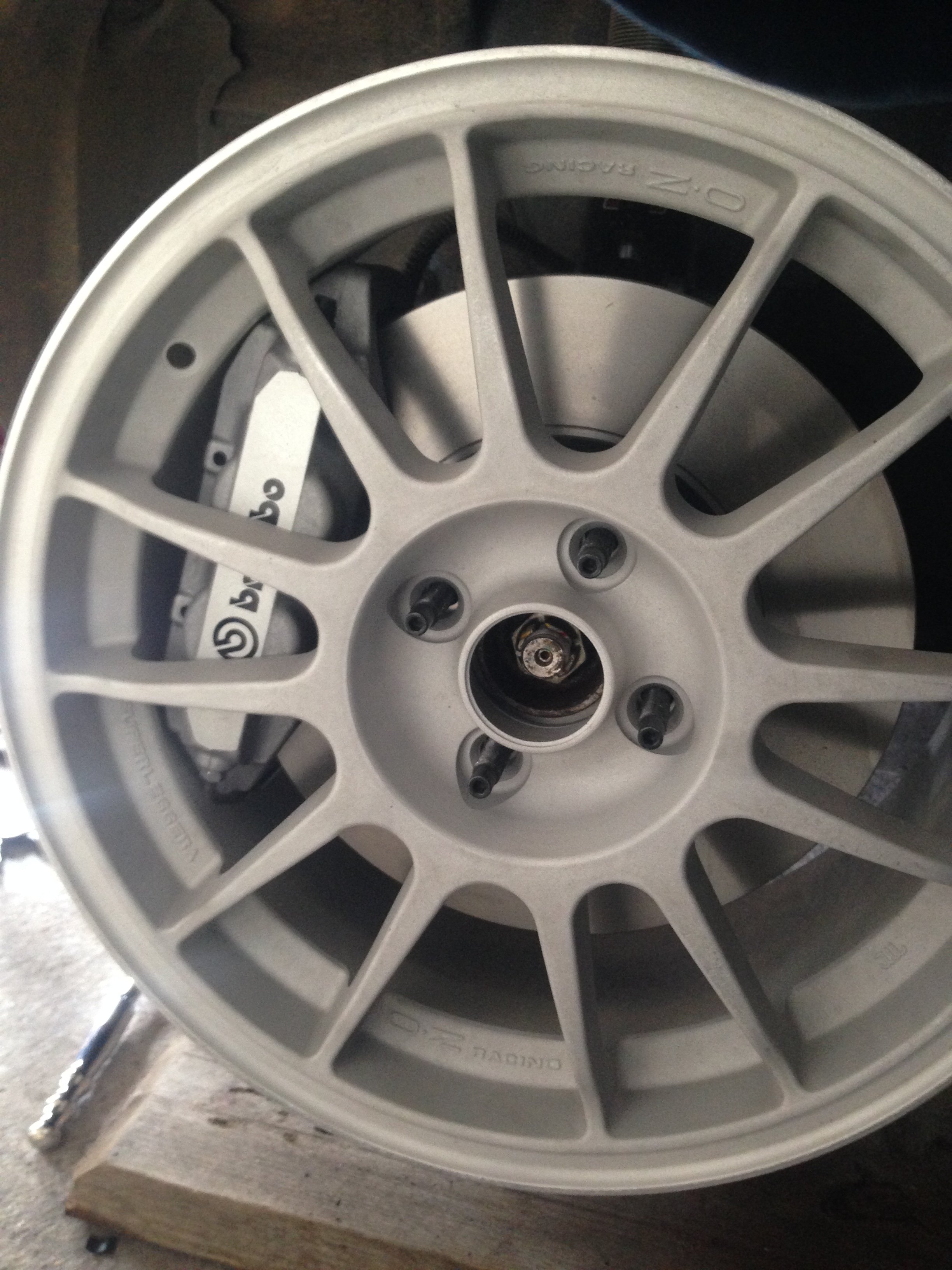

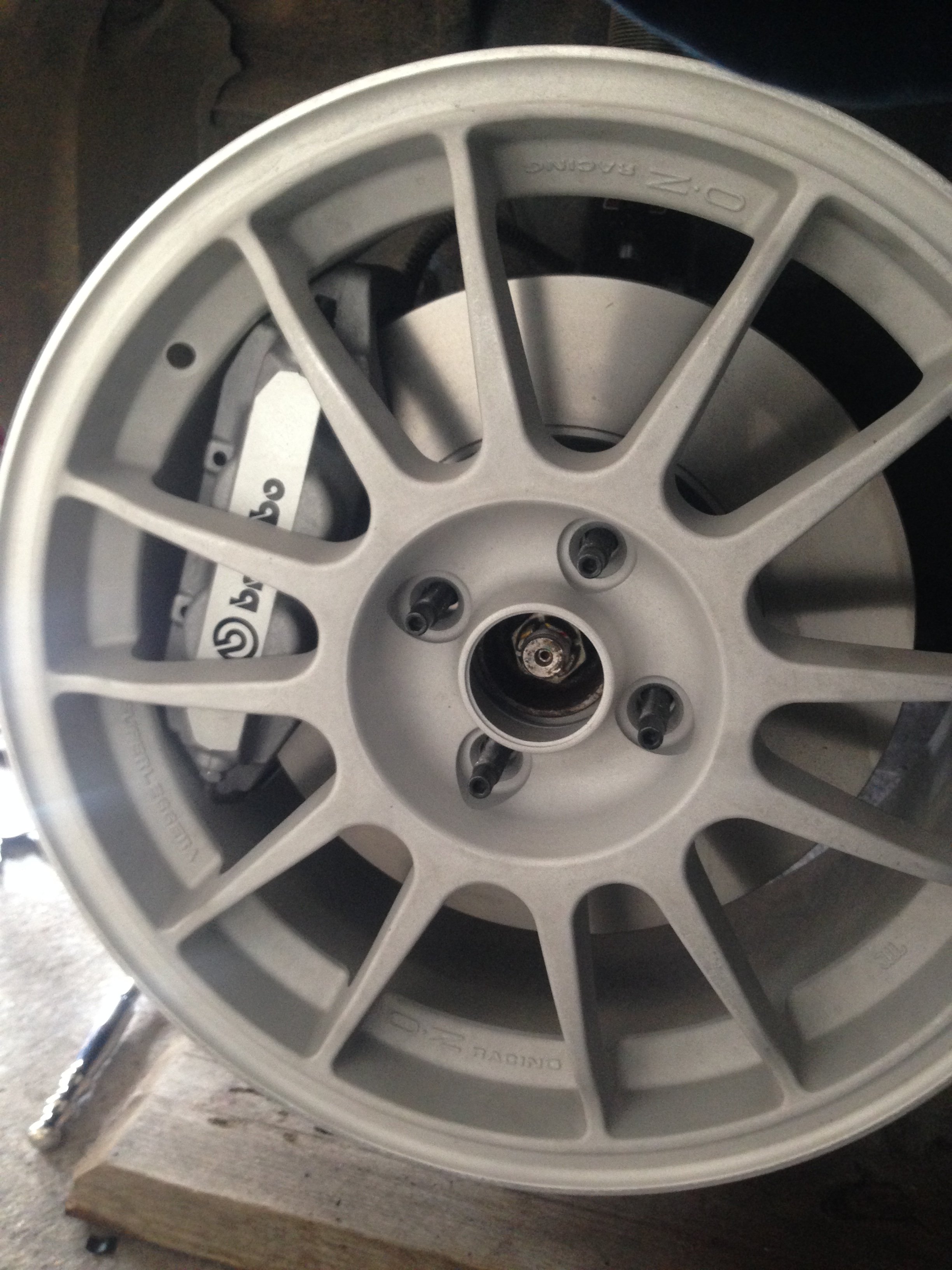

It'll be the spokes and inner part of the rim that will potentially cause you a headache mate. Look at the pics of my superleggeras and you'll see what I'm on about. Et37 for reference as well.
