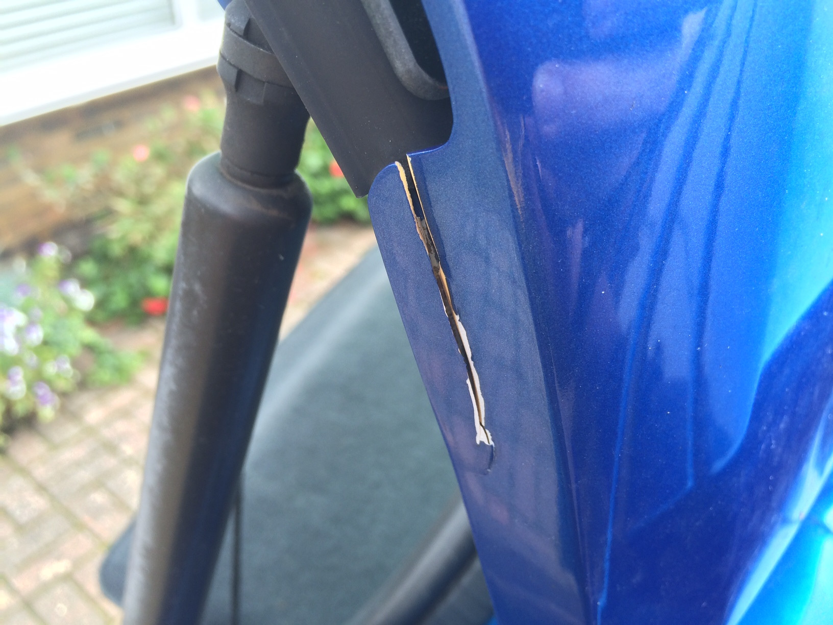

How to fix a small split on the spoiler?
  Clio 172 Cup
Hi all.
My 172 Cup has a small split on the edge of the spoiler. It's so hidden that it doesn't seem worth replacing, but I don't want it to get worse. What would be the best way to repair it? Is it something I could do at home with little talent?
All advice gratefully received.

i recently bought one with a section missing in the same place.
I used some Body filler and two bits if plastic (two debit cards i found in draw).
Stuck the filler on, then squished the cards in place to form the shape.
once done i trimmed the top to be level with the rest and then let it set.
once done sanded down to a smooth finish and then wrapped mine, but you can paint yours.

If you are going to repair it, you need to drill the start of the crack and then fill it - this will stop it cracking further down.
