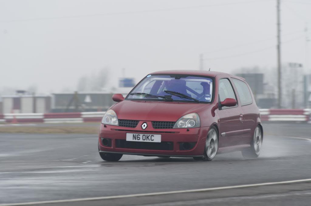

As Adamm. rightly points out, Bilsteins will still have roll when pushed hard. Here is mine, with Bilstein B14s, Whiteline ARB and a cage. Still rolling slightly. But...i've found my Bilsteins are the perfect balance between track and road. I'd go with ASTs if it was track only tbh.

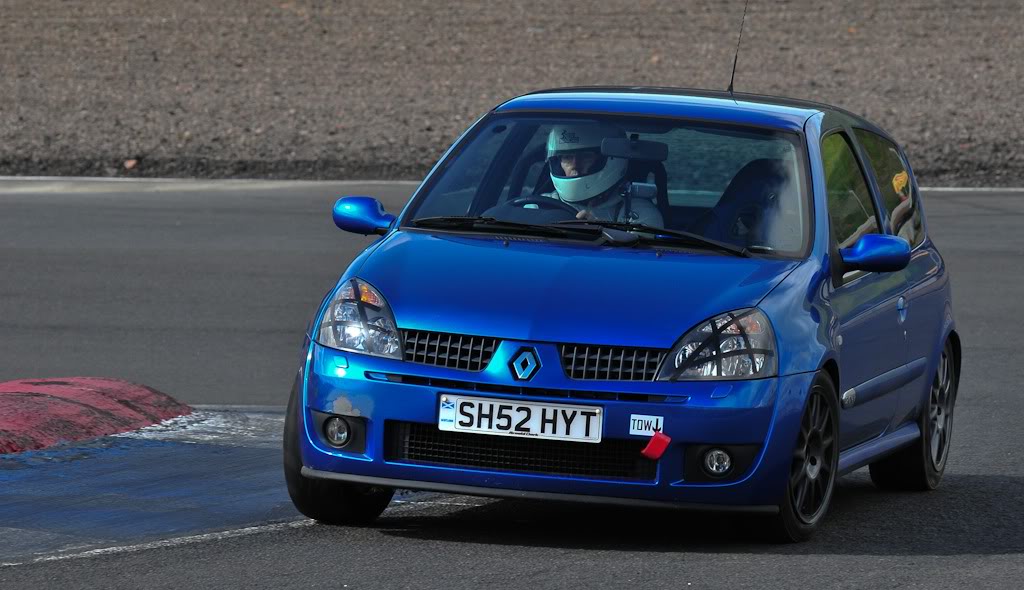

Here's mine at the hairpin at knockhill on kw v2's. Body roll still there but vastly improved over cup setup.
