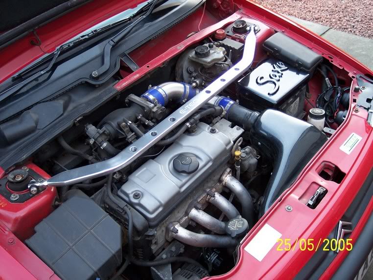

Intercooler idea is silly. Nothing to pull air through it.
This type of set up works well on saxo's and pugs.
Thanks for your reply, I am starting to think that it might be more hassle than its worth haha.
That looks awesome! Very tidy.
I hope to end with something like this, as long as its successful then i will be happy.
