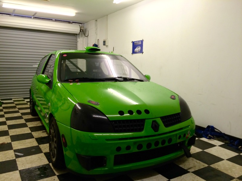

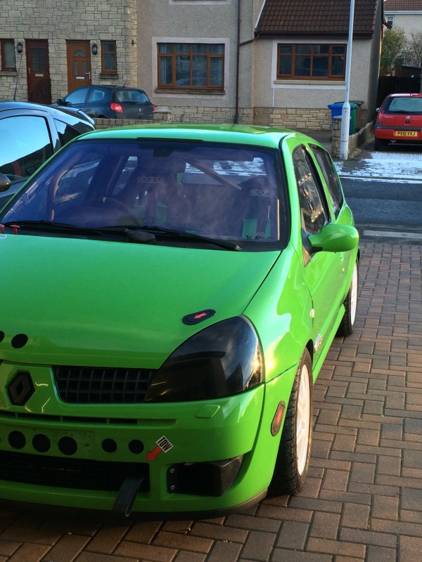

Got these fitted today , and first impressions are very good even from cold they seem very sharp.

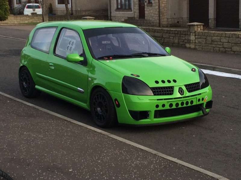

Then made up some headlight blanks, not sure if I like them in black or what colour to do them.
neil a
Thanks I like the look they give and only takes 2 min to re fit the lights if needed.

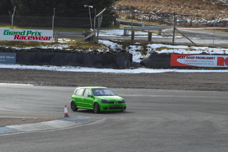

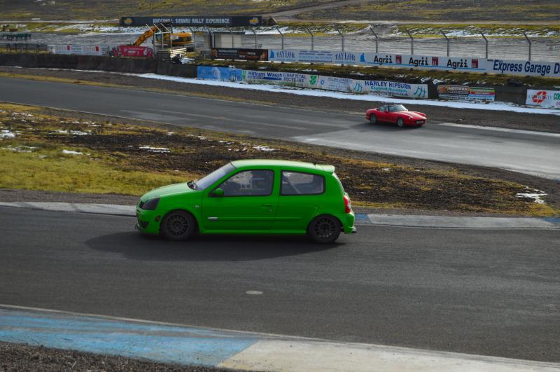

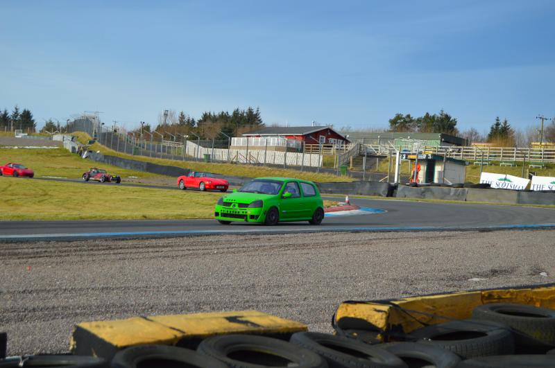

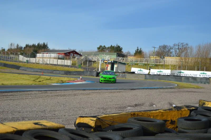

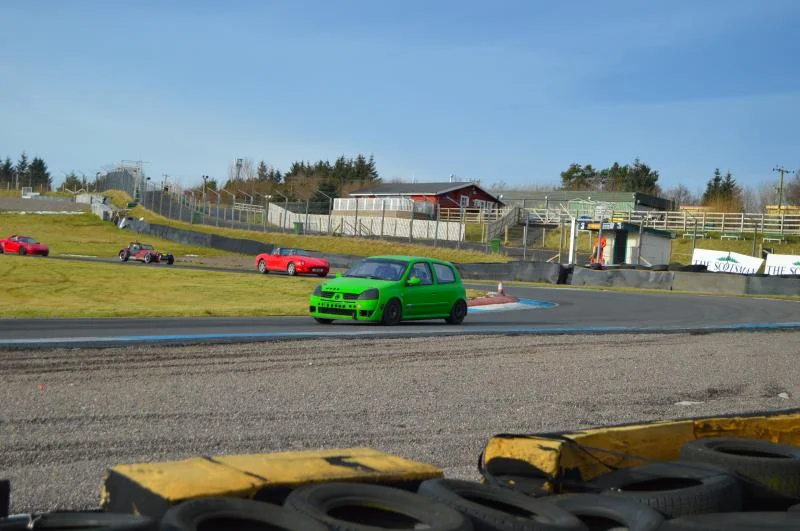

Was at knockhill today and again the little clio was faultless all day
The track was slippy early in the day but towards the end there was decent grip round most of the track, but still easy to lock up going into the hairpin.
Think my best time was a 62's with a passenger , which I'm fairly pleased with considering the conditions and it was the first time I've drove the car in 6 months.
Not as good a day for a few others, with a couple of evos going bang, a bmw compact going into the tyres and a subaru rolling into the hairpin.

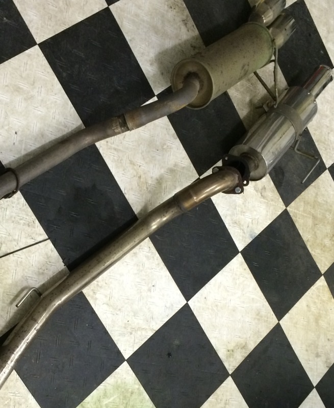

Also have a FG tailgate to fit and maybe a Yozza race exhust, as ive always hated the one on my car and its a heavy system.

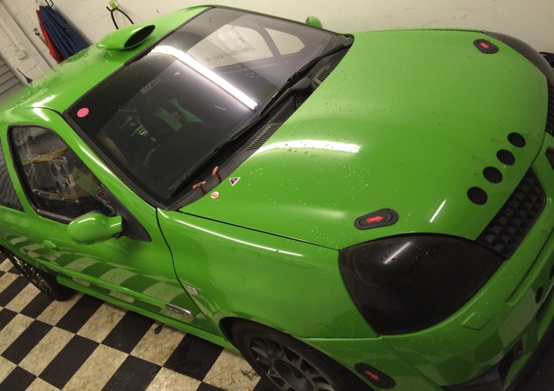

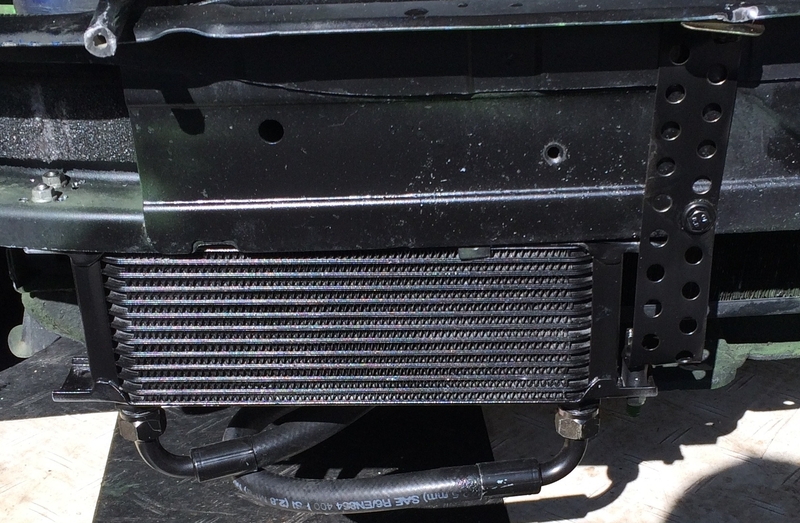

Got my roof scoop fitted today along with an oil cooler . Was a bit worried about drilling into the roof as its had filler after the bonnet came up but all went well.
Going to pick up a Yozza just now and get the oils suspension off as hopefully the AST's should be here tomorrow.

Will get one tomorrow , it's a 19 mocal cooler kit, I'm not running a thermostat justnow but as it's a track only car shouldn't have a problem. I still need to get some spira wrap for the hoses to avoid any rubbing.
neil a
Could have went bigger but I was only seeing temps of around 130. So just wanted to drop temps a little for added safety.
my temps are 125-130, my thinking is if it's there on a cold March day, what's the middle of summer going to be like?! I'd rather have a cooler with s thermostat for peace of mind :)
I was actually thinking if a 13 row Mocal.

Sorry Mark I thought it was larger it is actually a 13 row not a 19 Im not overly happy with the hose run still.

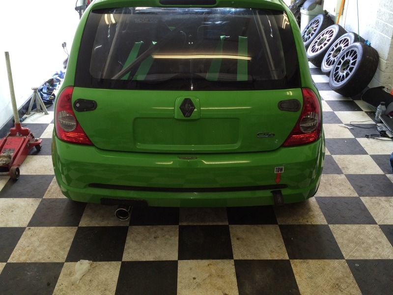

Yozza on not sure if i will need a map tweak or not as went from 2.25 to 2.5 " , Im still running a sports cat so would think that would be the main restriction in flow.
I had to fit a heat shield to the rear bumper to cover the hole where it had been cut for the twin pipes.
neil a

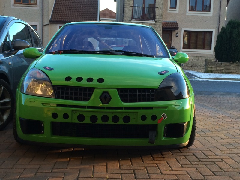

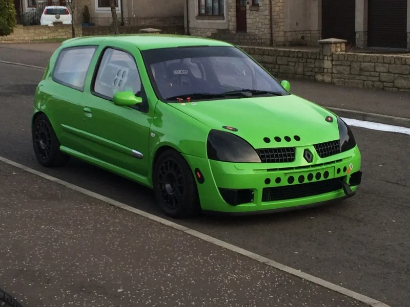

These should add a bit of contrast to the green :)
The rear end now sits about 20mm lower than before more like cup car ride height,but the suspension was set up by Mark Fish on Porkies car so looking forward to trying it out . Im now also switching to AST top mounts assisting camber and caster.
