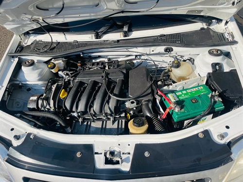

Thank you for this info. Sounds like just getting a K4M 1.6 16V engine would be a lot less work and still a large upgrade over my current 75hp 1.4 8v engine. As it turns out, the K4M is very plentiful here in South Africa even though the Clio never came with it. Other than the Meganes, Scenics, Modus's and other Renault cars, the K4M also came in the Nissan NP200:
It looks very familiar under the bonnet of this thing, even the strut towers look like a Clio. The fusebox also looks identical. I just hope the ECU in here works with my UCH.
