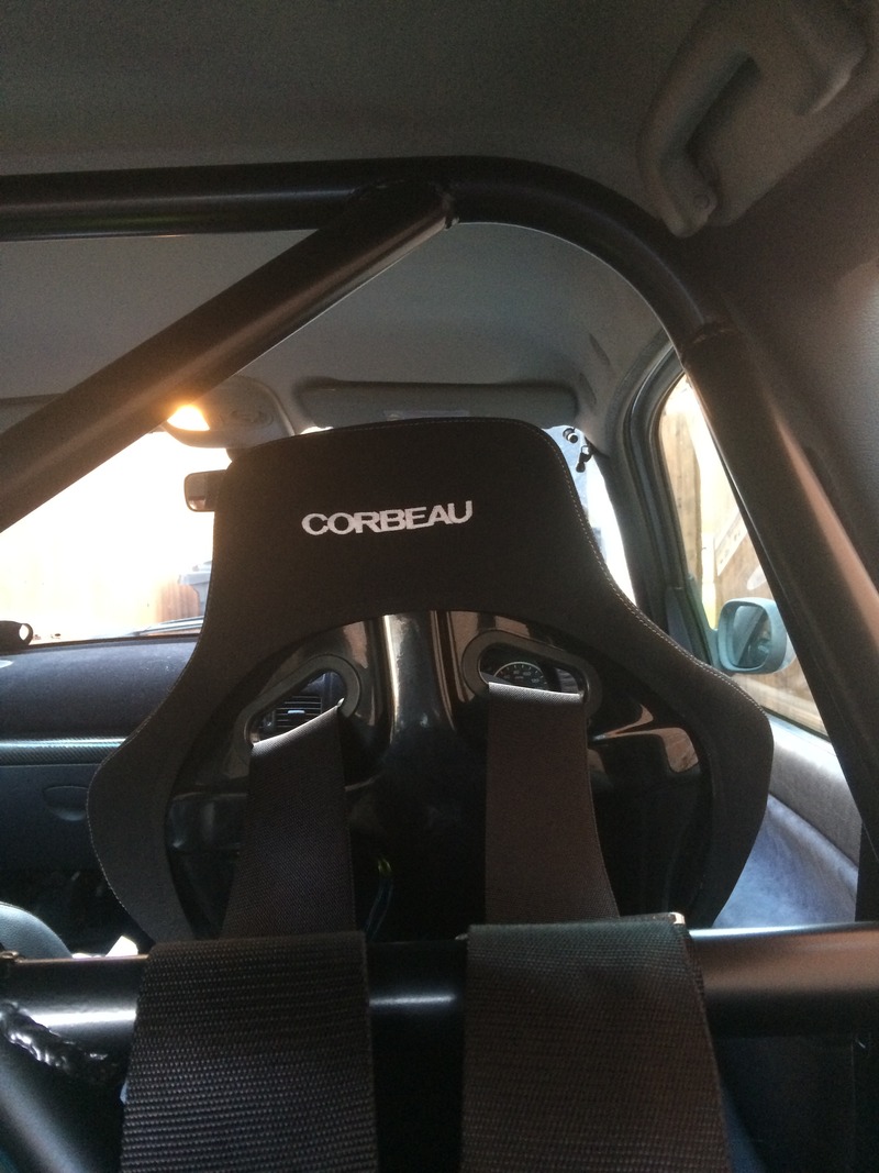

What have you guys used to level the seat out? I've got it as close as poss, but it still leans towards the centre of the car.
bashracing
the renault spacers that sit under the standard seats just on the tunnel side, or washers if you don't mind it a bit pikey
haimsey
  ph2 172
Took the plastic Renault ones out thinking it would sit a bit lower. We found some nylon spacers, but we seemed to be spacing it out quite a lot
