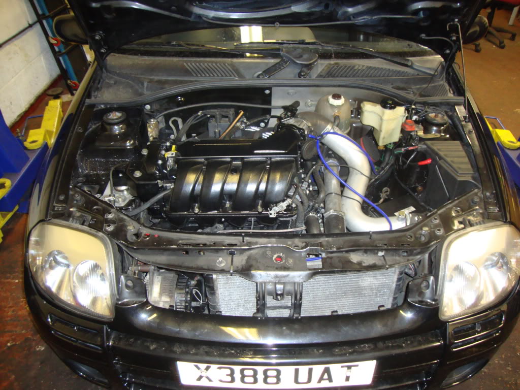

I have a 197 head on my phase1 turbo for example:

That is what I had on my turbo phase 1, with a megane gasket as well to also drop the CR (the head only makes a very small difference)
