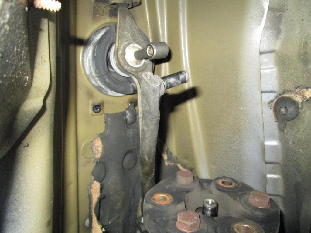

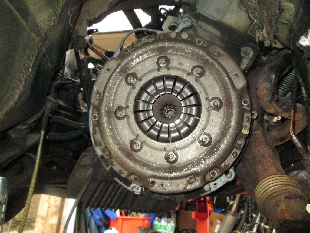

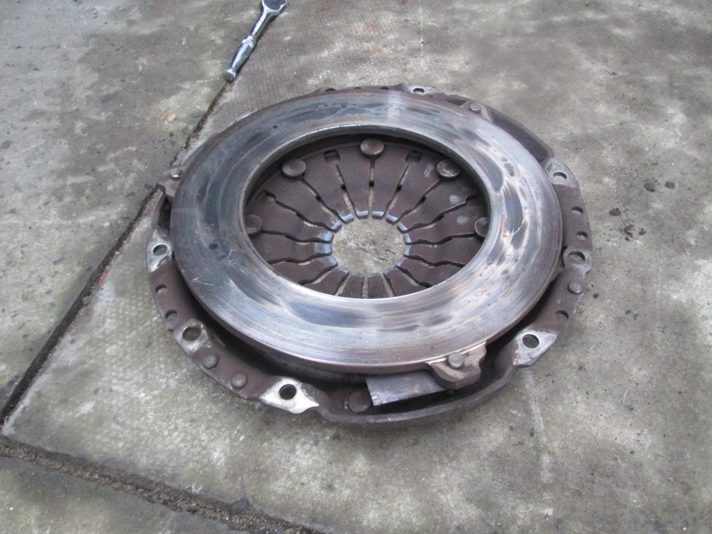

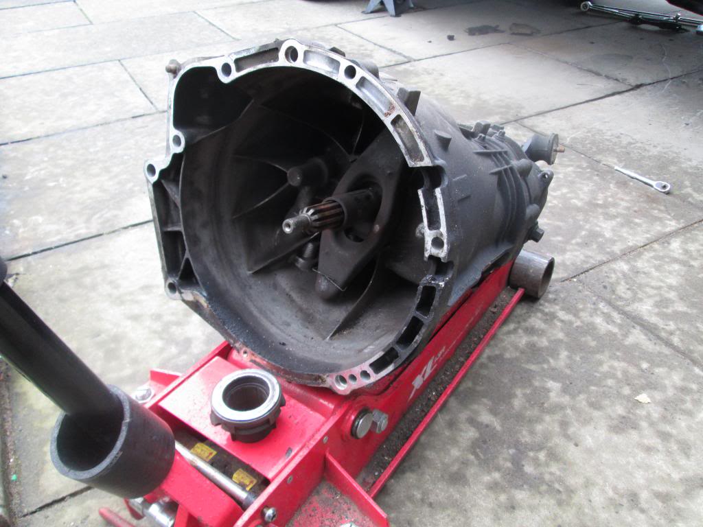

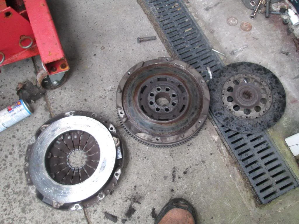

Full day on it today and only half way there.. if anyone attempts this on a driveway have plenty of help on hand, its not an easy job by any means!
I removed the inlet manifold for easy access to the starter motor/wiring to begin with. Then removed the exhaust, propshaft, shift linkage, clutch slave cylinder etc.
Removed the gearbox mount and dropped the box down on an angle to gain better access to the bolts for the bellhousing. They are pretty hard to get to, especially if all your sound deadening had fell down like mine (so I ripped it all off), get the car as high as possible to get a full turn on a breaker bar. You'l need at least 2-3 10" 1/2" Drive extensions too, linked together. Combination of E-torx bits, E10/12/14. I snapped one of the bolts when undoing it, so its stuck in the block now (not that it matters as the engine is being replaced, but not ideal).
Once all the bolts are undone, we wiggled the box from the engine. Not a simple task lying on your back to say the least, but it came off onto the jack quite easily.
The release bearing was completely knackered as expected, metal on metal where the rotating bearing is. DMF + Clutch still fitted..
Everything looks to be original, so I'm guessing the box has never been off. Removed the clutch and flywheel..
Only to find the pressure plate was completely knackered also, 2 of the 3 rivets/attachments for the clutch face had completely sheared..
Then as per it started to rain... Fitted the new flywheel and clutch with the new bolts. No pics of this as we were just getting on with it. Attempted to get the box back on for a couple of hours, but it got dark and the rain never stopped so its been left off for today. Nightmare trying to get the right angle/position under the car. Hopefully a fresh start tomorrow will see it onto the block and everything bolted back on!

All done, finally. Big job, do not attempt it on your own for sure! If you've never done anything that size of job before, allow 2+ days.
The 323i E21 taller release bearing is 100% NOT required. Clutch is perfect, biting point right in the middle. Lightened flywheel is much better too.

Out of interest what alignment tool do you have?
I've got some shitty draper one which didn't hold the pressure plate and clutch together in perfect alignment so it was useless. In the end I threw it on, left the pressure plate loose and used an extension bar to line it up.
Good work getting it all done BTW. Any downsides to swapping to single mass? I know in dervs you get a bit of a rattle and more vibrations but I've not experienced a single mass conversion in anything other than PD engined VAG's
I've got some s**tty draper one which didn't hold the pressure plate and clutch together in perfect alignment so it was useless. In the end I threw it on, left the pressure plate loose and used an extension bar to line it up.
Cheap one from Machine Mart, just had to get the right size for the crank pilot bearing so modified the diameter with tape to get it a mega tight fit, then used the clutch disk part to centre that and torque the cover plate up.
No downsides really, the Getrag transmissions suffer from a bit of input shaft rattle at idle but no issues. Mine (ZF box) is silent, just as it was before. Clutch feel is much better too. I had issues with 1st/reverse being stiff to engage since I bought the car, I always thought it was the box, but it turns out it must have been the clutch - all the gears are smooth and perfect now!
Does it rev quicker now? Could you get a vid?

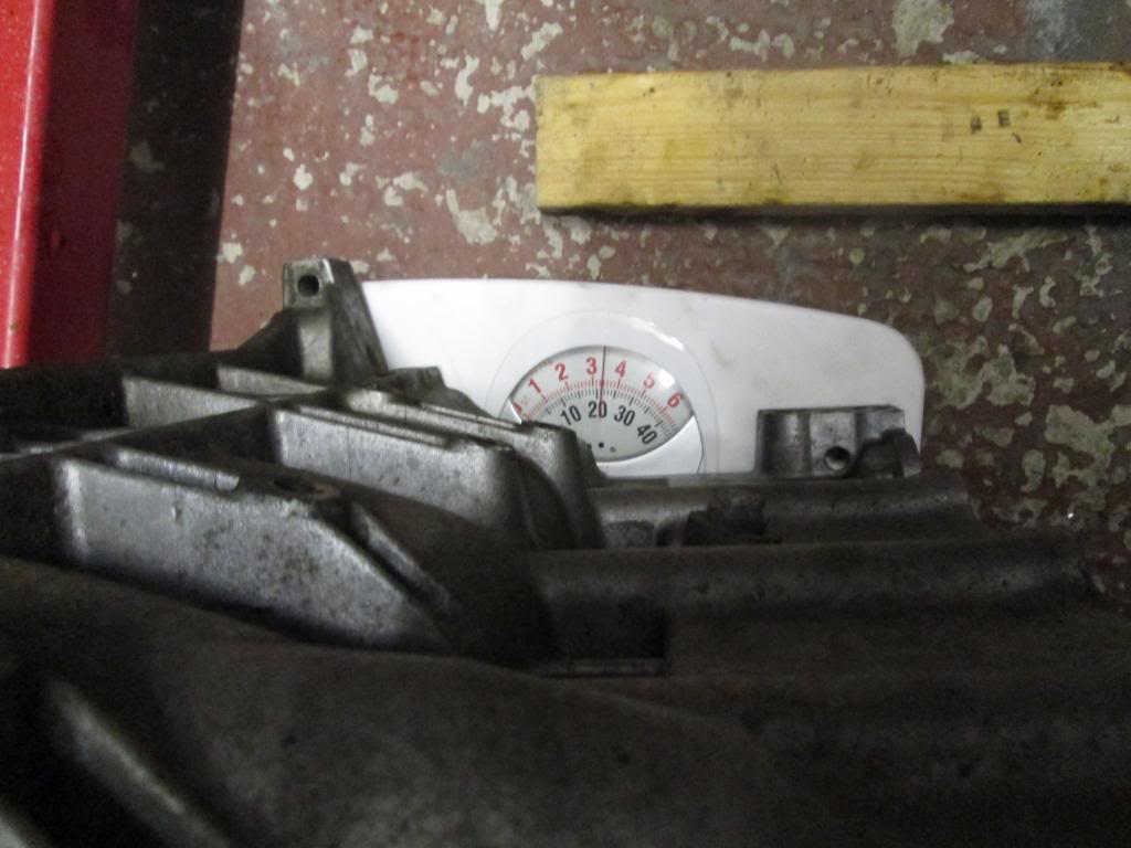

On idle, revving it yes. The DMF weighed on its own 12.5kg, the SMF is just over 5kg. I've not driven it 'properly' yet as im having issues with hesitation now, but I've given up for today. Think something may just be unplugged.

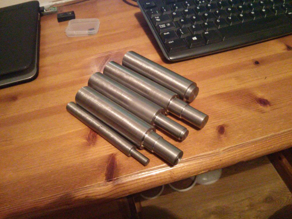

Had these turned up from a set of drawings for a job that needs doing on the car soon - can anyone guess what they are?
Re: E36 v2

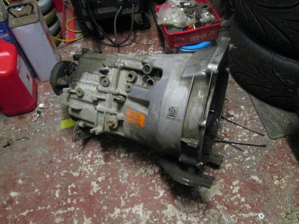

So a few weeks ago I picked up a 'spare' ZF S5D310Z, removed from a 3.0 M3. As mentioned previously in this thread I had issues with very stiff gears on my current gearbox, so I'd been on the lookout for a spare. Ended up winning this one on eBay for good money. The 328i's came with a ZF box also, but the later S5D320Z, the only difference being the torque rating (310nm vs 320nm).
Which brings us onto the above tools... the ZF S5D boxes have issues with the detent springs/pins inside the box, causing stiff/hard to select gears, lever sitting to one side when in neutral, etc. These tools allow the new sleeves, pins and parts to be fitted from the outside of the box via the access caps dotted around. They are available from BMW, obviously not cheap, also available from the USA for around $60 (+ shipping/import/etc) so still not cheap.
Luckily some kind person had drawn the tools up with exact measurement on CAD, and put the files online. I then had a friend take them onto a CNC lathe and turn them into the tools you see above. Just need to get a set of springs, sleeves and pins now so the box will be sorted and ready to go in with the new engine. Will probably clean it up at the same time and put some fresh ATF in.

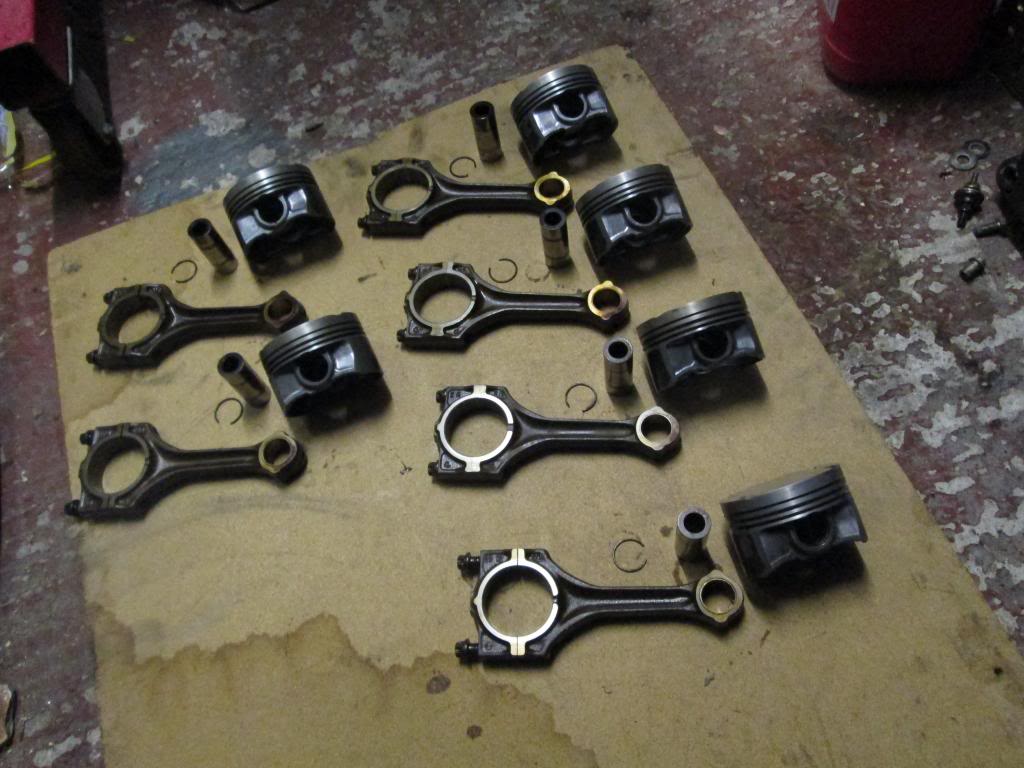

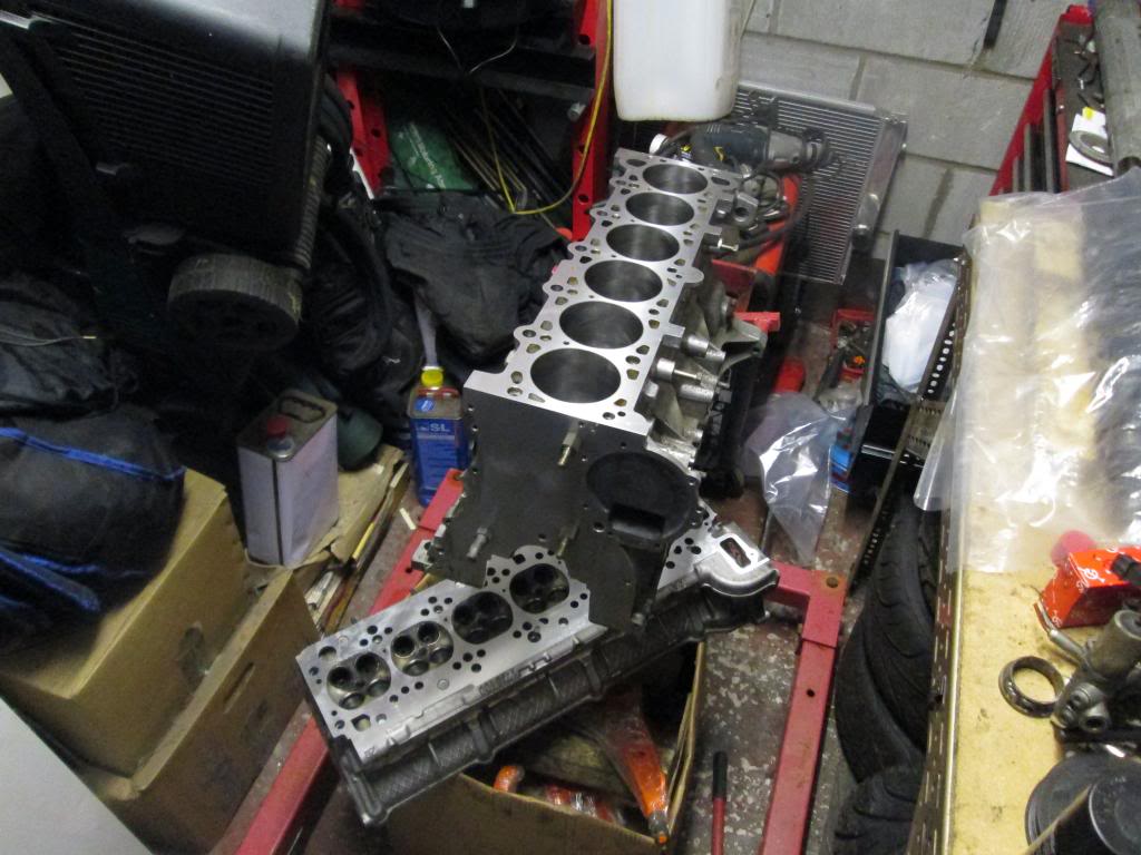

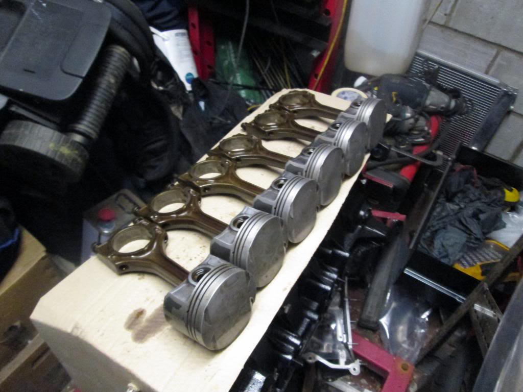

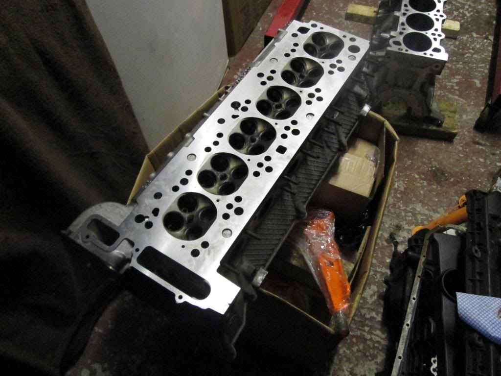

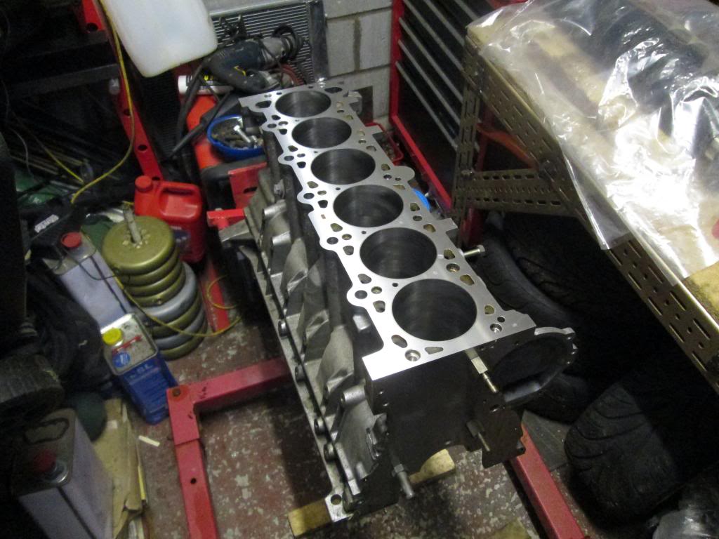

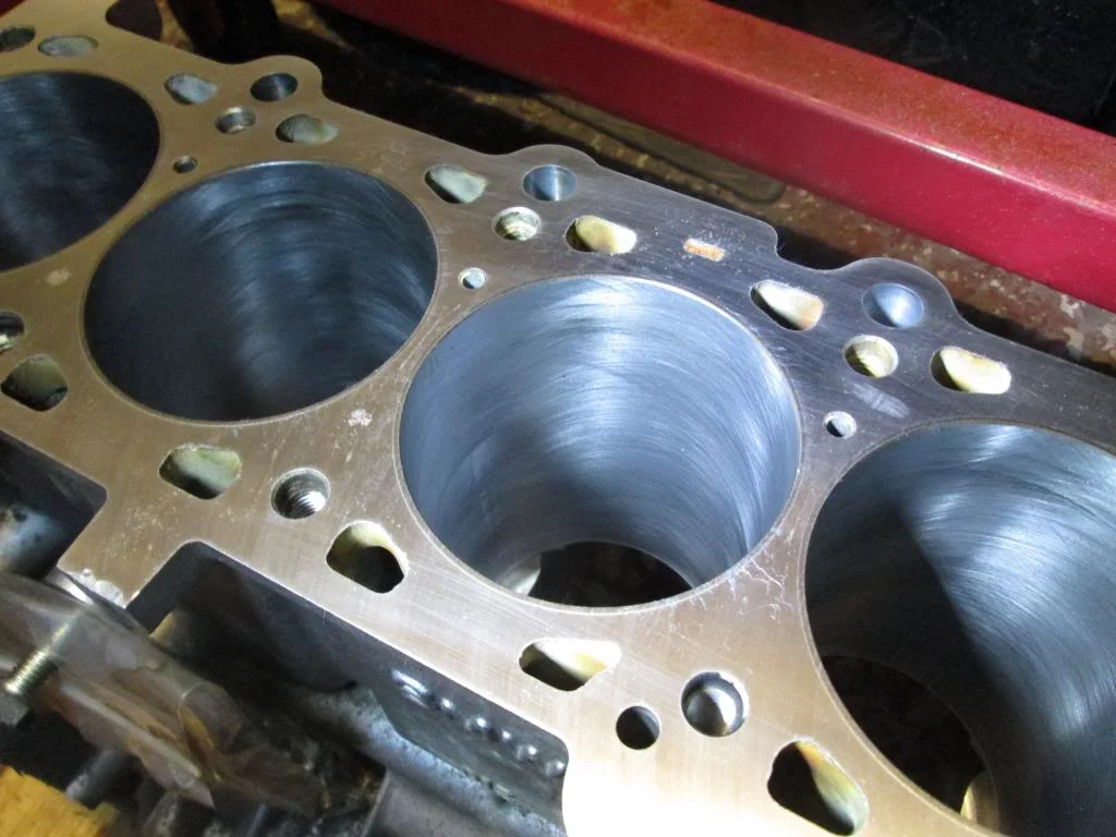

Ive been collecting parts over the past couple of weeks also, and now have the head/block back from the machine shop. The bores have been honed, the block decked and the head skimmed. Both of them then properly cleaned and now ready to build up..

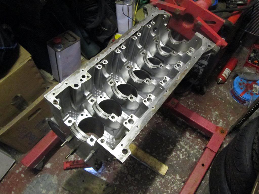

Its quite crazy how light the bare block is, compared to an F4R, just under 21kg..
The bare head is about 18kg, so not much different again. Now to get on with building it up :approve:

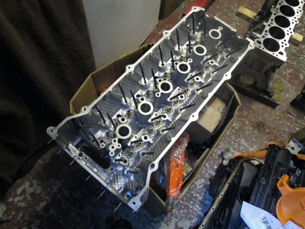

After spending what seems like days cleaning and checking parts, sump, timing covers and other various bits I finally seem to be getting somewhere. Had the joys of burnt on oil and gunk to remove, then I pulled the old rings from the pistons and stripped them apart checking for wear. Then cleaned them, making sure the ring lands were perfect and re-assembling. Many hours later..
The block has also been painted, along with the sump and various other bits. Time to bolt it all together now :clown:

If your using an F4R as your benchmark for engine weoght your prob gonna find most engine block seem light bar ford fox engine.
Re: E36 v2
F4 is light when empty compared to a lot of others too I guess, cast iron etc. Considering M52 is aluminium its gonna be lighter than a lot of others when empty, and a lot heavier (160kg) than a small 4pot when built

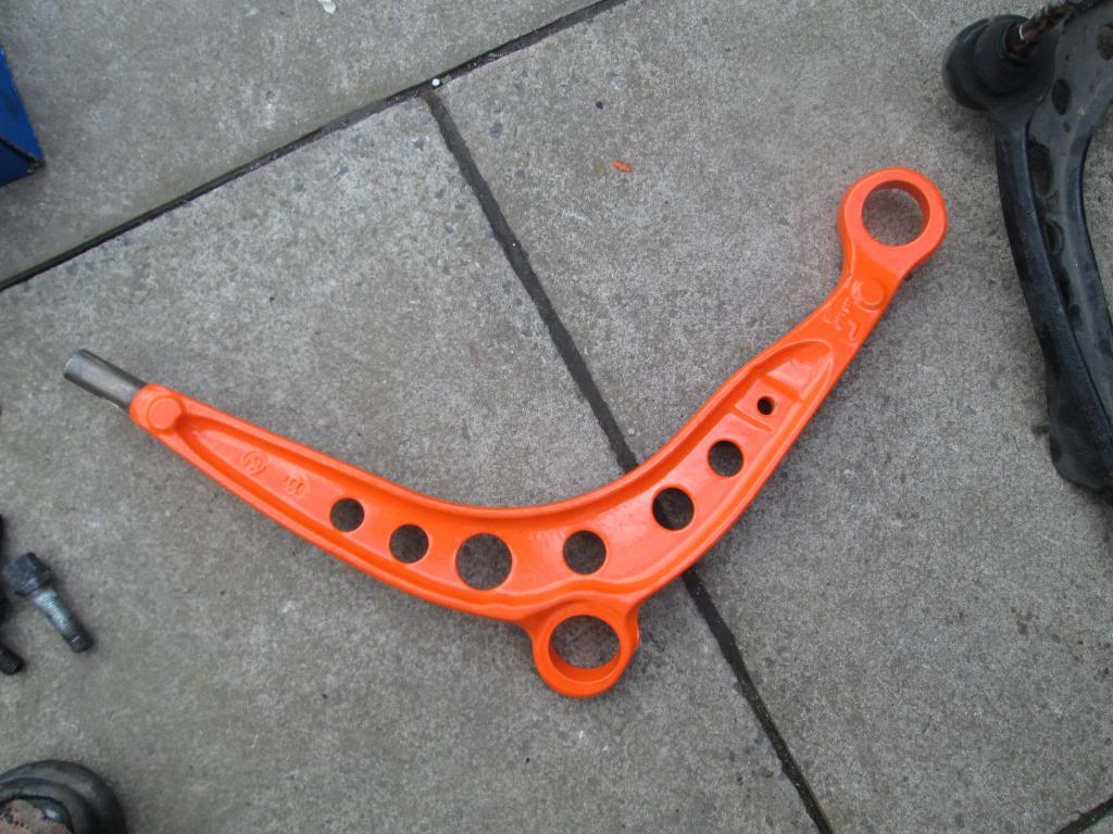

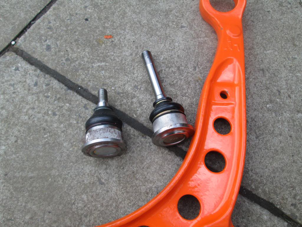

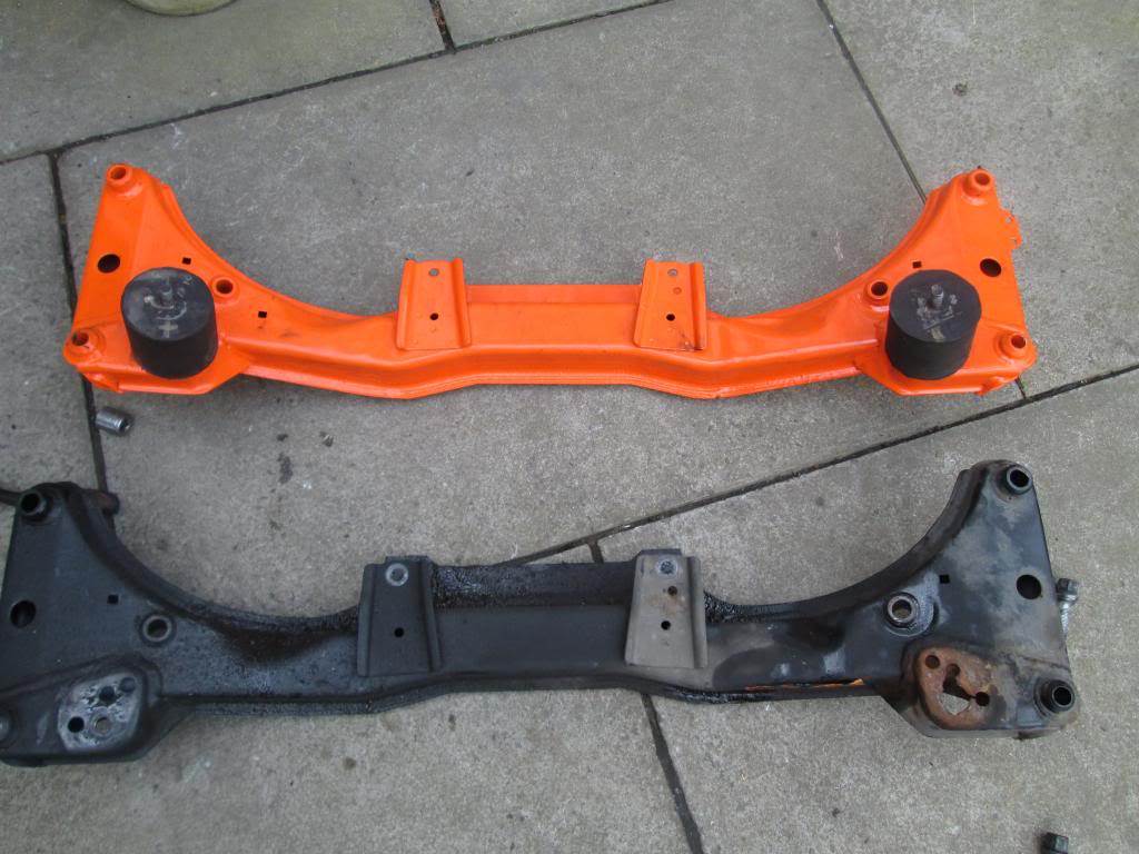

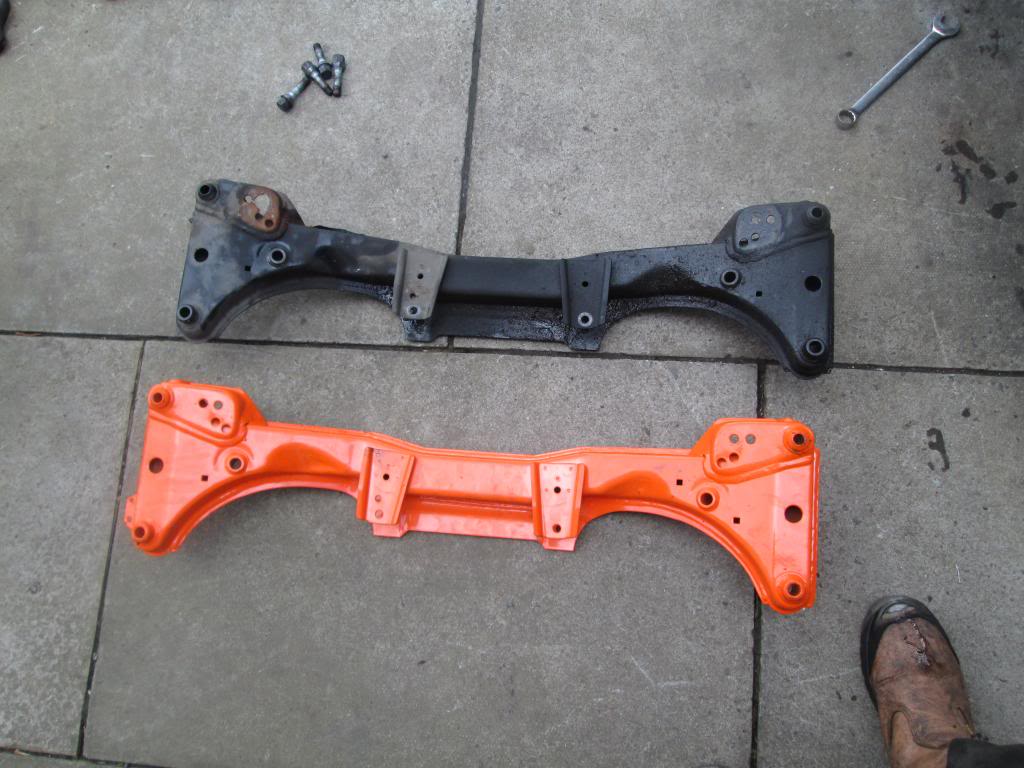

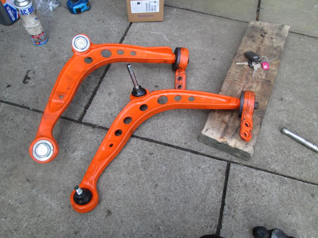

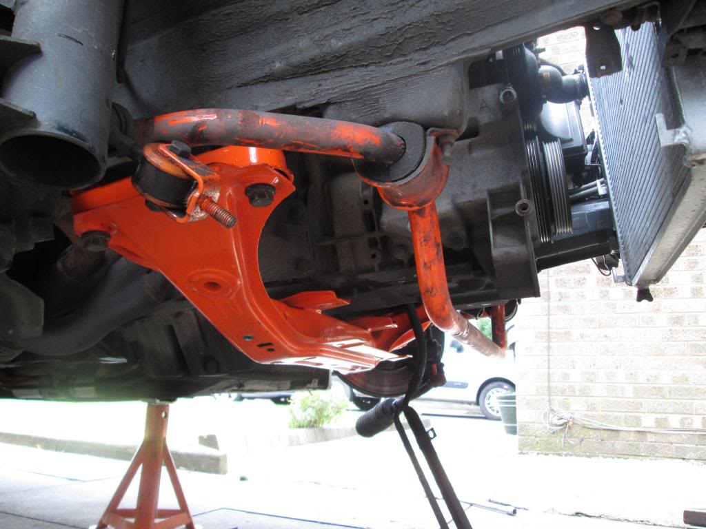

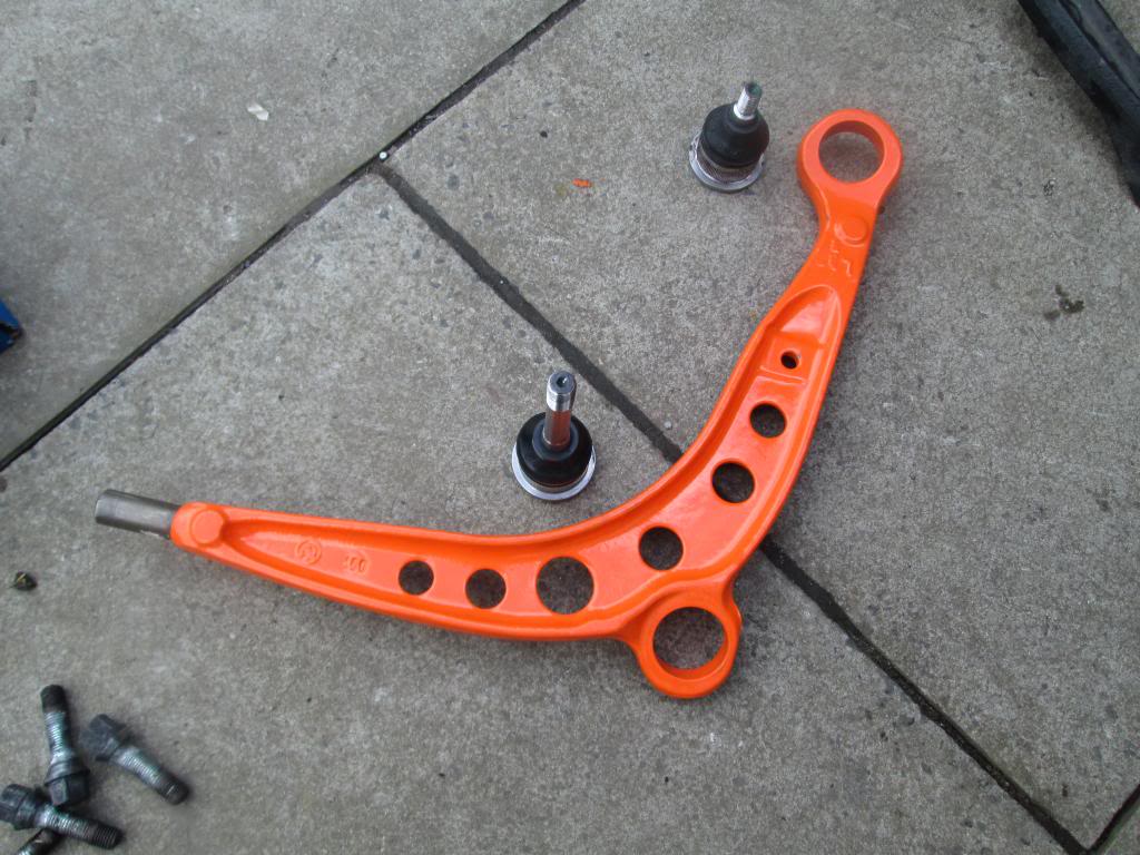

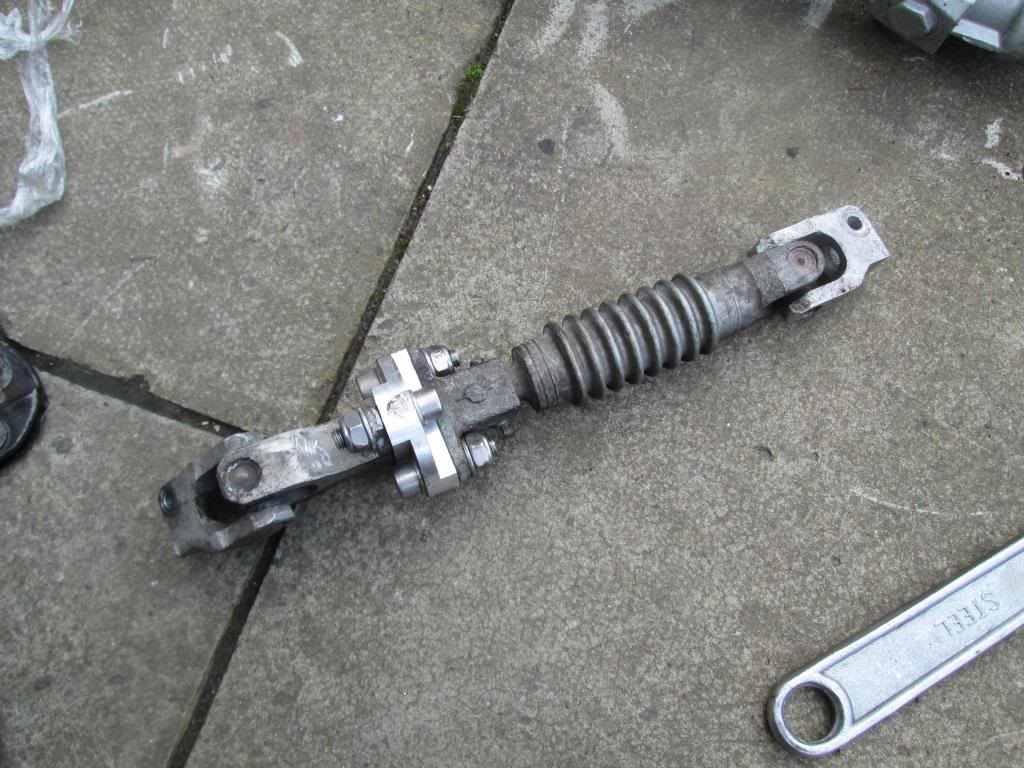

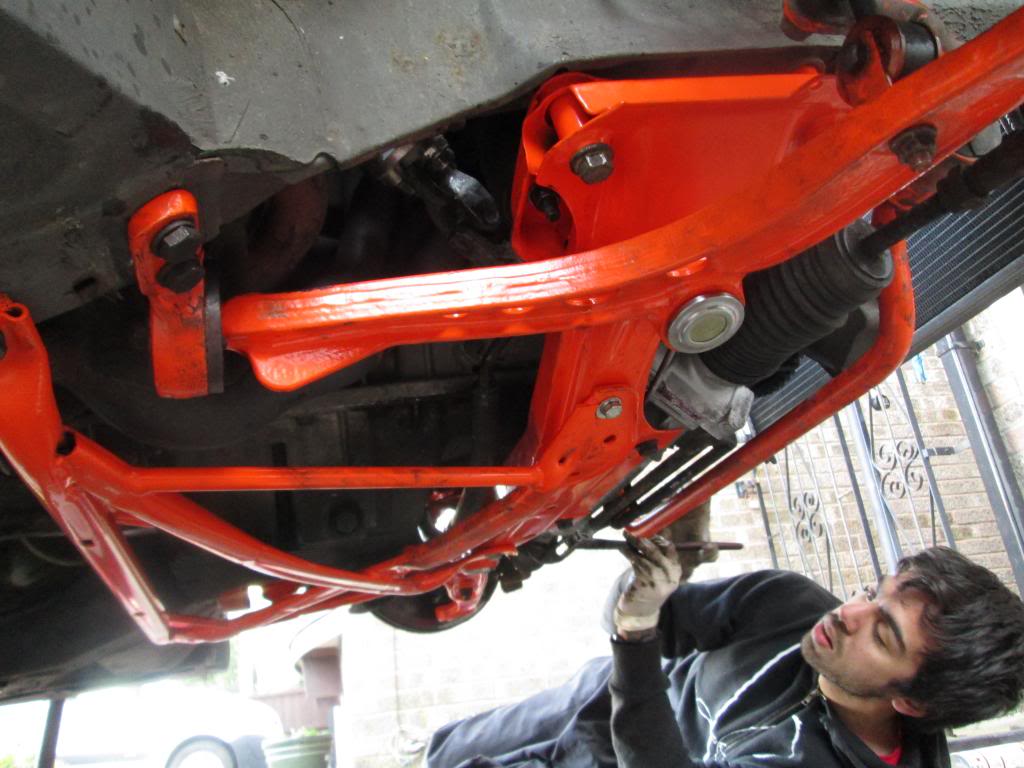

So last week, had a bit of a mishap with a piece of pavement in a car park, which resulted in a banana shaped wishbone. No major worry as I had the powdercoated ones ready for fitting. The rack felt a bit funny after it too (although the TRE and arm were still straight), so I thought I'd swap the lot at the same time.
Spent a while removing the old subframe/wishbones, steering rack, draining the power steering, then swapped the engine mounts to the new one..
Bolted it up to take the weight of the engine..
Pressed the new balljoints into the powdercoated wishbones..

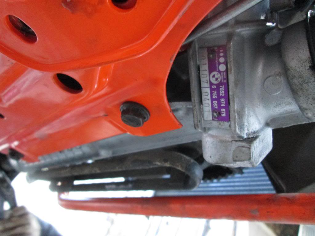

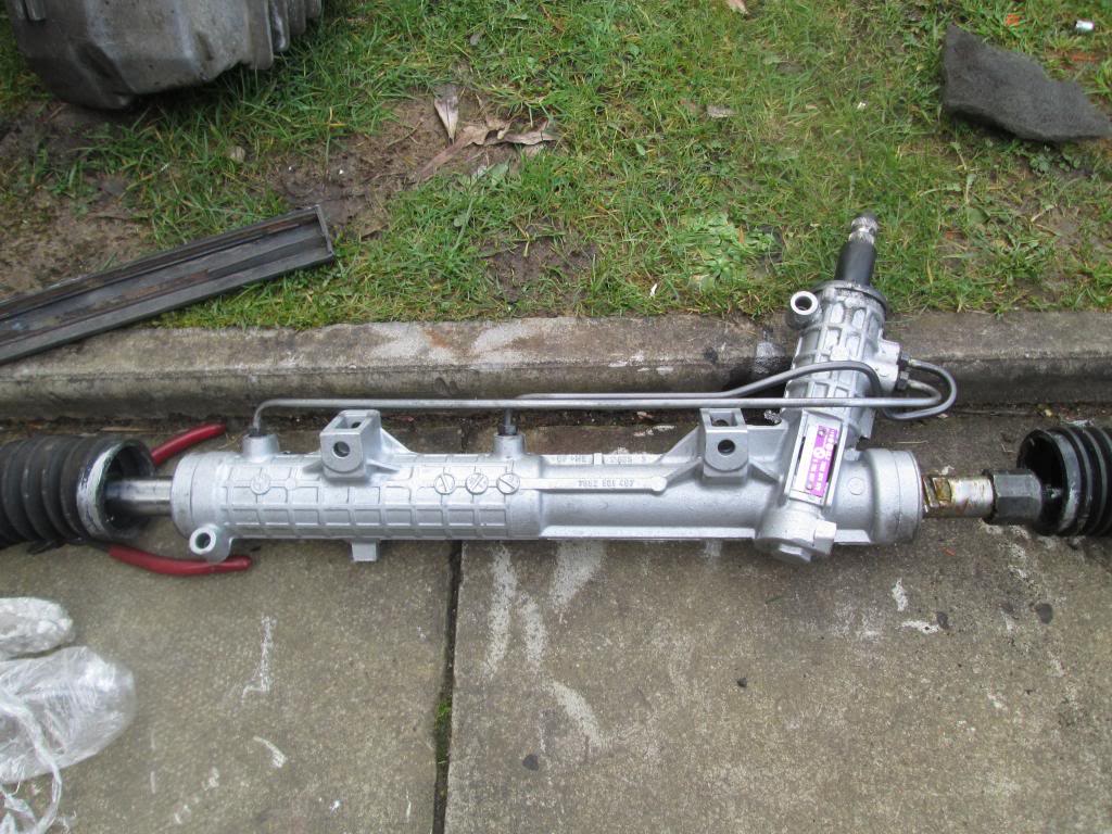

Picked up an E46 '067' rack from eBay cheap, cleaned it up and gave it a paint.

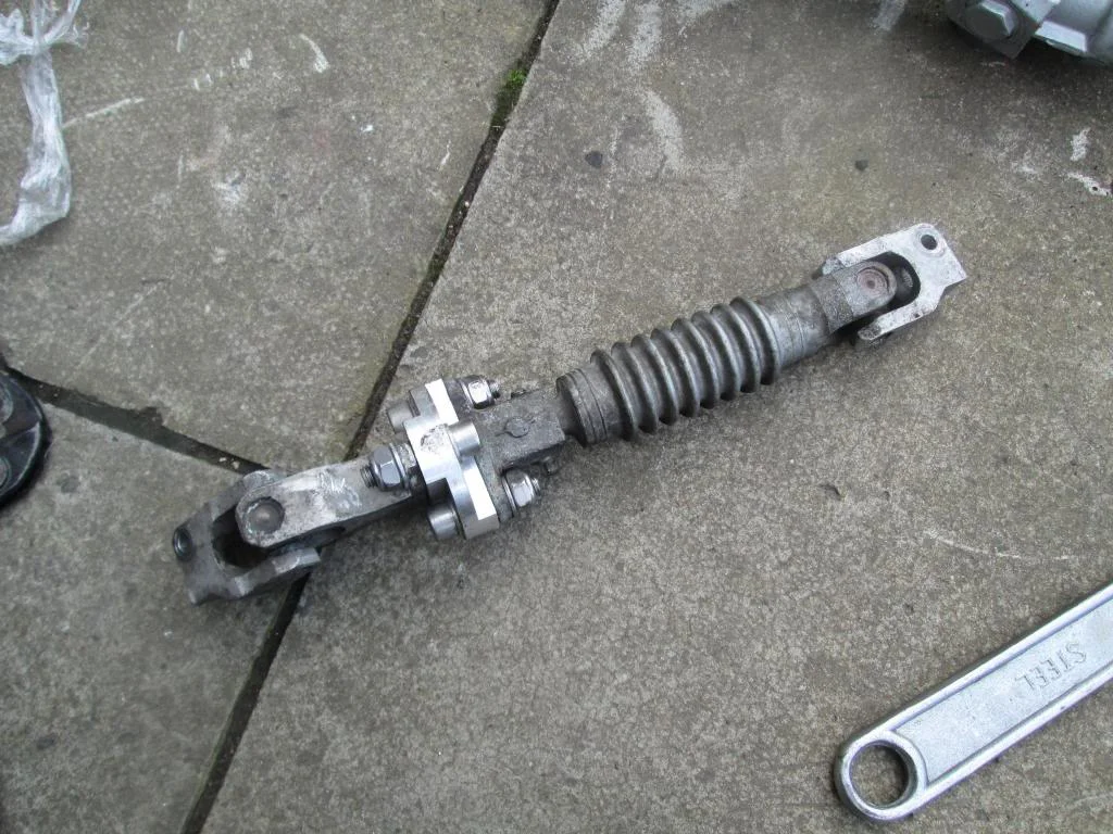

Steering linkage bush replacement close up for those who asked a while ago..

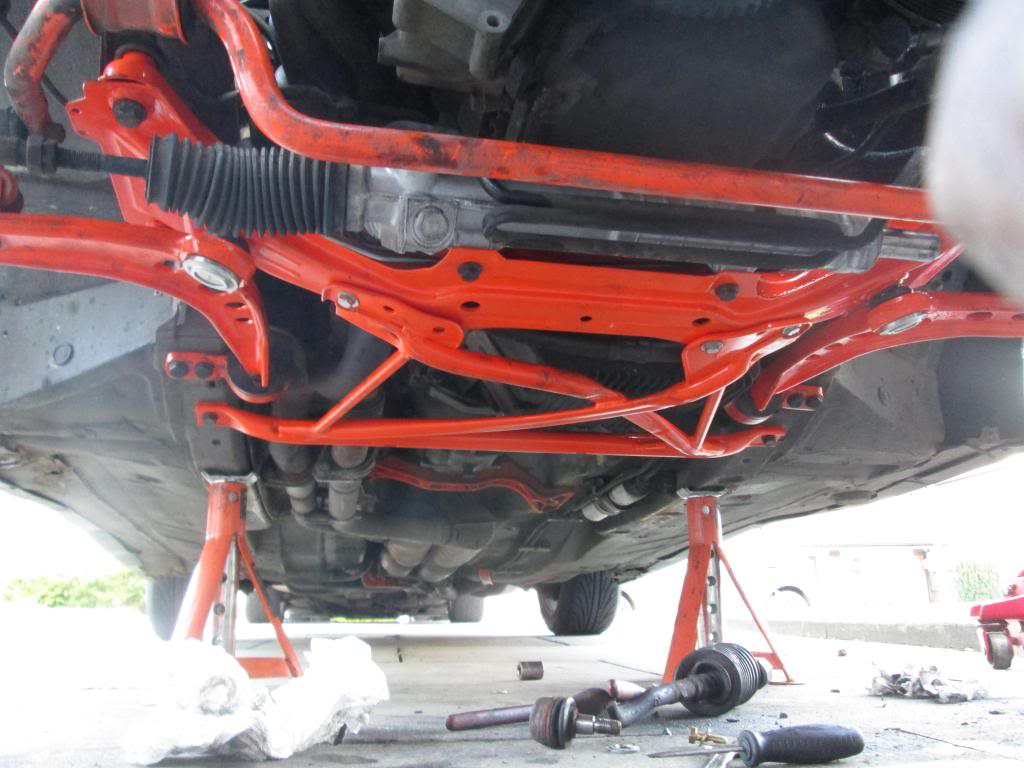

Bolted it all up, along with the X-Brace and piped up the rack / replaced the PAS fluid..
Job done. I was going to wait until the engine was swapped to do the subframe/arms, but with the wishbone needing swapping it was easy enough to do the lot in one go.
The E46 rack is much better, heavier feel than the old high mile E36 rack, and less turns LTL so it feels 'quicker'. I get about 1.4 turns each way from the central position. Alignment will need double checking now at some point, but I doubt much adjustment will be required.

Feels somewhat different yeah, its probably due to the steering being heavier with the E46 rack too though. True test will be Cadwell at the end of the month!
