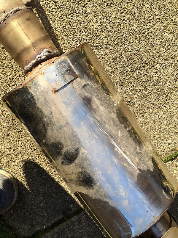

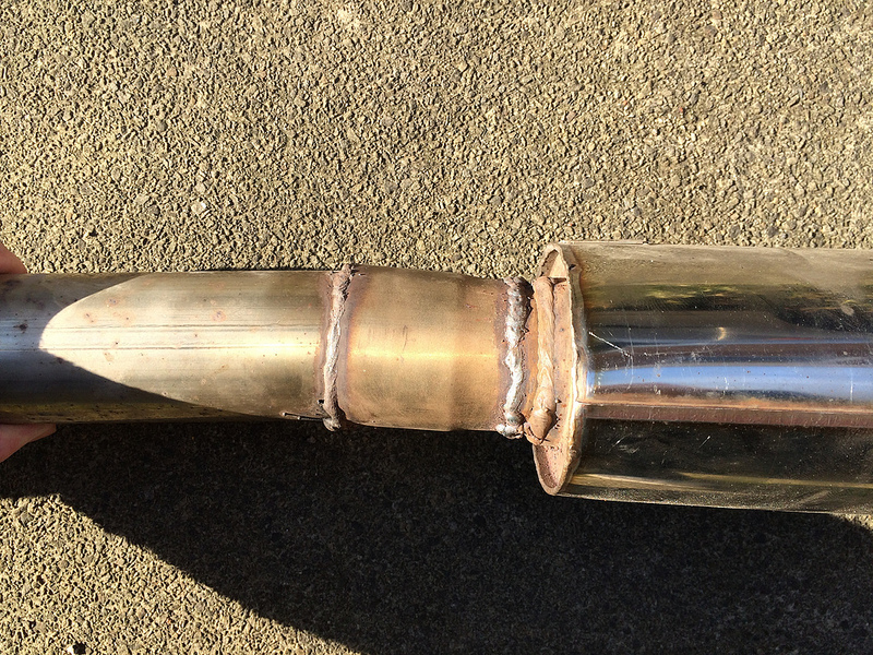

A few days went by and I decided to have a look underneath it. I was slightly shocked! Instead of welding straight bits of exhaust, as it should be, he has used sleeve type pieces of metal (lazy) to connect all the parts back together. Further to this, the sleeves didn't actually join how they should do, so my full exhaust system was 'twisted'. This caused the tailpipes to sit against the bumper, vibrating when at idle, two knackered rear mounts and the cable tie on the centre section snapped as well.
See the photos for more detail of the work done.
Should be straight.
'The sleeve'.

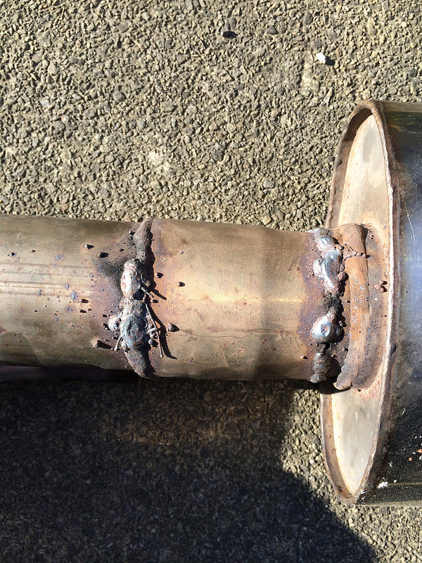

'The welding'.

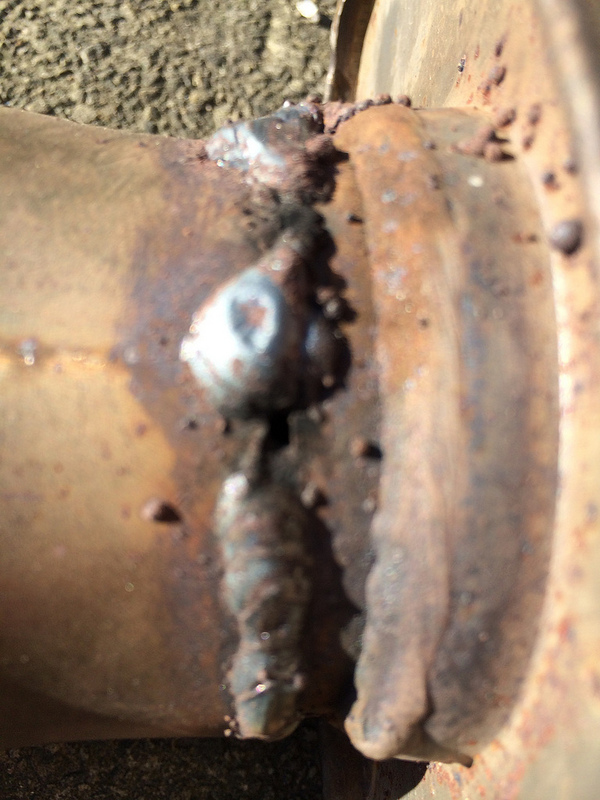

One of the two holes in the welding which obviously caused exhaust blow.

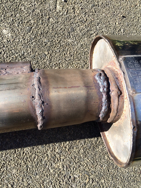

I would be expecting wielding like this (my mate makes exhaust systems in his spare time)
