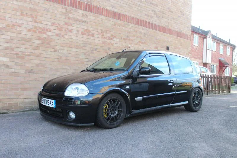

New camera = an excuse for a bit of whoring.

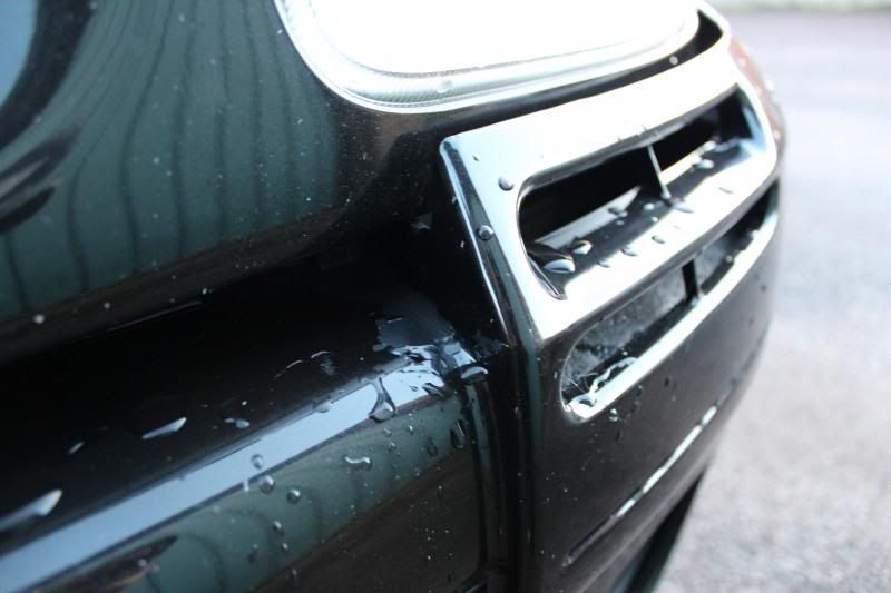

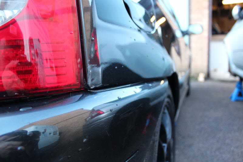

Peeling bumper
Scrape

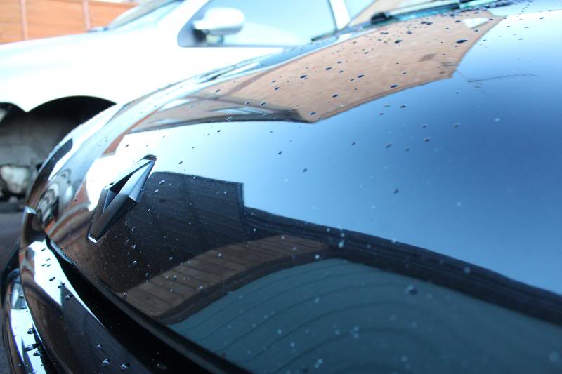

Stone chips

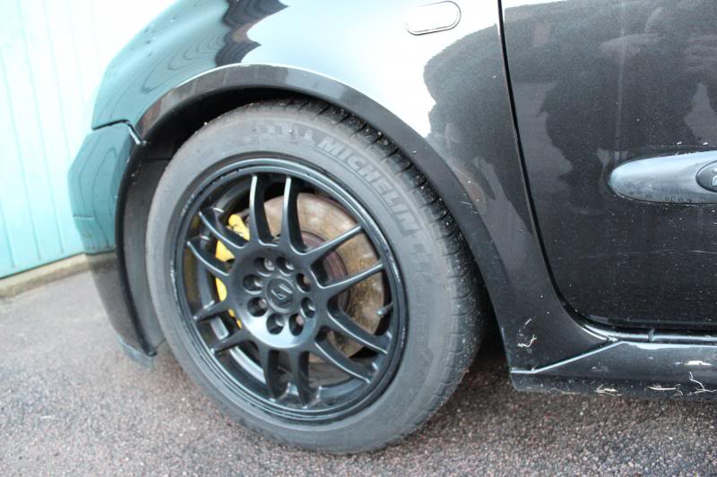

Curbed wheels and s**t yellow calipers.

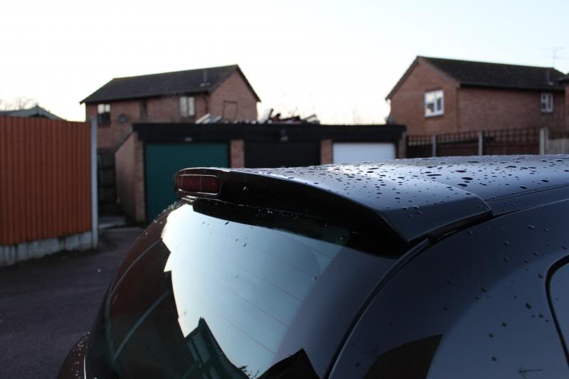

Cup spoiler. It feels great to finally have a ph1 with one fitted.

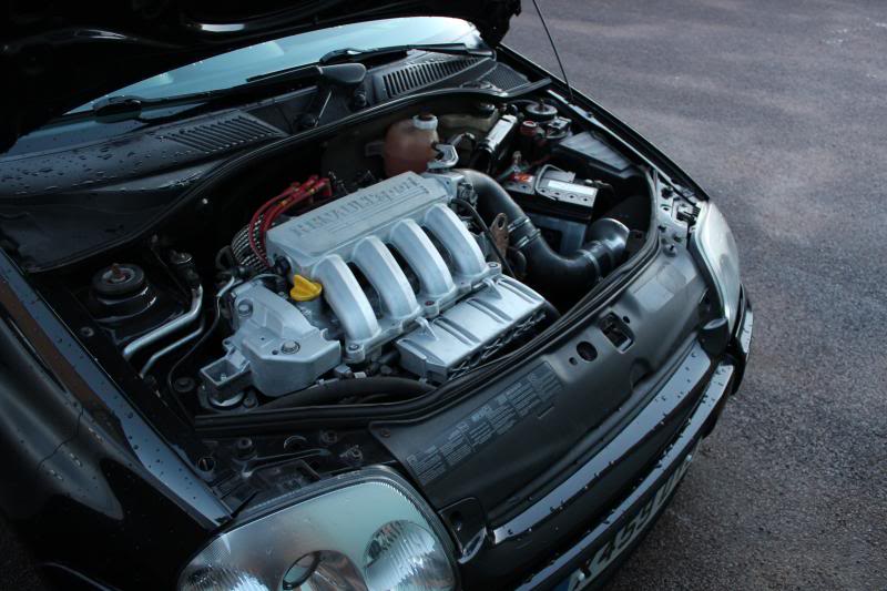

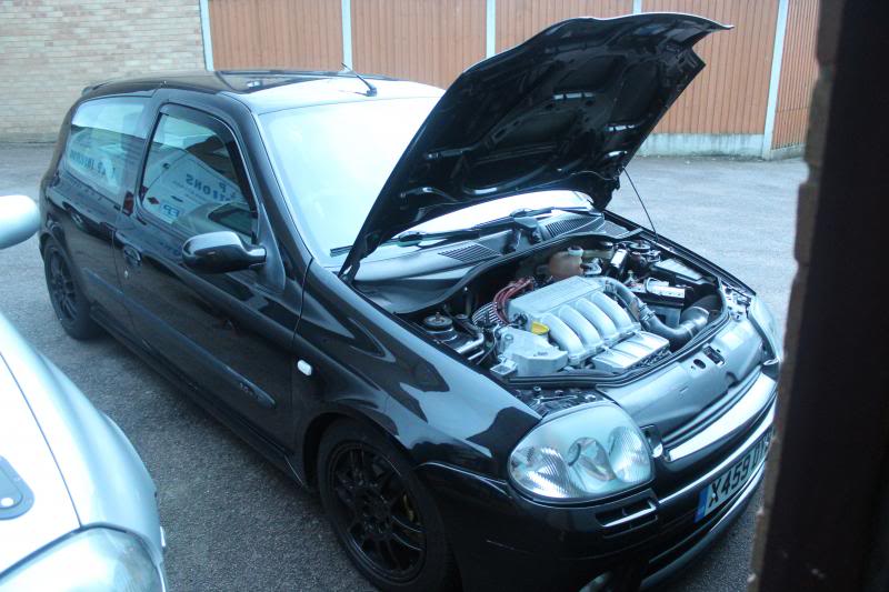

Engine.

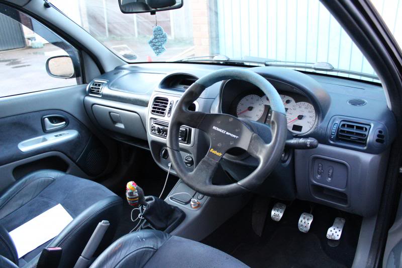

Horrible blue interior.

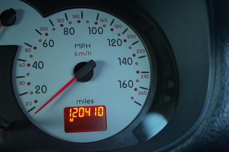

The amount of miles its had its been abused for.
Bit of a negative selection of photos really, there were more but I cut it down to the worst bits.
But lets be honest, for 120k its not in a bad state. And I will happily say its the best to drive out of the clio's I have owned.

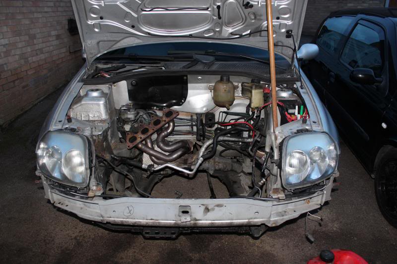

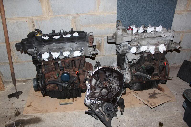

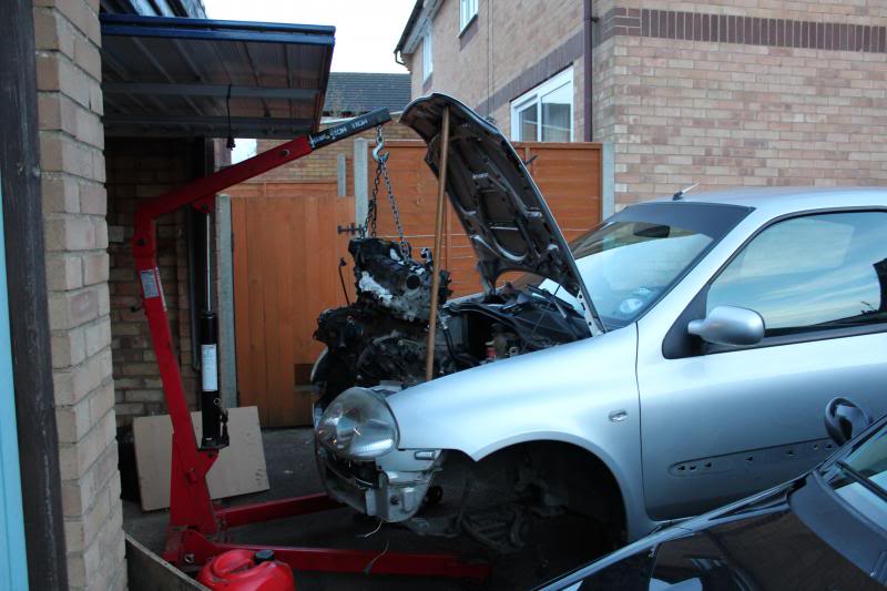

My destruction continues.
Empty space.
And stored, anyone would think I was planning on destroying engines/box's.
The silver car is pretty much done now, got about another days worth of work pulling bits off it and it can be scrapped. Then I can finally start ruing the black car.
  Many.
Re: dmallett's indecisive clio thread! Monaco ph2 pg1+, Titanium ph1 pg31+, PB ph1 pg
And I've not even had any bits off this one!
Good you got the engine out, even if it is the ***** way of doing it.

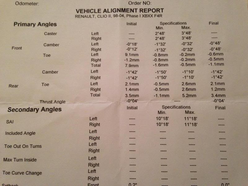

Bit of advice, looking purely at the rear measurements/figures is this roughly normal? Was done 07/13 so not too long ago.

I know I've only just woken up, but bugger me thats hard to read.
You could do with more front camber IMO and it could also do with a small shim to correct the rear toe, 3.4mm is quite a lot.

Agreed what a jumble. 3.4mm is the total across the axle not per side.
You need more camber up front as its only set at 0.8 deg where as the rear is 1.7 deg. The front should have more camber than the rears on these cars for performance, around about the same front and back for tyre longevity.
If you have 15" wheels your rear toe converted to degrees is 0.6 left and 0.4 right. You would be looking for 20' max toe in or out really or 0.3 in degrees.

I dont understand it at all! Its so hard to work it out, il stick my camber gauge on the front and see what sorta camber its reading now for a rough idea.
Ill set the camber up front to 1.5' as thats what i normally run, ill wait until I get the cup wishbones/spacers on first though.
It drives nicely as it is, but I need to get it set up properly :)

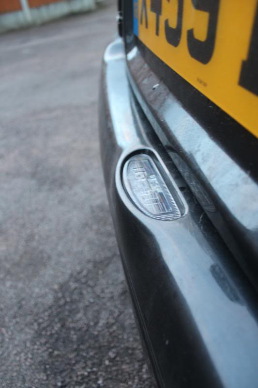

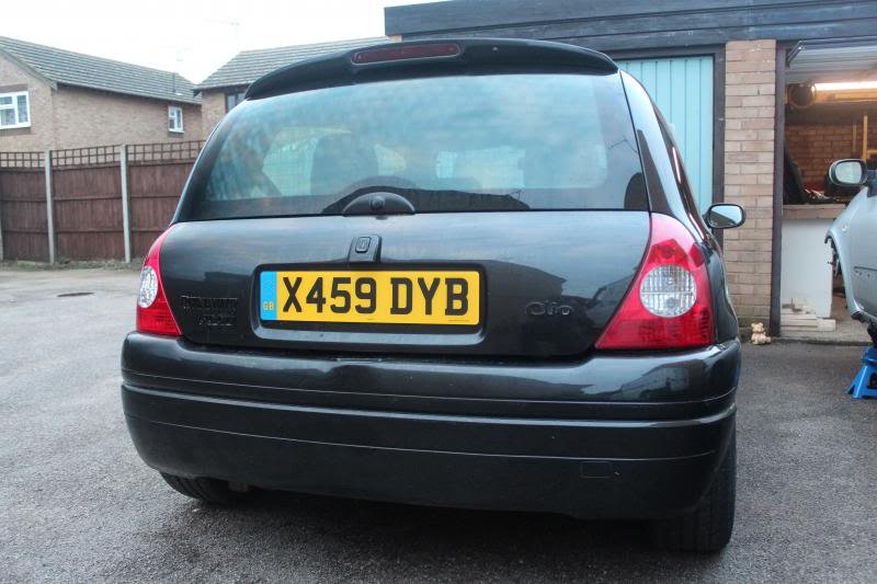

First up new number plate light,
Followed by the rear lights of my titanium/monaco, they are pretty mint tbh with silvertec indicator bulbs.

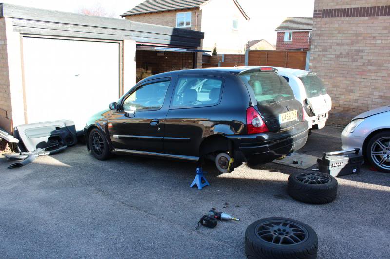

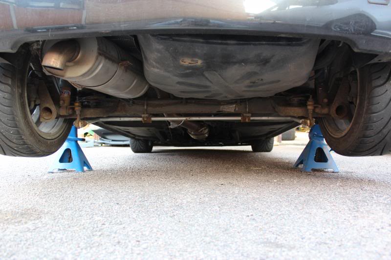

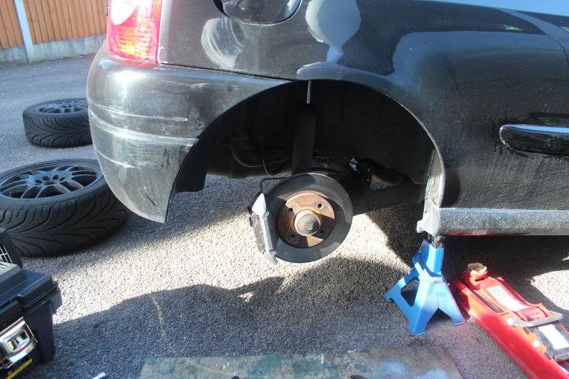

Then the rear wheels were off, plan was to swap calipers to some i sprayed black, fit 5mm spacers, fit whiteline ARB and raise the back up 5mm.
Much better!!

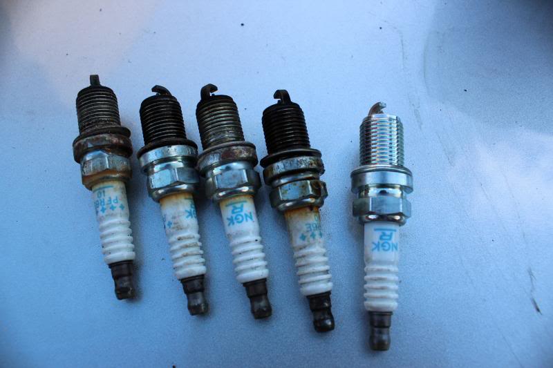

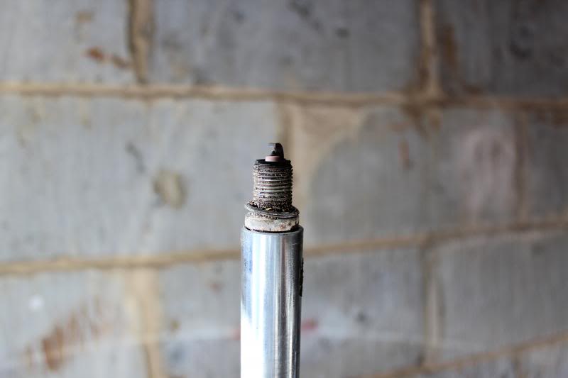

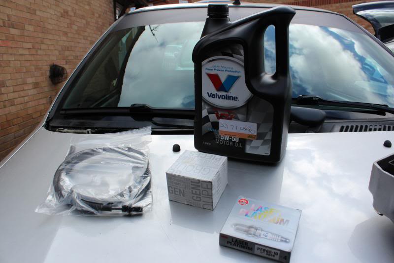

Oil and filter, throttle cable and spark plugs ready to change.
What appears to be dirt on the thread of the plug lol
Old v New.

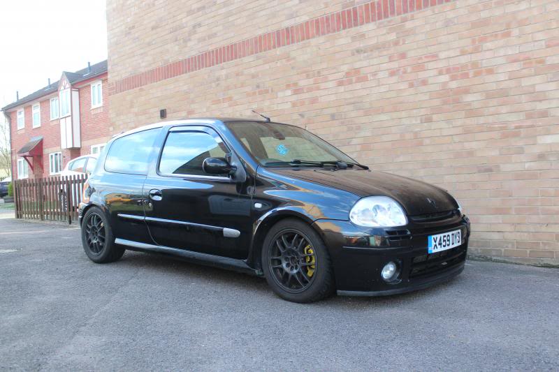

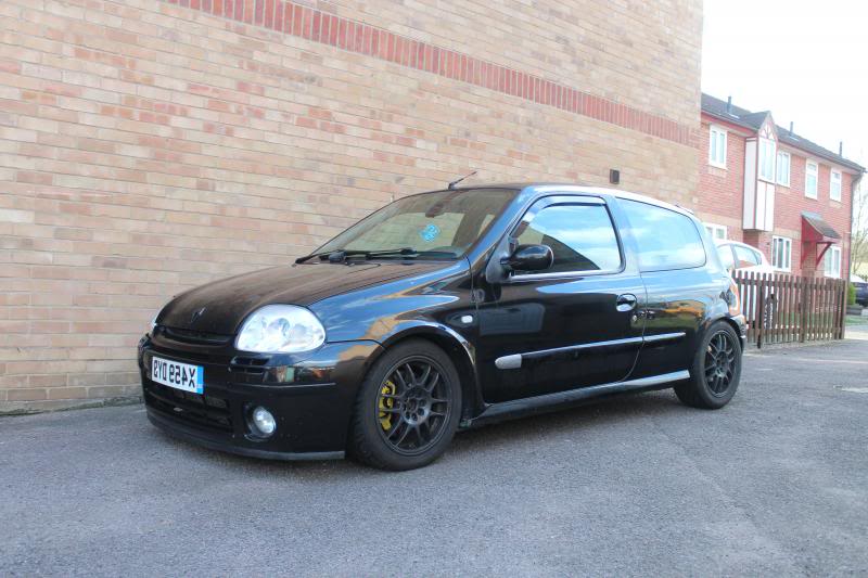

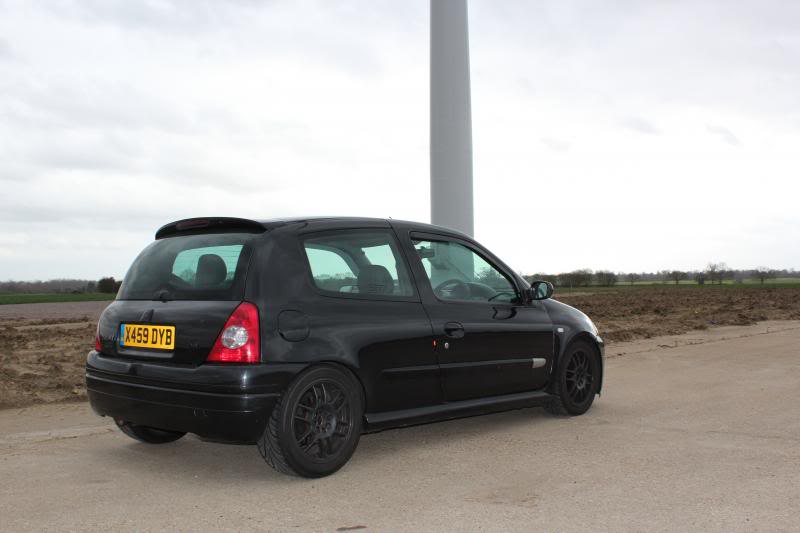

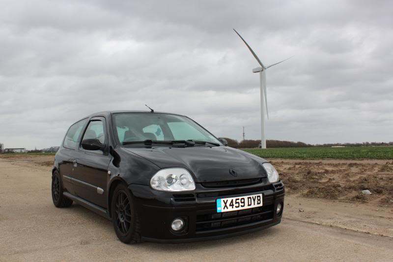

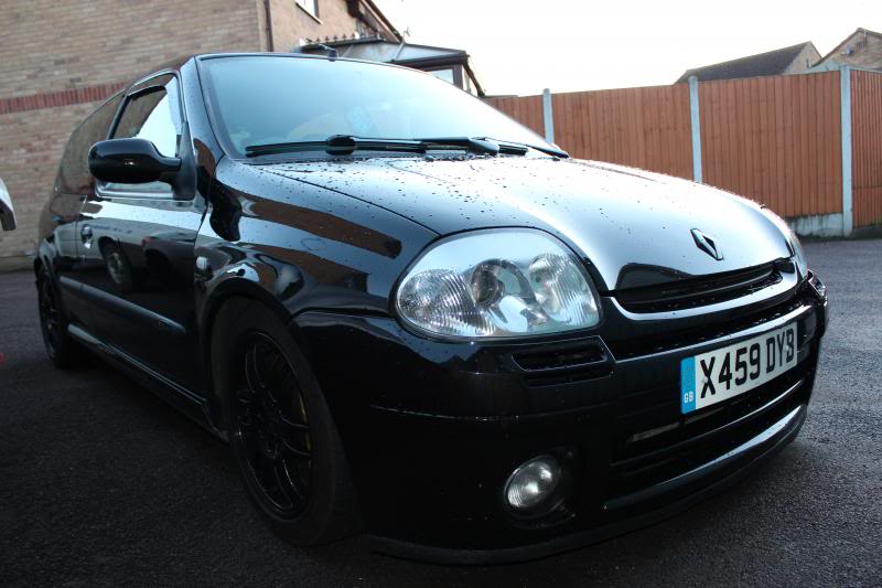

And how it sat at the end of the day, oh and i fitted the ph2 side strips too.
Today was the first time Id jacked the car up/pulled it apart. Didnt find anything of shock/concern really. The engine is breathing abit of oil but not copious amounts.
The black F1's are off the car to get 2 new tyres then to be rufurbished in silver.
@AlexW is popping over tomorrow with the remainder of the bits I need to do the ph2 interior conversion. Im yet to decide what to do about the seats.

I had mm's and degrees confused. Would be nice if it was perfect though!
