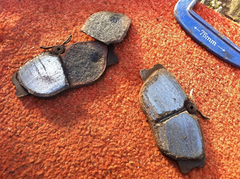

Thought people might be interested to see the state of some 2500's after a few trackdays, 53 plate 172, BMC induction kit, coilovers, R888's all round on 15" superleggera, Volvo 440 alternator mod (no ac) and standard calipers so not particularly special (well, the nasty, dog-eared, stick-on carbon fibre effect vinyl on most of the interior trim is quite 'special' thanks to the previous owner...).

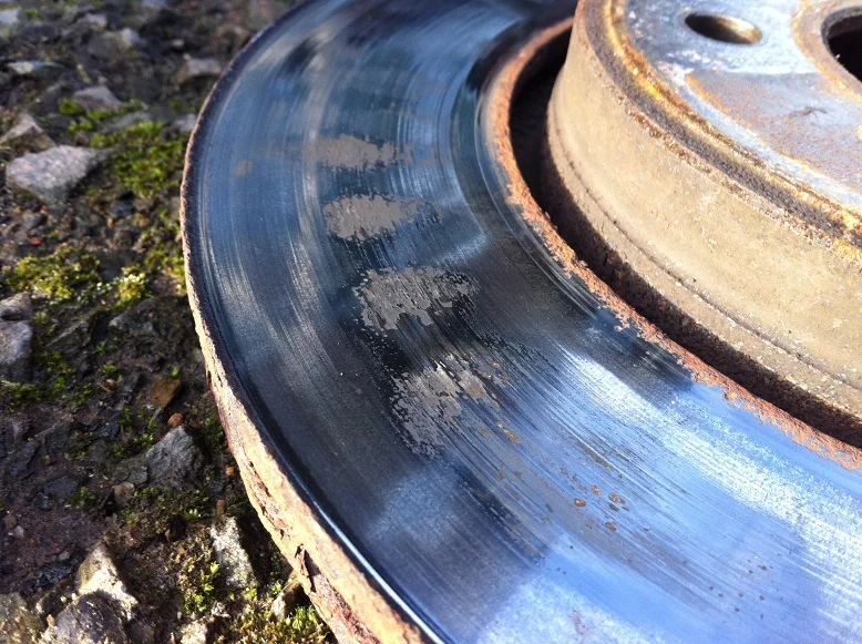

Cadwell twice, Curborough, Barkston Heath and Oulton and maybe ~300 road miles tootling about to work and stuff. I decided to have a look at my brakes after the last day at Oulton. Admittedly I cooked them in my last session of the day after having a ~5 lap do against a RHD E30 with an M3 engine (he was quicker than me by about a car length per lap!). They started to fade and developed a nasty judder after I'd guess about 10 laps. They'd been amazing until that session.
Clearly the pad has laid some material on the discs, hence the juddering, the lay down areas coincide with the ribs of the disc. The pad material could be crumbled off the backing plates with my thumb nail and in one case one of the pads had fallen to pieces.
After quick call to Fred at about 14:30 on Wednesday, I had a set of DS3000's by 11:30am on Thursday (the next day) cheers Fred, great service. Also fitted a new set of discs ready for Snetterton on the 20th. After some tweaking to make them fit and then a bedding in session yesterday afternoon they seem to brake pretty well, even from cold compared to some of the reviews I read on here (?).

You've cooked the hell out of those - the friction material has come unstuck lol
I nearly cooked my ds2500's at Donington - Have you thought about running some cooling pipes from fog light holes and some deflector plates just to get some cold air to the calipers?

Did you fit these from new? How many miles have been coverd on them? I'll stick some pics of mine up later on. They were much worse, but were a good year and a bit old on the car with a few track days on them.
Fitted last February, bought from Fred. Not sure on mileage without looking at the clock, looking at previous MOT and doing some sums, nearly all covered on those trackdays.

I wonder what mine look like, after the last 2 trackdays I have developed brake judders by halfway through the day and have required new discs. How much did you pay for your DS3000's from Fred?

Did you look at the disc faces ? juddery brakes always get misdiagnosed as 'warped discs', but it's nearly always pad material transfer, you can get them refaced if they're in reasonable condition, costs about ~£10 per disc, but when new ones are £40 a set...

Yeah the faces are covered in heat spots, and yeah I know it was probably caused by the pads being very hot whilst stationary and material transferring.

you've simply cooked those DS2500's, they are the bottom of the range motorsport pad and not suitable for more advanced drivers (i bet you got them that hot they were binding slightly when hot, hence the shim removal and back plates need filing down so you have some float)

I wouldn't call DS2500's poor, they are a very good pad for the road/occasional track days, its only when pushing it to the limit on track they have issues, but I think they should really be a sub £100 pad.

DS2500's aren't poor - they're perfect for what they're designed for - road and occasional track. They brake well from cold which is essential on a road car but still cope fairly well with track abuse.
If you cook any brakes they're gonna die
If you're really hammering a track session then you should really be on dedicated track pads like Jay/Tony are - it's too much to expect from road pads
