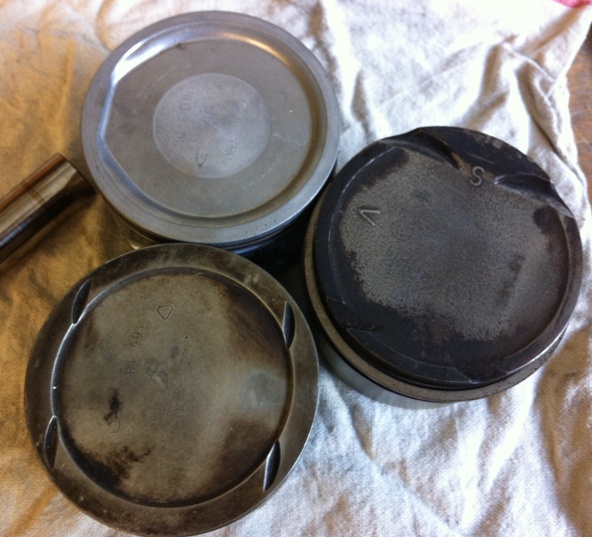

As Laine says, the standard Clio pistons only have small cutouts anyway.
i guess i have a special set of pistons then because they seem pretty big to me, especially as the megane's have none...
Megane sport vs Clio sport vs Williams:
i stand corrected, I forgot mine is on forged Megane pistons and that standard ones don't have the little cut outs in them.
Would be very easy to machine them in though.

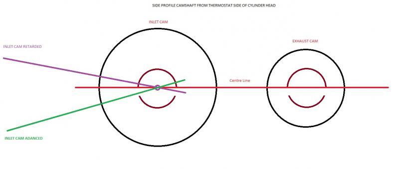

The VVT allows 16 degrees of swing.
CHip ive tried doing some basic reading on cam timing and understand the basics. If i were to change the static timing of the inlet cam to 8 degrees retarded. Which would then allow for a lower 8 degrees of inlet advance when the VVT is energised (and all being well avoid and piston and valve contact).
Advancing the inlet at lower RPM helps the torque, what effects will retarding the inlet at high load / high RPM have (-8 degrees), while keep the exahsut cam at static 0 degree.

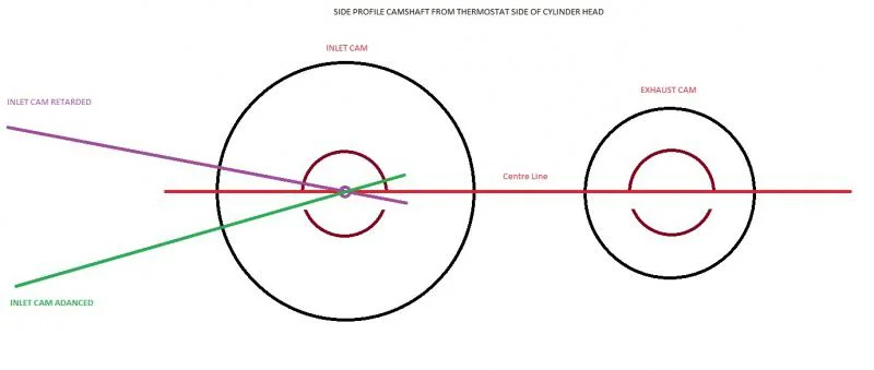

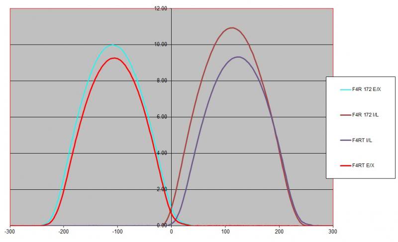

Broadly speaking r****d at high rpm will increase high rpm power as you end up with a situation where by as the induction stroke time base shortens its later in the compression stroke that the power equalises with the inlet ports and ideally you want to shut the inlet valve just as that is achieved. But the devil is in the detail so it depends how far from that point you are in the First place as to if you see the benefit from retarding it.
I meant retarded in the fact the valve opens a fair chunk later than the 172 one. What affect does it have if the inlet closes slightly later (the brown 172 line would shift to the RHS of the purple line by 2-3mm).
Sorry if this all sounds dumb, got a lot of questions flying about in my head and hard to write them down :D
Will reply in more detail when on pc not phone but like I said above, at high rpm the cylinder pressure equalises later on the compression stroke so its an advantage to close the valve later.
