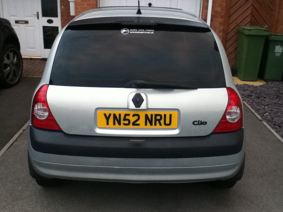

Hi guys i got a 52 plate 172 and there are no pins holding the renault and sport badage but there are pins holding the clio badage bit on. I took all mine off yesterday just to clean inbetween the letters Hope this helps

alright lads, yeah undid the inside of the boot (good idea -Danman-) and could feel two screws up underneath, so would look stupid with the badge off. may see my mate who owns a bodyshop to see if they could fill in and spray the holes, reckon it would tidy up the back end!

If you take the badge off carefully and don’t bend it you will be able to pop it back on no problem after spraying, from what I remember the ‘Clio’ badge is’nt stuck on, it’s only held on by the two pins.
The ‘Renault’ and ‘Sport’ badges are stuck on from what I remember.
I took my Clio badge off when I sprayed mine black. Think the easiest way to remove it is from the inside of the boot lid. Just pull off the black plastic trim (its only held on by about 8 clips which won't break) :) this way your Clio badge isn't going to snap or the pins wont snap. Just get a flat headed screwdriver and push the pins put instead of pulling at them. Clips back into place perfectly :)

No worries :) The front diamond is held on with 3 clips, really easy to pull off. Some people say the clips are really fragile but I never had any problems, just use something to lever it off with.
The back diamond however is a pig to get off :( Once you've opened the boot and took the plastic trim off you'll see the wiper motor. You need to unscrew this (3 nuts) and then you will be able to take off the plastic boot handle which surrounds the boot release. The diamond is bonded on with 4 plastic clips. You do have to break these clips to get it off :/ once I carbon wrapped it I just used clear silicone to stick the diamond back in place :)

Took of both diamonds tonight. Broke one of the pins on the front but that's alright. The back I'm going to leave the diamond in the boot handle and just mask around it then spray. Wasn't actually too bad taking the boot release off although now I have to take down the back seats to get to the boot while I spray. Think the primer is a nice shade. May jus lacquer over the top ha
