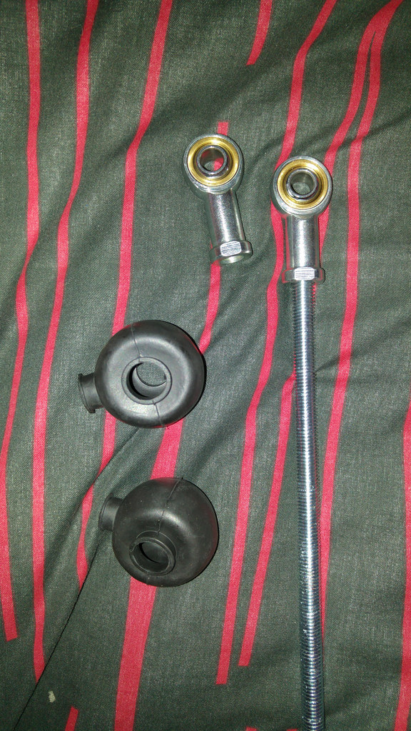

Have found those rose joint covers to be very decent, especially if you keep them full of CV boot grease. :up:
Not going to be able to grease them. Bearings are self lubricating and get funked up with other grease apparently. :(

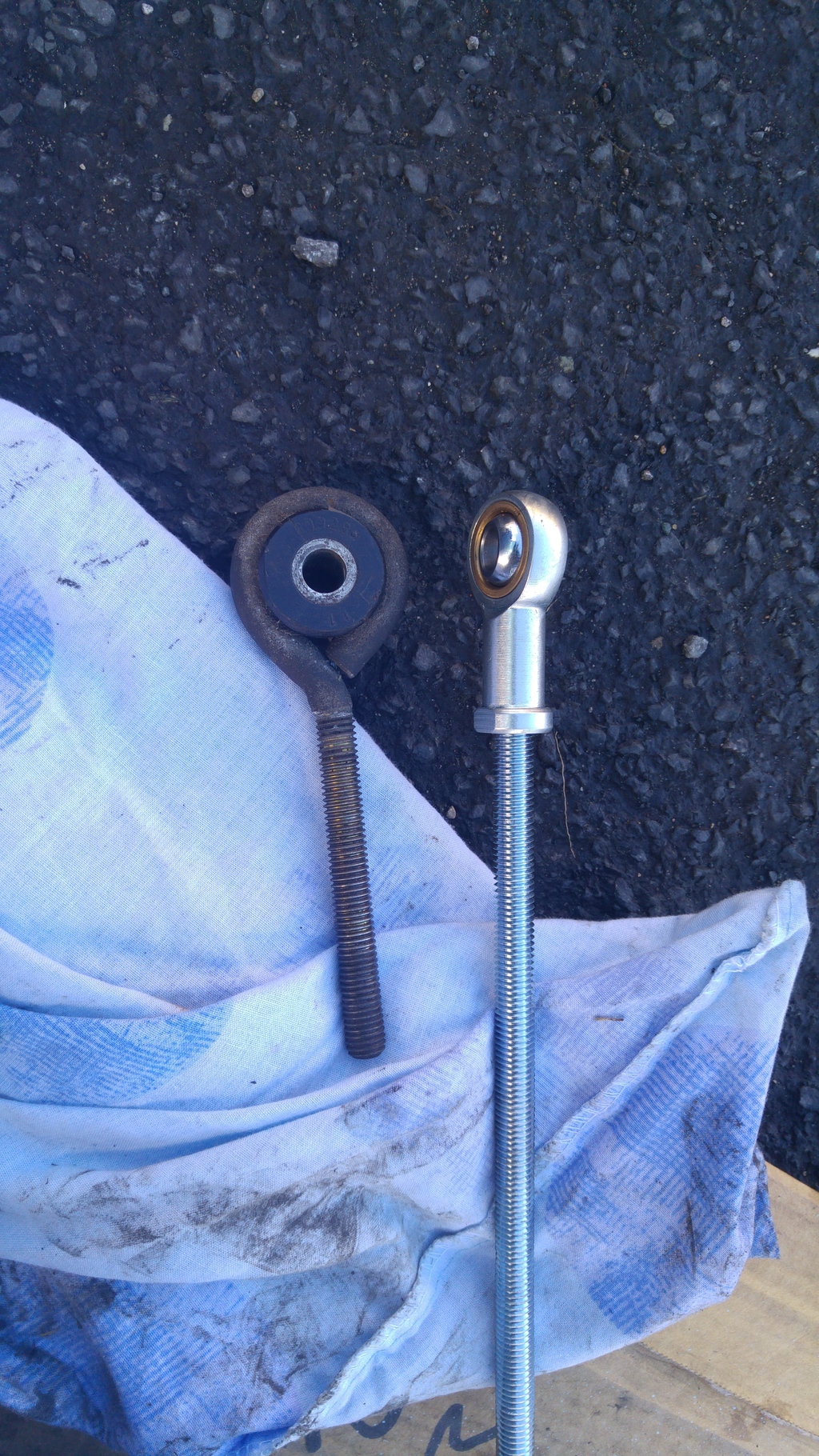

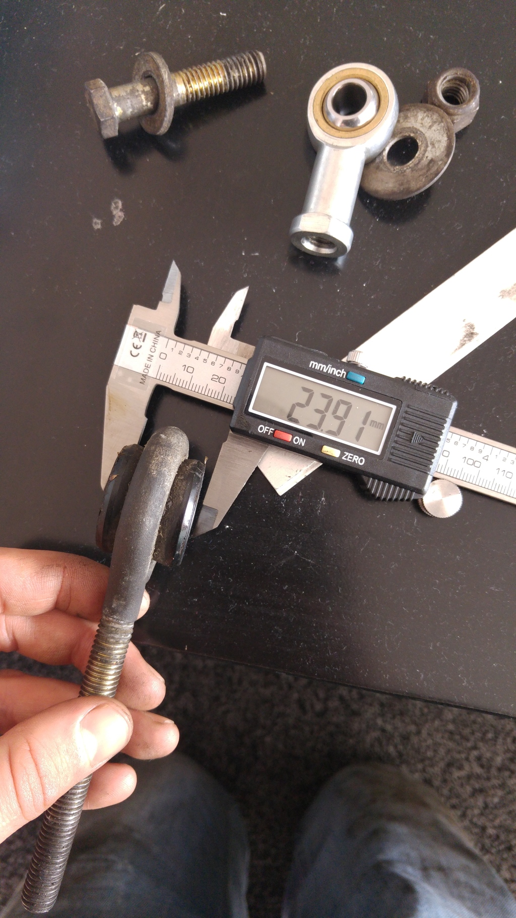

Fitted my rose joints for the arb today. All went well despite the weather.
Before and after

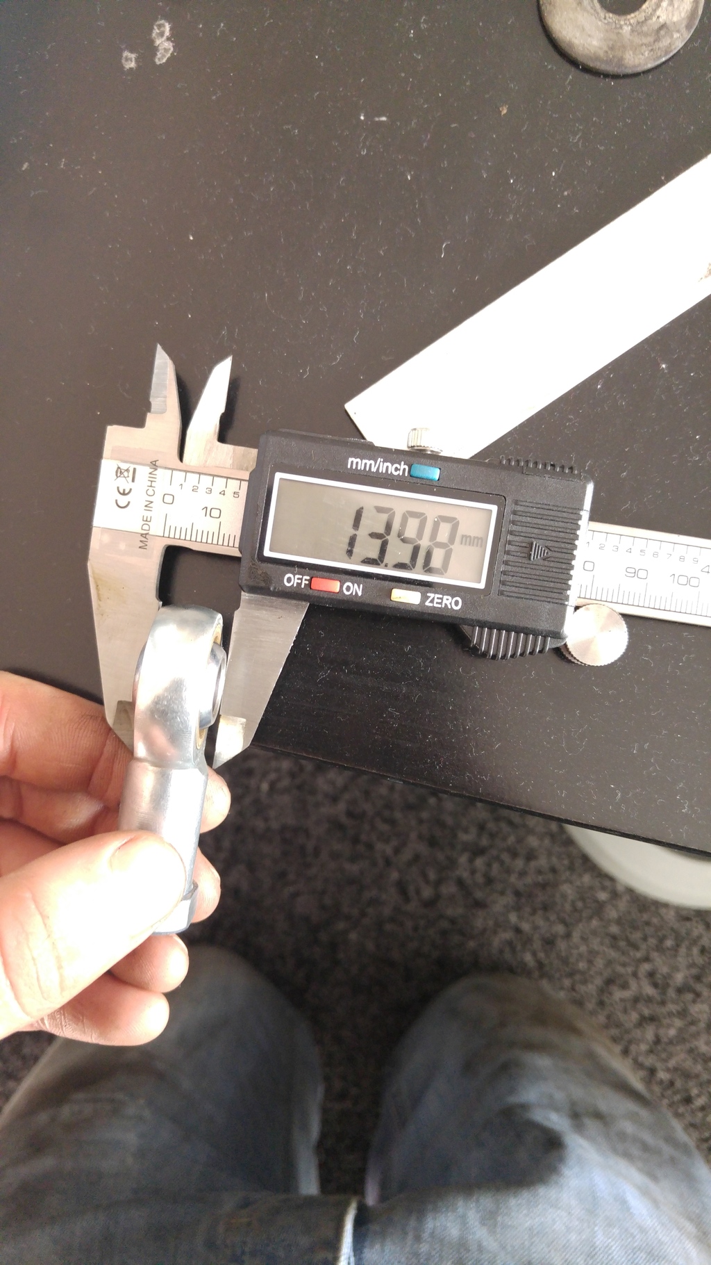

However the old one was 24mm wide
And the new one was 14mm wide insinuating that I needed to make up 5mm at one side where the bolt is in order for the link arm to not be bent. If I was to fit it without spacing it out the link arm would be bent.

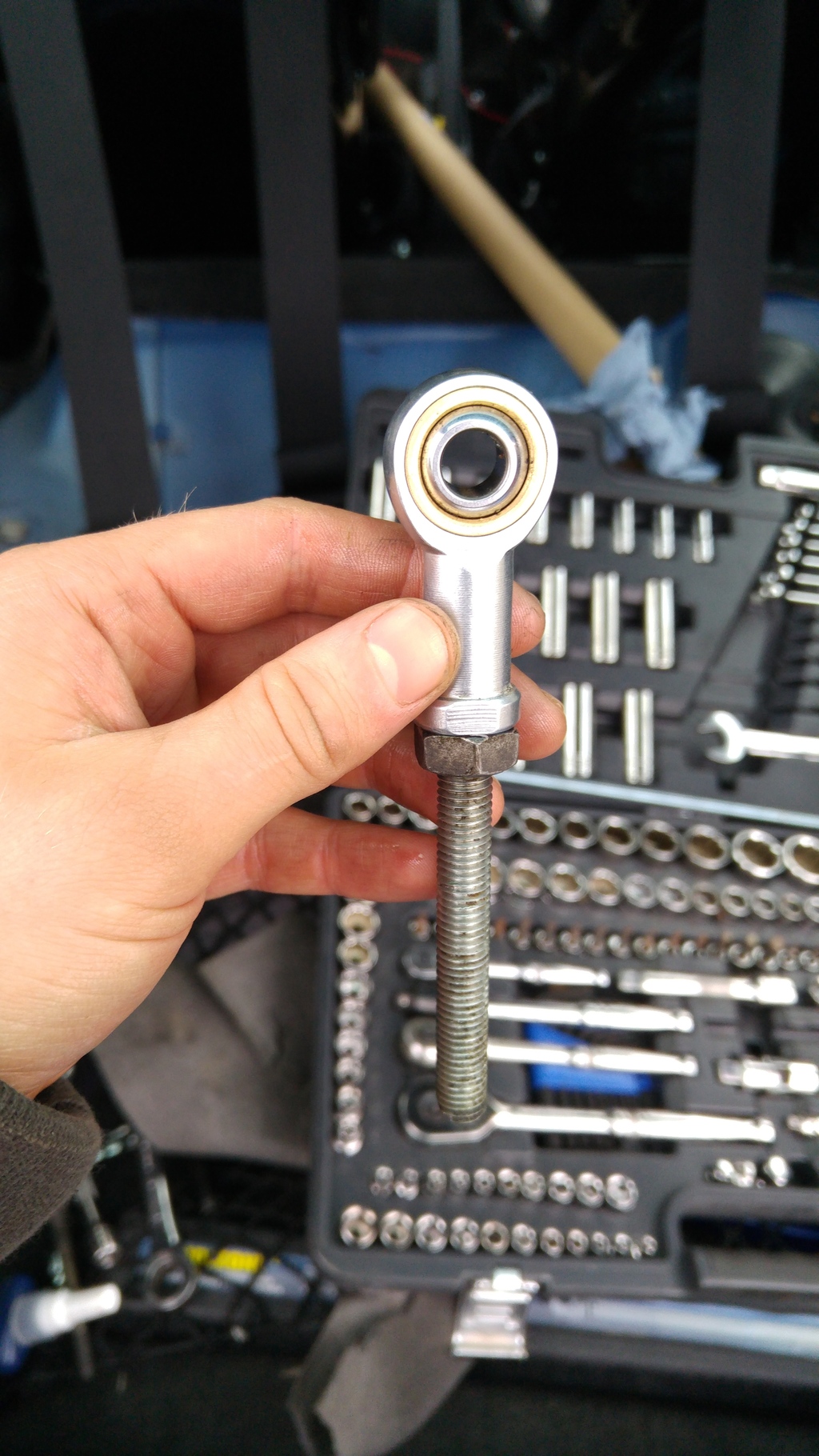

I cut down my threaded rod. Loctited it in and put a nut on to secure it

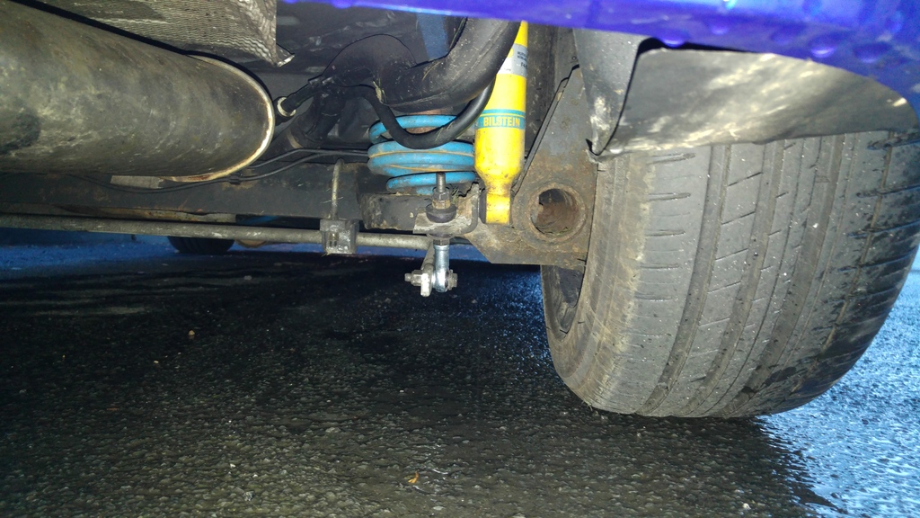

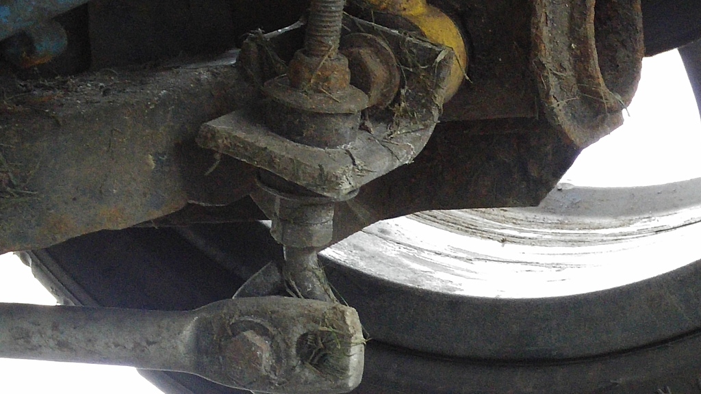

The old one in situ
And all on!
The car feels so much tighter in corners, really happy with them. It's noisier in the cabin but I'm ok with that.

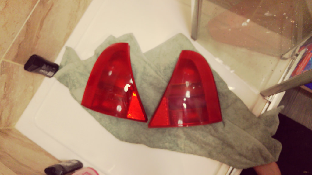

Tonight I finally got around to spraying the rear ph1 lights with the red tint spray.
The hipster filter doesn't show it too well but the left light is sprayed, the right not. I just wanted to get rid of the traffic light like appearance which they have standard. Will fit sometime tomorrow once they have fully dried.
