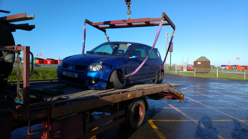

f**k me it looks a write off in the pic! [emoji33] [emoji33] [emoji33]

It does look bad doesn't it!
So basically I have 20mm wheel spacers that are non bolt to hub type. They use longer nuts. I'd tightened them all up the other night but I think due to their length they're always gonna come loose. Had the same problem at Blyton Park. I need some studs in my life I've decided today.

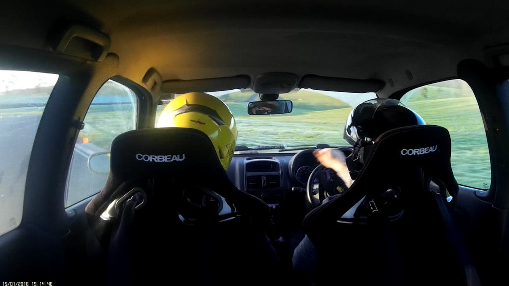

Anyway here's the vid when it happened. I'm going to make a proper video when I'm back home as I'm at my parents house now and their media set up resembles something from the victorian era
And here's a little sideways action haha

s**t mate. See you at the side of the track and was gutted for you mate. Hope you get it sorted and thank f'ck you weren't going faster. Good luck fella

No way @dann2707 what you needing to replace? Wing definitely but is there any other damage?
Ideally a new hub too as when it went the nuts took out a few of the threads. Managed to re-tap them at the paddock though very sketchily but it worked a treat.
Also lost a fair few wheel weights and a wheel nut gayyyyyyyyyy
Oh and reverse is a no go at the moment when I spun off the track the soil /dirt has hit my linkage out of place but that will be easily sorted tomorrow.

I had to run the broken side without a wheel spacer due to losing a wheel nut on track which was the dodgiest thing ever. Completely threw the handling out. When I braked it would throw the car right and even on certain corners I didn't even have to turn the wheel to steer into it I just braked. I think that's maybe what led me to spin a few times after that. It was all a great learning curve.
