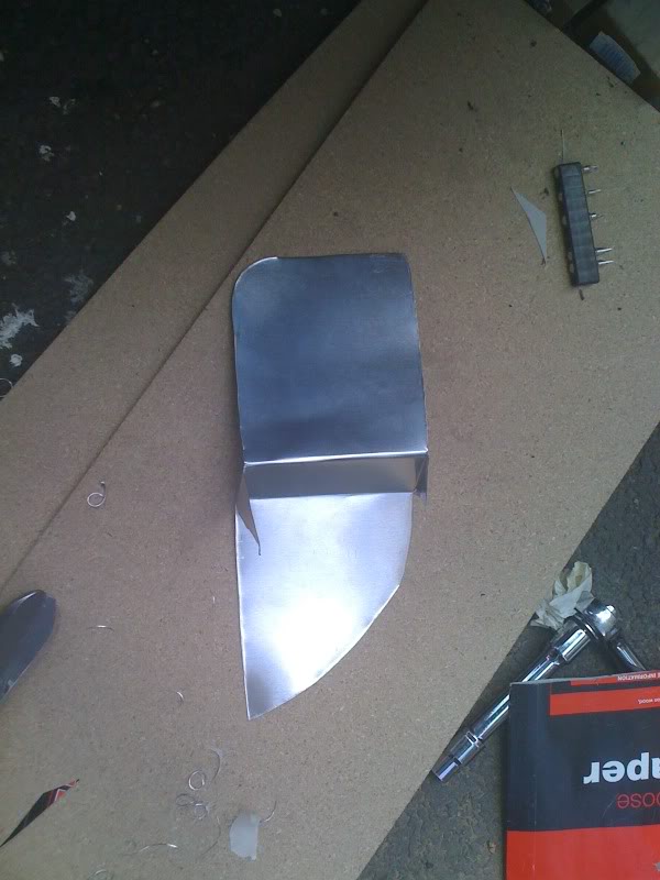

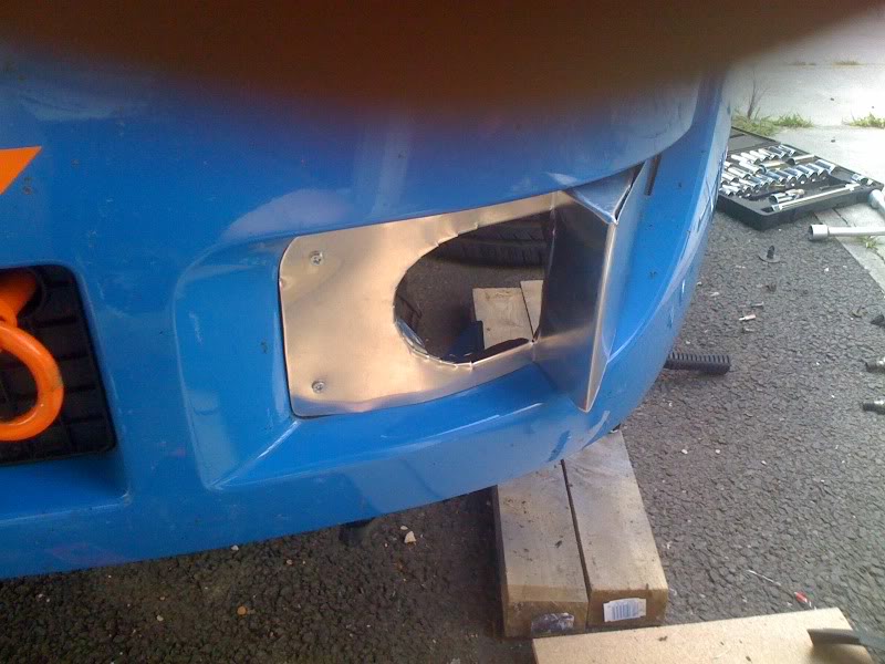

After bedford trackday it was clear that my brakes could do with a little help to keep them cooler. The obvious was to use the fog light surround as most people do, but with the shape of the bumper could see that a lot of air would just go past. Other option was cup racer ducts but couldn't justify the money. So one sheet of aluminium and a few hours later:

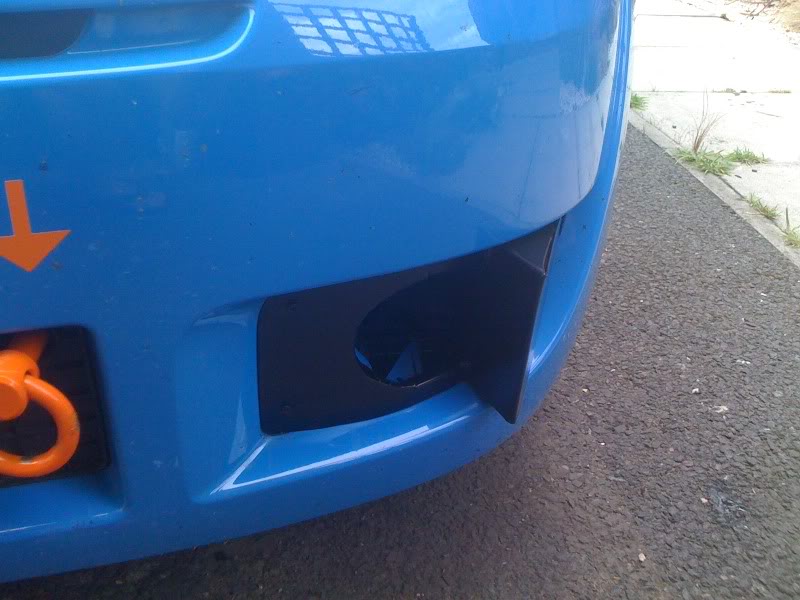

Sprayed with a few coats of hammerite:

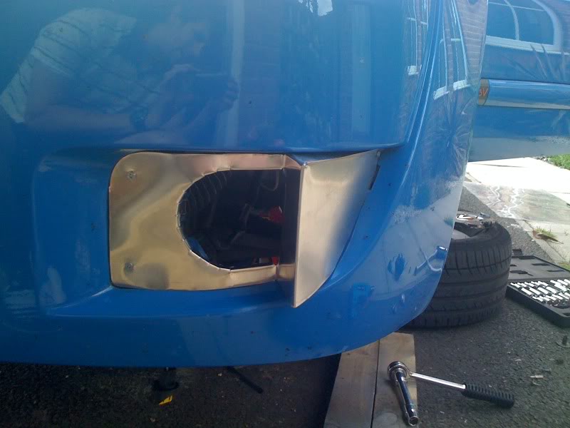

Not the greatest finish, but completely removable (all the fog mounts behind are intact) and hopefully functional. Also knocked up a quick deflector for in the arch. Just got some 102mm caf tubing so need to pop that in at the weekend.

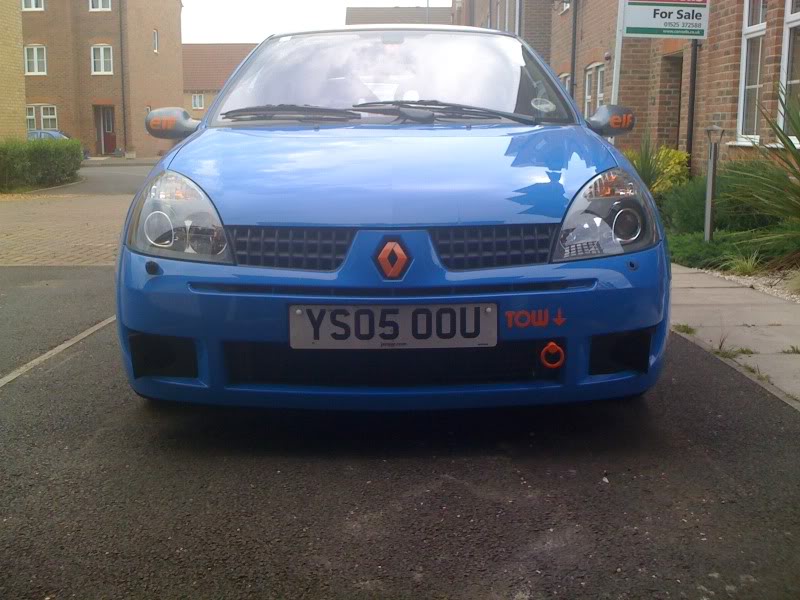

Cheers all. As said cup racer ducts are £150+ and you have to cut out the fog light mounts to fit them. These were under £25 including the caf tubing and completely removable :) Whole point of the car is track functionality but me being me i might make them look a bit neater soon.

I cringed when you showed them on the car bare aluminium and expected to see hilarious comments, but in matt black the look pretty damn good! Great job!

The finish is pretty rough but it's not a bad idea. Maybe if you got the shape spot on you could have these laser cut for relatively little money...you could even have the fold lines etched on. Then it'd just be a case of folding them up like origami with a couple of wee spot welds to hold them together. No way I'd spend £150 on a couple of bits of fibre glass. DIY ftw! No need to spend huge amounts of money on bought parts a lot of the time.
You should test them out and see if they work. Could back it up using a brake temperature strip that shows maximum temp before and after...but if you eradicate fade you'll know yourself it was worth while. Prob. not going to be as good as the cup racer ones but at a fraction of the price you can't complain?
