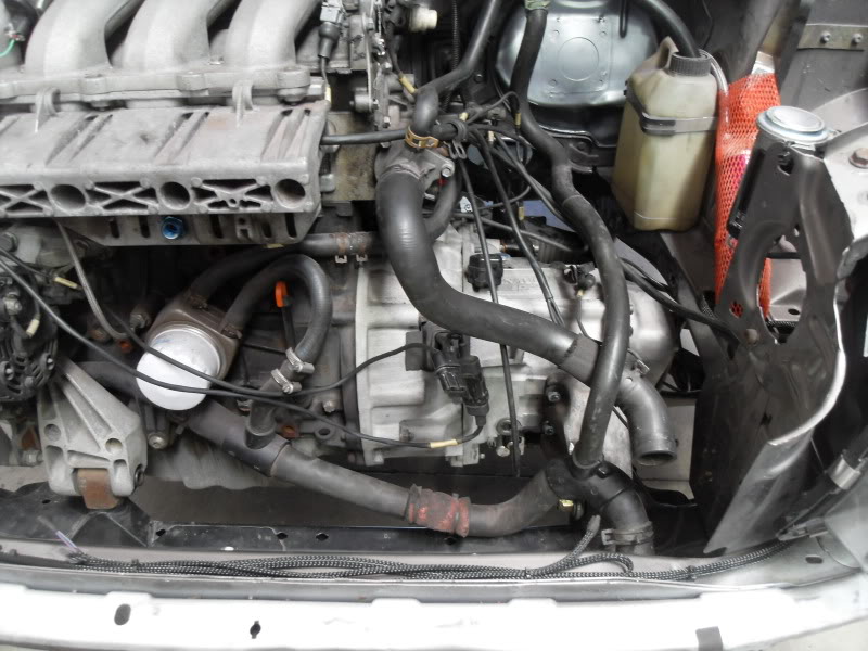

I know the cup racers are fully subframe mounted. a lot of people subframe mounted their engines in mk1 clios using the mounts from the R5GTT (as they came subframe mounted as standard).
I was hoping someone could tell me if the cup racers use the same mounts (as the rear section of subframe is idential) as the R5GTT on the rear? because im not sure if it will get around the exhaust manifold. And if not, what mounts are they using the mount the engine as im thinking of adding it to my very long to-do list.
any pics of the cup racers engine mounts would be absolutely amazing!!
thanks guys
only one i can find at minute on the forum

The rear mount gets in the way so you have to re-jig the linkage to make it fit , genuinely interested to see if you get this to work.
Gate throw felt all wrong on the rigged up linkage I used. :)
