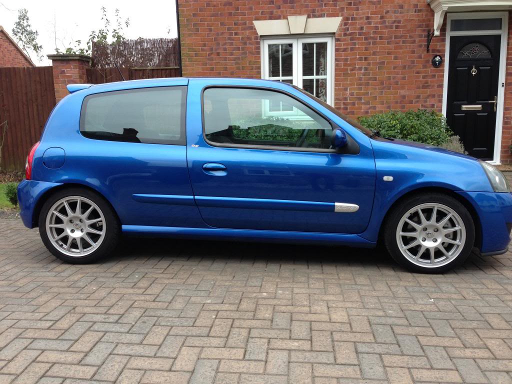

  172 Cup
My cup about 15 minutes after the springs were fitted with new shocks etc.

Theres probably pictures in other theads but Chip, have you got any pictures of the car sitting on the springs do you?
  182/RS2/ Turbo/Mk1
Took it up the multi storey (flat surface) and took some before pics. Will go back when its settled. Also measured all four corners from wheel rim to arch, will do that again too.
