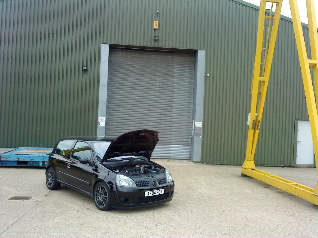

cat mod + centre section removed + matched/painted inlets = :)
  b/g 182, meg tourer

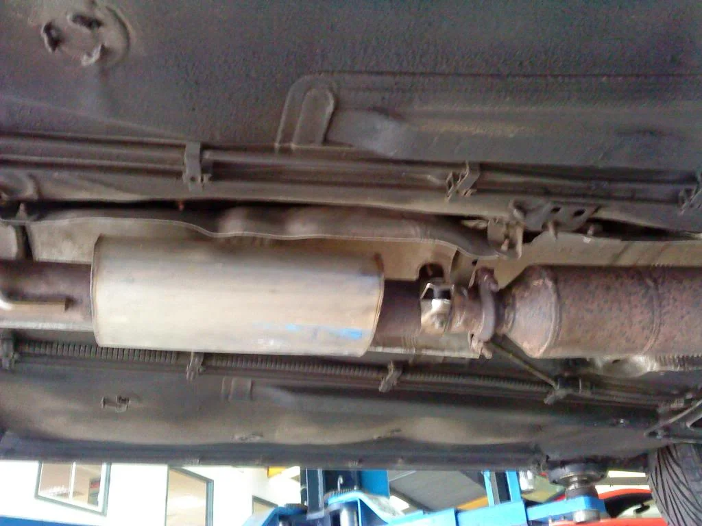

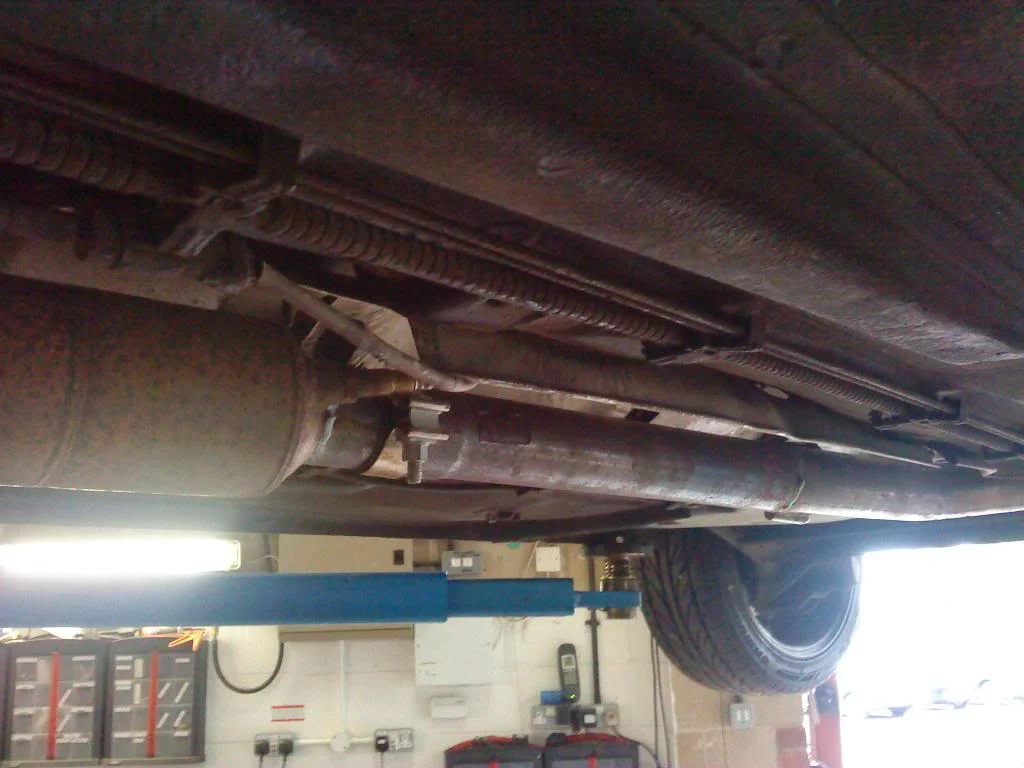

well as the miltek centre section sounded like the baffles had gone, myself and luke at jabbasport decided it would be the sensible option to cut it out and weld a straight pipe in its place. as it needed a little cutting and welding anyway i remembered reading D4ve's thread http://clio-motorsport.blogspot.com/...ification.html so i decided i was going to do that too.

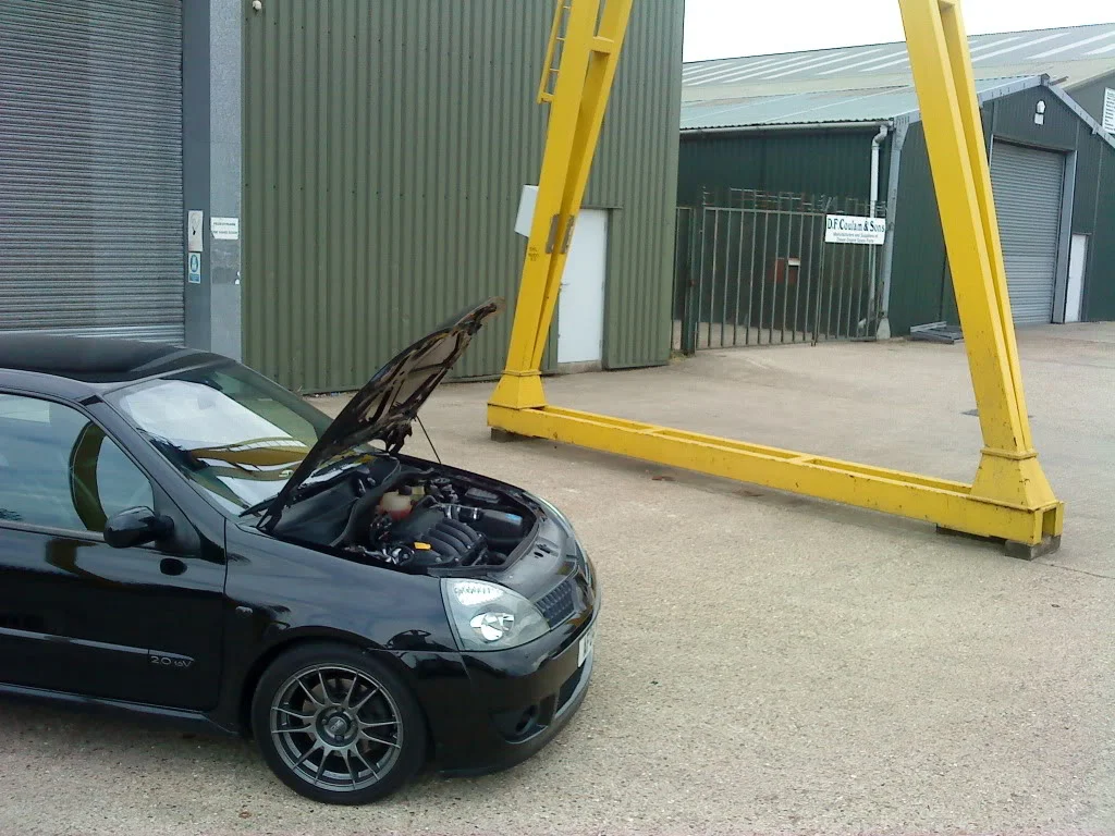

here is the cat and centre section before...

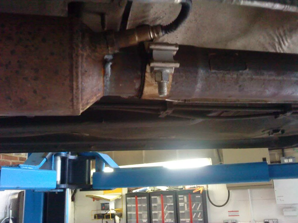

and here is the cat cut and welded (stainless welds) to a full 2.5" bore straight to the back boxes...

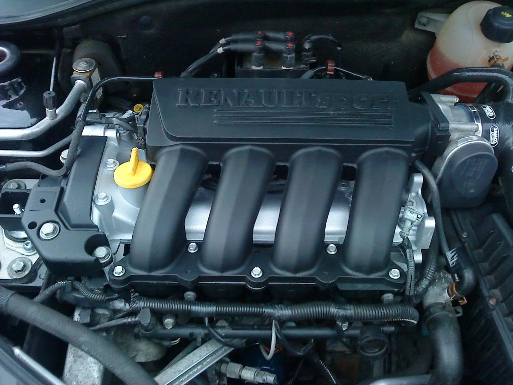

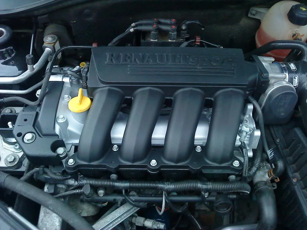

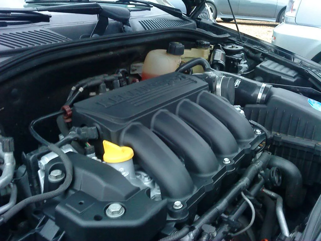

also while the car was at jabbasport, i had the inlets matched and painted. no before and after photos of the matching im afraid, neither do i have it on a rr. but the mid torque feels improved, and they look great imo.
so here they are...

oh and by the way... far better with the centre section removed and the cat mod rather than a decat imo. no hassle with mot's or police. and you get just as good if not better noise than a decat gives you and its not boomy or too loud with normal driving but as soon as you plant your foot it brings a smile to your face :) great mod for the money!

mid torque is definately improved from the matched inlets. so happy with all of the work that has been done :)

That's a very nice looking engine bay. If only I could be arsed to make my own look half decent...

thanks. on a budget, the best way of making it louder/better sounding would be to remove the centre silencer section, remove the top feed to the airbox and the acoustic valve.
Wheres the front bit of the inlet gone? The bit that sticks out whatever its called?!
the fuel rail guard is off atm. took it off for them to paint and left it off, not really needed tbh. just extra weight. oh and stops the car blowing up in a front ender apparentely.
cheers mate. really happy with the bay. not a lot done to it tho really. i dont like fussy engine bays, it works and its tidy enough for me :)
  b/g 182, meg tourer
Normally i don't like painted engines, but that looks nice and tidy.

What type of paint is that mate, looks nice and tidy, not into glossy in the engine bay

my missus works for a metal company so i got her to pick me up some 2 1/2 inch stainless tube, gonna hopefully get it engineered to be a pattern part as the centre silencer but obviously just a straight through pipe. think you may have started a mini trend luke ;)
  b/g 182, meg tourer
cool, that should work. i did away with the joint on the back of the cat (as you can see in the pics) as it just tends to blow/leak. best to just cut the back end joint of the cat off and just weld the pipe straight on :) not my trend tho mate... christopher, dave and a few others were there first. well worth the money/effort tho.
not really sure, its not high temp or anything. pretty much just mattew black paint.
yeah im not going to do the cat thing just yet, although i do want too. gonna get this bit engineered then go from there, i had a look and it can be easily done at a later date from what im doing :)
