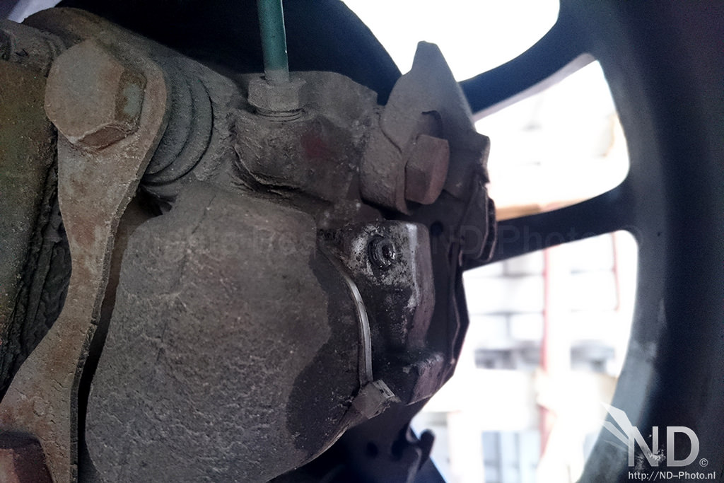

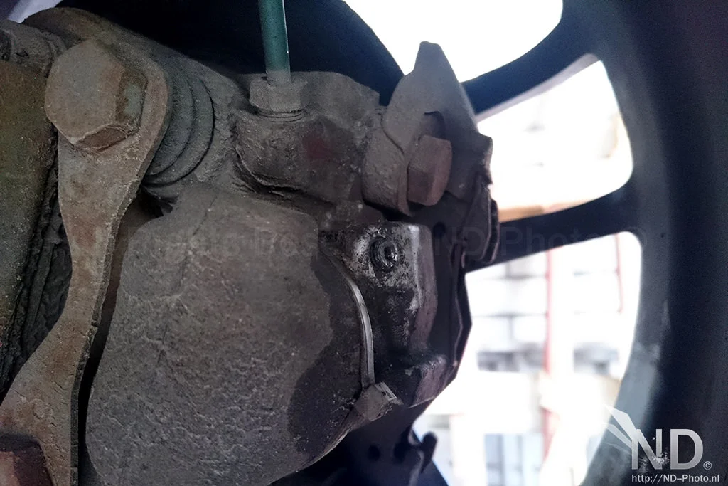

Ok, so when I did a full service not too long ago, both bleed nipples of the rear calipers sheared off. I didnt even put any big strain on them...Anyway, I will have to replace them eventually,
Broken Bleed Nipple by Andy Ramdin, on Flickr
1) are these the correct ones? http://www.ebay.co.uk/itm/231465144606
2) Anyone has a good tip on how to remove? I wanted to slam a torx bit in there & try to get it out. There isnt enough to hold on to it with a good grip wrench. Worst case scenario: drill it out?
I have a pressure bleeder (Eezibleed), so small bits wouldnt be able to stay in the brake lines.

You sure you can't get it with some decent mole/vice grips? Looks to be a good couple of mm free there. Failing that you could try some bolt/stud extractors. I have a set made by Irwin, but it only goes down to 10mm I think. They do sets with smaller ones though. They bite into the outside edge as you turn.

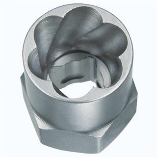

Something like this

Thanks! Will be ordering them.

try some left handed drill bits. normally when you get close to the size of the thread it will pick up and start to turn it out.
