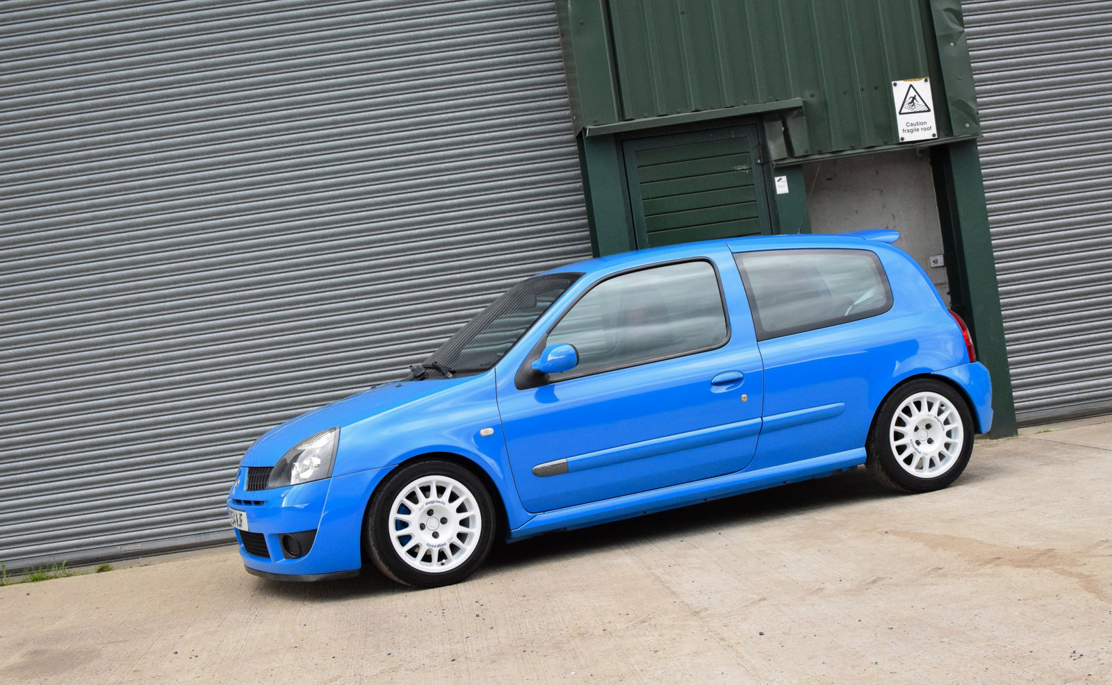

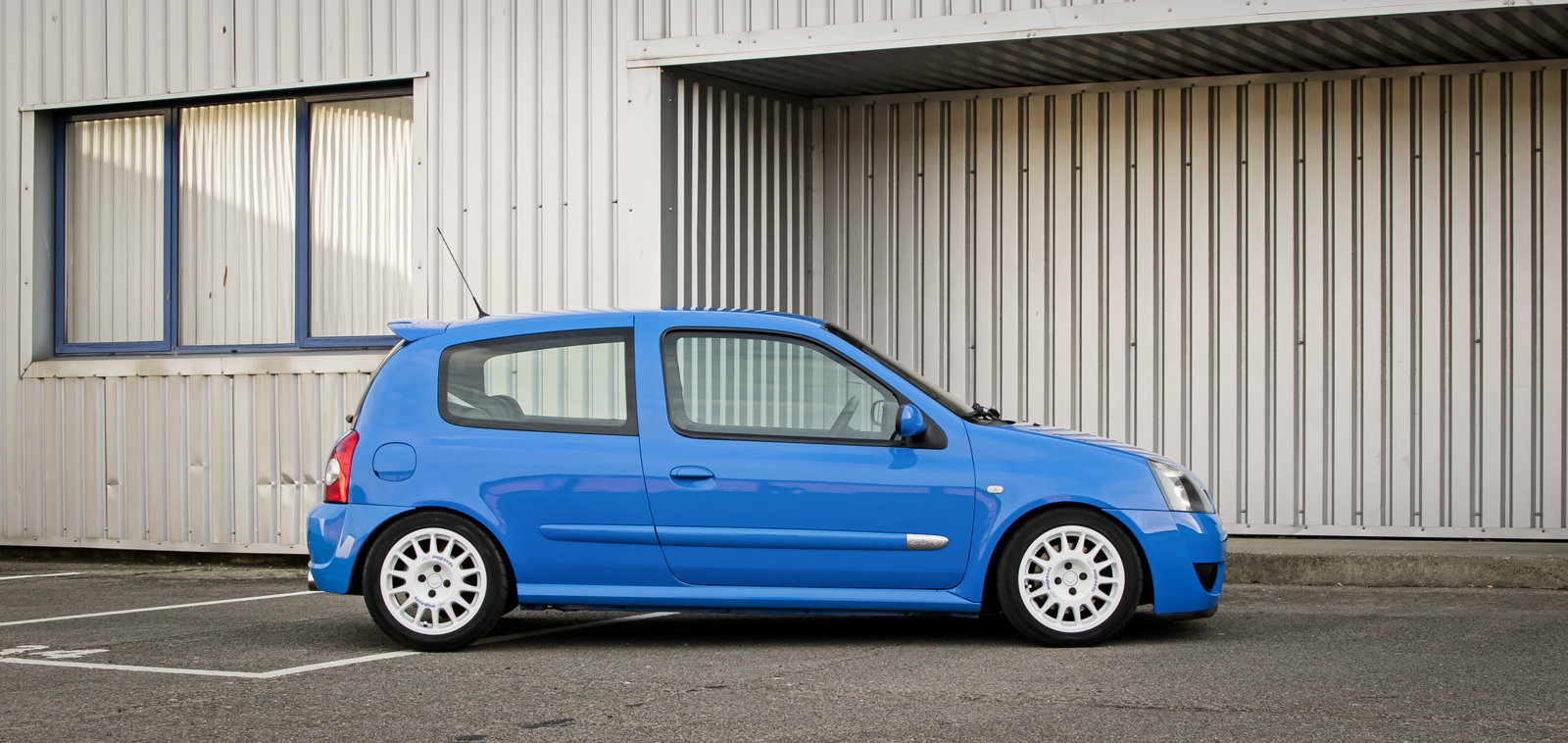

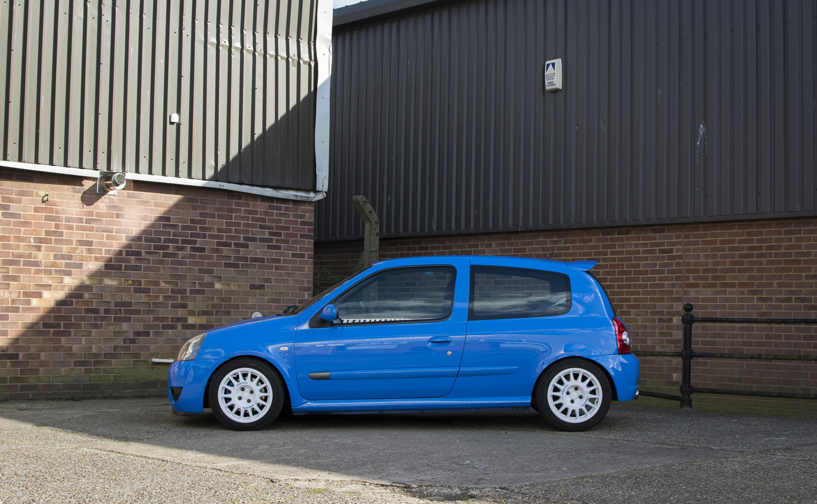

Jekyll
No mate. I'm on 15s. Here's a few pics to show how mine sits:

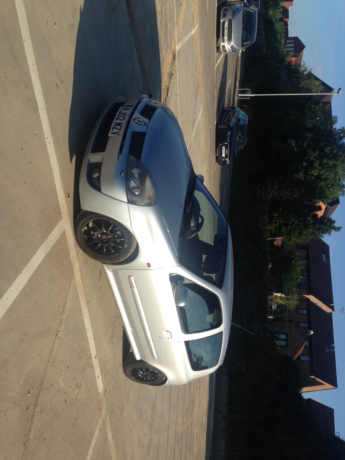

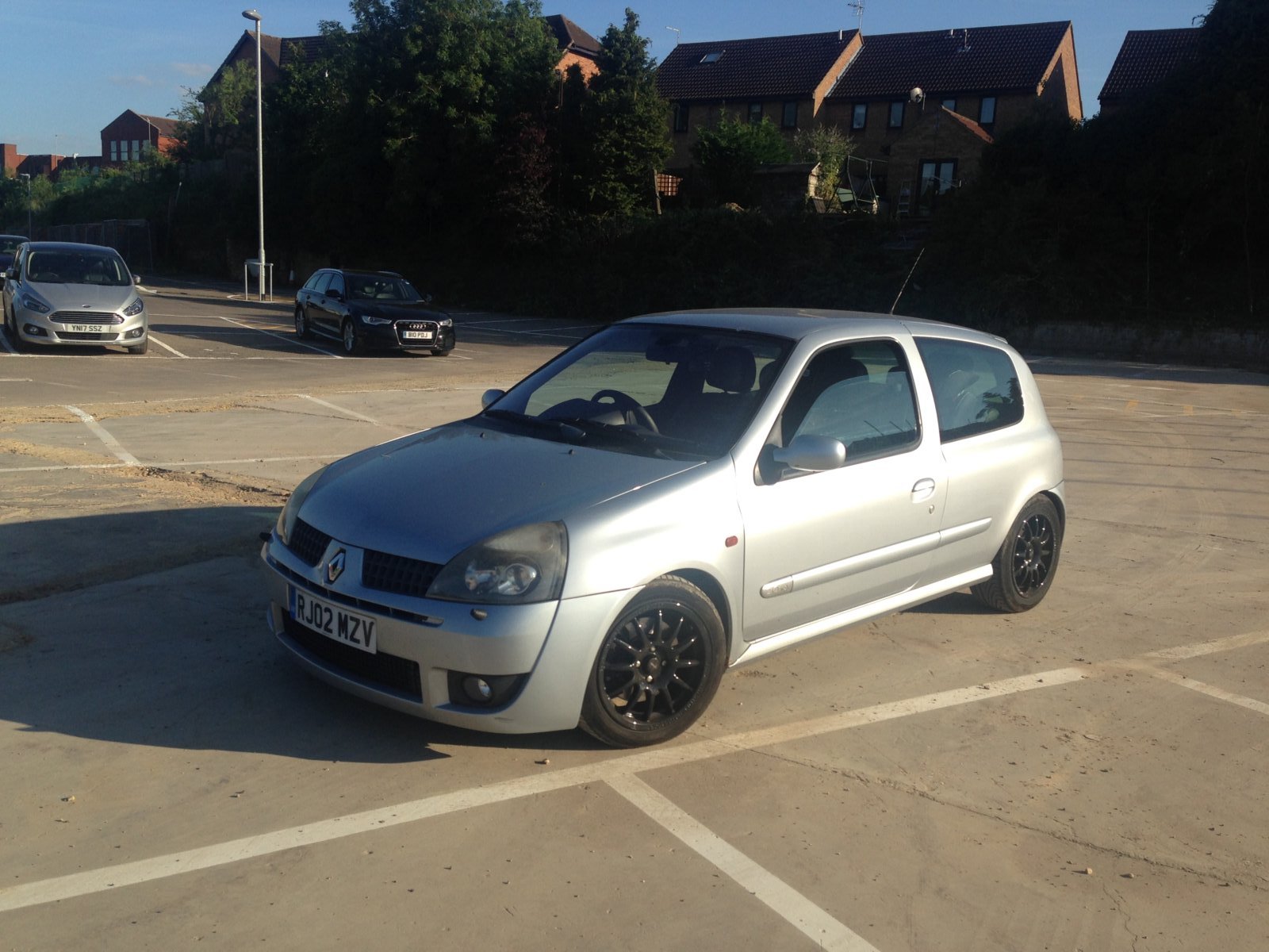

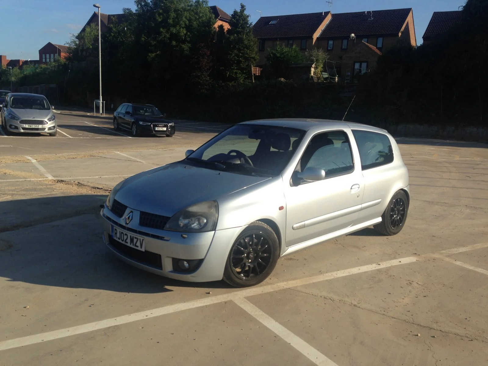

Rojer
Looks like we have sorted it, lowered the front and now its so much better! Also flipped the rear springs and adjusters as they were upside down apparently. Can't believe how much better it is now, just need a proper setup next week and should be good to go.
