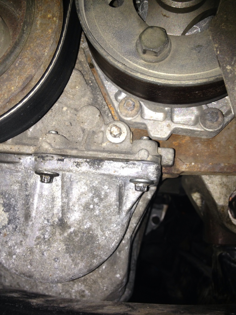

I have a bolt in mine

I've just had a look at ours, and yes there is a bolt in there.

Good question, but I don't fancy taking it out to find out.
Try Fred or Danny, they should know.

Looks to have had a bolt in it untill recently, you can see the corrosion ring. Holds on timing case to engine ..no?

It looks like a bolt holding the front cover on , I'm sure it was going to cause problems it would be leaking by now ?? the front cover is also held in place by the sump as well.
Looking at your photo , and the access on the car , you should be able to helicoil it in place for peace of mind

Haha tis very true! I ran the engine up last night for 20 odd mins so I hope not :dead:
Yes I will check Monday morning just thought I'd put this up over the weekend so I didn't have to pester anyone at the weekend :)
Yes that was what I though put look to hold the water pump to the block to me!

no its not the water pump , you can see that clearer on my pic , water pumps to the right
Yes it does look to go quite deep and there is a hole at the end which was the bit that concerned me! True but the engine has always leaked oil on this side and is gradually getting worse so was looking for where its coming from!
Thanks for that mate :)

its easier for me to see as I have my car up in the air on the ramp , and a spare engine on an engine stand under it !

No you want a bolt :D

thats the oil pump cover, if its not leaking it should be ok, where the f**k has that gone? (we didn't touch the engine incase people think its BTM being shoddy!)

Mine was also missing and I noticed because it started leaking oil. Put a bolt in it and don't be so shoddy ;)
Haha that is what I thought and lucky it didn't get stuck in the belts lol!
Sorry no of course not mate :)
Ahhh yes I have spent ages looking at that area of the engine in the last few days as I can't work out where its leaking oil from :(
Haha okay lol ;) I will call Renault in the morning and collect it on the way to testing on Tuesday.
Does anyone know the name of the daft head on the bolt so I can get the required tool to fit the bolt? :)

Touque headed bolt (think its spelt like that)

If not leaking, ignore. If leaking, consider fixing.

It doesn't seem to be leaking from that hole no mate :) It is leaking from where around there though! Bloody french cars its been leaking for months but it's getting worse so don't want it to suddenly dump its contents lol

Mine was leaking badly from the same area. Thought it was the crank seal but ended up being the cover plate was loose. Had to take the engine out for other things and so was easy to sort that when it was out.

Had another look tonight and as Dan said a few pages back it does look to be this and the sump gasket! Will hopefully be okay for the next week and then the engine will get sorted over winter :)
Mmm that could be a possibility too :) As long as its okay for 10 days i'm happy!
Re: James/BigAsh 182 Race Car by TDF... It doesn't get much better than this! *Pic He
Had another look at the bolt hole and it has got no thread left in it :S its very odd!

Can you not re tap the thread?

I wouldn't have a clue mate :( lol! I will just leave it for now and then it can get sorted when the engine is in bits
