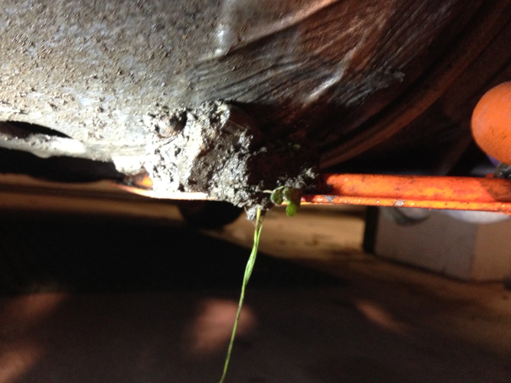

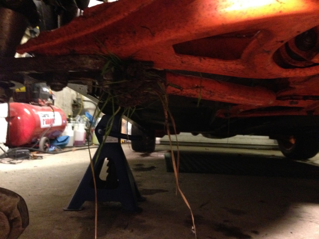

Had a little jaunt into the field at Croft lol
Also found some of the polystyrene board from Donington! The engine bay was full of mud from the field so time to give it all a final clean for the year
Parked up for the foreseeable future :(

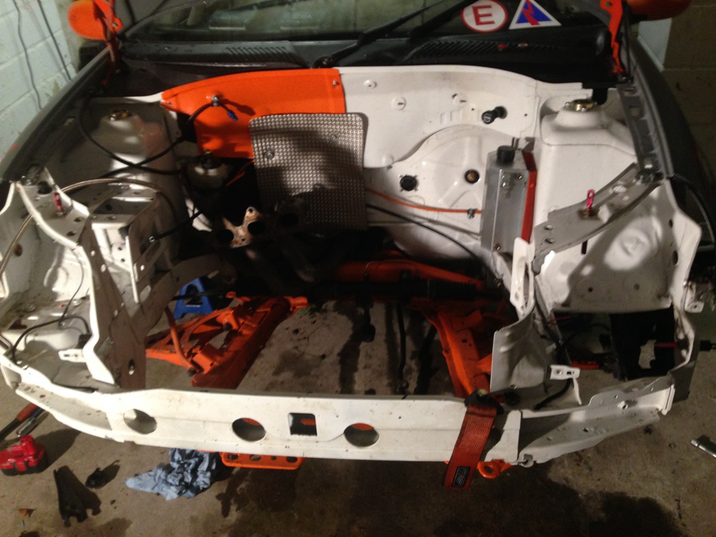

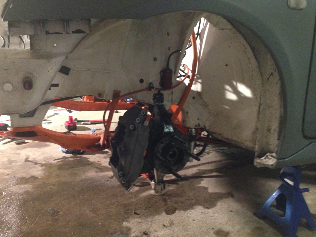

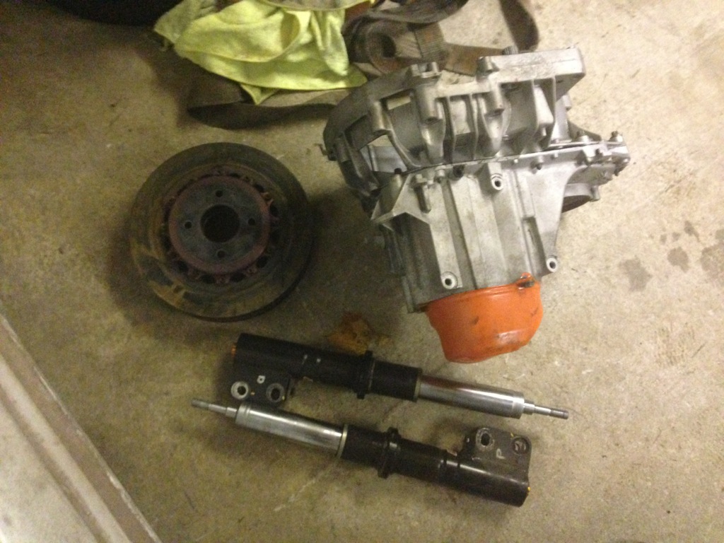

Stripped off all the bits I need to get fixed
Since swapping to the EBC pads I seem to have cracked the front disc's badly but only on the outer face, going to get them inspected it could just be due to age as the same discs have been on for 2 years now.
Dampers off and ready to be taken for inspection and same with the gearbox ready to go to gripper :)

So it was a week today since at Croft and having the gearbox noise. We originally thought the crownwheel had lost a tooth but I dropped it off at Gripper (its a gripper box) they have been massively helpful and very quickly turned it round. It turns out its actually lost a tooth off the pinion :(. It was apparently a custom made one off crown wheel and pinion so they are looking into changing to spec to stop a repeat. Really impressed with the service by them :) Looking forward to get my lovely gearbox back!

Nice one James, they're a good bunch down there, glad it was nothing too serious. I assume it's not done damage to any other part of the box?
Yes they are :) Apparently everything else looks in tip top condition
So you have two boxes with grippers in then?
I used to have a gripper diff with helical crown wheel and pinion. I then had the issue with the casing cracking and also syncro issues. I then found a gearbox for sale that was a gripper diff with straight cut final drive and also a straight cut, close ratio dog gear kit (No syncro’s hence me not using the clutch sometimes in the videos) The ratios are perfect and also not having the syncro’s is one less thing to worry about. It’s so good to drive with :)

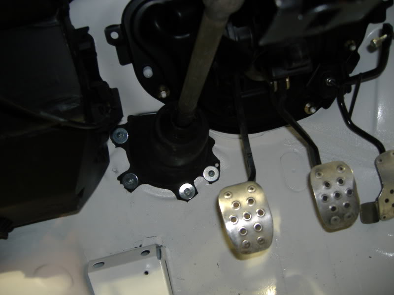

When you heel and toe, do you not feel that the ball of your foot is just balancing on the brake pedal to be able to reach the throttle?
It's new to me still but when I do it I feel as if I'm right on the edge of the pedal and could potentially slip off of it or miss judge it..
I think my throttle pedal is too hight though because now when applying the brake hard the throttle is far too high to reach and my foot is almost under it.

No not really although if you look in the video you will see my throttle pedal is adjustable to move it closer or further away from the brake pedal. I could actually do to move it over a bit more but I always forget. I’ve struggled tbf with heal and toe on the new gearbox as everything has to be perfectly precise as the gearbox wants really quick changes. I was the same with heal and toe when I was younger but then just started doing it daily when driving around in a manual car and it becomes second nature. It’s the same with a few driving habits for track such as trail braking I tend to carry them over onto the roads and it makes everything so natural you just don’t even think about it.
In the video you will see i’m covering at least 3/4 of the brake pedal and then getting the throttle by pivoting my foot up and across so if I’m going to miss a pedal it will be the throttle not the brake, this also helps for when the throttle pedal is higher like you say yours is.
Thanks for explaining, I'm going to try and take what you've said and apply it to my attempts. Can't help but think my pedal needs to be lower though. Probably just need more practise.

I find its easier to heal and toe successfully when fully committed to the brake pedal, trying to practise at low speeds on the road is a bit of a pain. I have an adjustable pedal as well and it certainly helps but it all depends on where you're brake pedal ends up while braking really. Good thing about having the go pro in mine is that its really wide angled so can see my feet while in normal position viewing out of the windscreen.
