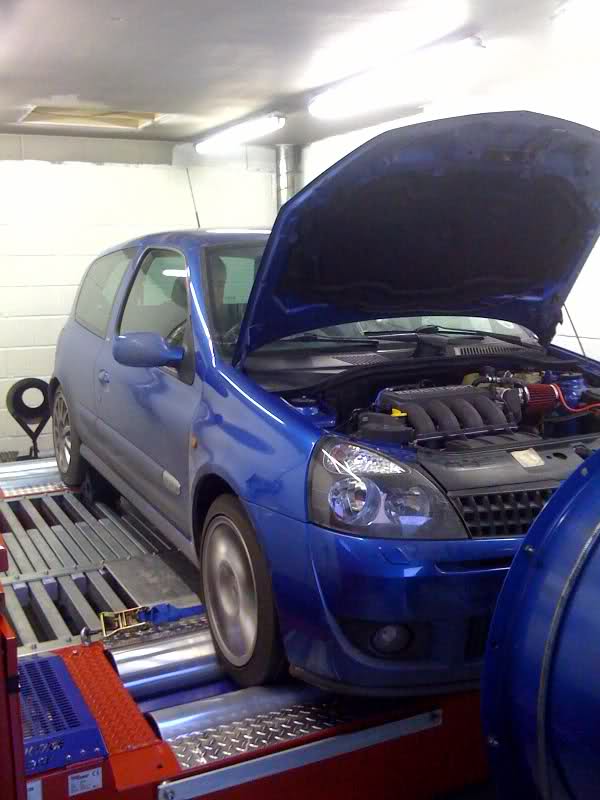

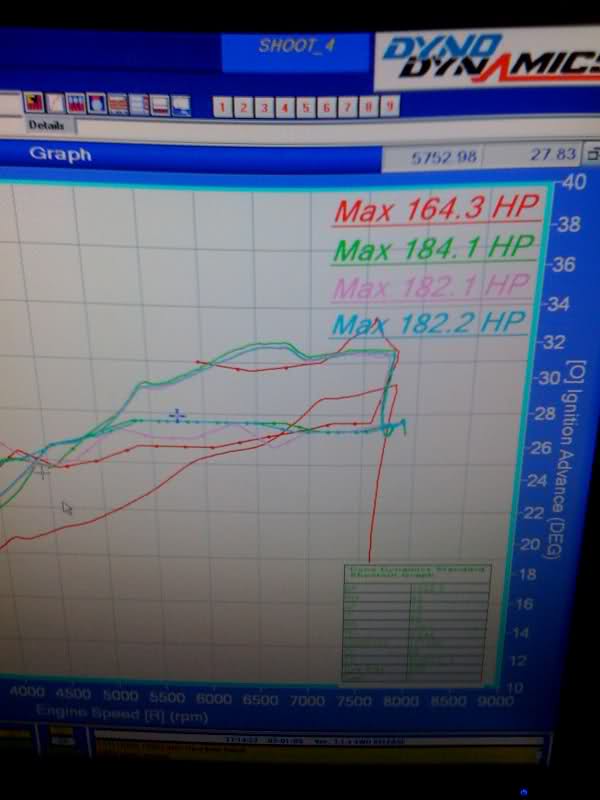

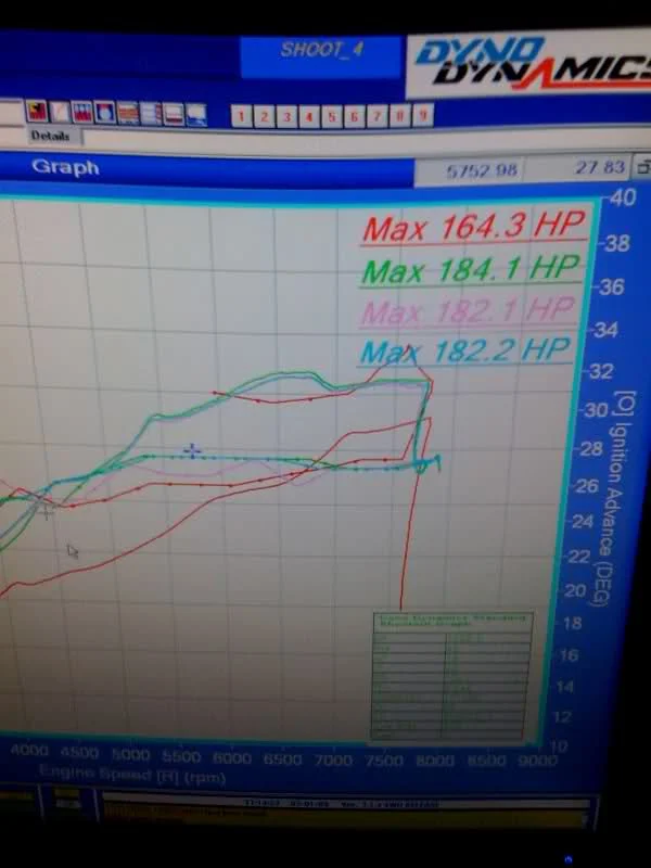

Been on the dyno
At 100K miles, showing compressions of (1) 170 (2) 130 (3) 180 (4) 150 with an airfilter from a Saxo VTR that I salvaged from the bin.
That'd be a best of 184bhp then with three over 182bhp, best torque recorded was 156ftlb. Makes over 180bhp at 7200RPM.
If I can be arsed to stick a none fooked head on it it'll be brilliant! LOL
Thanks to Paul for mapping it even though its knackered ;-) Much appreciated!!!
On the hunt for a fresh engine now, same spec with a decent inlet manifold design should see 200bhp!

It's had a cambelt fail in the past and has been badly repaired. Should be 5 - 6 bhp up on where it is at the moment.
Still better power/weight ratio than an R26 at the moment LOL

weak result for cams and ptfe gaskets but those compression rates are shocking so no wonder why :)

Looked at the compression readings, and glanced at the graph and though how the f**k has it made that power when its standard and buggered? :eek:
Number 2 is fecked.....
Number 4 isn't much better either as it took a lot of cranking to come up to that!
Should be good with a fresher lump in there!
