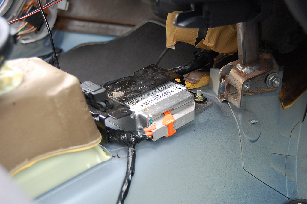

Dont have a clio handy! I'll try to get pics tomorrow but ona ph1 at least the airbag ecu is in front of the obd port so you have to take the plastic cowling off to access it and then just unplug the large orange plug on it.

Tell me more with pics!
Sorry for the huge pic
Orange and grey plug
