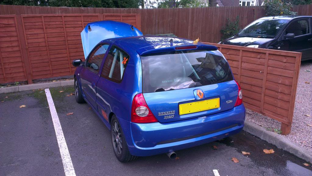

After quite a crappy year in my personal life I decided to splash out a little and have something I've always wanted since owning a CS... ITB's!! :evil:
It's taken quite a long time to get the car to this stage but its done, mapped and no going back now! I now need to sort a track day out before the year ends and then work out a budget to race next year.

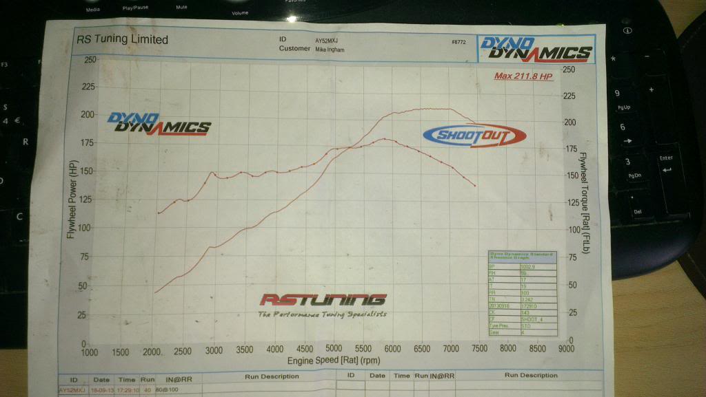

On first impressions I couldn't tell the difference between our old induction setup and this one, but as soon as you get the car into the upper rev range and properly give it some beans, the power is pretty mental. Not earth shatteringly massive, but enough to give the car more poke and be competitive. I was expecting 215-220 but after chatting to Paul and Fred this seems a little optimistic. The car still suffers a little being too high comp, there might well have been a tiny bit more power if the decat was fitted but its healthy and strong so all is good!

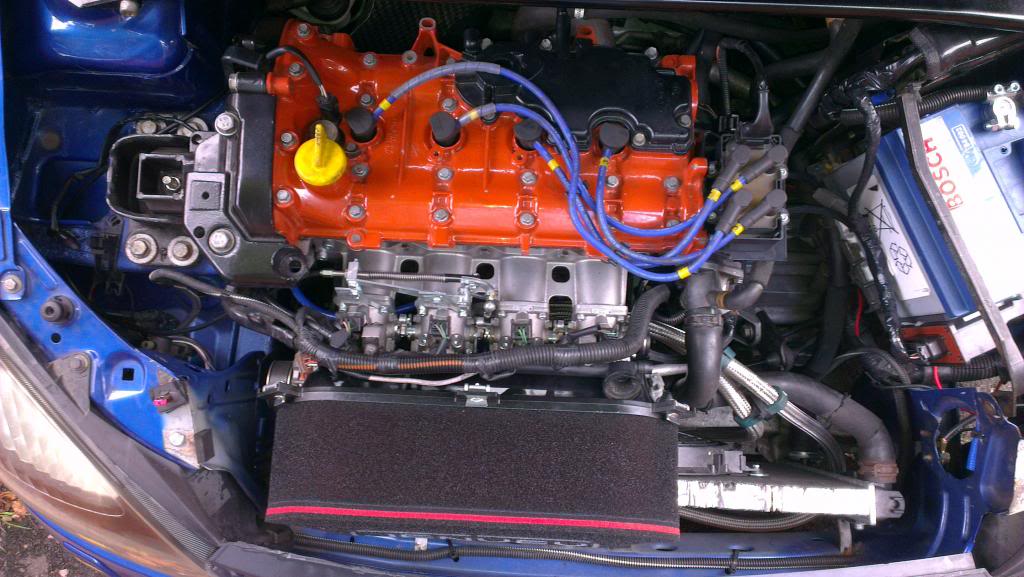

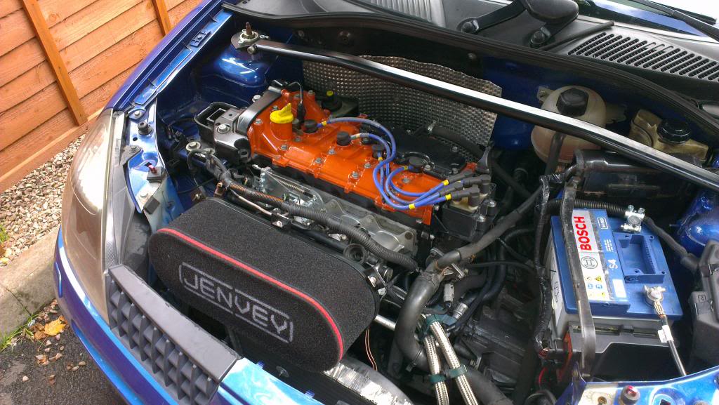

Jenvey ITB's with 120mm trumpets, high comp pistons, megane forged con rods, all rebuilt and with a skimmed head.
Big thanks to Fred, Paul and James for all their help :)

So you had to cut the timing back again? Same as with your old inlet?
Iirc the 438's don't have as big an overlap compared to 421's and are advanced or retarded in timing marks for better idle, did the guru' say 421's or 422/3 would have been better suited?
I looked for your thread but can't find it hence the questions, were they aftermarket megane con rods and what hi comp pistons?
  RB 182
Same as before yeah, Paul had to pull the timing almost all the way back.
On the original build we were running stock ECU so 438/421 were the only option, iir 421 were not in stock from all of the usual places but 438's were so we chose them. If the engine was due new belts then yes I would have bought the wildest cams I can afford as well as a thicker head gasket to lower the cr, but I don't have the money to pay for another belt job when it's not really needed at this stage. I would rather get the car to handle correct and invest in better coilovers, full cage, possible race license next year than tinker with more power on the engine. That can wait till the next engine overhaul, I would seriously need to consider LSD if that were the option too. Never ending money pit! :(
Not 100% sure about the con rods, probably best to ask Fred. I know they are OE, I think Fred had some "special" ones stashed aside from back in the Yozza days.
