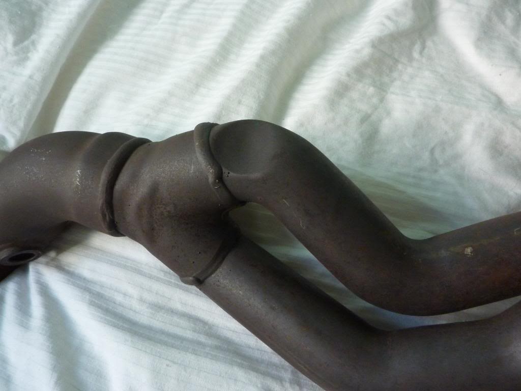

I've seen that some of the manifold on sale here have a "dint" in the exactly same place where it scrubs on mine, is it normal, maybe an afterthought by renault? Or is there any other way to not make it touch?
We're thinking to replicate the "dint" getting it red hot and bending it a bit with a clamp or something...

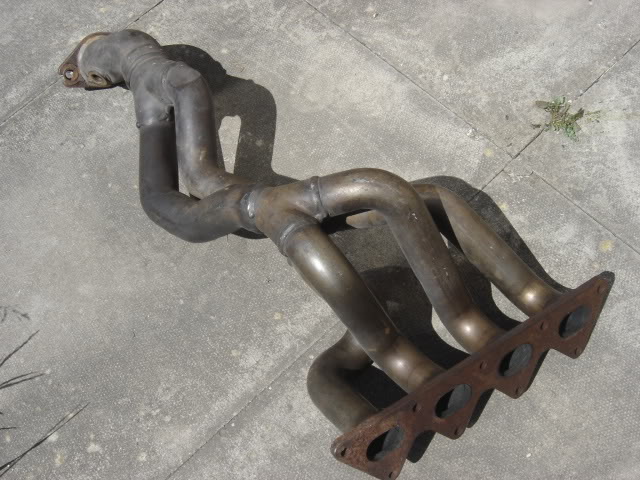

I've found a few pictures about it:

I can't understand why some have dents and some don't?
But is it possible that your engine mounts are a bit worn and if you were to replace them it might solve the problem? Have you tried tilting the engine forward abit like "Andyman" said?
  R5 GTT EFI Clio.
Well the one with the dent obviously has to miss something, if there wasent a dent it would hit on it, so there for it has a dent, if that makes sence.
Yeah but I am assuming all 182's are the same so why do some have the dent and some not.
Thinking about it tho, maybe 182 cups/cup packed cars have it because I think they have a thicker anti-role bar?? If that is what the mani is hitting then maybe that explains the reason renault made put the dent in them!

We've tried to replicate the dent...the manifold is VERY hard, we tried every kind of clamp, we bent it a few mm and scratched the surface a lot. The engine is already tilted as much as it goes.

You shouldnt need to mess about with the manifold, knocking dents in it and shoving wrap round.
I got my dent taken out back to round and its fine. Never knocked once and the cars currently on the original dog bone with 120k's under its belt.
The gap is tight yeah but imo you only need some fine adjusting unless the manifold you have is somehow bent ? Was it taken from a written off car?
Do you have pictures of the fit to see what the gap is ?

i reckon your manifold is bent... when the cars are rear ended they tend to bend
should fit fine... not easy but should fit with some adjustment

I don't think so, when mounted is perfectly aligned with the engine and the dekat, so it's not bent. I think that with a new (and not a 8 years old) dogbone mount it wouldnt knock.
And if this wasn't an issue renault wouldn't have made the ones with the dent.
