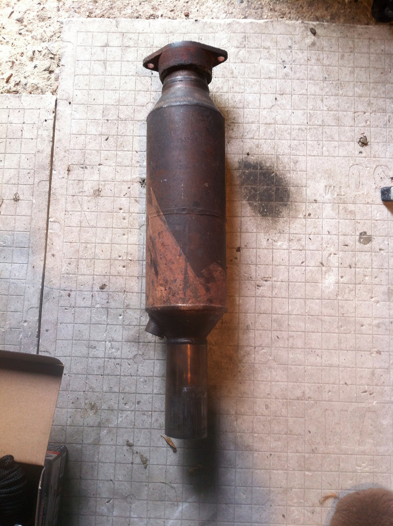

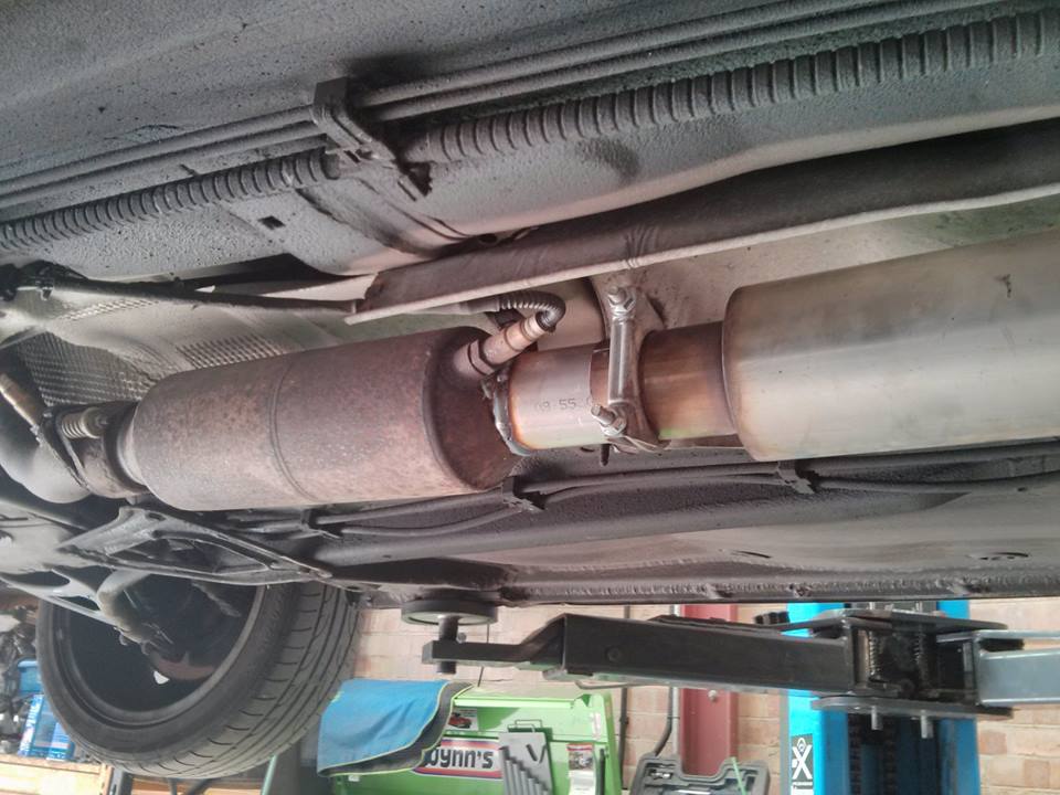

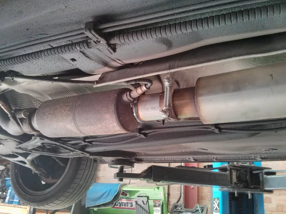

I got mine sleeved at Fred's last year. Fantastic welding and fabricating of the steel pipe.
I'll grab a picture tomorrow because I'm jacking it up anyway

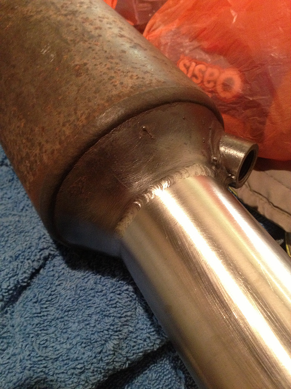

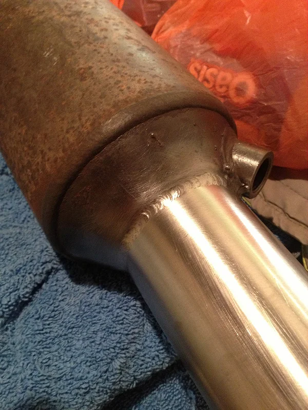

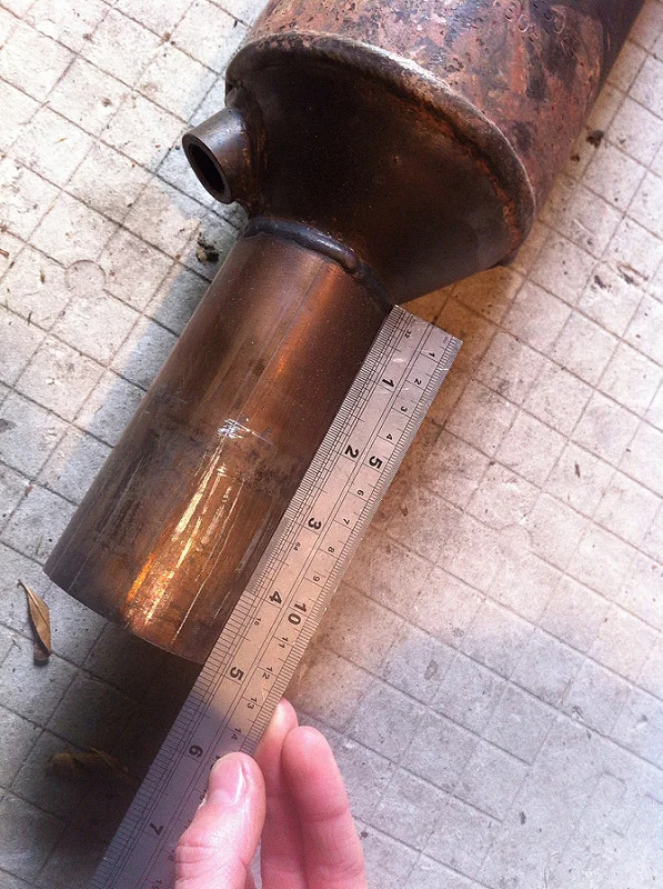

When Fred did mine, he chopped the olive join off my yozza, and welded some metal onto the Cat (chopped the end off the cat too), the sleeve is slightly larger than the yozza pipe, so it works without having to touch the exhaust really.
(or its done the other way, i cant remember, either way not much is changed).
