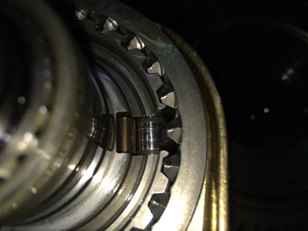

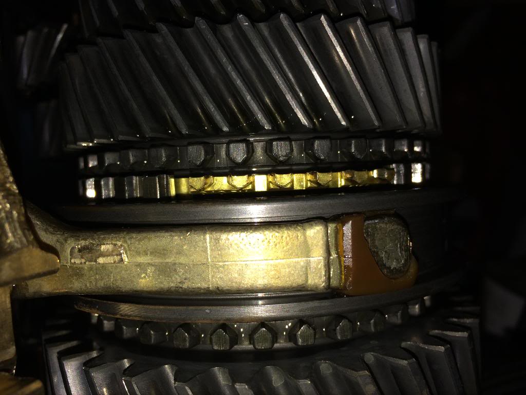

Ok, so got my gearbox out and opened up. As you mentioned Northloopcup, the gears are rounded and damaged. As are the synchro hubs.
I have a spare box and its no better. Nightmare.
I really need 2nd, 3rd, 4th and both synchro hubs. Surely cost s fortune.
As you can see in pic, the lower gear (1st) looks a lot better condition than the upper (2nd) gear!

Oh dear mate, that's going to be expensive to buy all the parts from Renault!! I got quoted about £400 and that wasn't including bearings or seals!! It's hard to tell what condition they're in from that picture mate as they don't look at all bad. The ones I've seen have been nearly flat across the part that should be pointy.

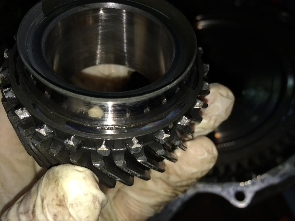

Heres better pictures of gears/ hubs. Not sure how bad this actually is, but as they synchros are actually all fine- it must be this damage causing the problem!?

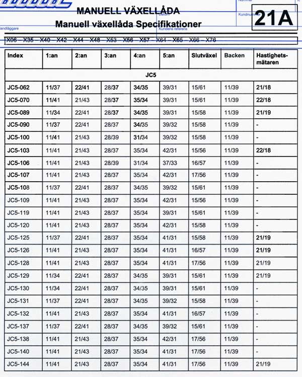

No they dont all have the same ratios, in fact its only the models fitted to the sport that have the 11/34 first gear for example.
I will dig out the chart I have.
Cheers Chip. That confuses it somewhat.
I remembered the Renault gearbox manual had all the gear ratios etc in it so looked at that.
The JC5 029 which i have has gearset G, so looked at others in the charts that have gearset G as id obviously be able to swap them straight over.
That came back as 028, 029, 037, 038, 039, 040, 047, 048. For some reason 030 isnt listed on it.
Completely different from what you have! Where did you source that?
EDIT: Yours show the wrong codes, theyre mostly starting with 1 instead of 0..
The only ones I can personally confirm off that chart are the 89/129/130 which I know are correct, cant comment on the others.
Its just a chart I found online when I was looking years ago.
Yeah that's your problem right there!
