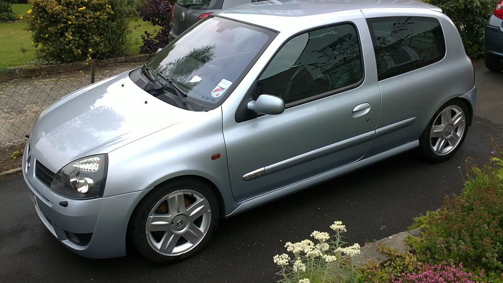

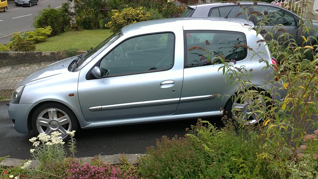

Well I've had the 172 about 18 months now I think and living in a flat it suffers a bit of handwashing neglect. The koni's and eibachs have been on for about 11 months now and having fitted new tyres it was time to sort the camber out.

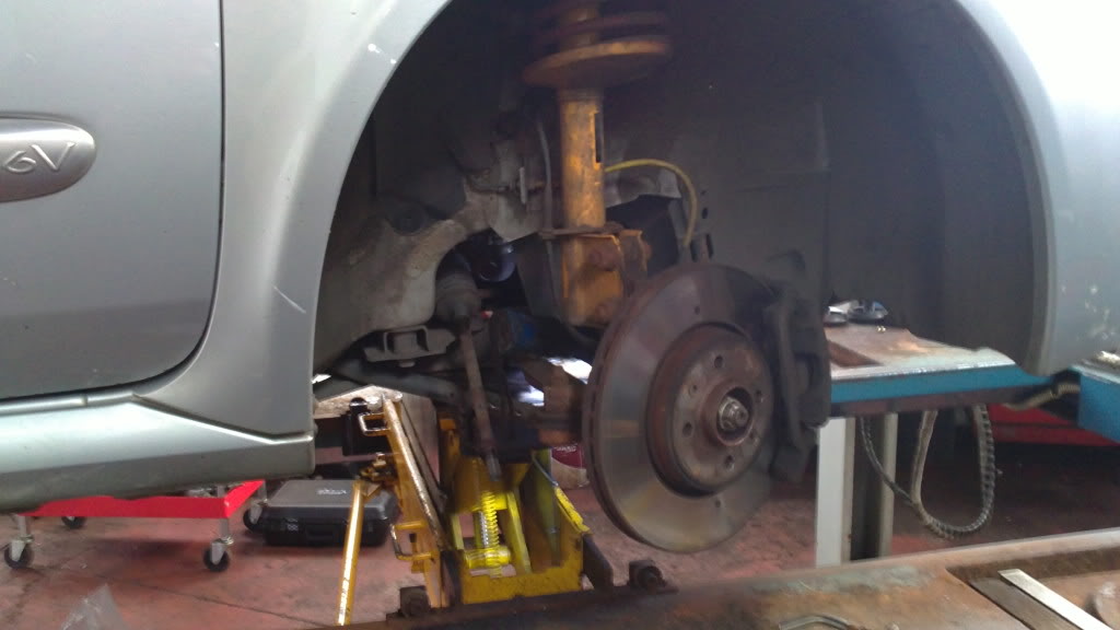

Today it was treated to 2 new track rods which has tightened up the steering hugely, some camber correction bolts (was running -2deg now -0.5deg) and a wheel alignment.
How it sits:

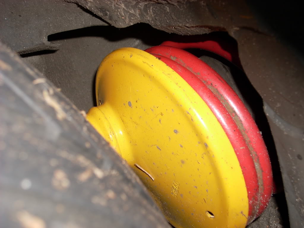

The culprits:
One of the offending trackrods:
