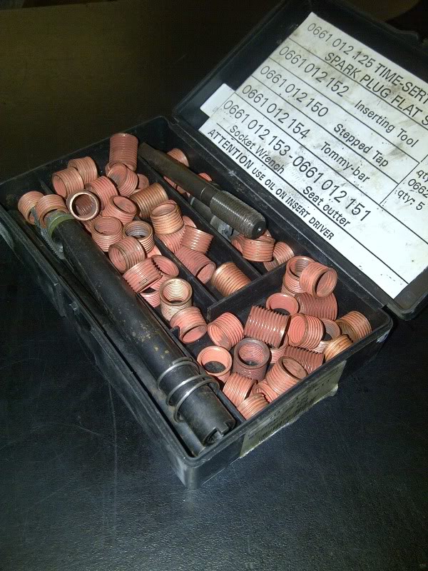

In short DO NOT use a "Heli-coil" wire repair as they're no good for spark plugs. What you need is a "Time sert" or "Tappex" putting in. Pics to follow later.

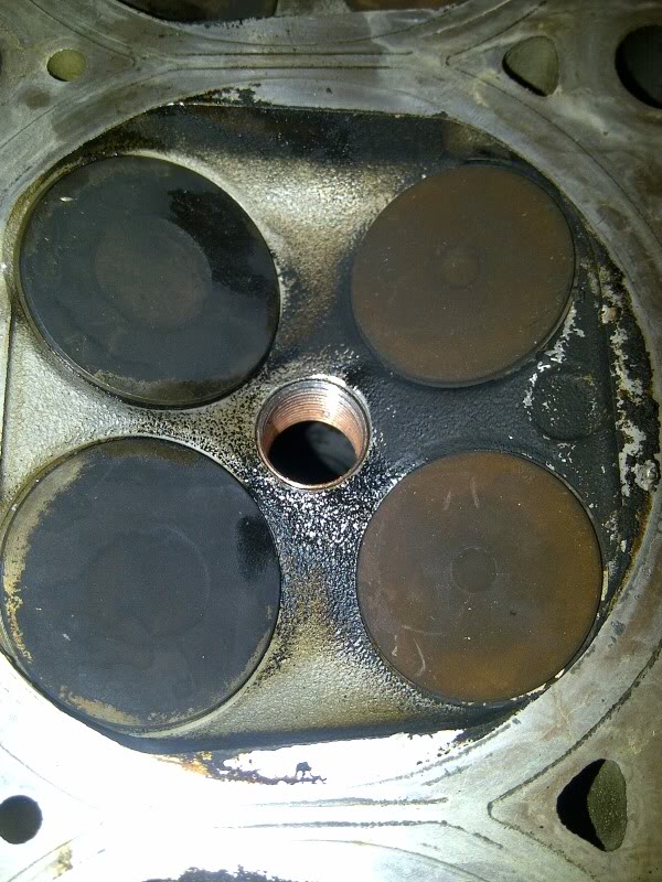

Here you go - Judes head from earlier:
Time-sert kit:
Standard thread after a clean:

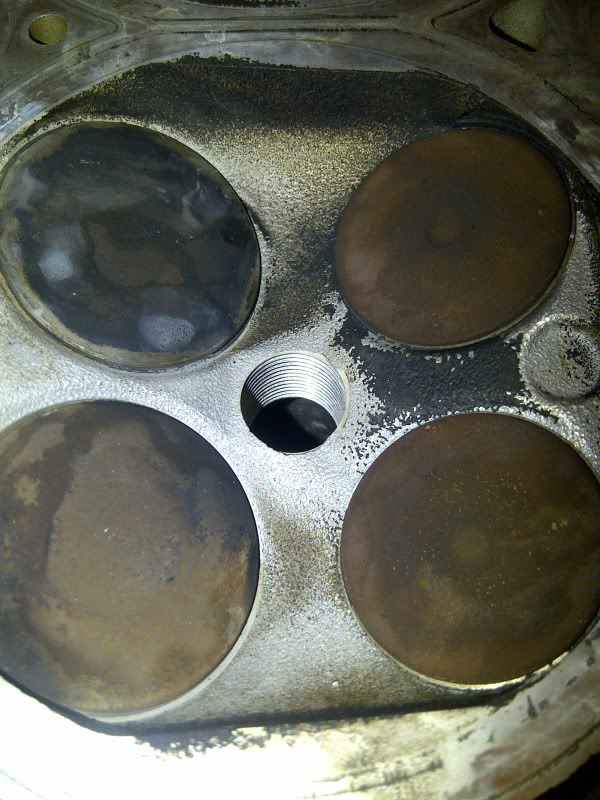

Repaired thread with time-sert:
