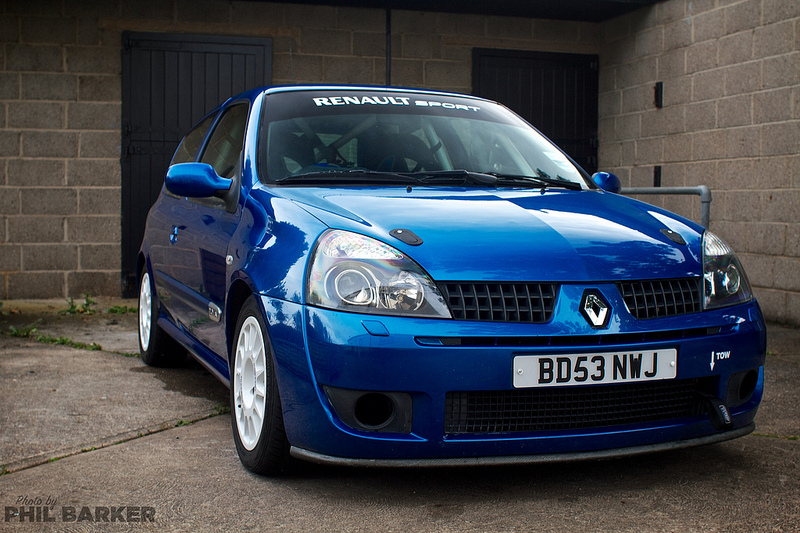

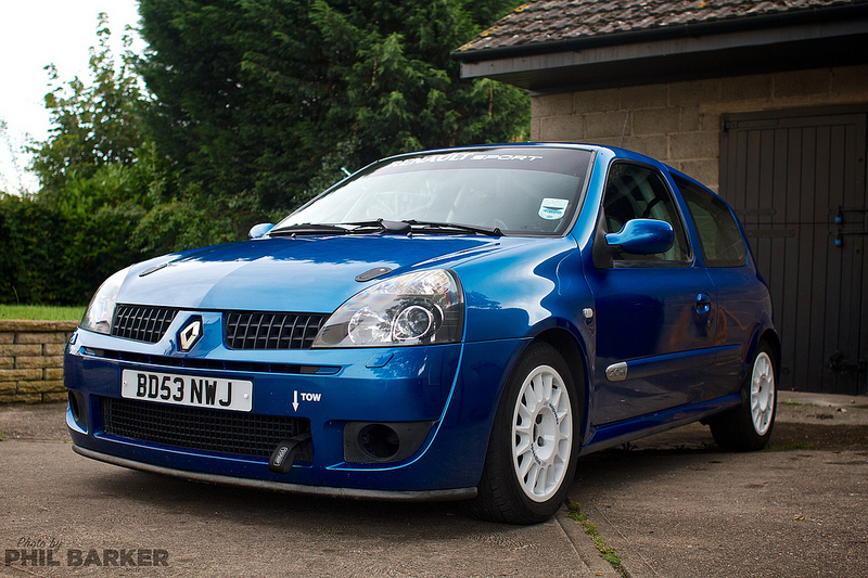

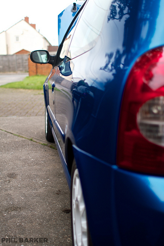

So saturday about 11am I got cracking giving the old girl a winter clean - finished about 7pm absolutely knackered but I'm quite impressed how well she came up!
Clean - September 2012 by Phil_Barker, on Flickr

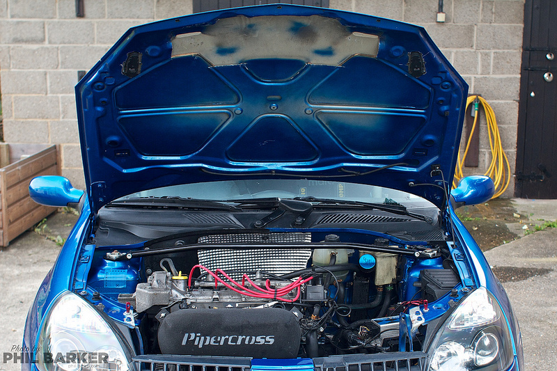

Also did a mod that I've been putting off for ages and cut my bonnet skin out to give the bodies more clearance. I'm ordering 120mm trumpets soon as my 90mm's have seen better days and I have the space to go bigger :D
Bonnet mod by Phil_Barker, on Flickr

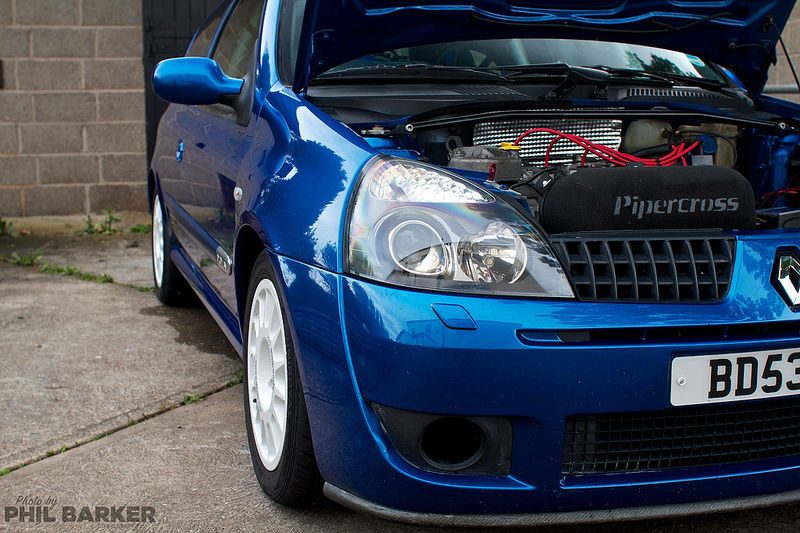

Looking good Phil, love the xenon's on the cups. Adds a bit to the front end IMO.
Detailing gets addictive when good results are had.
Good tip for you when using a buff, remove any plastics that pop out easy like the grills and fog surrounds, makes life easier. Tape everything else that's bare plastic, polish never comes out.
Is that sunstrip from eBay?
Yeah the black plastics are a bit wrecked anyway due to years of getting autoglym on them lol
The roof still has some stubborn water marks / tree sap - so I'm gonna buy some new pads for the polisher and some cutting compounds and do it properly in a few weeks - will mask up all the plastics etc...
Then probably treat the plastics afterwards with gtechniq
I used to be really into cleaning cars but this one gets abused so much I've neglected it a bit.
Also it needs a few bits touching up (door, front bumper, rear bumper) and the bonnet is now dented from cutting the backing out of it LOL
Oh well.. race car haha

Bonnets are made of crepe paper, thinnest of s**t.
Without looking threw your whole thread again, what depth back plate & filter do you have fitted? interested in room to bonnet.
Really tempted to go for 120's before I map mine ( not cheap tho)
Sunstrip? lol
The back plate IIRC is about 65mm - it's a reverie carbon one. The pipercross filter I THINK is 90mm - it's the biggest one they do C603D or something
So overall filter length is 145mm - and the filter fit fine even with the bonnet uncut - but the bonnet pressed against it slightly.
I'm sure 120mm trumpets are gonna fit fine
