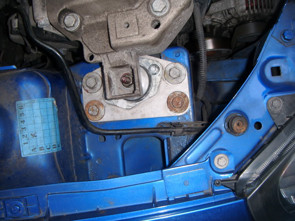

A pic of the top engine mount:
Forgot to take one of the upper gearbox one as I was that happy when I got it on and cracked on with building it back up.
I must admit, after fitting the engine mounts I dont know how anyone could use these mounts on a road car. The vibrations through the car is unbelievable. There is virtually no engine movement now. I had read up on a few threads on here on how to fit the upper gearbox mount but it was still a right pain in the arse to fit. All fitted now and pleased to get it out the way.

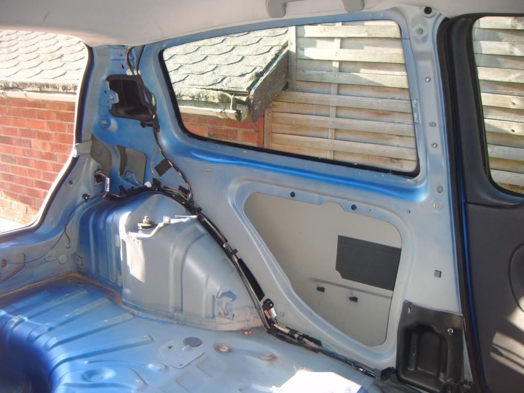

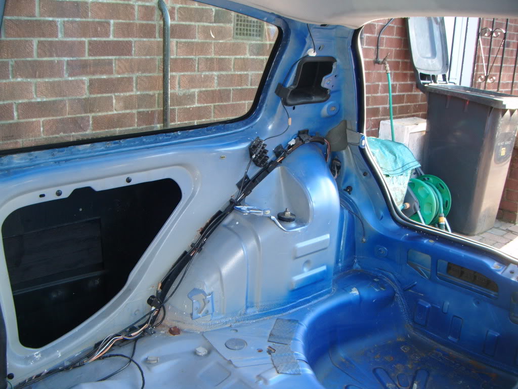

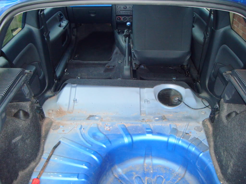

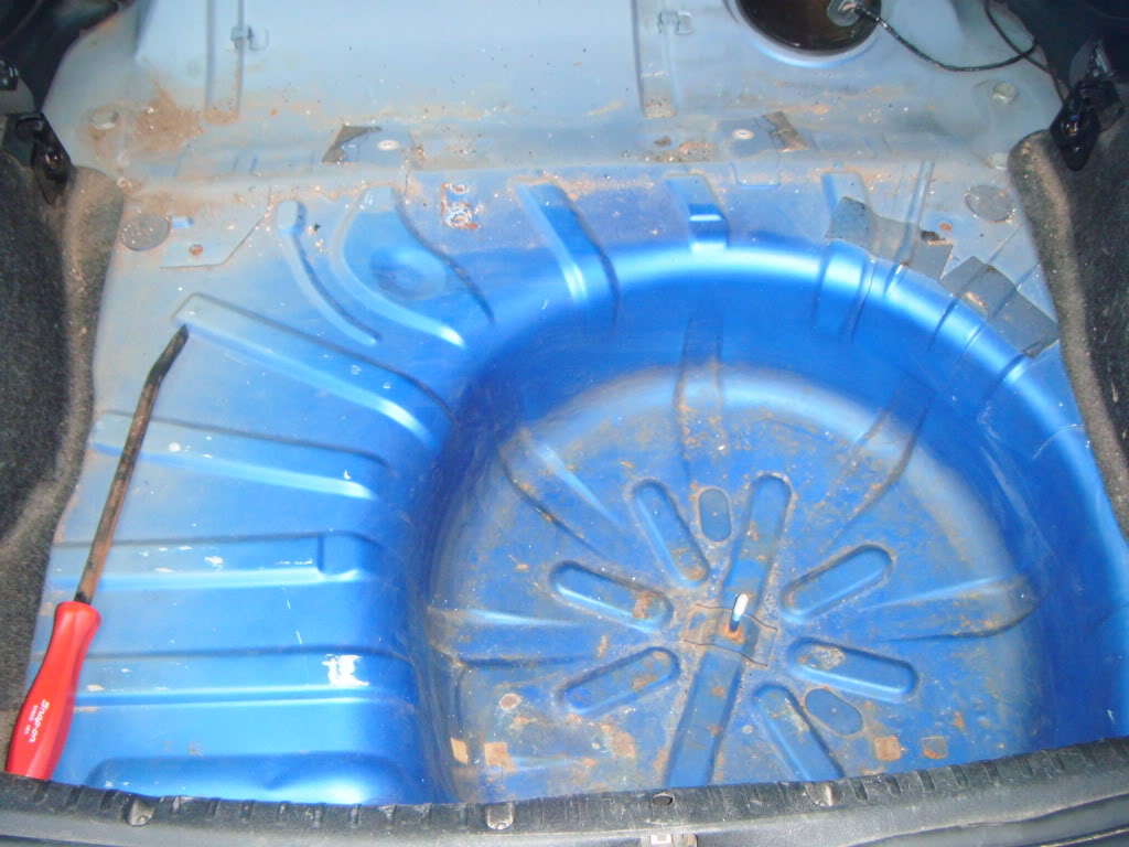

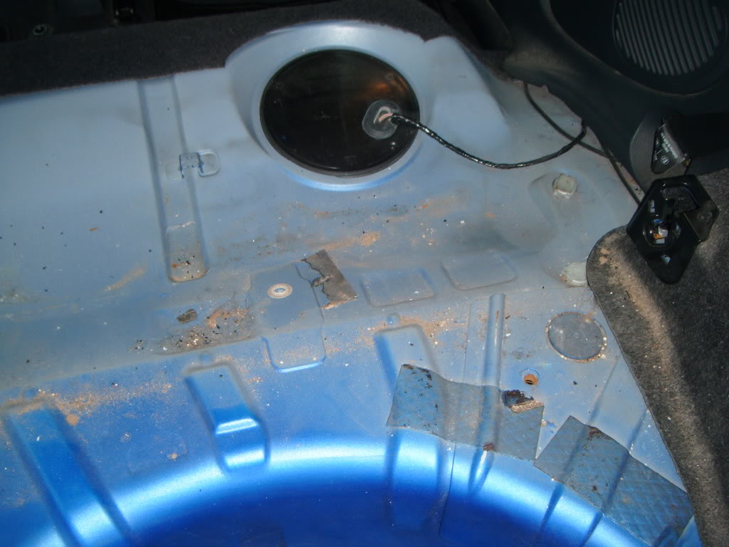

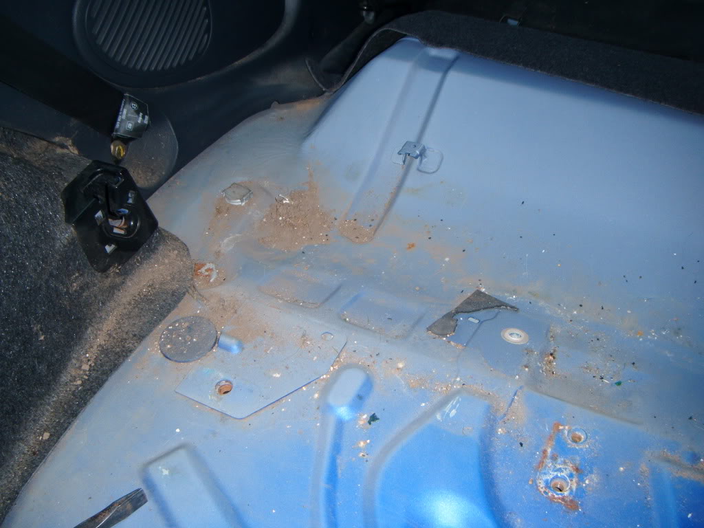

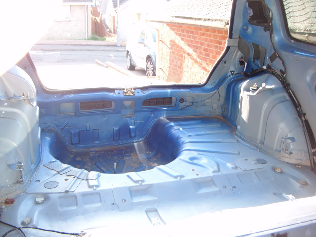

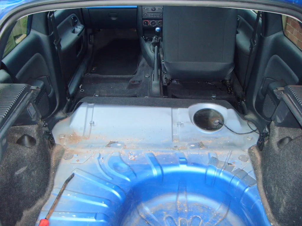

Started stripping out the rear and found about 8 years worth on crap under everything. The car has over the years been used a bit of pack horse but has never complaned once.

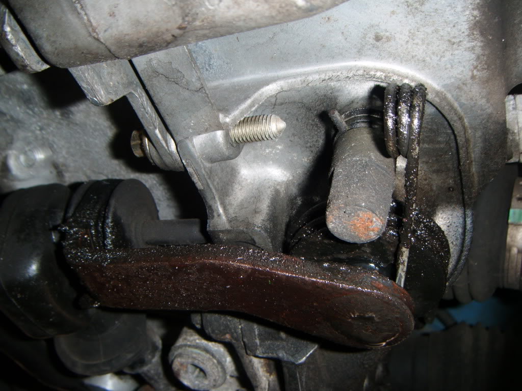

Noticed this when fitting the mounts:

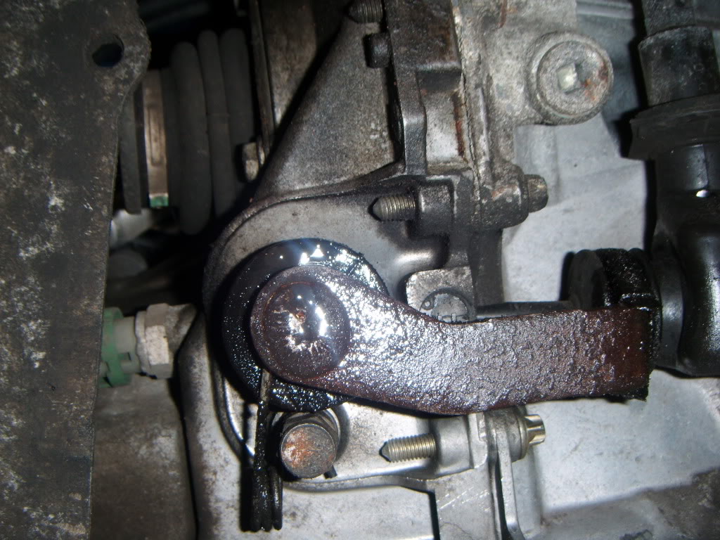

There seems to be oil leaking from this. Any ideas on what is involved in fixing it? Big job??

isnt that the gear selector , if so it looks like someone has just spilt oil over it as i wouldn't of thought gear would of leaked out of it ,
  172 cup, Impreza P1
Re: 172 Cup track toy!
Dried it up with a rag and then checked it the next day and it was back.
There was a small puddle on the plastic undertray panel.

Exactly the same on mine... Tried some of this: http://www.halfords.com/webapp/wcs/..._productId_193171_langId_-1_categoryId_165750 - seems to have worked!

Is that not covering up a problem rather than fixing it? Cheers for the info though!

Well - I did wonder that. I figured it might only be a slightly leaky seal, or something minor like that, so for £7 it was worth a shot. At least now I know it's nothing too serious, so I can fix it properly when the gearbox inevitably decides to s**t itself and needs a rebuild :approve: The box feels a bit smoother now too which is a bonus.

Think I'll keep my eye on the gearbox level for now and worry about a rebuild when I loose a cog! Lol

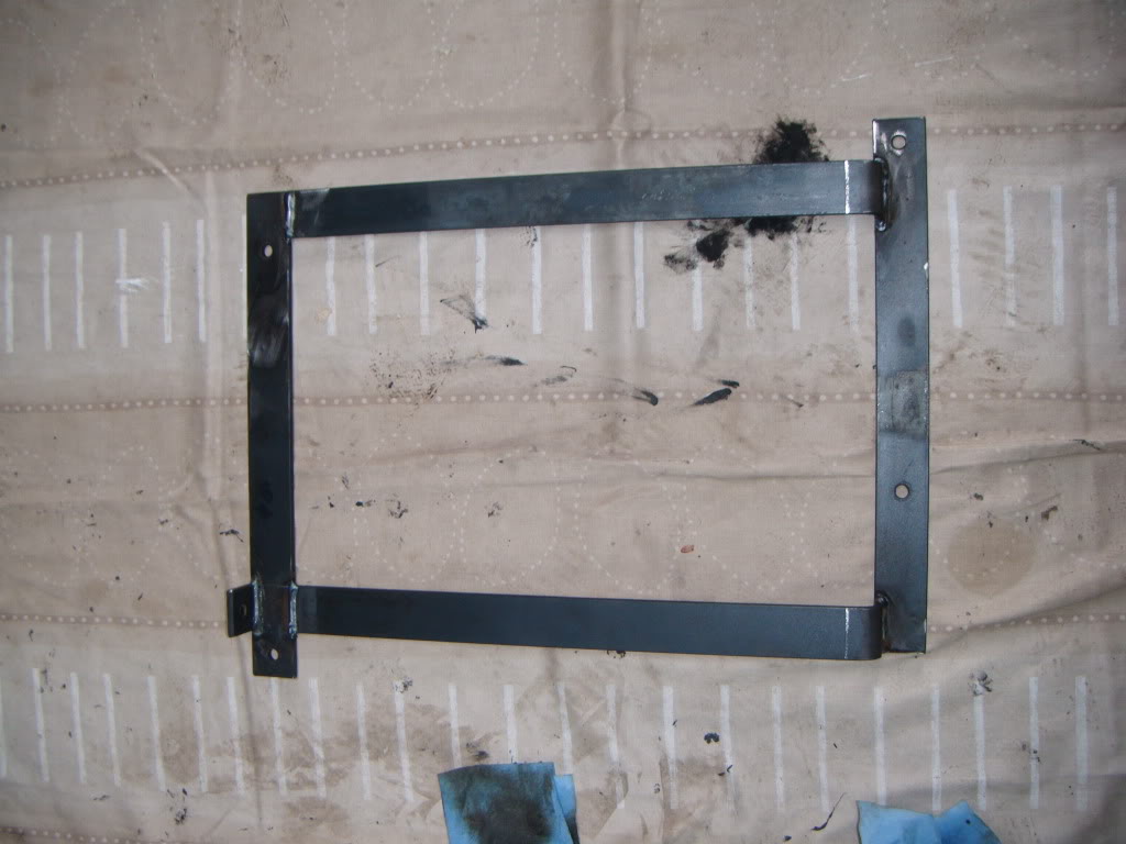

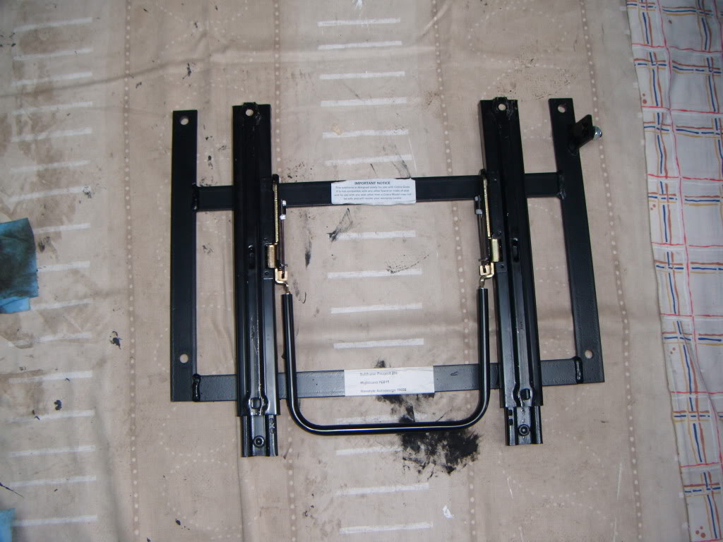

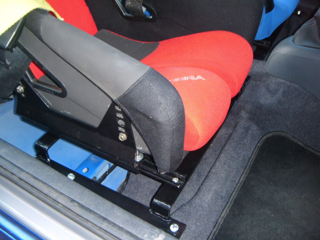

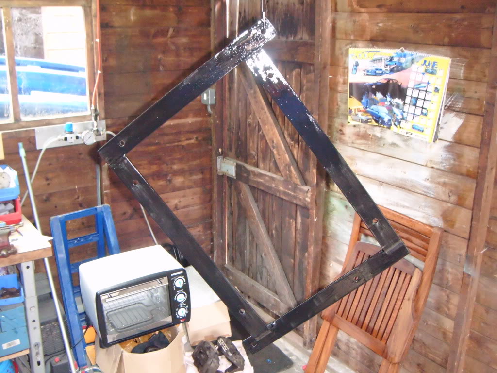

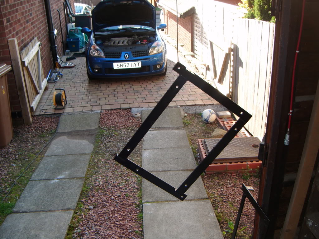

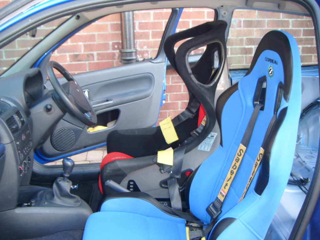

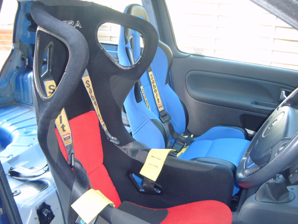

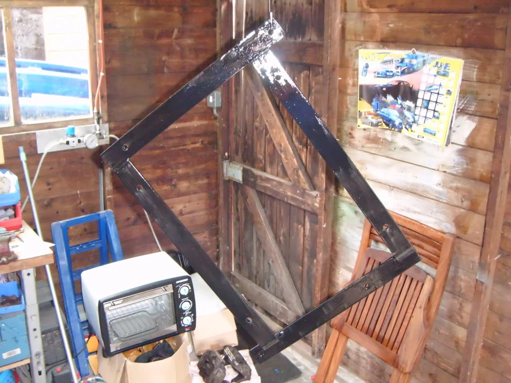

Couldn't find any seat sub-frames with sliders so I had a set of Cobra mounts for a Pug 206 that I have adapted to fit. When I say adapted I mean Ive used the sliders and made new sub-frames to fit the clio.
206 sub-frames:
DIY Clio frames:
And after a lick of paint:
And then fitted in the car:
The Evolution certainly holds you in place so cant wait to try it out on the track.

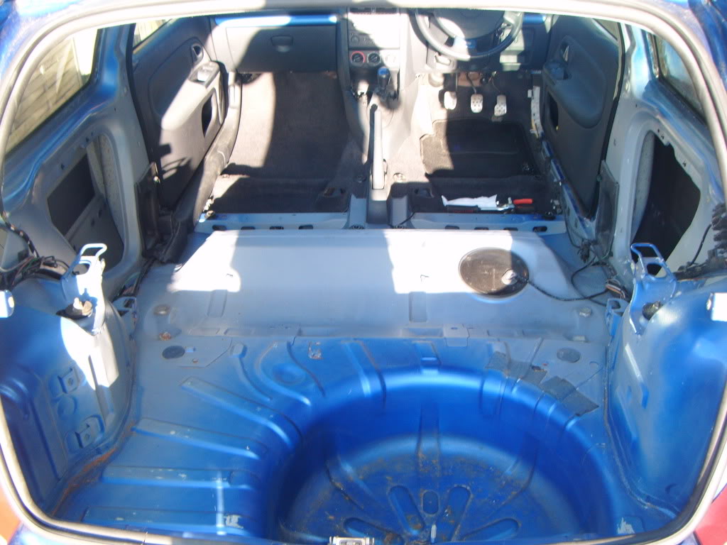

I decided to completely strip the rear of the car too. Cant decide at this point how far to go with the front. I'll probably end up going the full hog but still trying to get used to bareness of it as it is. :S

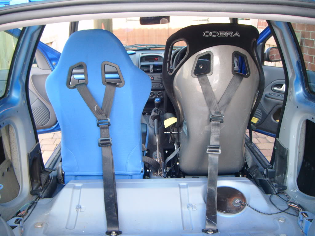

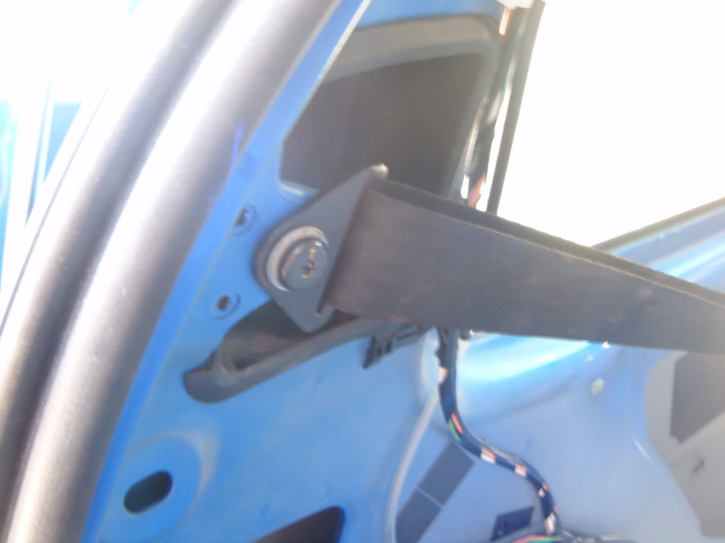

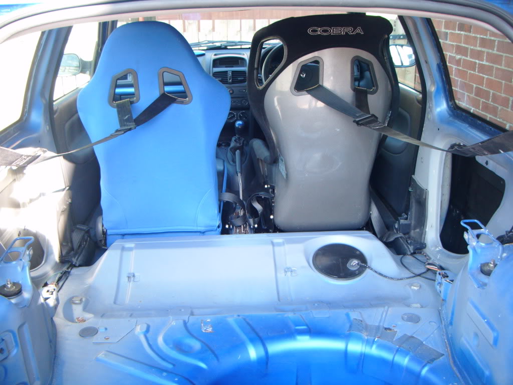

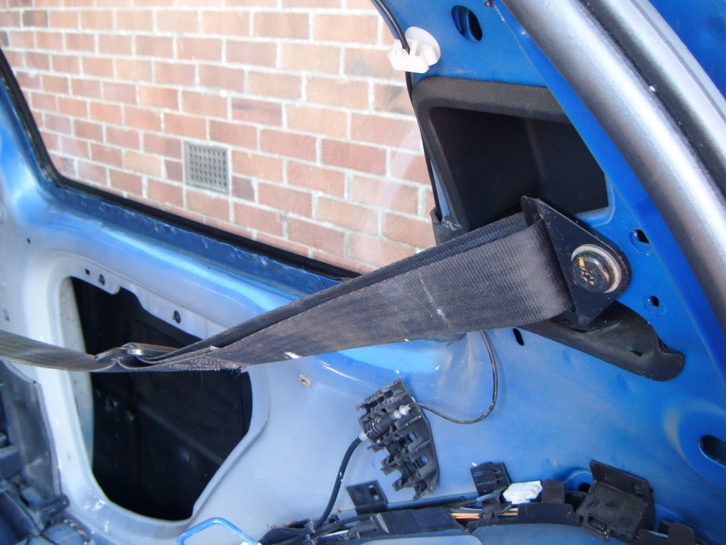

Not sure on where best to mount the rear strap of the harness. The 2 ways I have tried are:
And I now have it like this:
Is there a correct way for a cageless car? I will be getting a cage hopefully in the not too distant future so this is only for a couple of track days.
And just thought I'd post this pic too of all the babies in the fleet:
  TrackCar & F30 330d
The way you had it before breaks your back in a hard crash and the way you have it now is even worse.
Put it the way you had it for sure.
Car is looking good tho :)

I thought the angle of the straps were to be as level as possible to avoid this?
Your saying either way I'm getting a broken back in an accident? Anywhere else you would recommend?
Cheers by the way!
Not saying what Chrispy is saying is wrong he knows loads more about track set up etc than i do but i have seen a few race cars when i was at autosport with the straps angled down like cupman had his before :S
  172 cup, Impreza P1
I have seem them low and high but not sure what is correct.
Is what we are saying then that unless you have a cage or harness bar then harnesses are not safe?
  TrackCar & F30 330d
This is the best way
But as you don't have a cage then do it the way you had it before.

Even that looks slightly higher than parallel,I would weld a harness bar in,it can always be removed when cage is installed.
  172 cup, Impreza P1
Thanks Tony, good info that! :star:
The way I have it now is about level so it should be ok?

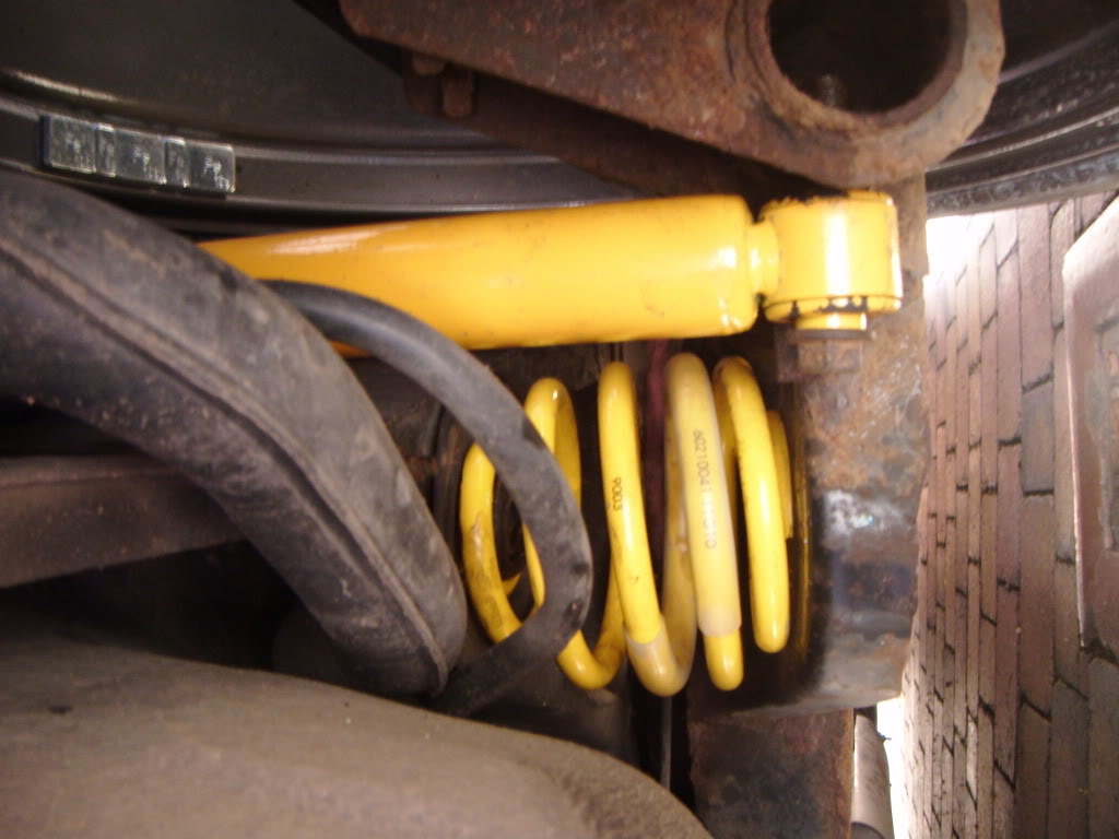

Small update, got the refurbed front calipers fitted along with some pagid blue pads and new motul rbf600 fluid in there for good measure. Got a set of DS2500's in the old calipers but can't decide which to use. The pagid's are about 10% worn so like new and the ds2500's are about 50% worn.

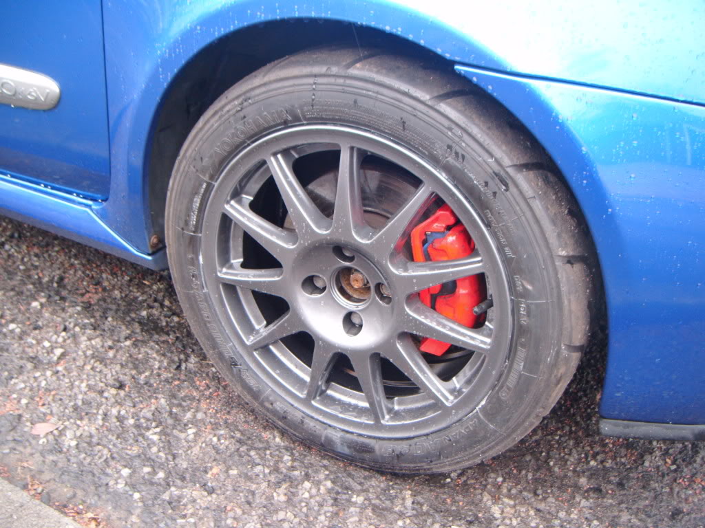

Got a set of Turinis refurbed in anthracite too but only got tyres on 2 so far. Need to see which are better on track, A048's or R888's.

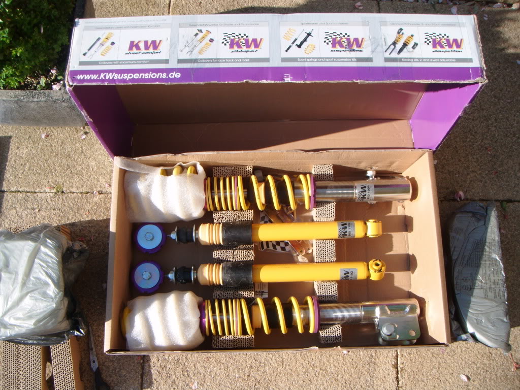

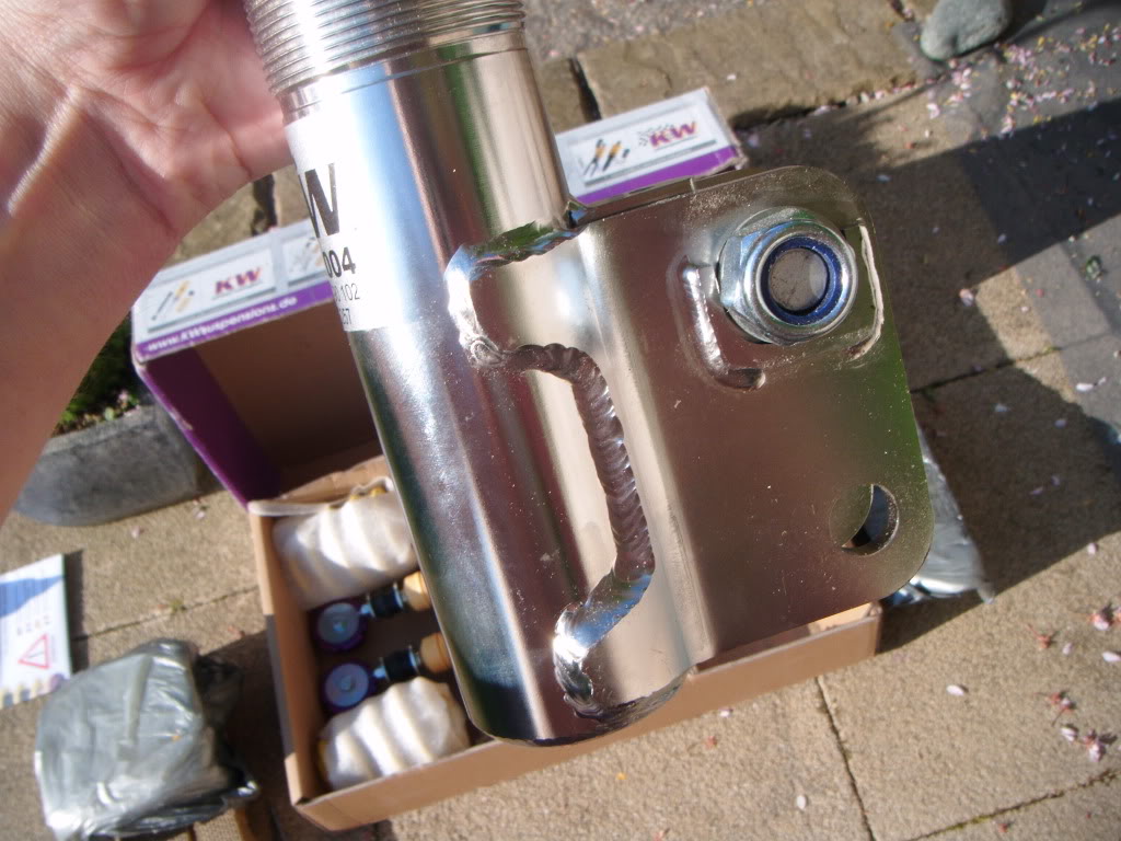

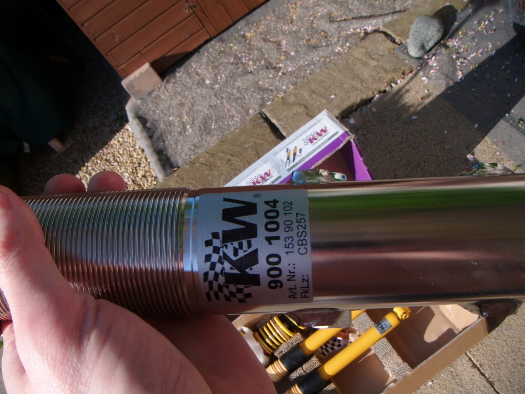

Also decided on which coilovers to mate up with the AST top mounts. Went for KW V2's and they'll be fitted next week hopefully along with the top mounts, fingers crossed!

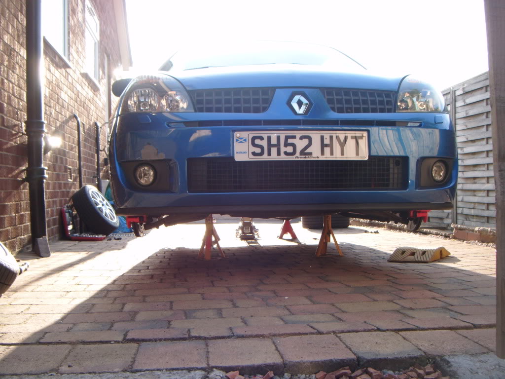

Bit of a photo update of the recent activities.
New coilovers to be fitted and setup next friday at Kenny Brown Engineering:

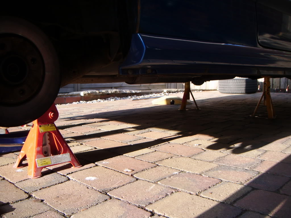

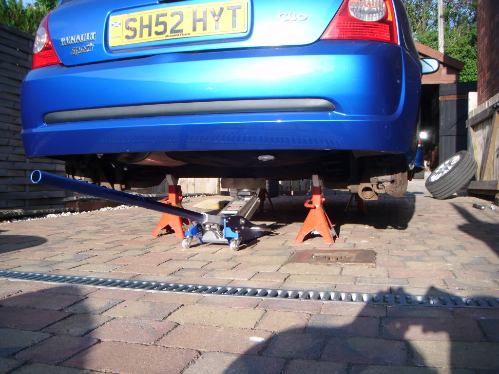

Car on stilts as the Mrs calls it getting the brake calipers and fluid changed:

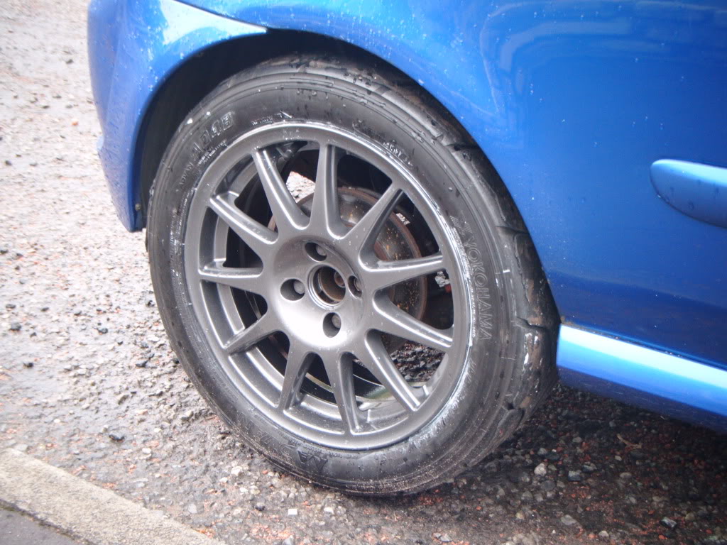

The newly refurbed Turini's with Yoko A048 rubber:
Like the look of the Anthracite with the red calipers but also getting the silver set I have refurbed in White. They all get done by a powder coater I use in work at very resonable rates.

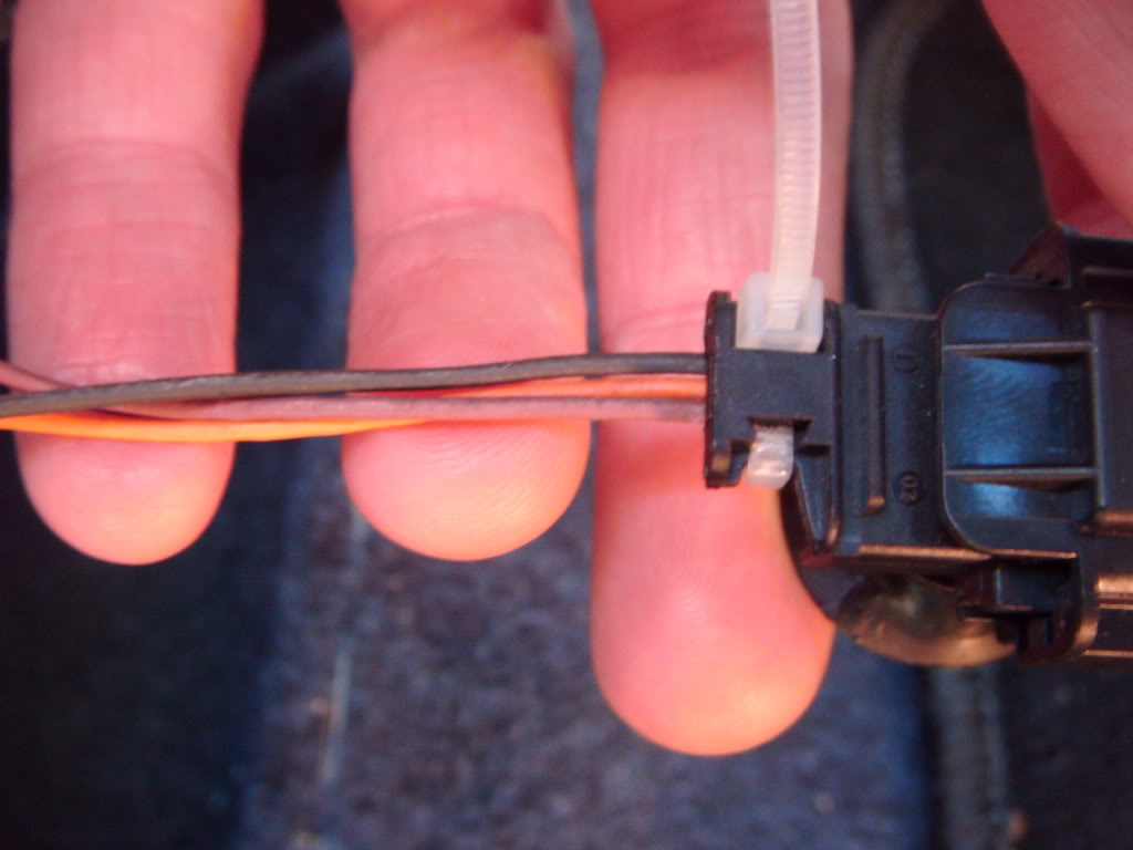

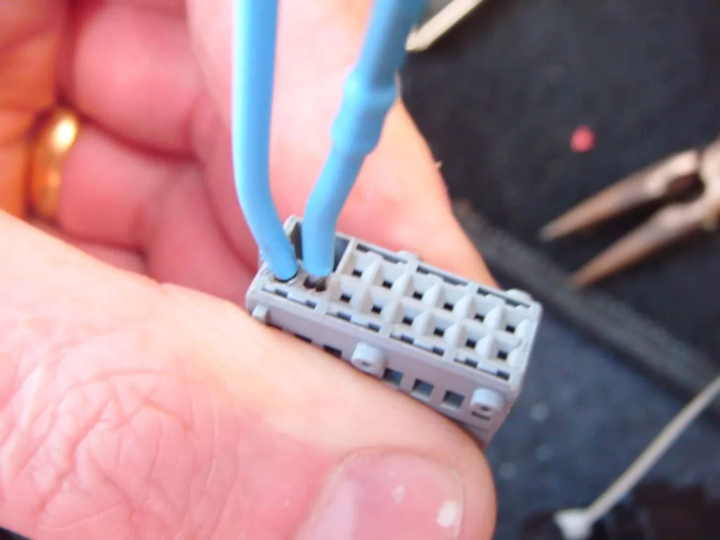

Thought i'd try in hear as I aint getting much luck on the other thread.

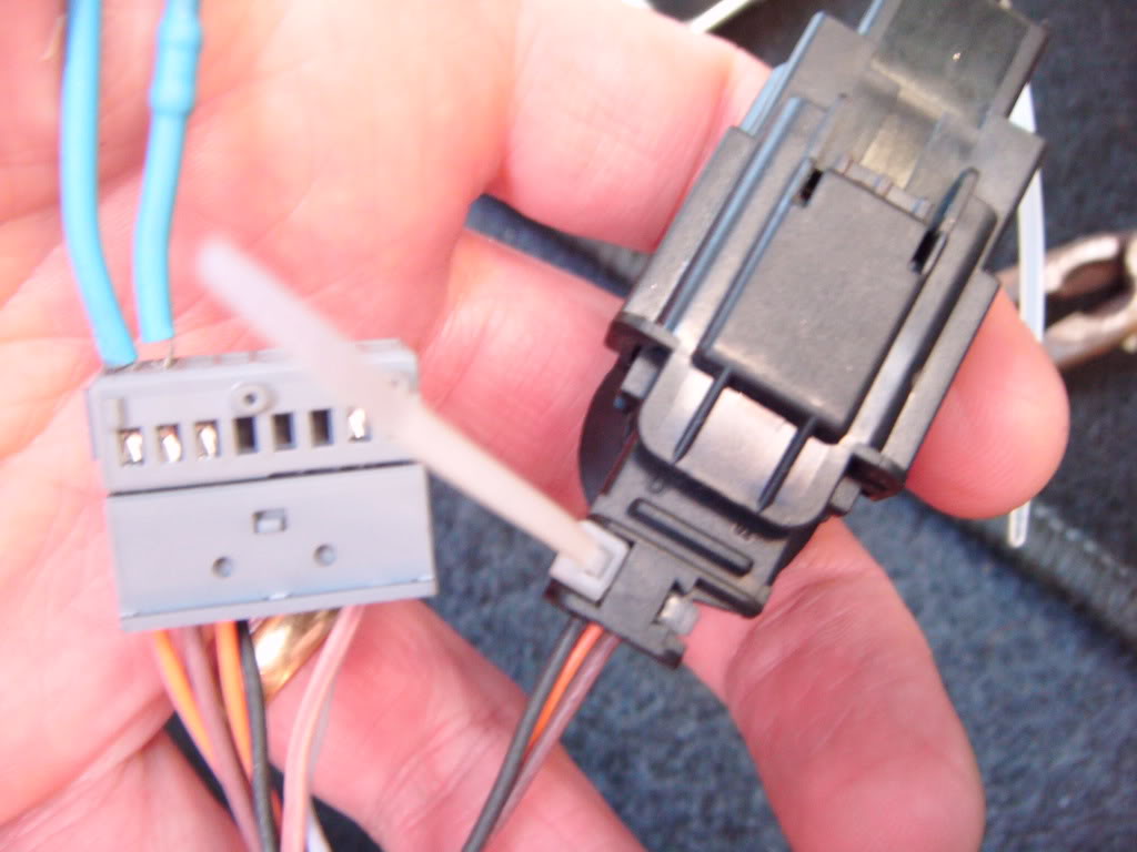

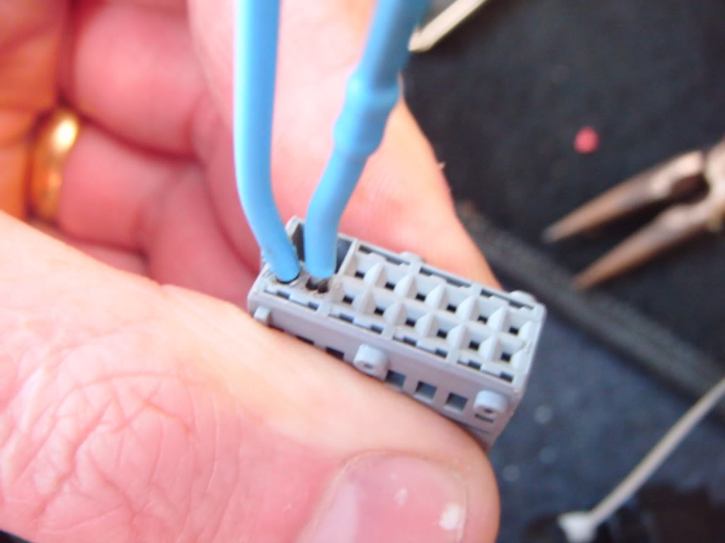

Can anyone tell me why my airbag light is not going out when I've wired the resistor like so:
The colours on The Boosh's guide shows different colours into the black plug. Is that the blackplug at the seat or somewhere else?
Help please!!!!!!!

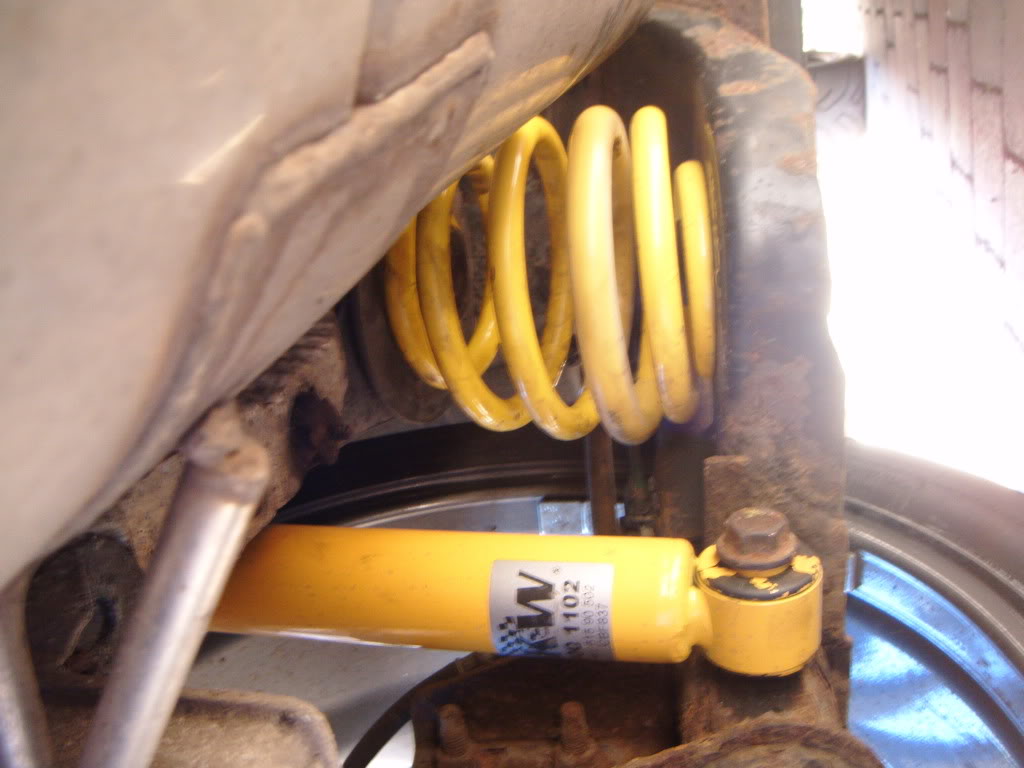

I'm getting the KW V2's fitted today for a track day tomorrow but the garage phoned there to say that they can't get the back low enough.
Is there anyway round this? Can the rear adjusters be removed completely? :S
Any help appreciated as I need this completed this afternoon? :(
thanks
  Clio 182 cup
Yer the rear adjusters can be removed I believe, don't think there is any problems when doing this

It will be fine without the rear height adjuster, i had to do this with my old ph1 to get it low enough (as it was stripped too!)
Steering wheel is on its way to you ;)
  172 cup, Impreza P1
Cheers guys. Told them to remove them and all seems ok. Hopefully be ok on track but I cant understand why kw make them so high at back. If they are adjustable you would expect to start really low to very high, not normal to very high?

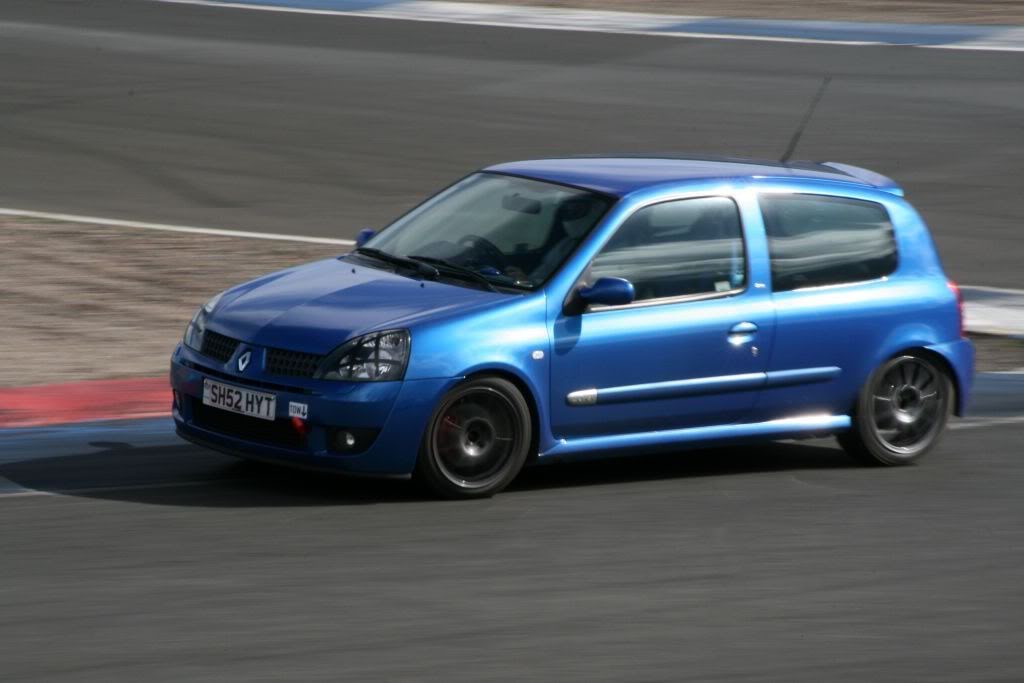

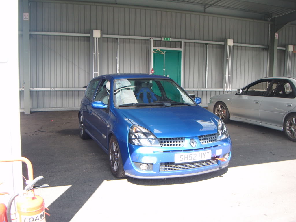

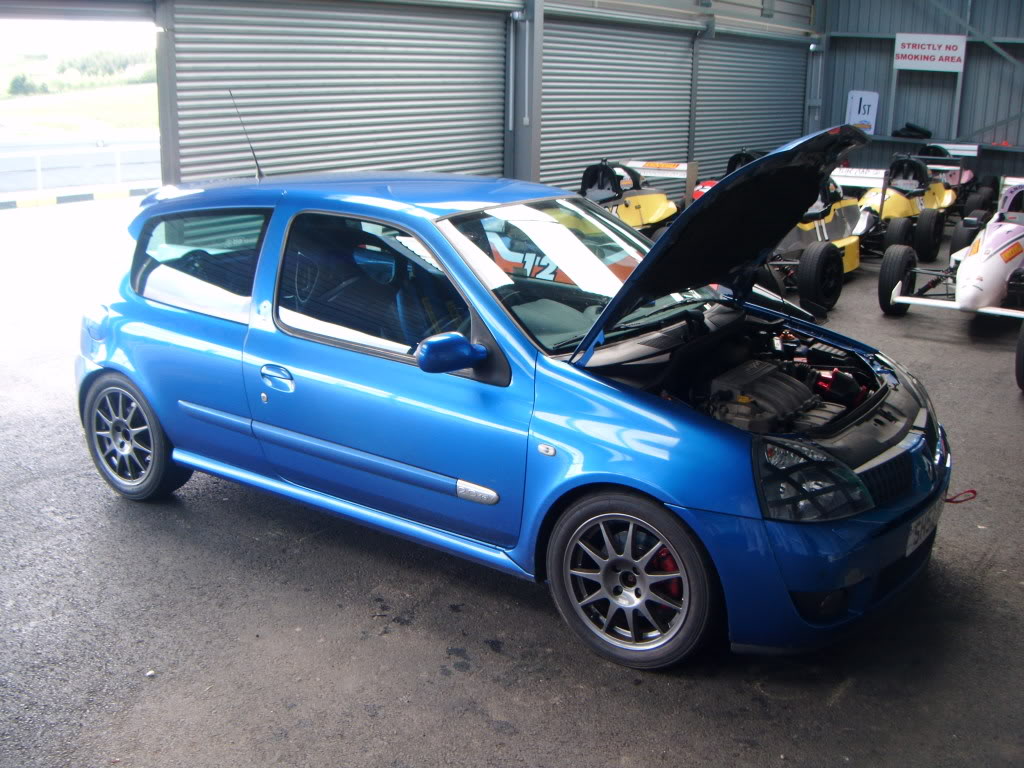

Got the car on track at knockhill on Saturday and what a day it was!
Time Attack was being held there the following day so lots of nice cars which I'll get pics posted shortly.
The Clio did well after a spin on my first lap. Oops! Came back in to the pits, stiffened up the rears, let some air out the tyres and went back out. Felt 10x better than before. After I got some heat into the tyres and brakes the car felt great. Played about witht he settings on the suspension and settled for fully hard at the back and 9 clicks on the front.

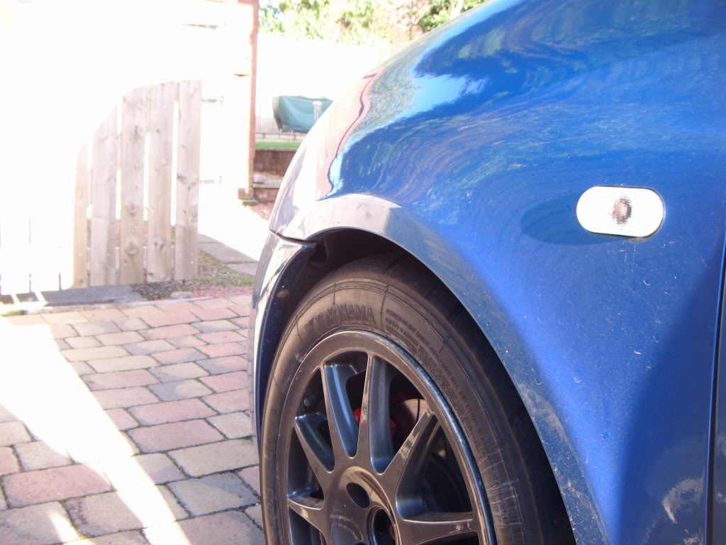

The only issues I had was tyre rubbing on the rear arches and after a few sessions heard a rumbling noise form the front left found the wheel nuts had come loose. After torquing them up to 100Nm, the only thing I could think of was the heat in the hub was expanding the hole and causing it to slacken. Anyone else had this???
some photos of the day:

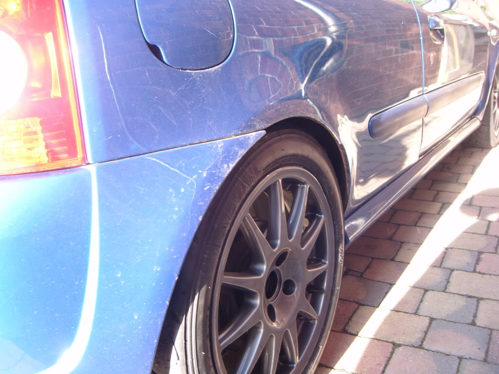

Also cant decide if the rear is too low now without the adjusters as it is rubbing quite bad at the back or just get the arches rolled slightly. Any thoughts?

i would raise it before rolling the arch, but it depends on how you felt it handled, i like oversteer before it understeers (never happens, always get understeer first) so having a bit more height at the back is a good thing for me, might not suit you though? Also, looks like your running 16's, a set of 15's might cure it?

Might raise the rear a bit then by using the rear platforms and see how it goes.

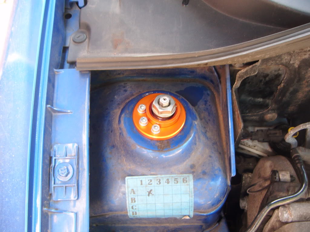

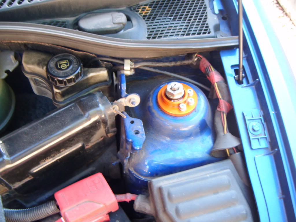

A few pics of the AST top mounts and rear set up:
and howe the car sits:
