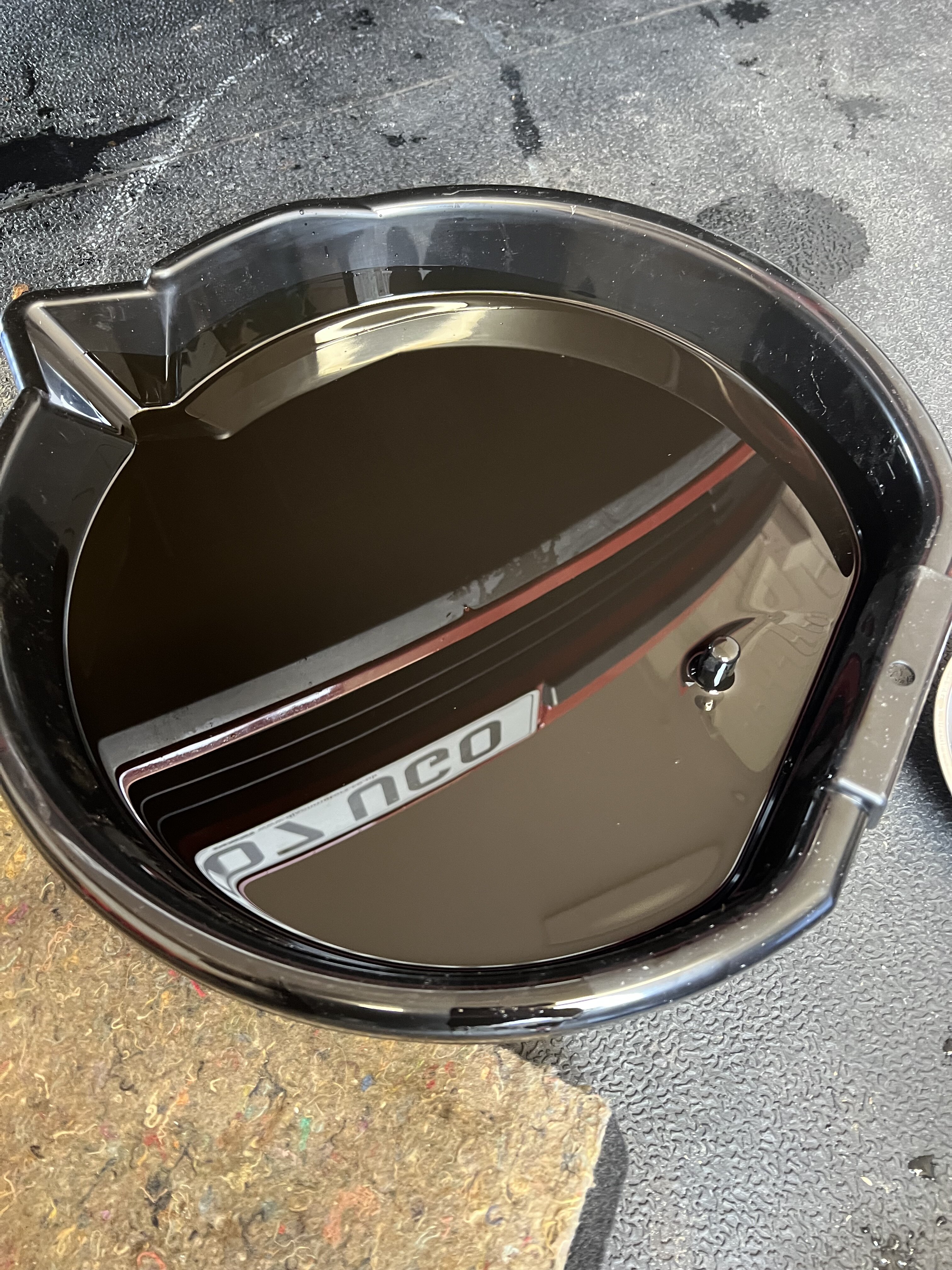

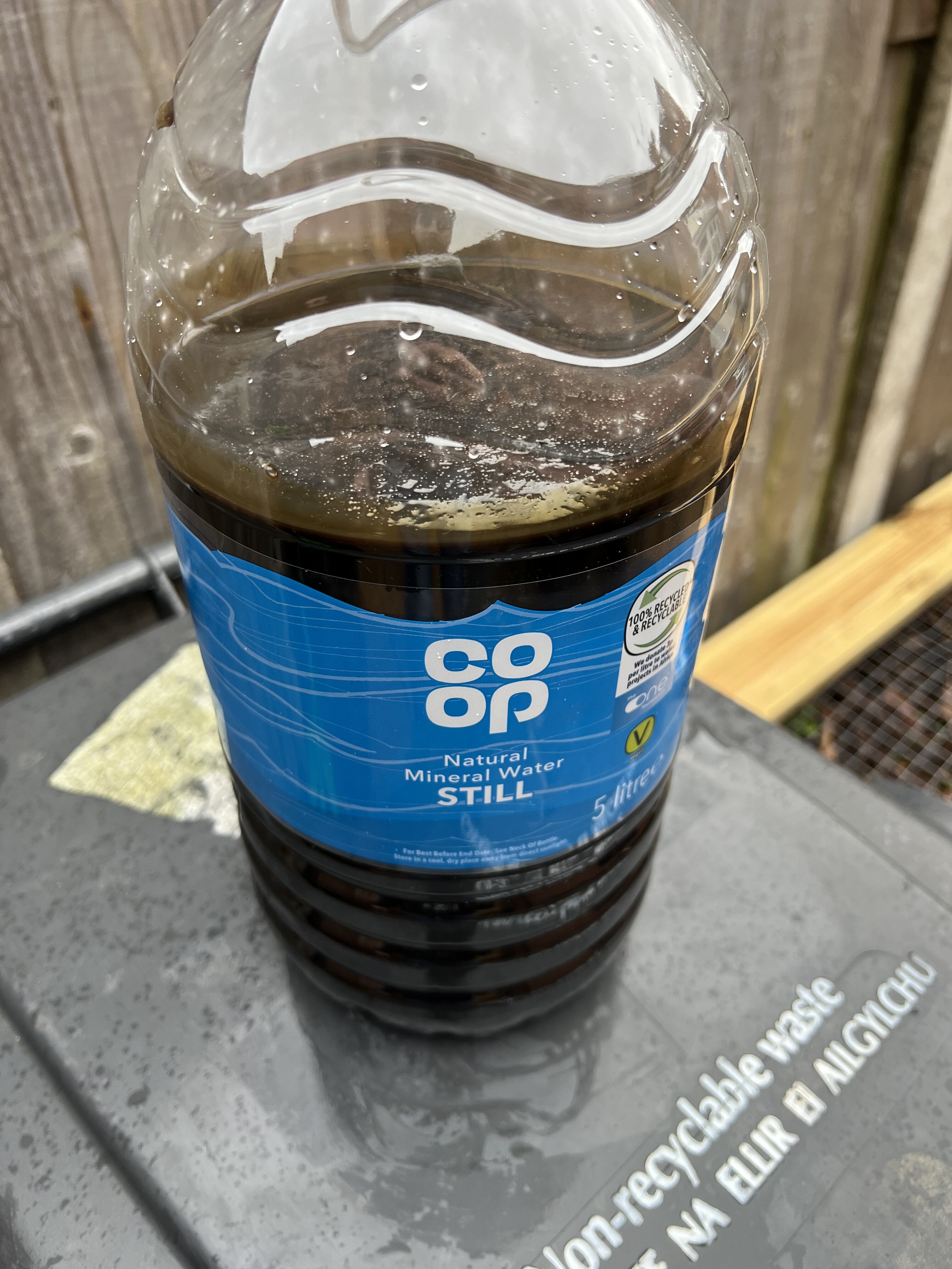

But before all that I figured I'd do the oil to see if there's any glitter surprise in there that would make the rest of it a waste of time, £35 for oil and filter all looks pretty good.
Disposed of the oil in a responsible way, 5ltr water bottles always handy for this.

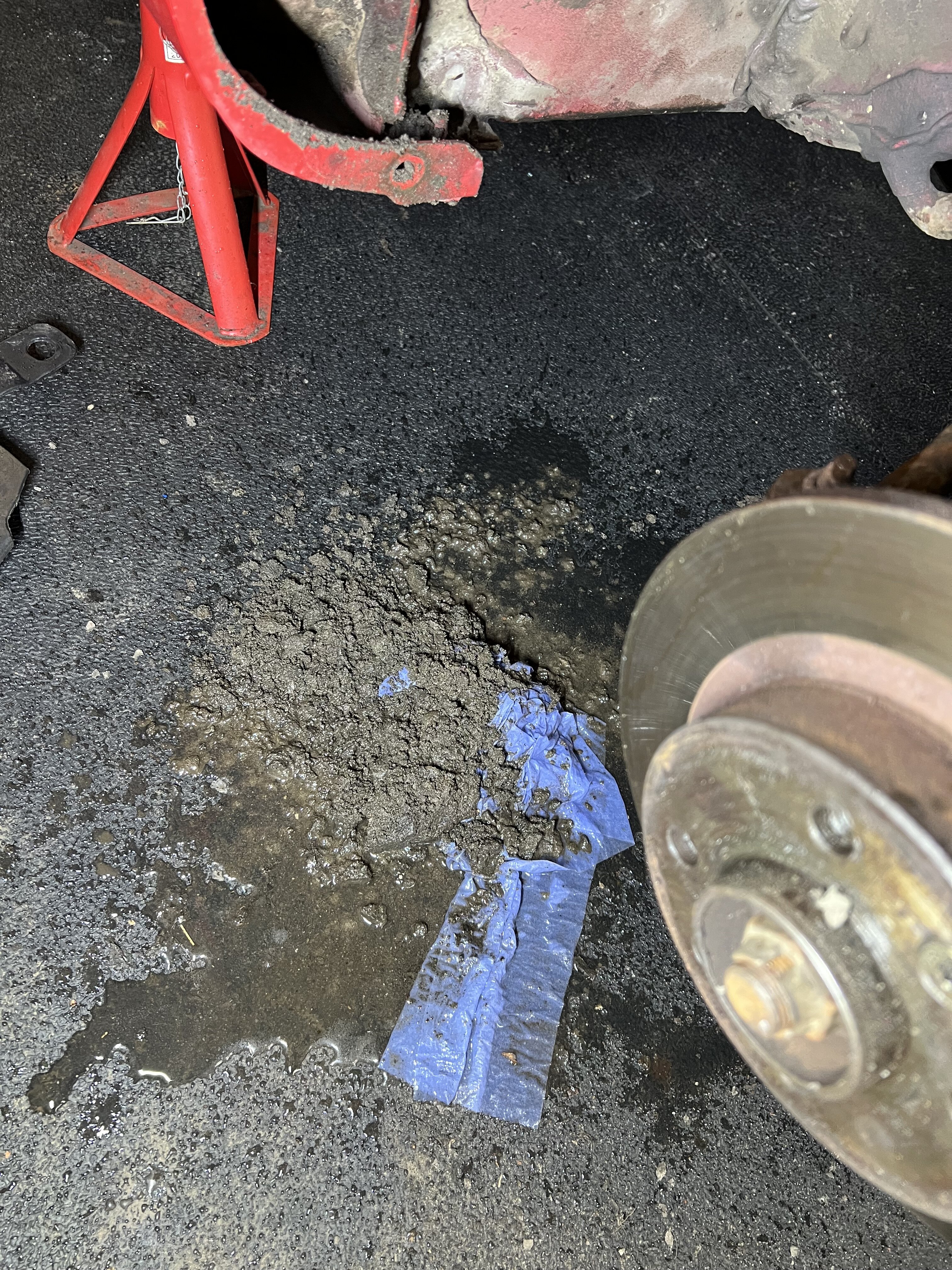

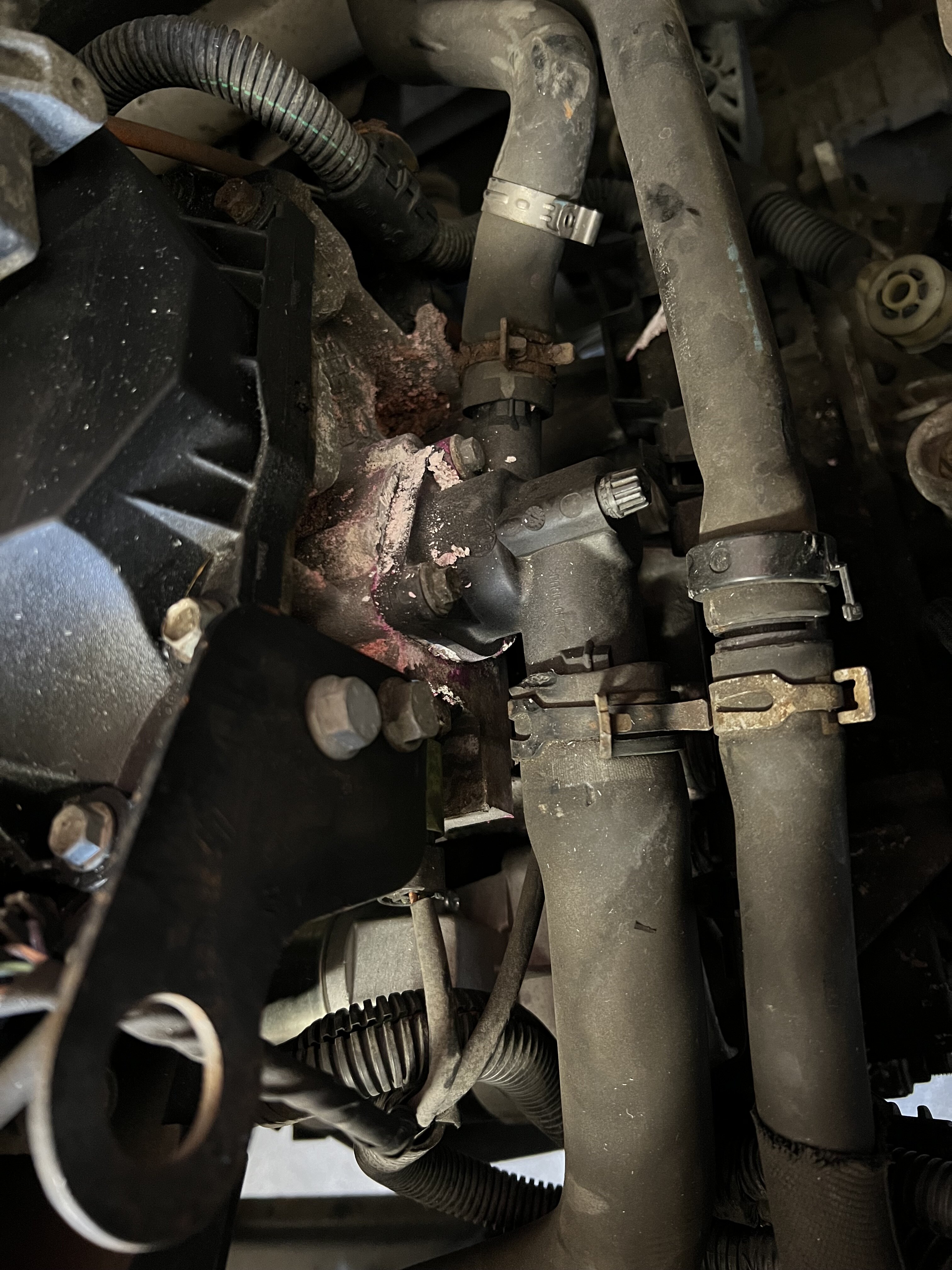

Moving on I ordered a new thermostat off eBay for £17 and picked up a bottle of type e coolant.
At some point this has had a coolant change to red coolant so when I uncovered the thermostat It was a bit powdery.
Coolant dropped some went in the bucket most went on the floor.
Cleaned up the face with a razor blade to get the crud off and fitted the new thermostat.

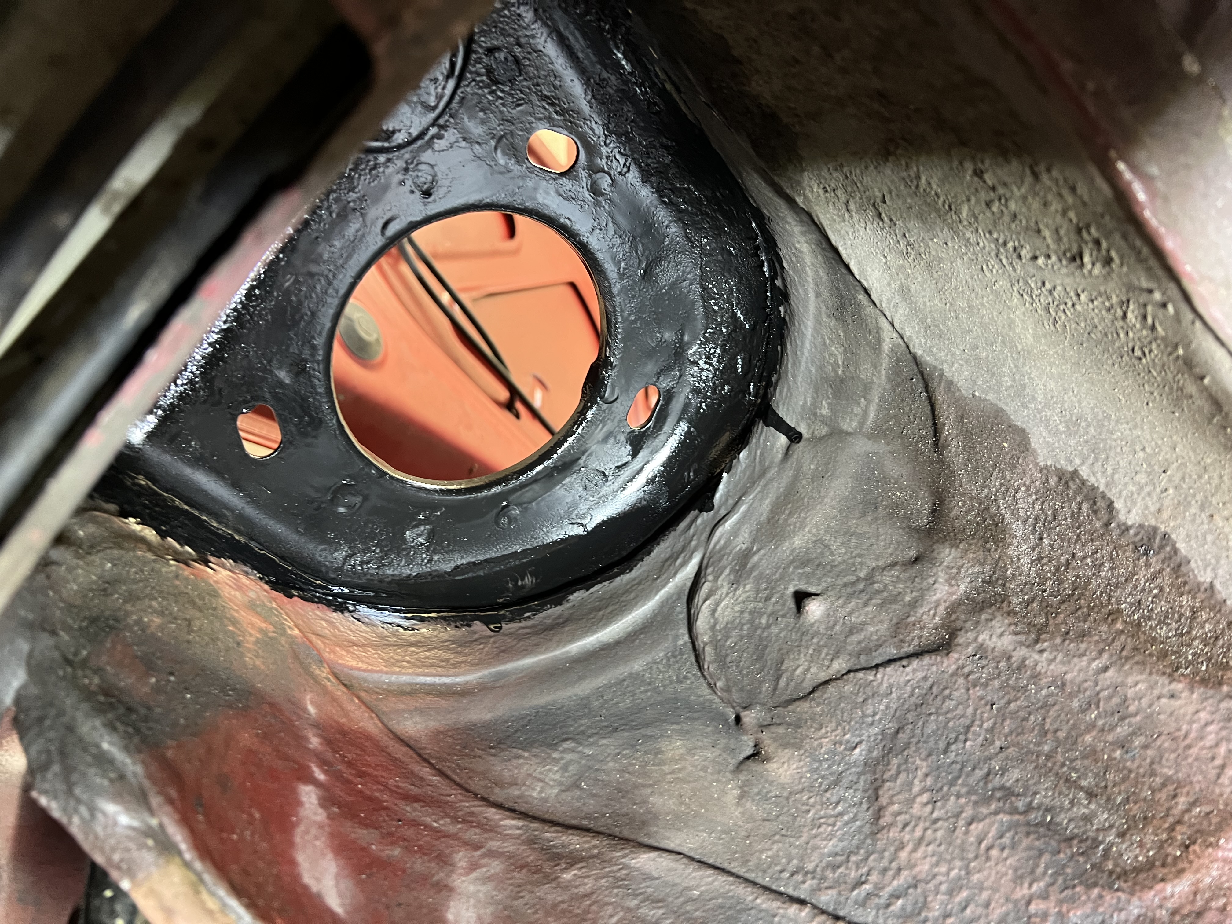

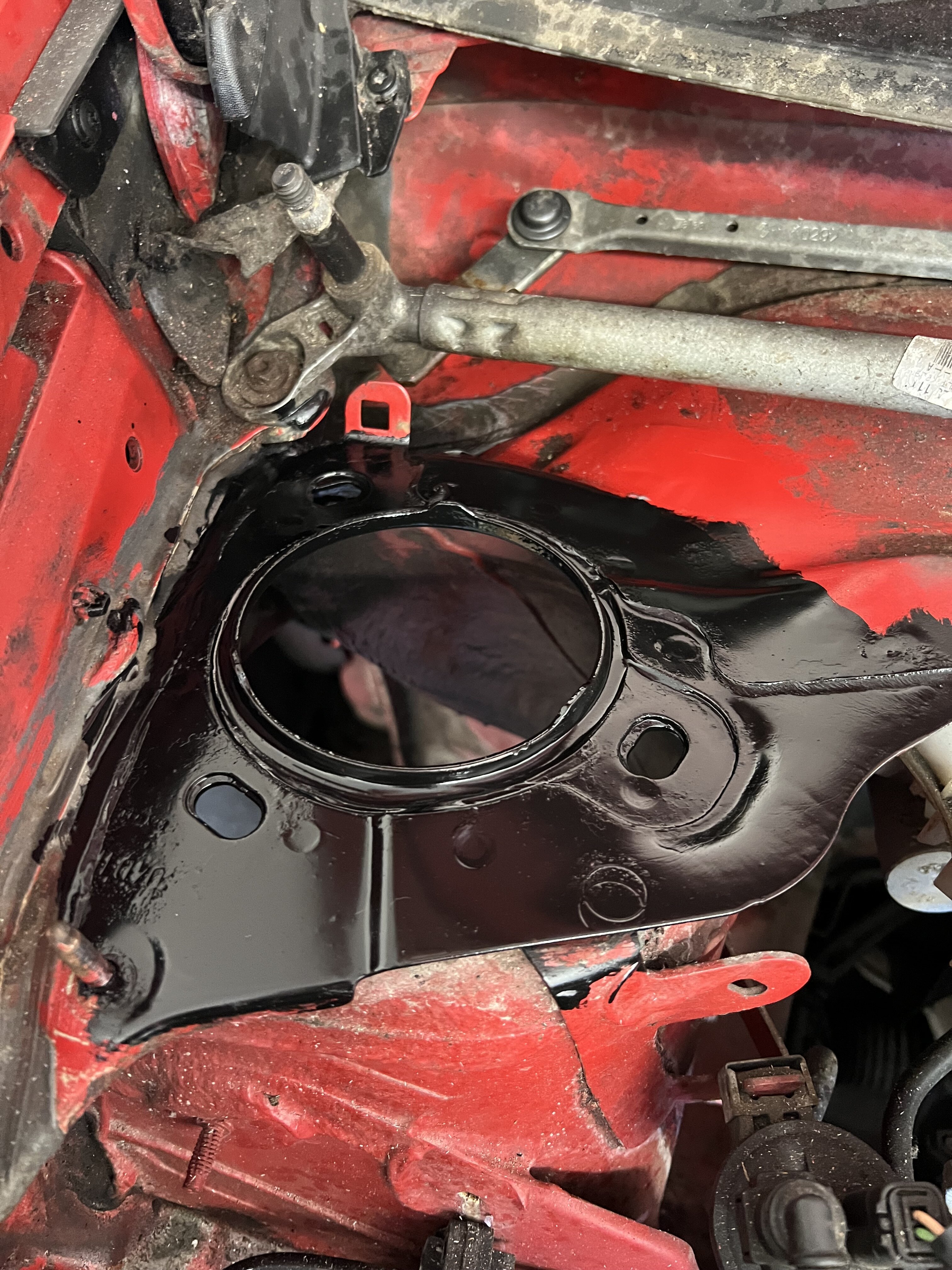

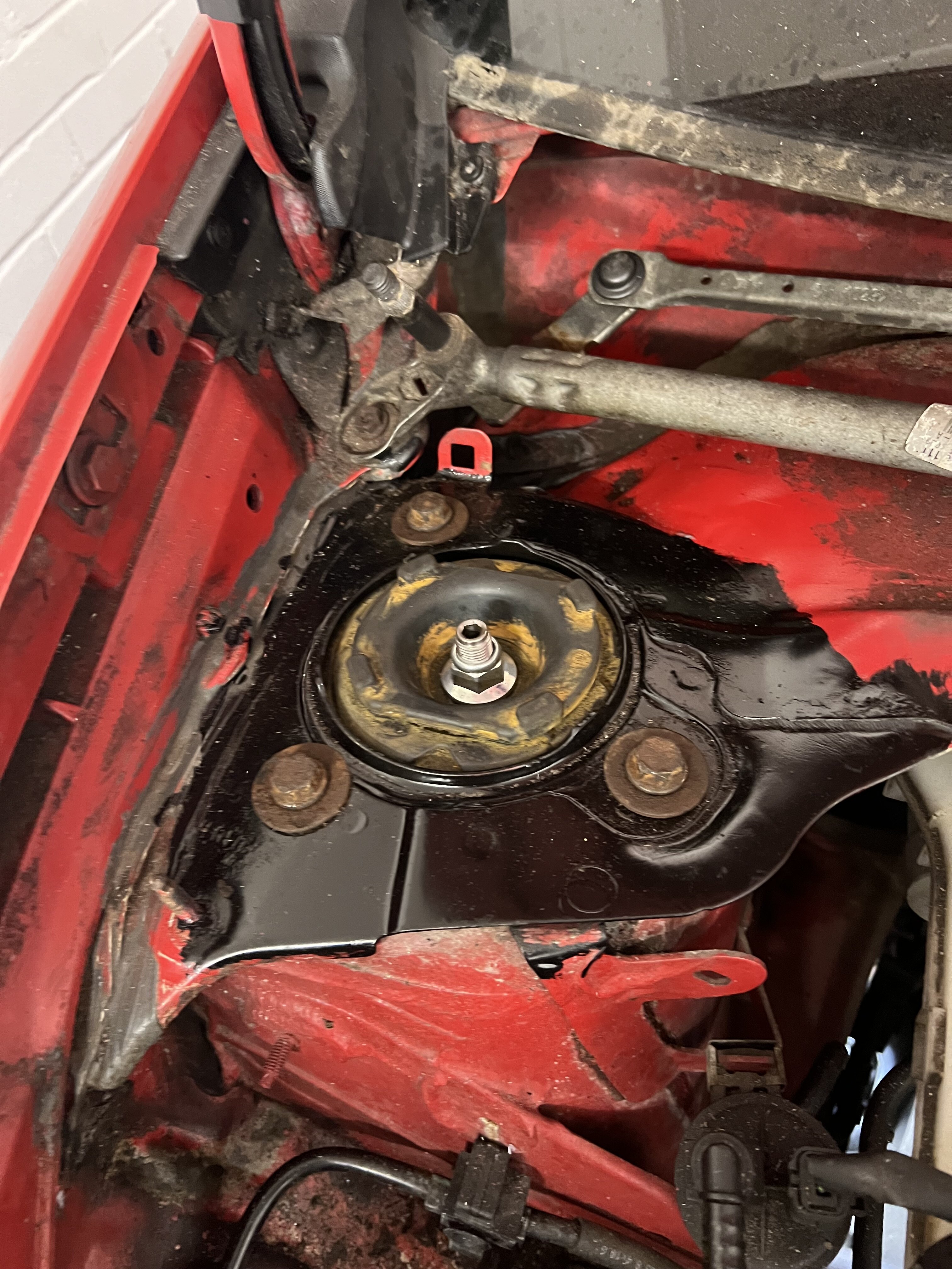

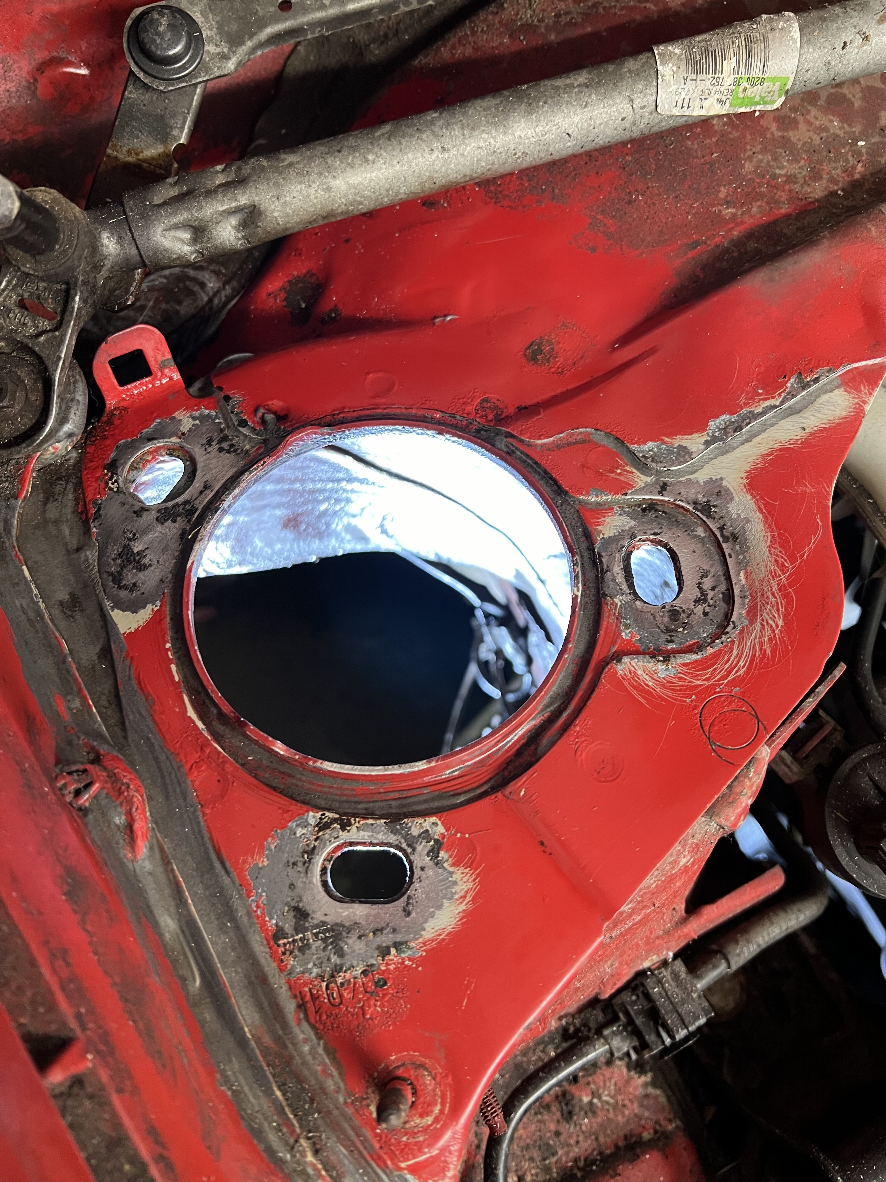

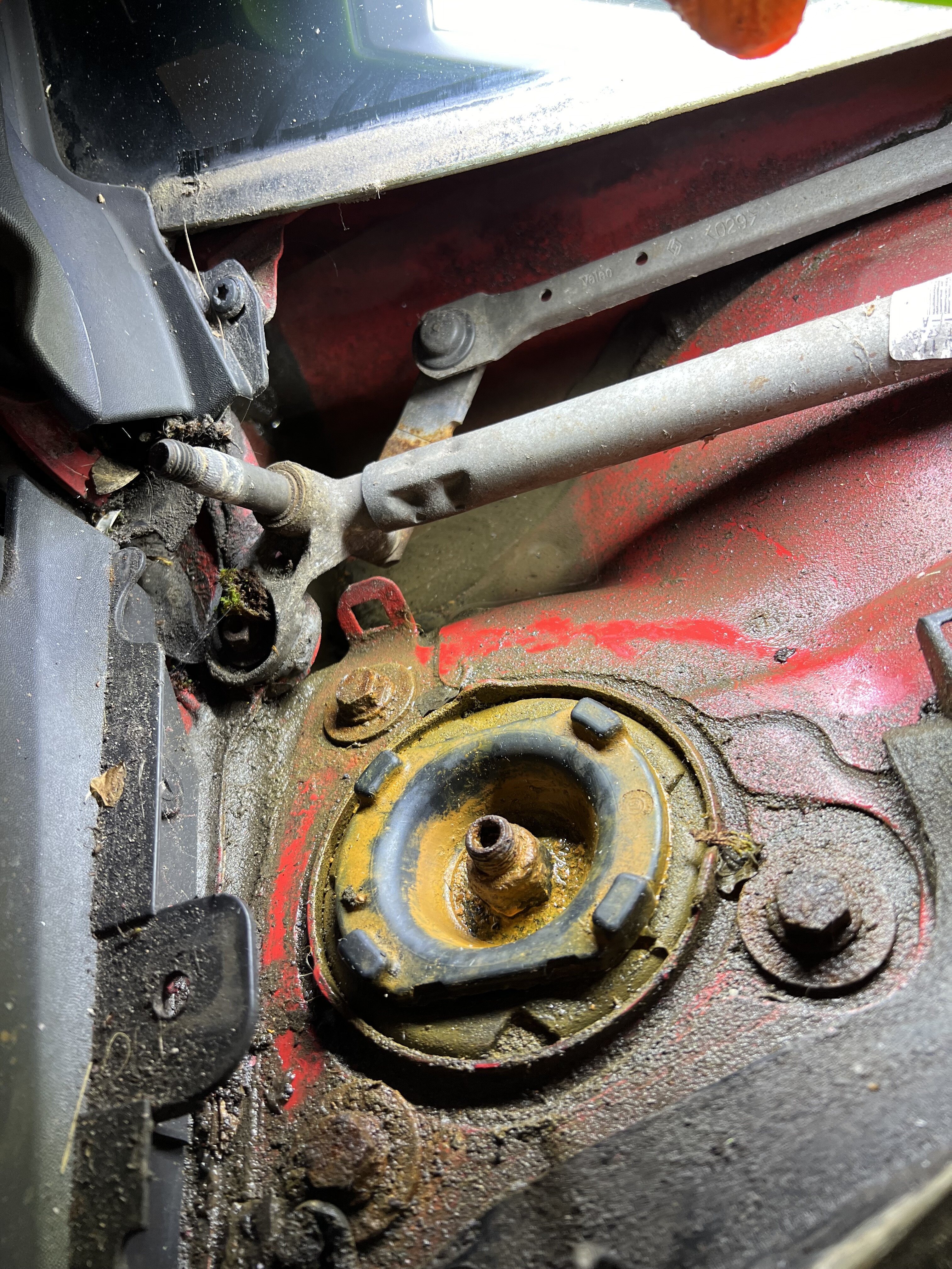

Stripped off the scuttle panel to get to the top mounts and was met with a nice pond and a blocked drain.
Pretty amazing amount of dirt in there so it must’ve been blocked for a while.
Got to say I’m impressed with the generally lack of rust but wire brushed a few bubbly spots and gave it a coat of chassis paint.

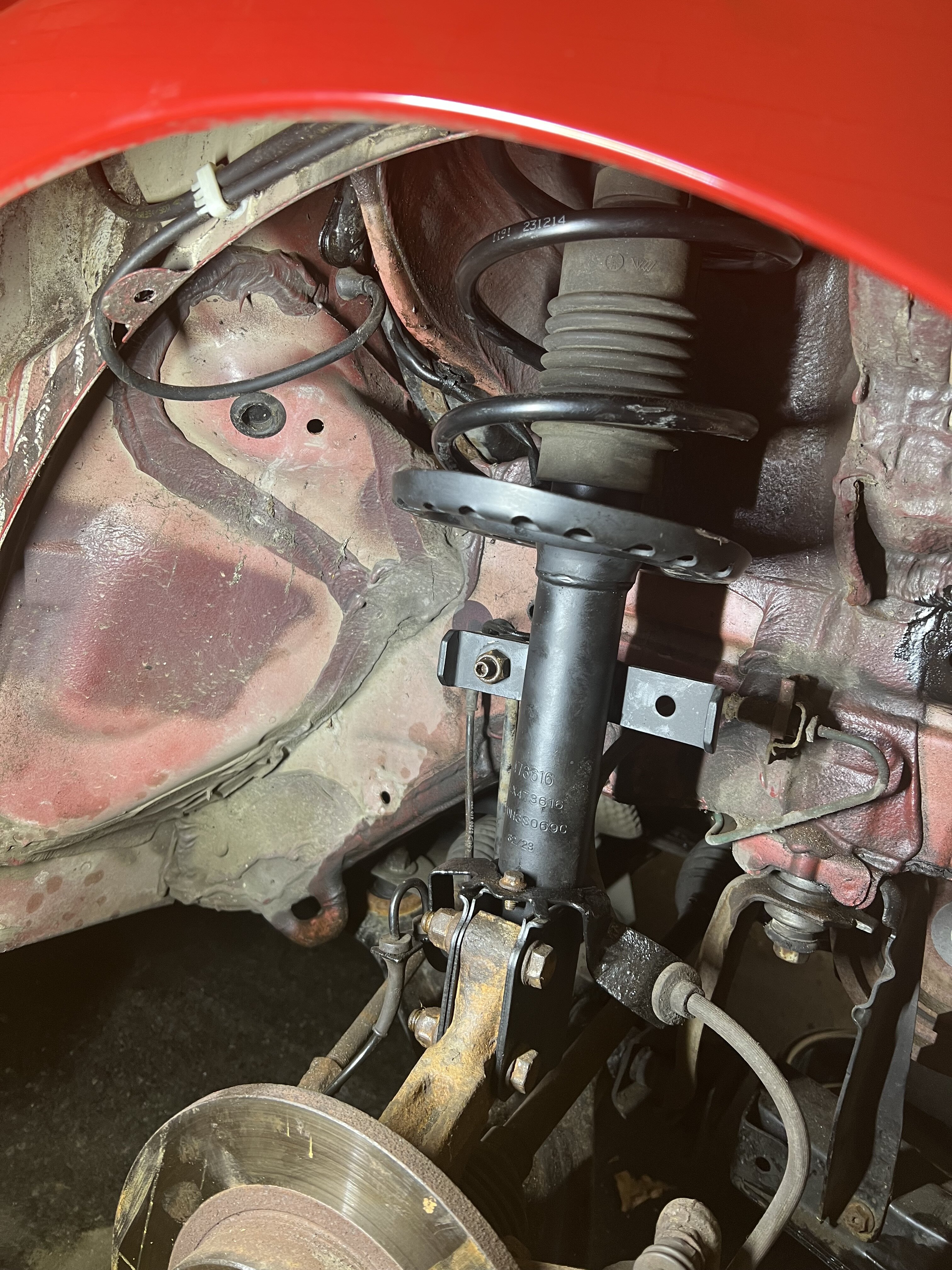

Refitted the struts with new shocks and springs, also gave the rusted bracket a coat of paint to tidy it up.

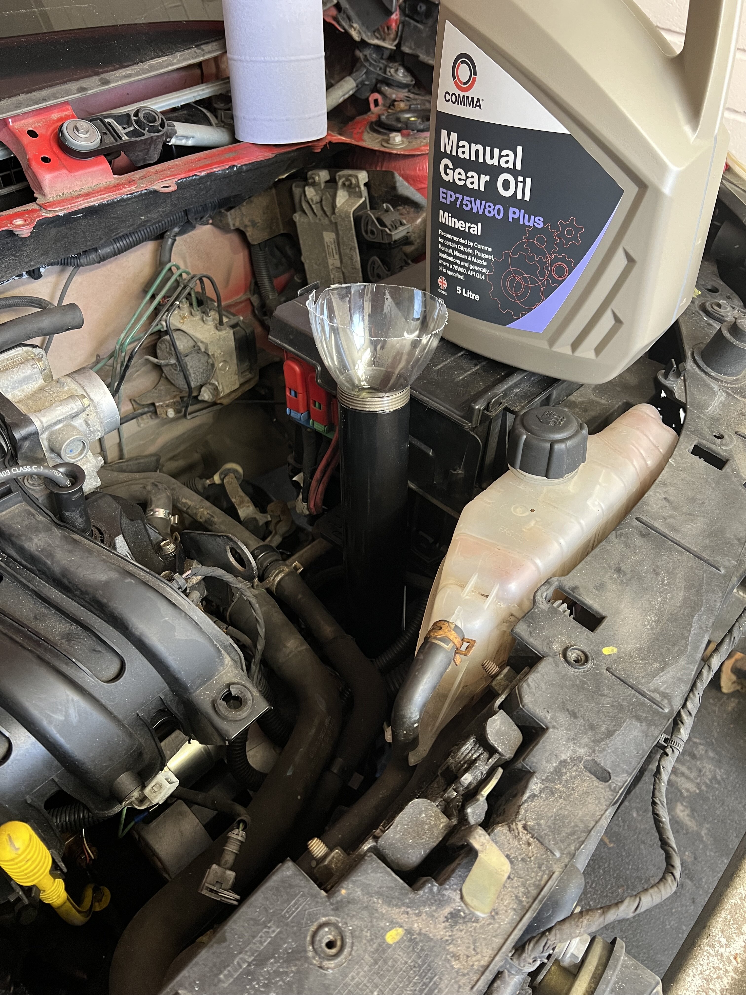

Gearbox oil changed, getting the plastic bung out was a complete nightmare, stupid design. But the existing oil looked decent so has been changed at least once in it’s life.

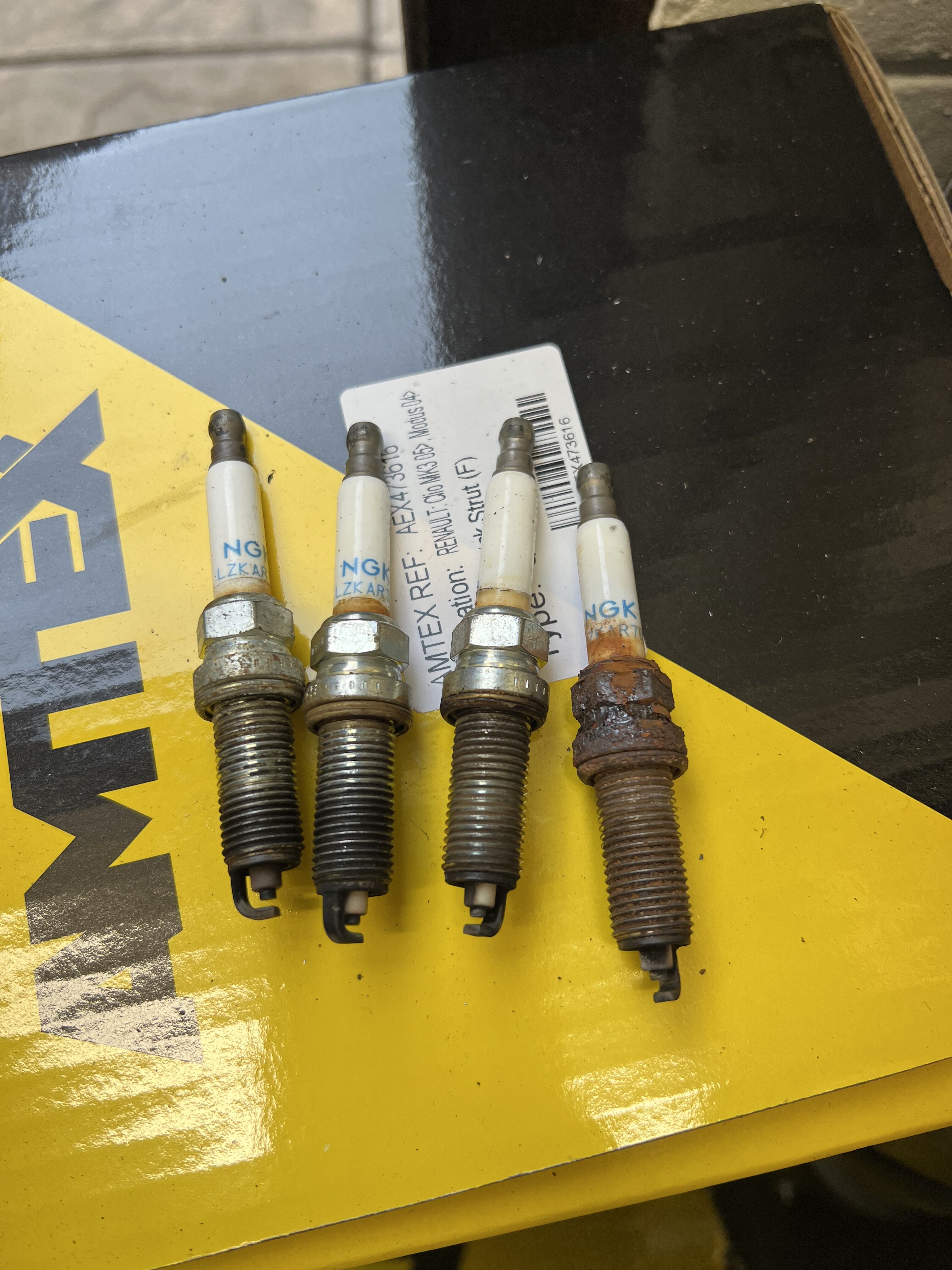

Then swapped the plugs, cylinder one was full of rust which not ideal but dry so I suspect some water had got in there previously either from a leak or over zealous cleaning.
JamesBryan
Get some ignition coil grease on the inside lip of the boots.

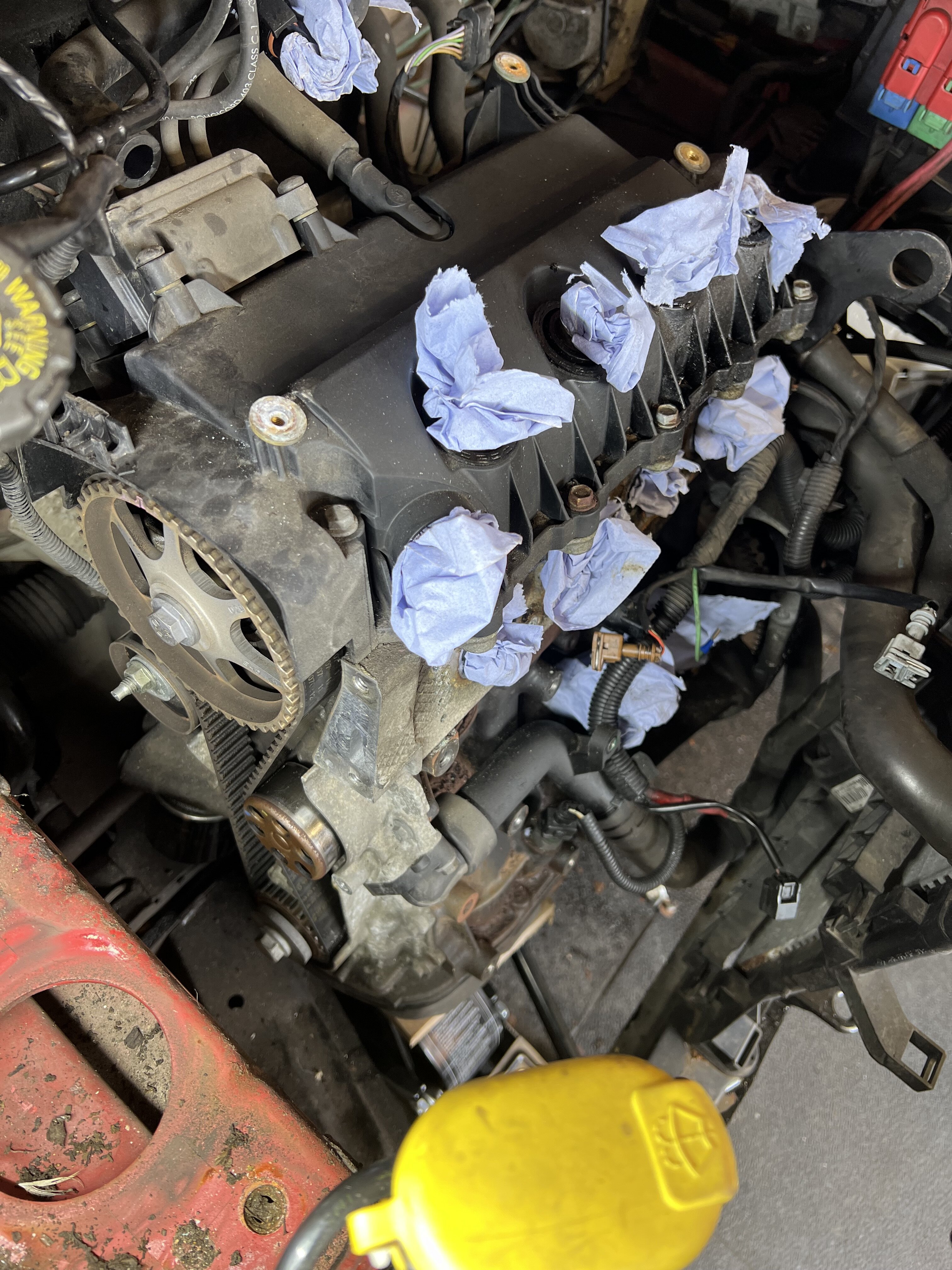

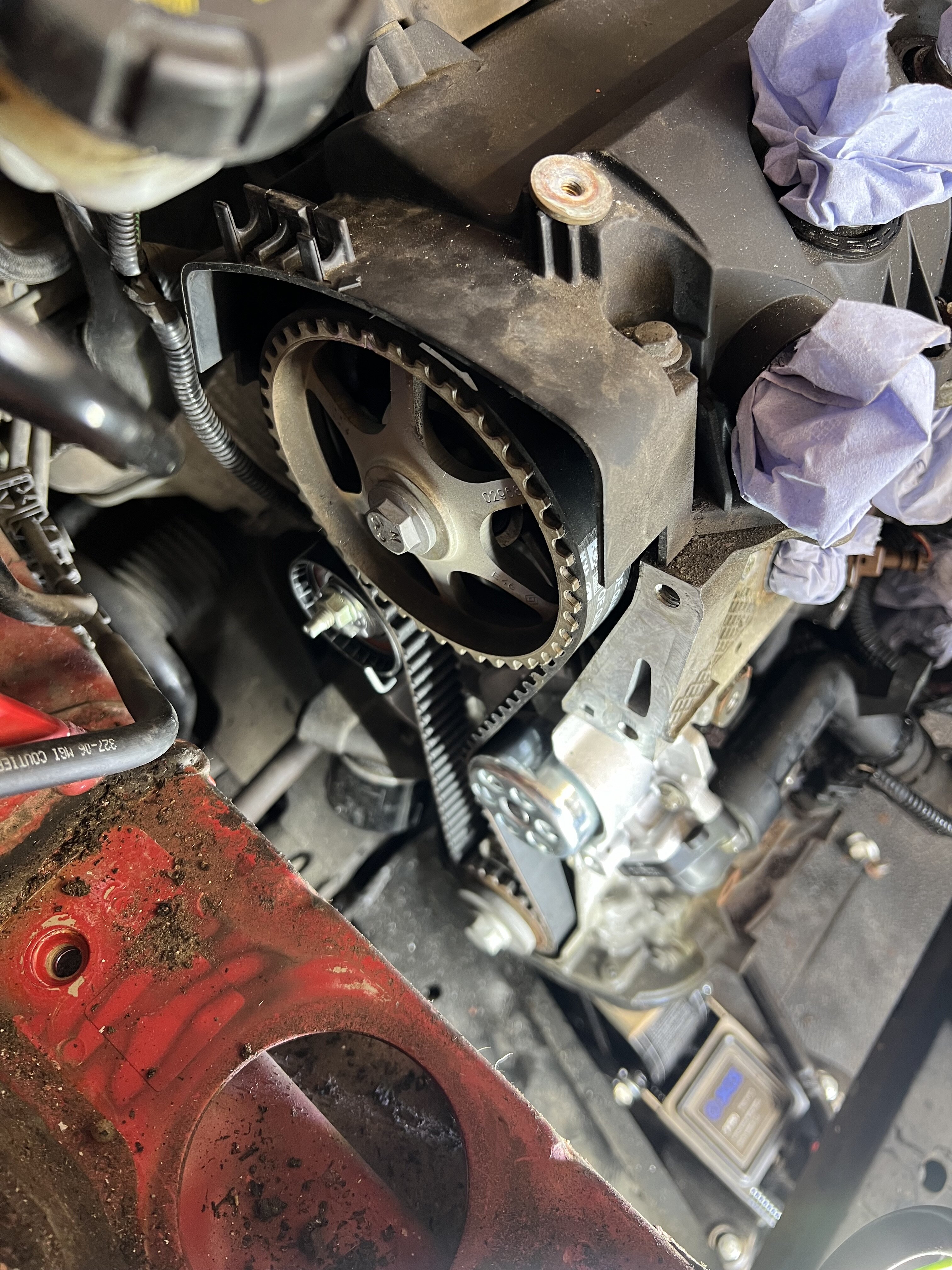

Engine fully stripped down for the belt and water pump change.
New pump and belt installed.

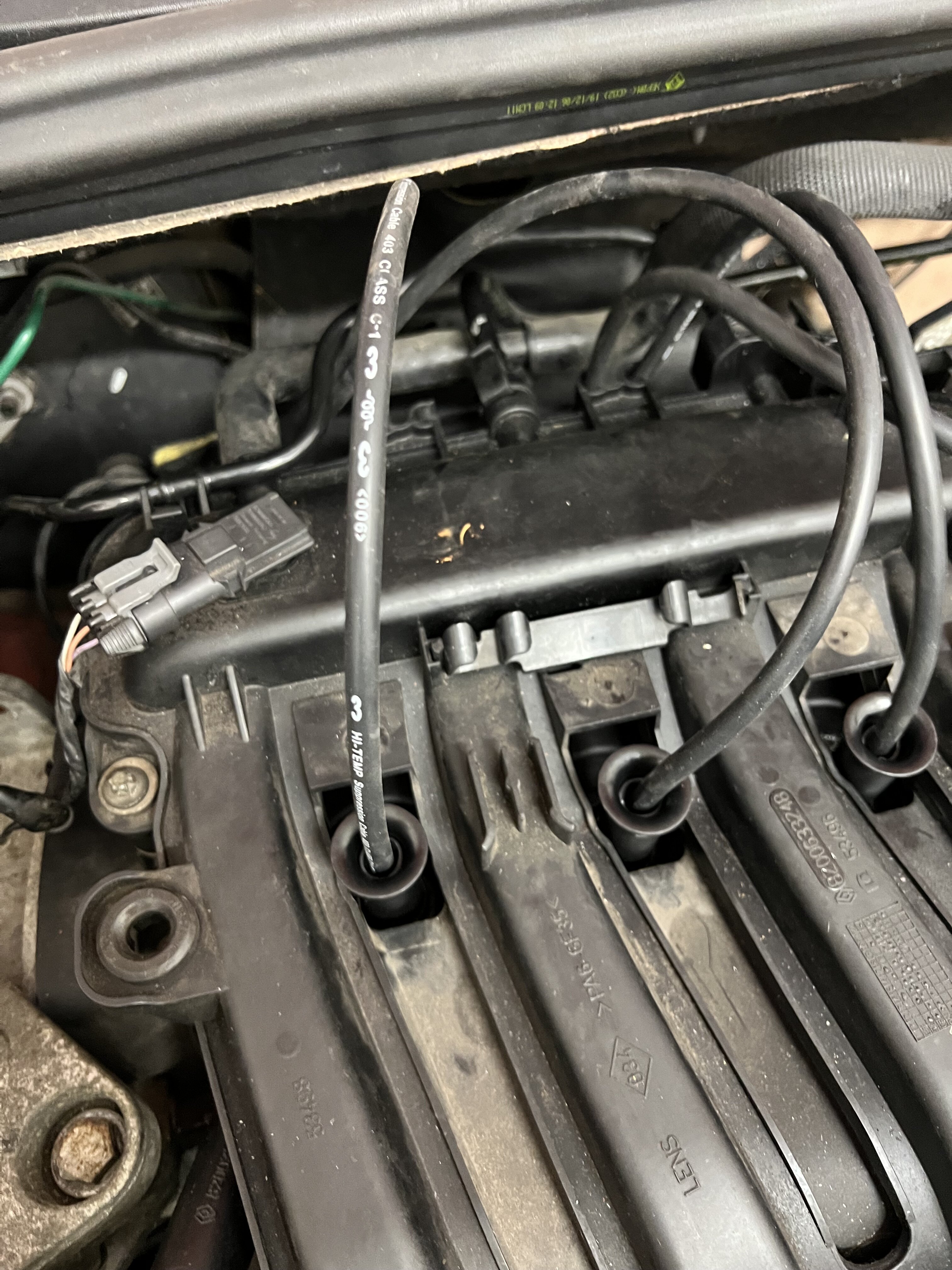

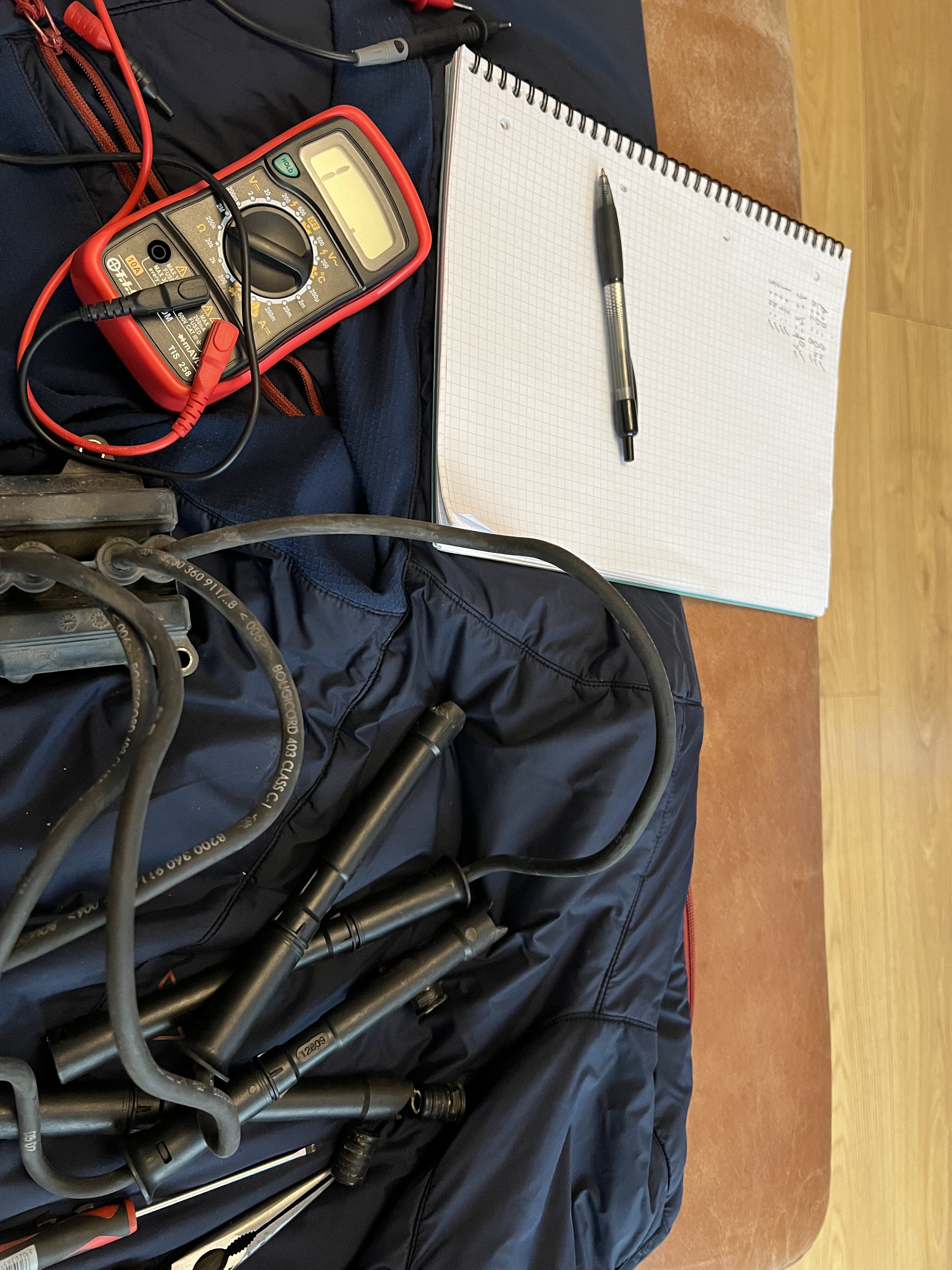

So took it for a test drive and noticed it’s down on power and feels like it’s misfiring.
Played around with the HT leads and narrowed it down to cylinder 2.
Swapped the spark plugs over just in case but same result so figure it’s one of two things the coil pack or an injector.
The injectors are faff to change on 1.2s as getting access without taking of the inlet is a pain so I elected to test the coil pack first.

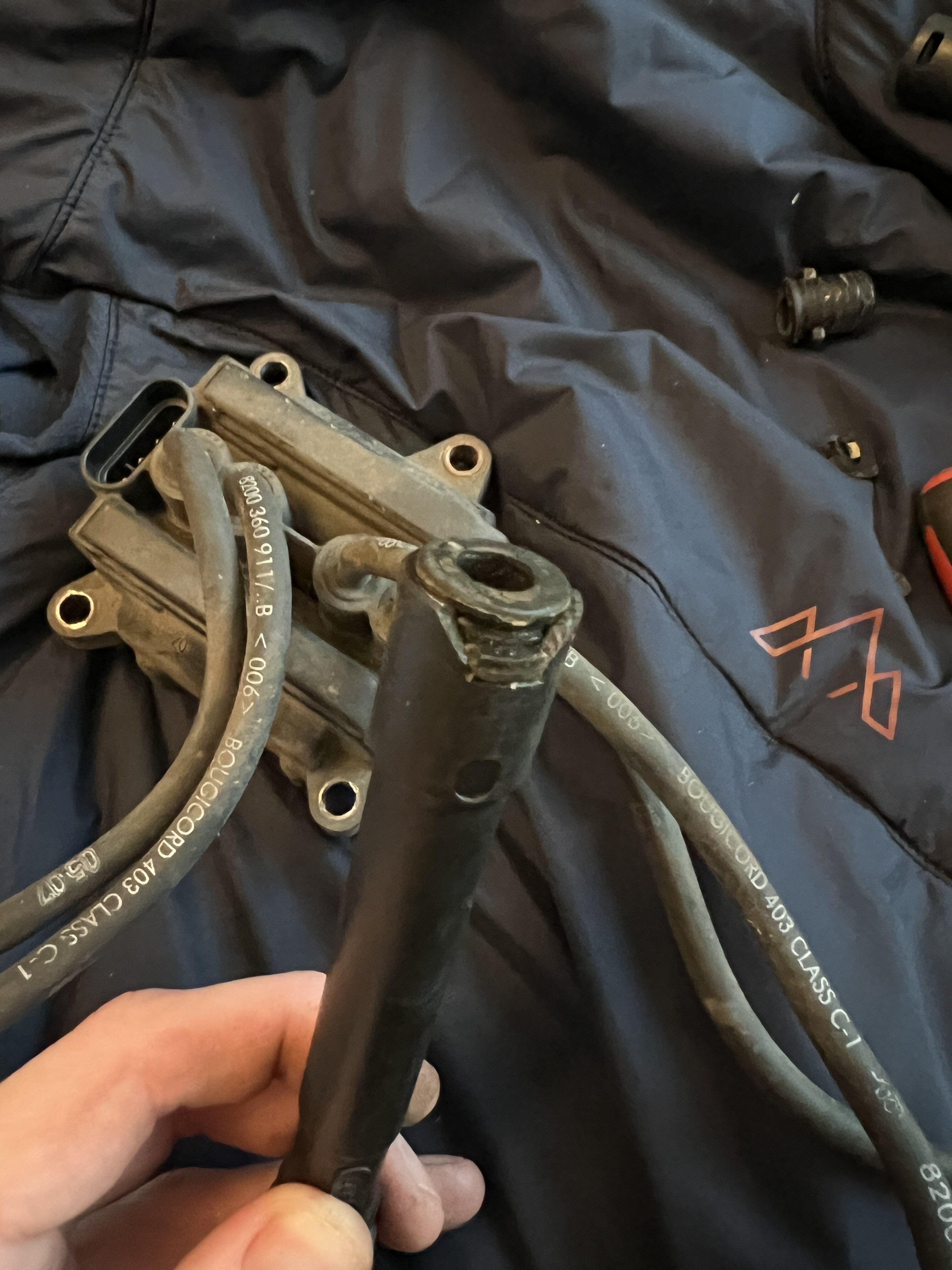

Took it off and soon as I tried to remove the rubber boots the plastic just crumbled.
Annoyingly tested it on the meter all came back within spec…, damn.
So next up need to swap the injectors over to see that’s my issue.
I also imagine the boots are going to stay down with the spark plugs if I reuse this coil pack and it’s going to be fun picking those out.
TheBandit
  Monaco172, Green1.2
Suffered exactly the same, new coils sorted me out. I dialectic grease them + use coil pullers and so far I have avoided snapping them again 🤞
Hope it's an easy sort

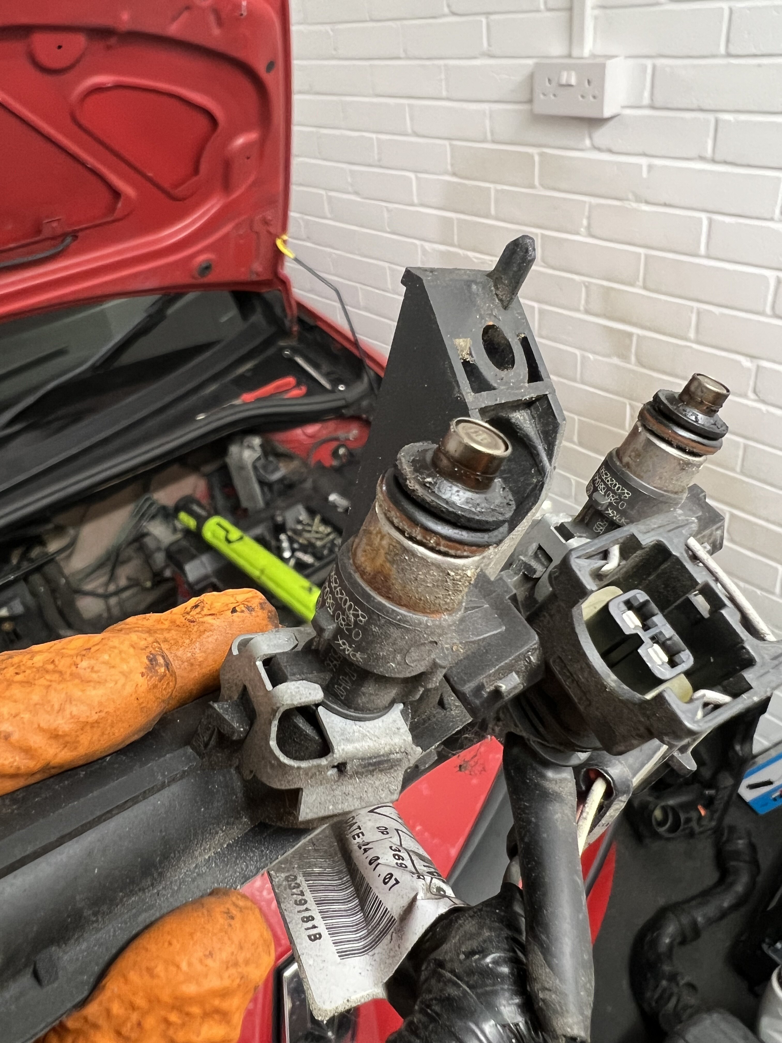

It was annoying me so pulled the inlet off to take a look at the injectors.
Certainly looks like cylinder 2 injector could well be my issue as it’s more rusted than the others.
The likes of ecp want £70 for an injector or an eBay special for £30, I don’t particularly fancy either option.
Noticed a breakers selling a full rail for £25 so seems like the sensible choice worst case I get one good injector, best case I’ve got 3 spare injectors.
Once that’s delivered I’ll get it fitted along with my original coil pack see if I can get away with not replacing the coil.

So swapping the injectors didn’t resolve my issue.

Was indeed the coil pack, seems to be running fine now.
Also kudos to euro car parts for installing the cables the wrong way round.

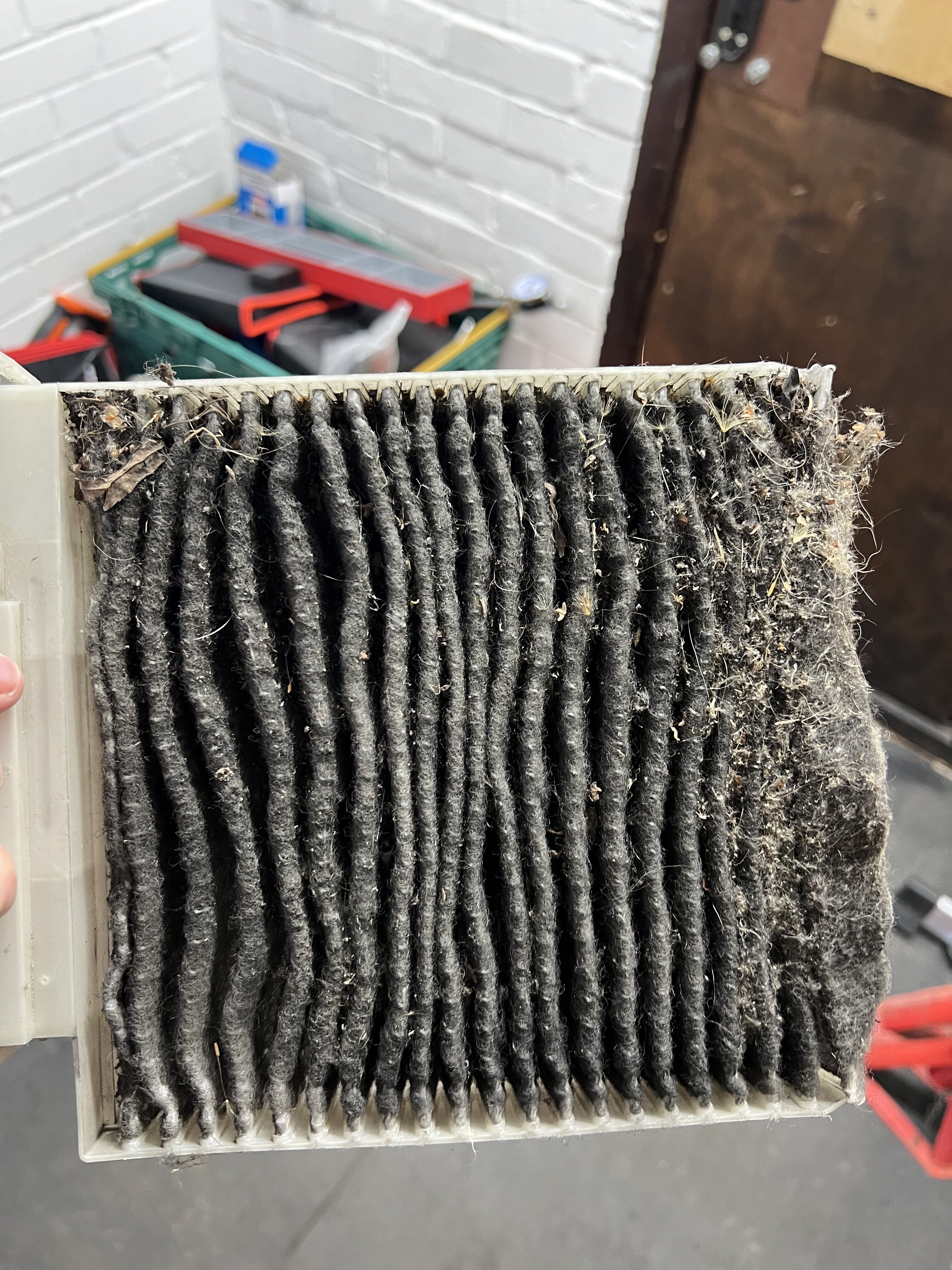

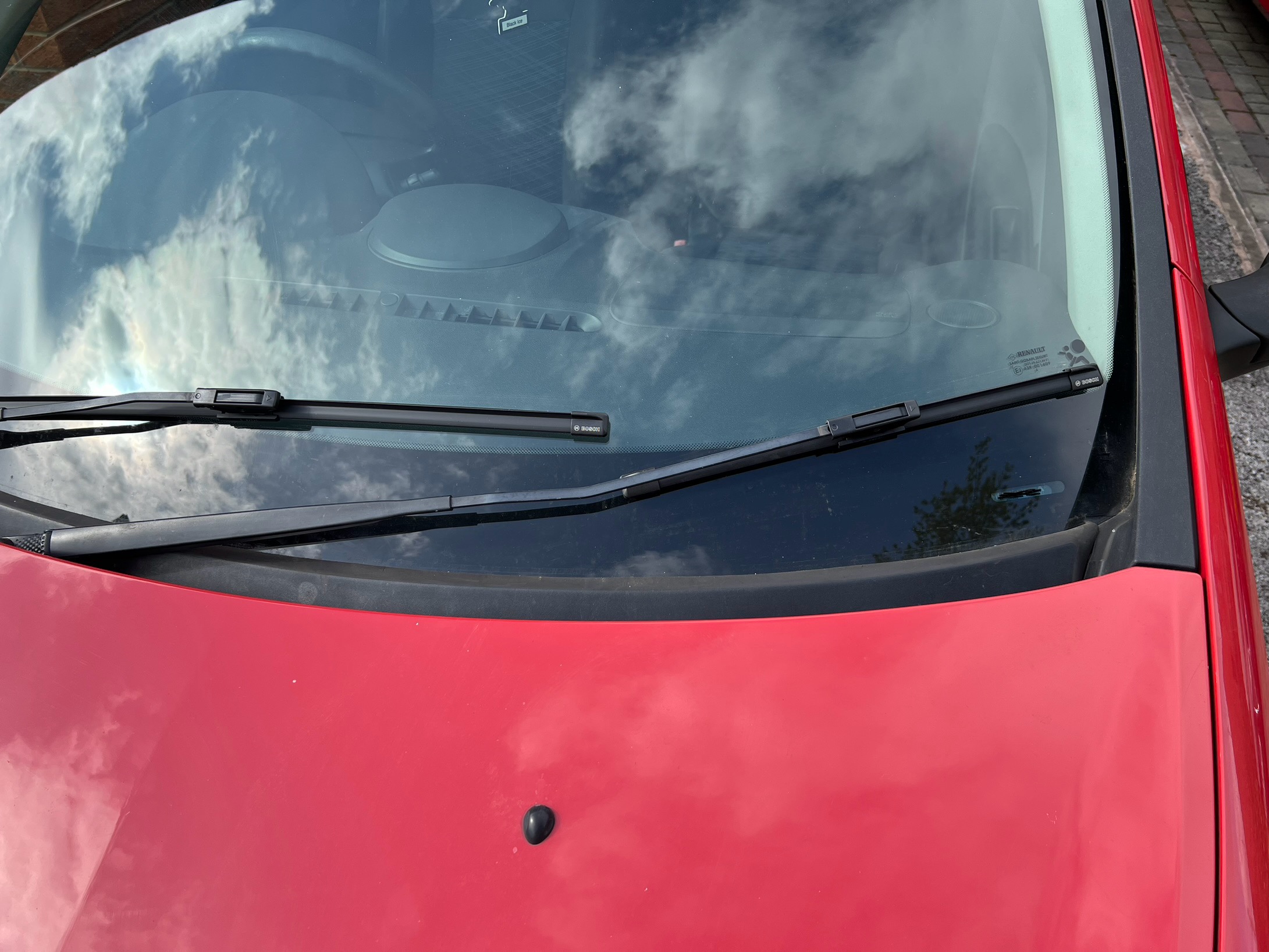

Swapped out the cabin filter.
New bosh wiper blades.
Fitted a new brake pedal switch as it was flagging up on the code reader.
Took it for a run down the motorway, returned 55mpg pleased with that.
