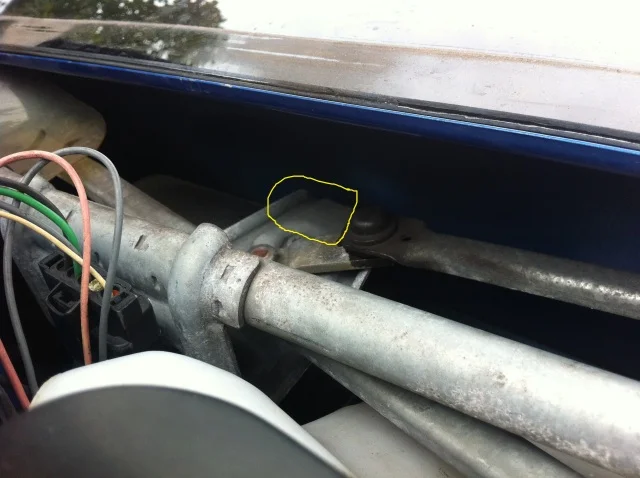

I unbolted the wiper linkages but it seems to be connected to a small pipe like thing towards the bulkhead or interior so I didnt want to pull it too hard. Has anyone pulled theirs off?

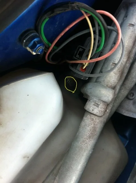

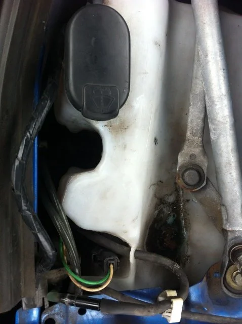

Also, How do you get this son of a b**** bolt undone to get the tank out? Do I really have to take all the linkages out?

Ok thanks, I will have a go. In the 1st picture it looks like its attached to the interior or something that way though.
I replaced both my pumps on Friday, as Fred suggests above disconnect the loom and remove the complete assembly (3 bolts).
The piece in your first pic is just a round metal bracket that holds the assembly in place and the assembly will just slide off it.

Bit of a ressurection but am trying to do the same thing and on getting the scuttle panel off I discovered the intermittent rattling i've been getting on idle is the washer bottle cos the bolt in the 3rd picture isn't there. Obviously makes getting it out nice and easy but where can I source a replacement bolt? what size is it?

Thanks but how big is the bolt holding the washer bottle in. Mines missing and I'd like to buy a replacement before pulling everything out again. Seen from searches its a 10mm bolt but not clear if that 10mm long or 10mm wide? If it's 10mm long then what size bolt is it M6?
