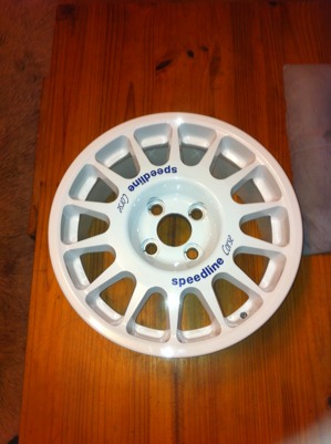

Think I'm gonna go for the common 2118's :) in white. What's the offset I would need? ET38 I take it
  Ollie's Silver Cup
Mine are ET43 (purely because the anthracite were only available in this offset) and fit with the midilite calipers without any problem.
I think the white 2118's are available in the lower 37/38 offset too though. :)

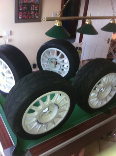

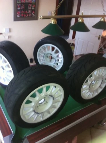

Lol, I'm very impressed by his service to be honest. Mine are already wrapped in R888 :) they look minty mint
